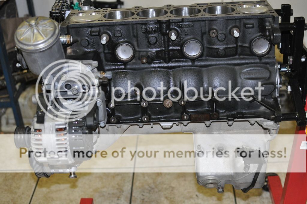

Xack said:a1exander said:UpNcOmiNg! said:Has the crank been knife-edged at all?
No.
i assume that it was polished then? also at what point would it require knife edging?

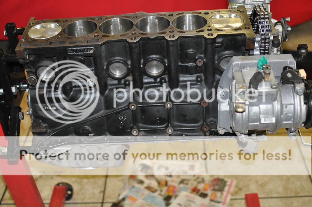

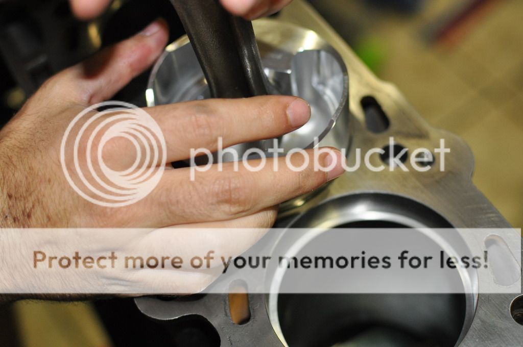

Walt car had overheated in its previous life and the bores where out by 200 hundreths at the top of the stroke.Tehwalleth said:Was there any damage to the brores that resulted in the compression issue or was it something else?
Tehwalleth said:So that explains the larger pistons? rehone the block and slightly bigger pistons?

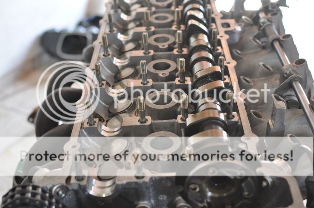

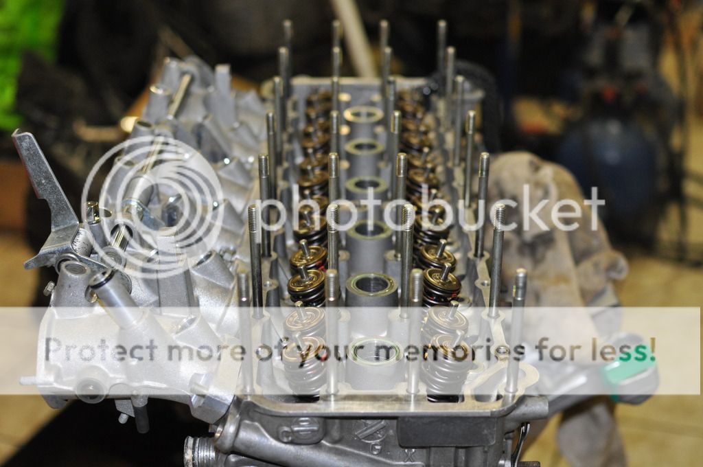

Dawie they are as they take longer to go out of tolerance....the down side is that when they do it is R300 per shim from agents.Daaf Vader said:Awesome work!raise:
So clean it looks amazing.
Those shims seem to be a well designed item.
