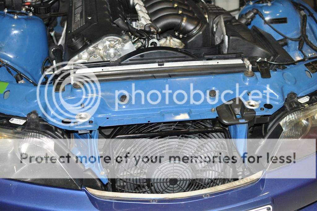

Im confused by the last pic, what colour is the car? Santorini or Estoril blue?
Peter@AEW
Estoril,however the engine bay is sprayed "The economy version of Estoril Blue" with a liberal amount of grey primer visible under the chassis legs.
