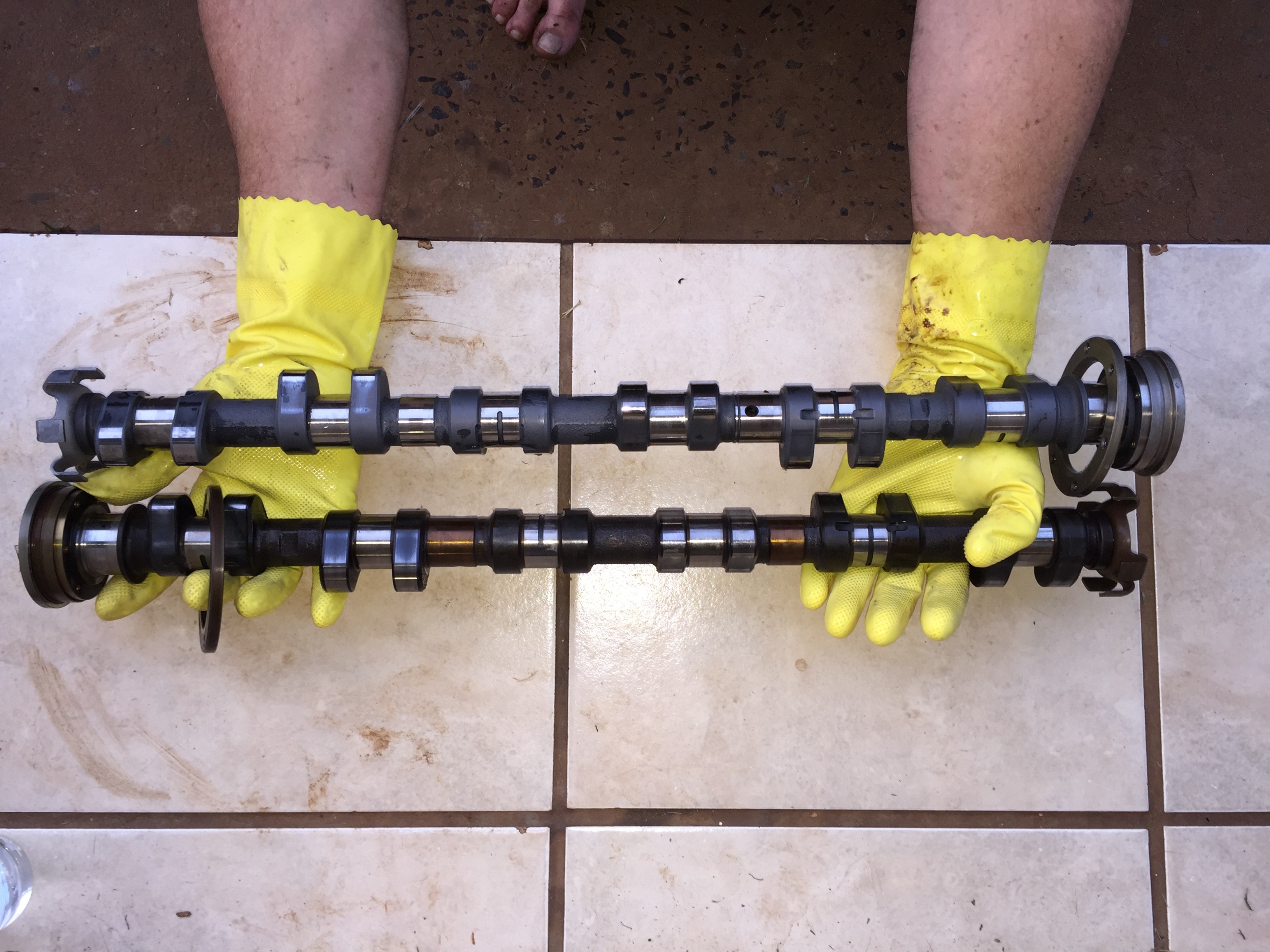

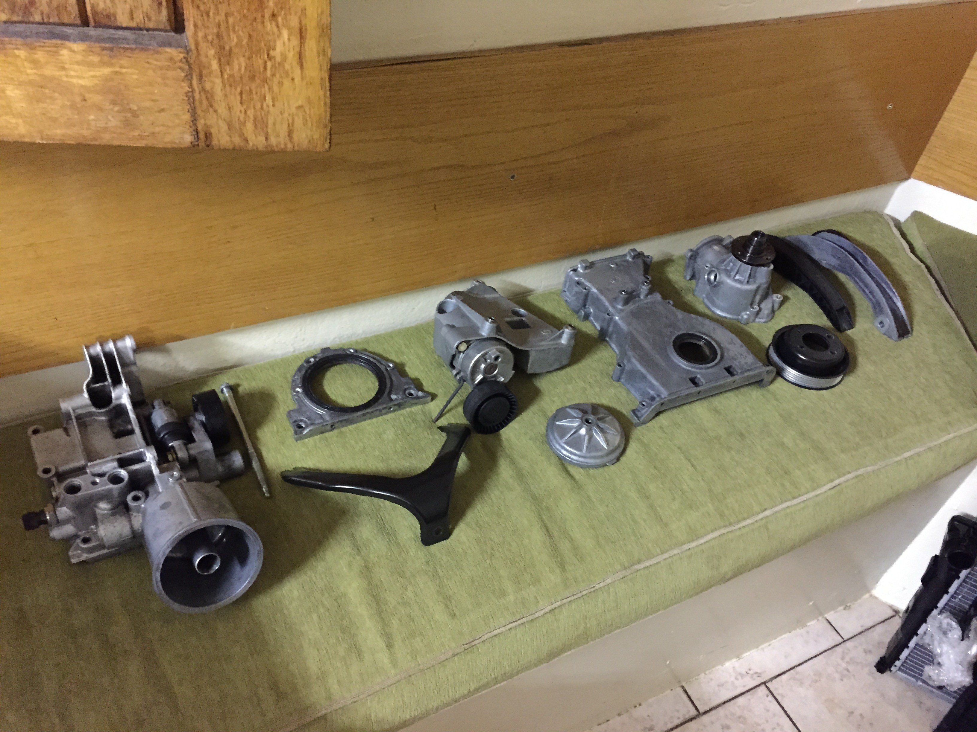

Here is what consumed most of my day today...
My hands are going to look like Zombie claws from all the Zeb oven cleaner, but it does make short work of all the burnt on grime in the casings, on the cams etc.
