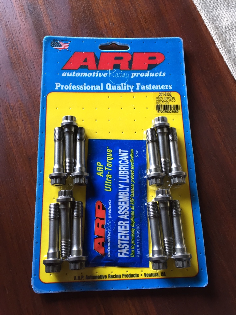

I ordered some new bearings (big ends & mains), ARP rod bolts and a cometic gasket from VAC, the most expensive order of the lot...

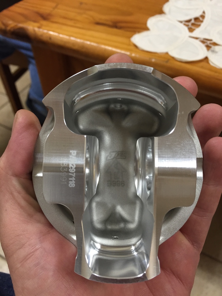

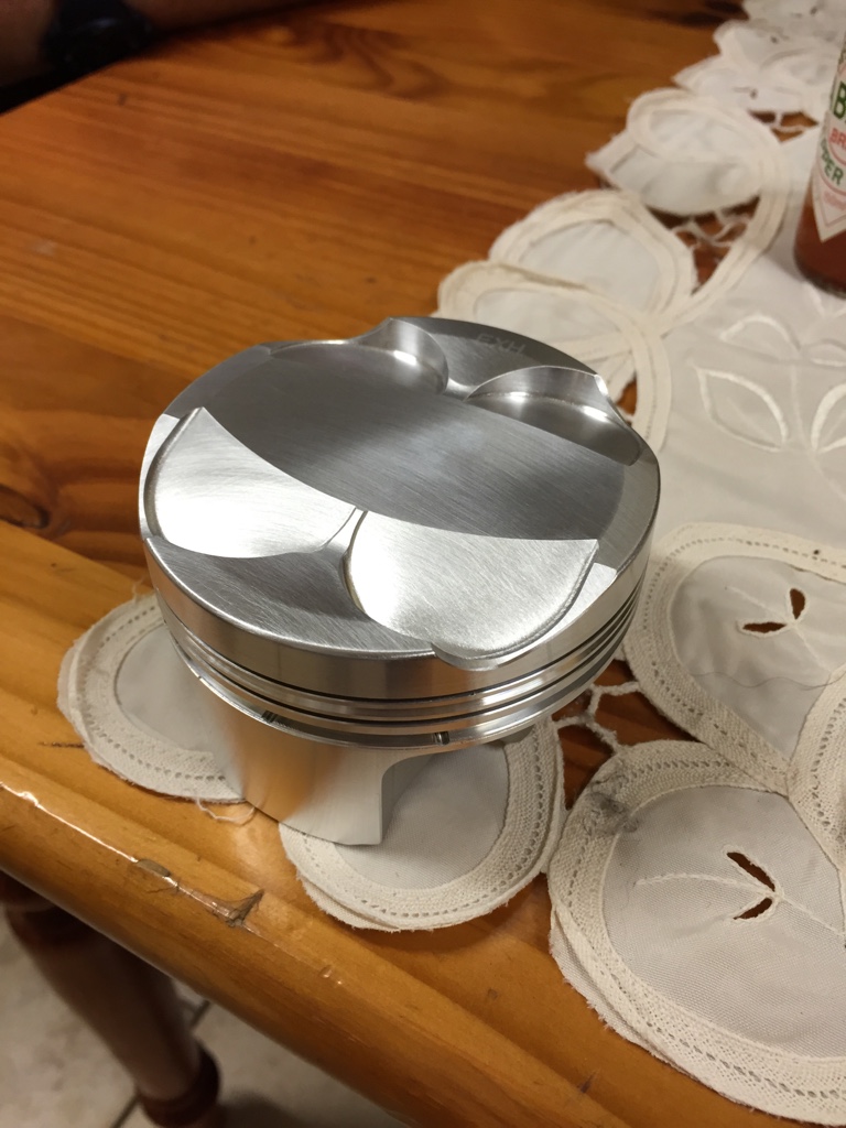

We got pistons from Top End Performance in the states as well (JE's, at 0.5mm o/s)

Xack
Wow they're quite beautiful for something you'll never wanna see again once fitted:clapper:

RE: E46 ///M rod bearing failure
Wow they're quite beautiful for something you'll never wanna see again once fittedClapper
For sure brother!
