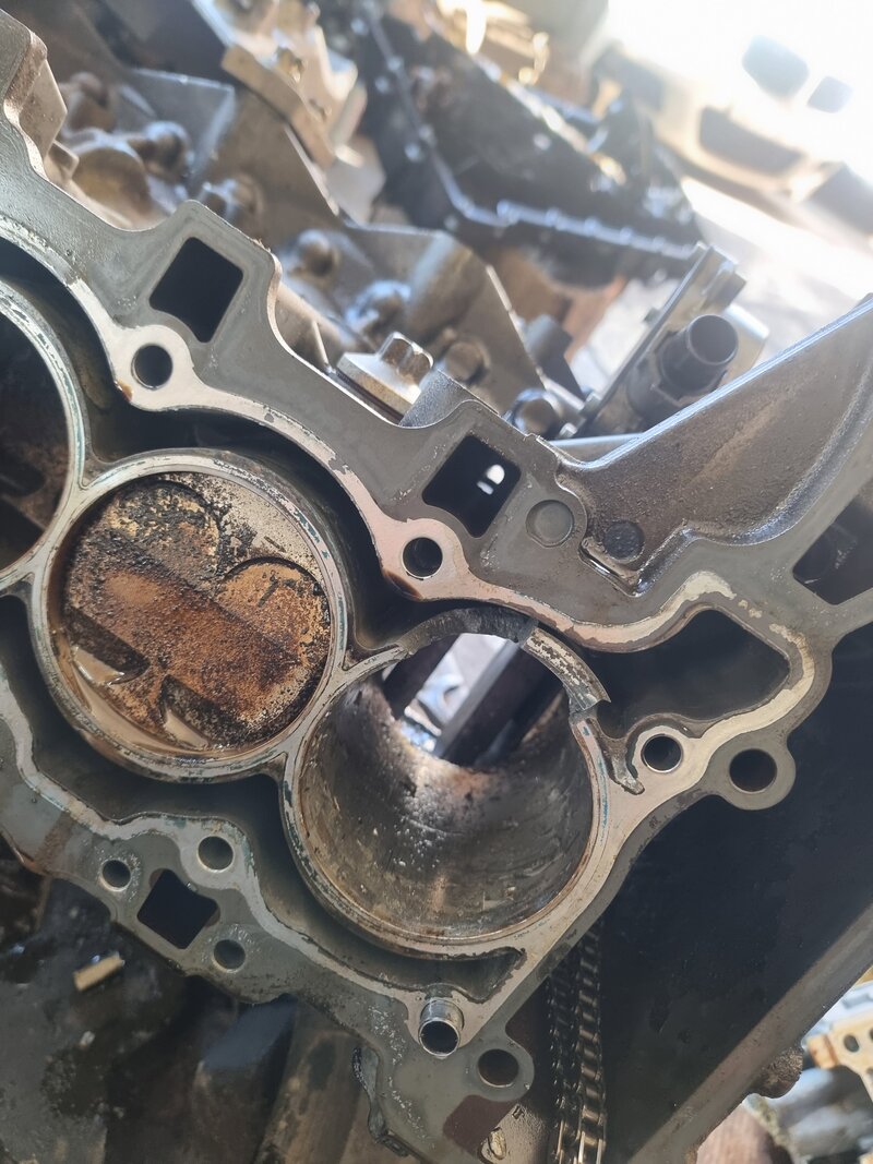

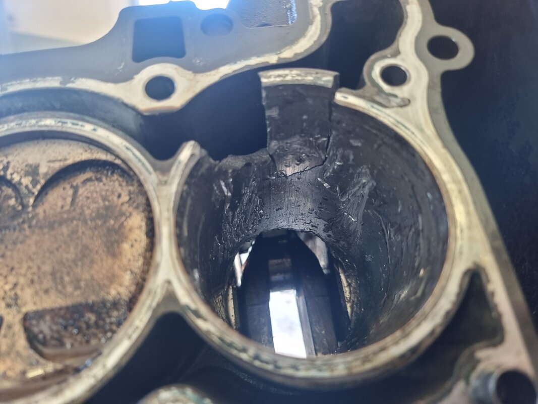

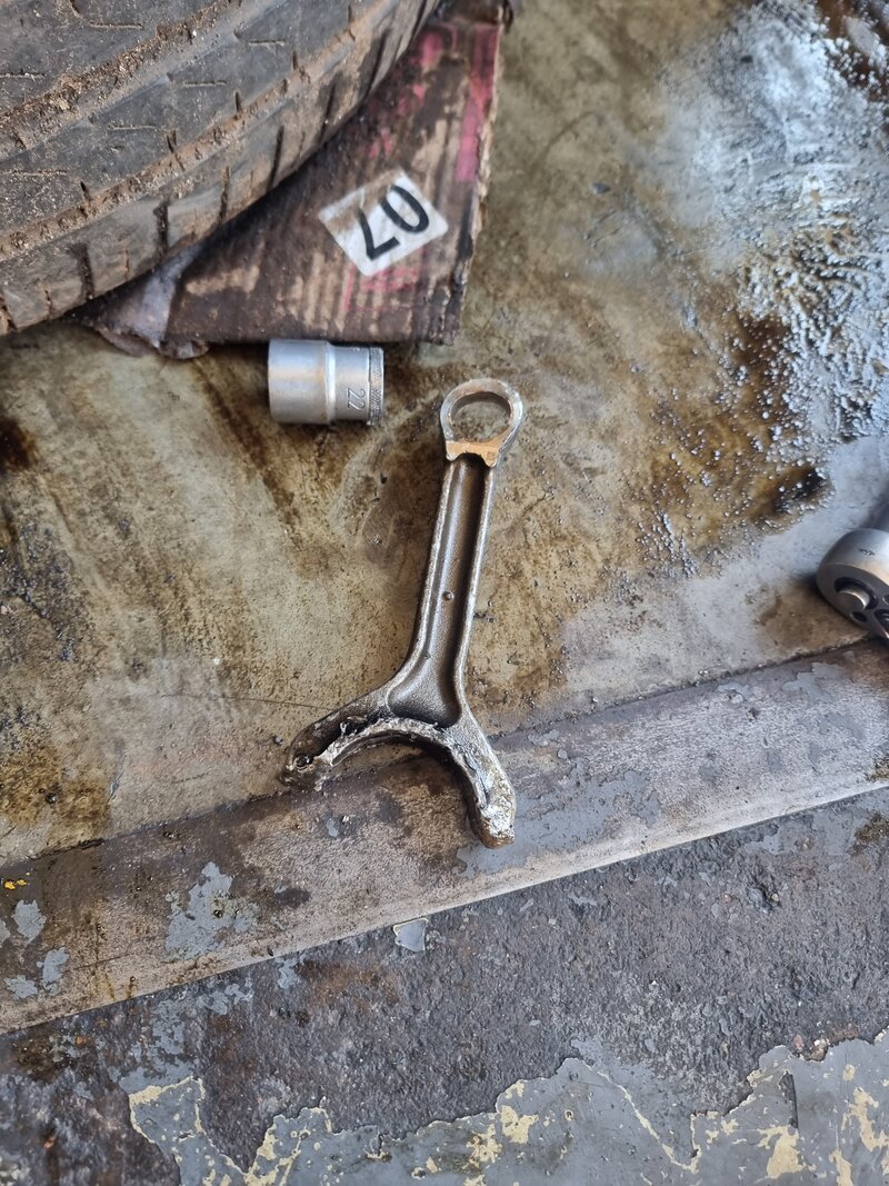

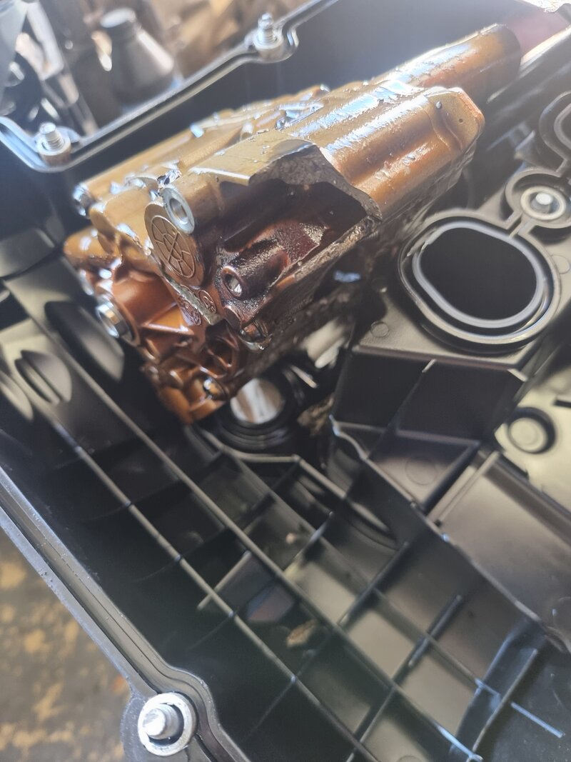

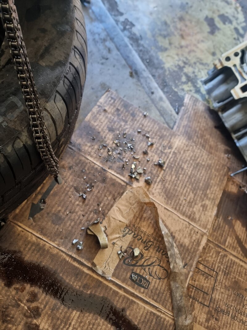

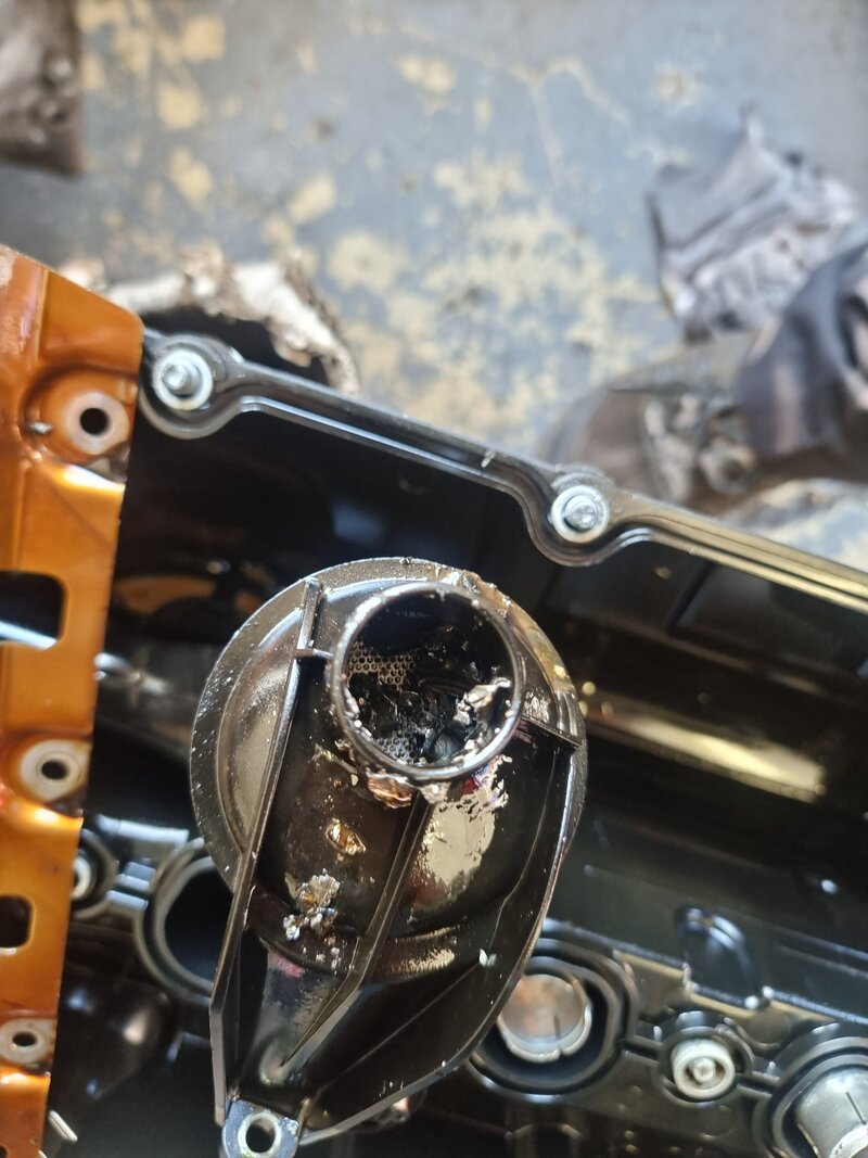

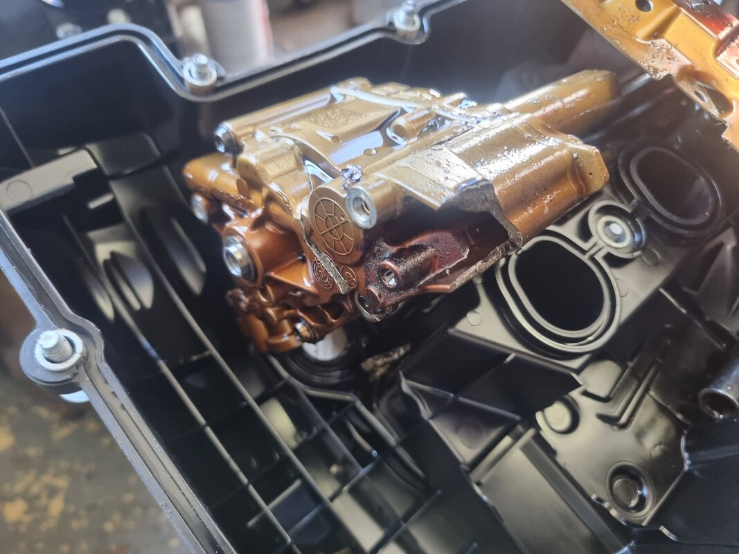

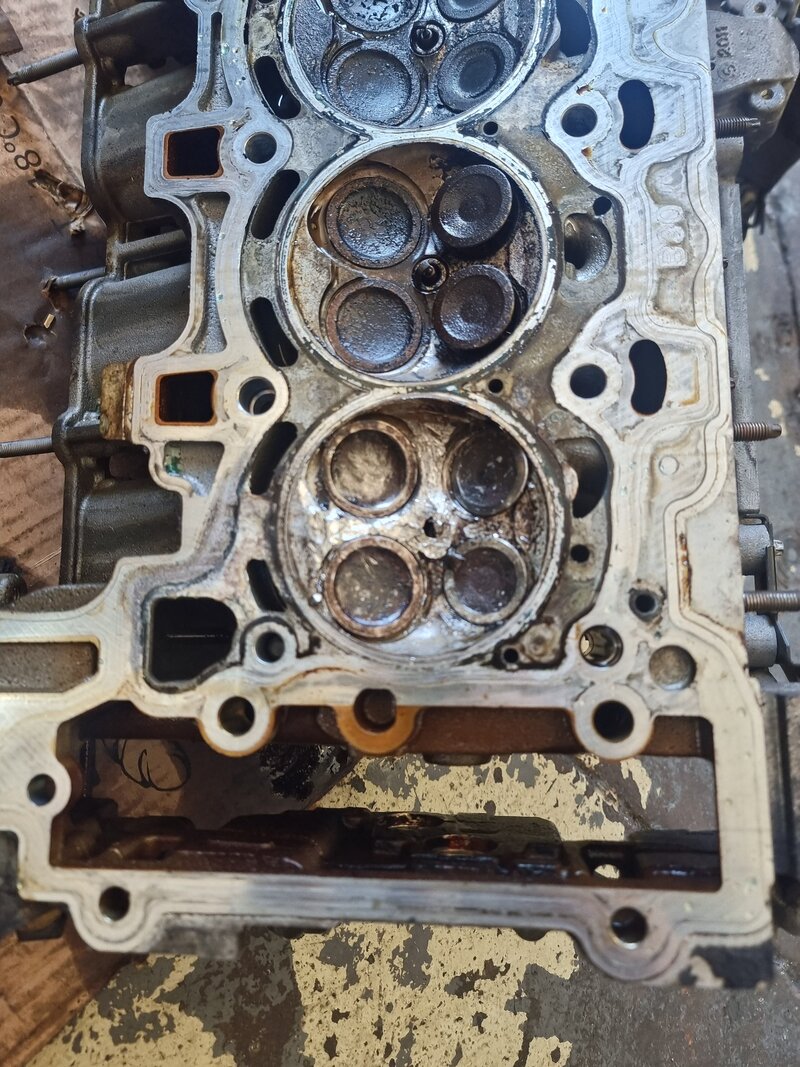

But I finally swung by and checked out my engine, and in essence it is completely done for T_T so I will be looking at an import engine :cry:
In essence - one of my pistons "melted" and essentially shot through the cylinder - my mechanic suspects it was a leaking fuel injector in the cylinder, but we're still not 100% sure exactly what happened here
Says I should have noticed a bit of an increase in consumption for the past few weeks at least - I did, but I was doing quite spirited driving generally so I guess I passed it off as just being being a little heavy footed
But from what was left of my engine, the cylinder is completely done for, piston? Or what's left of it is basically scrap metal oil pump had a section blown off, shiny porridge in my block and filter top of the cylinder also took a bit of a smack by the looks of it
Here's the images πŸ₯²

This turned out to quite accurate, there was an increase in fuel consumption and temp but I do send it quite a bit so I did actually end up attributing to heavy foot
Luckily I had saved up a bit of cash as I was looking to get a e82 N55 135i so basically all that will go to my engine now πŸ₯²
Not much to do except laugh like a crazy person, cry in the dark when I'm alone and drop an import engine in I guess
Usually any little difference I would have at least gotten checked out but I guess I let a little more slide than I should have in the maybe 2 months or so prior to this - I guess I had a few false alarms which lulled me into a false sense if security so I ignored some of the little things
While the school of life does take very heavy tuition, at least I got some on hand experience stripping my engine and a very well learned lesson to not slack off and ignore the little things
