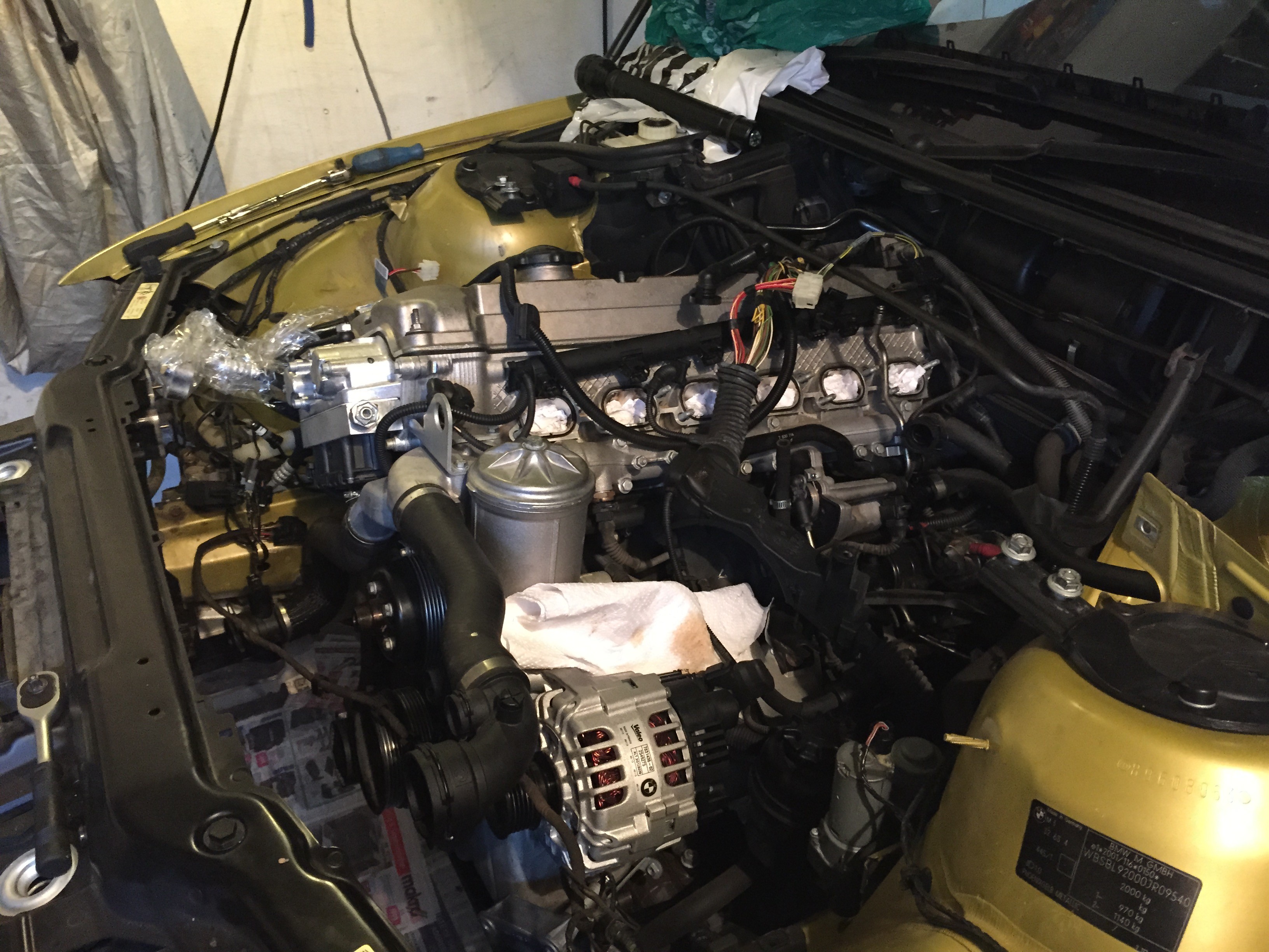

As promised, from uncle Pyotir's page on the engine build, myepic adventure of wrestling the S54 from her perch in the nose of the ///M3 to putting everything back together again...
Prepping to get it out.
thethe
It took me a total of about 4 working days of garage time to put the motor back in and stitch the car back together. It took me 3 weeks of working every day to get it out. I must say there was a total lack of motivation to pull it, as I knew it was going to be a financial b$%tch slap... ;)
The dreaded baboon droppings in the sump...
This was a very emotional moment. You know that feeling you got in primary school when you got called into the principal's office... Similar...
Putting chains on to pull it
