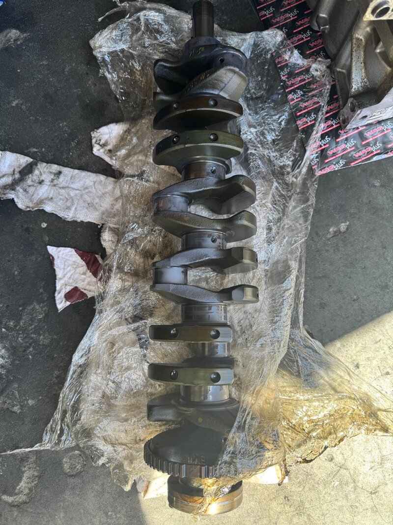

The crank/Rods/Pistons also all checked out. Only 1 conrod needed to be replaced. Crank was even fine.

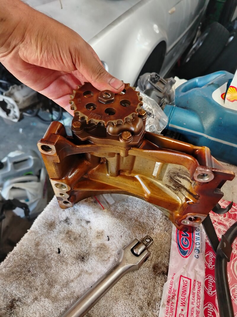

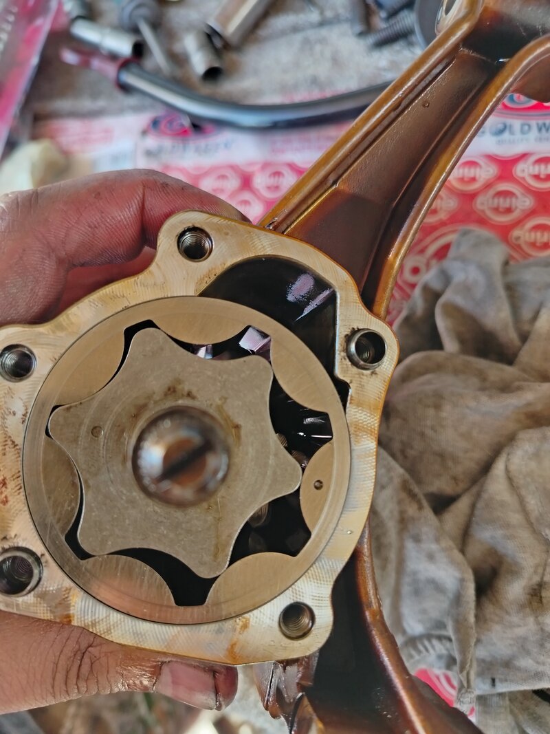

But its the only Guess he has since EVERYTHING ELSE was fine. Even the Oil pump went to Ruan who is also Racing a 330i on track. and He came back confirming oil pressure is Excellent and currently running that pump on his track car. ( i obviously Told him where the pump is from and sold to him for Peanuts. Thankfully it worked out in his favour)

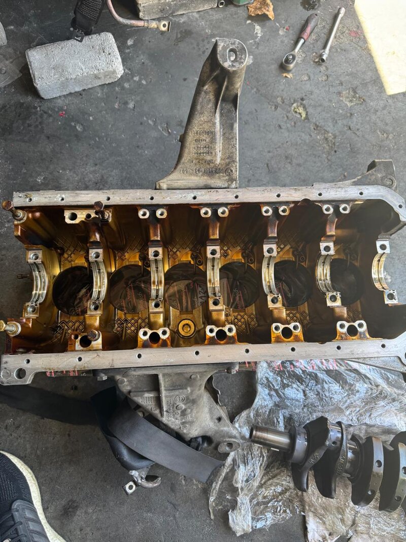

Just to give you an idea on what it looked like inside
Head

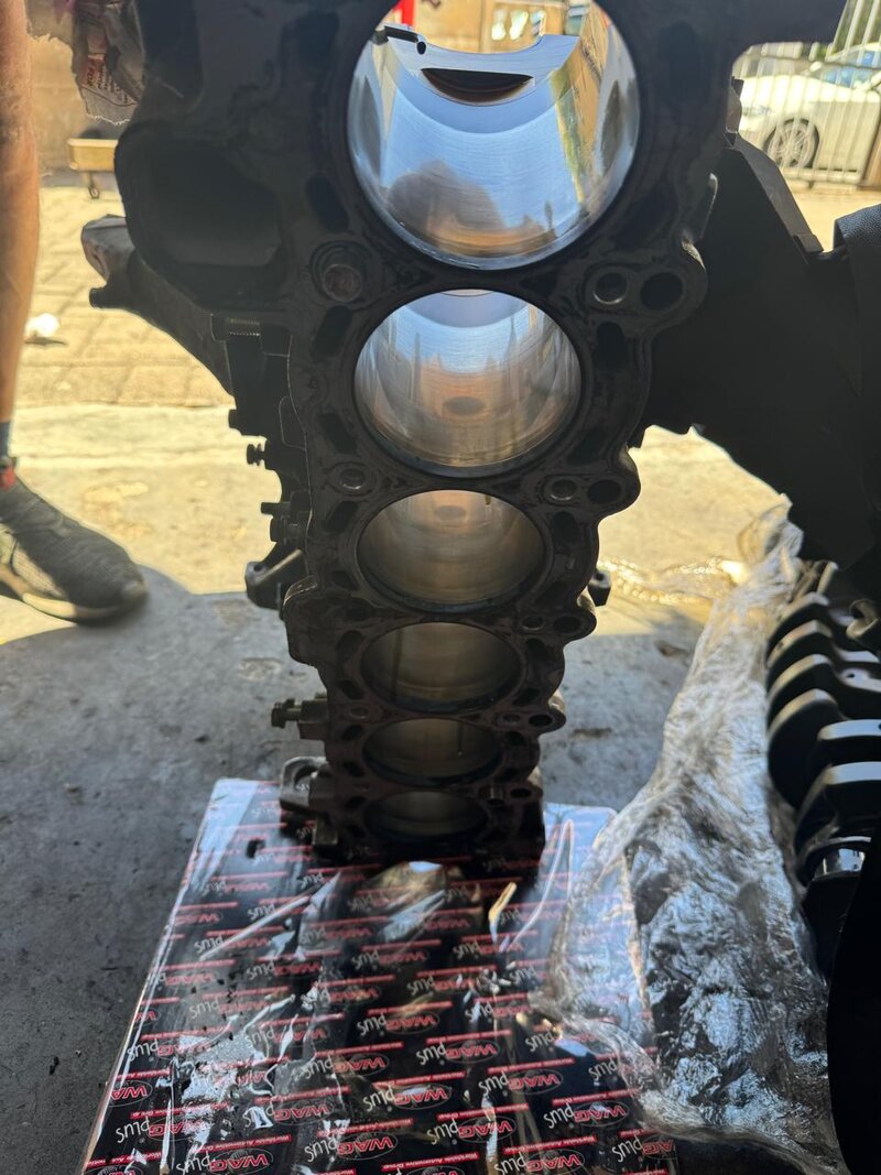

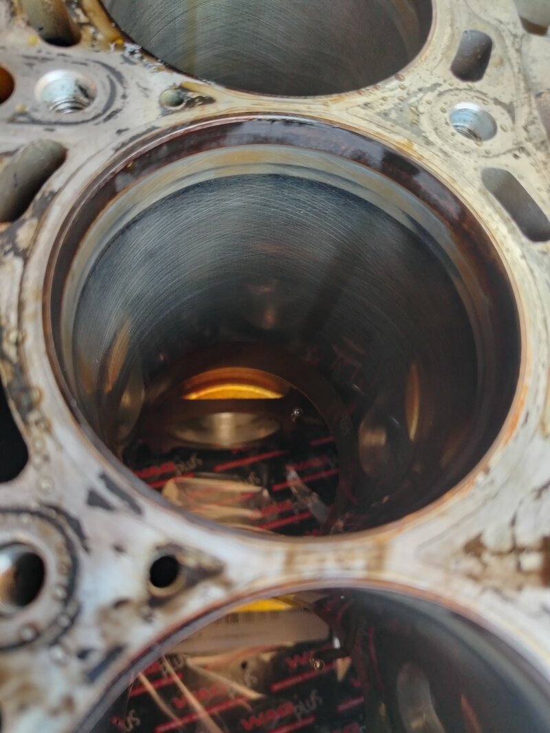

Block (plus Cyl 3 Bore)

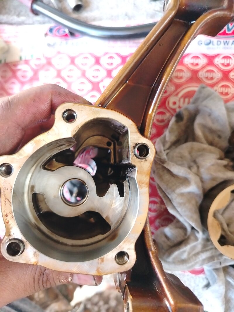

OilPump

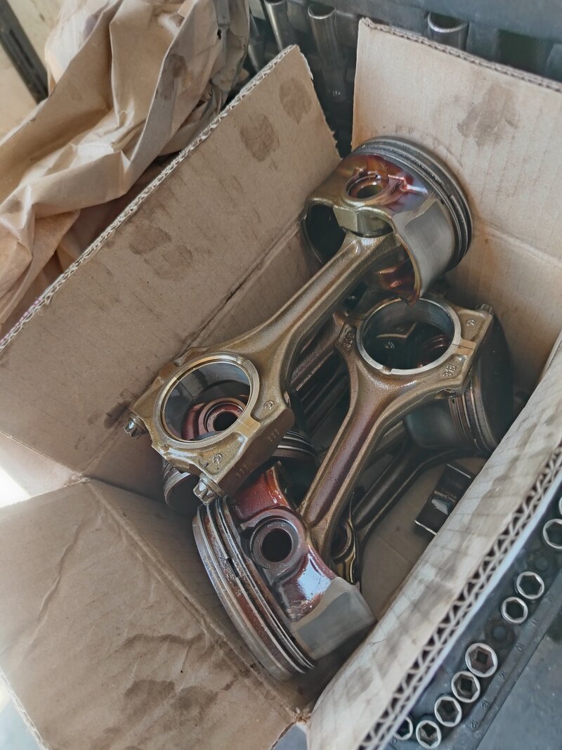

Pistons/Rods
Crank (Assembly Lube on to keep it from Rusting)

Your old motor did use oil? Looks like the oil rings on the pistons were clogged up?

I am surprised that it used so little oil with such gunked up oil rings!
