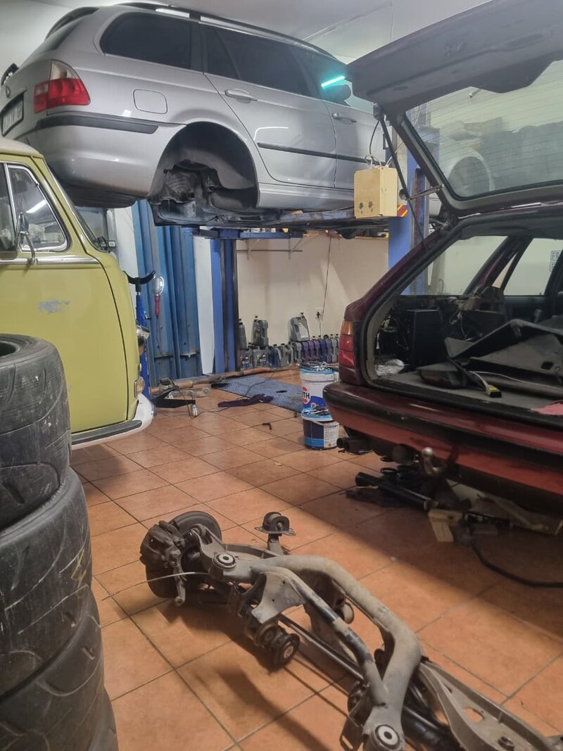

After distractions manifested themselves in the shapes of a L322 and a blown headgasket amongst other things, i finally got around to refreshing the suspension on the E46.
Start off my pulling the subframe

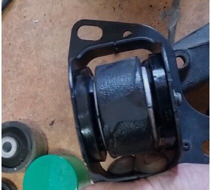

The subframe mount and other bushes were actually in surprisingly good condition considering they have over 500,000km on them:

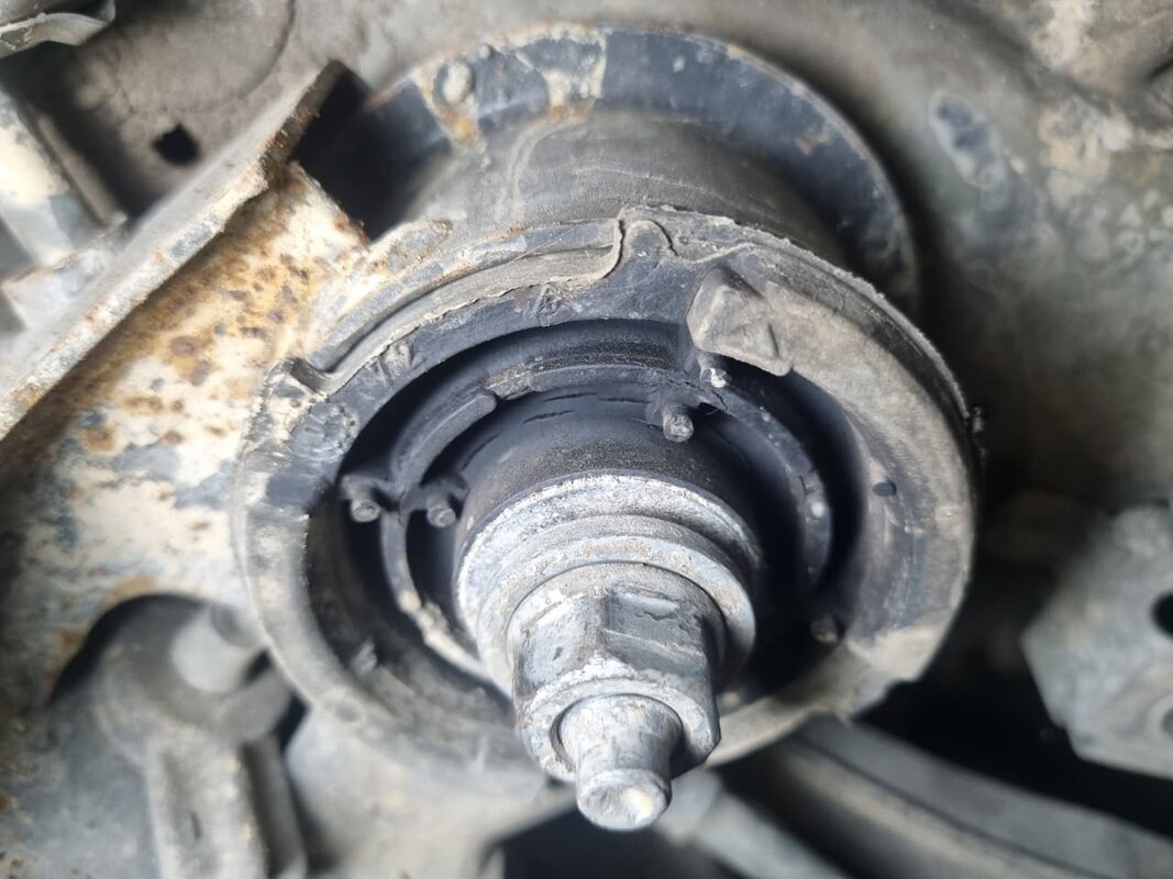

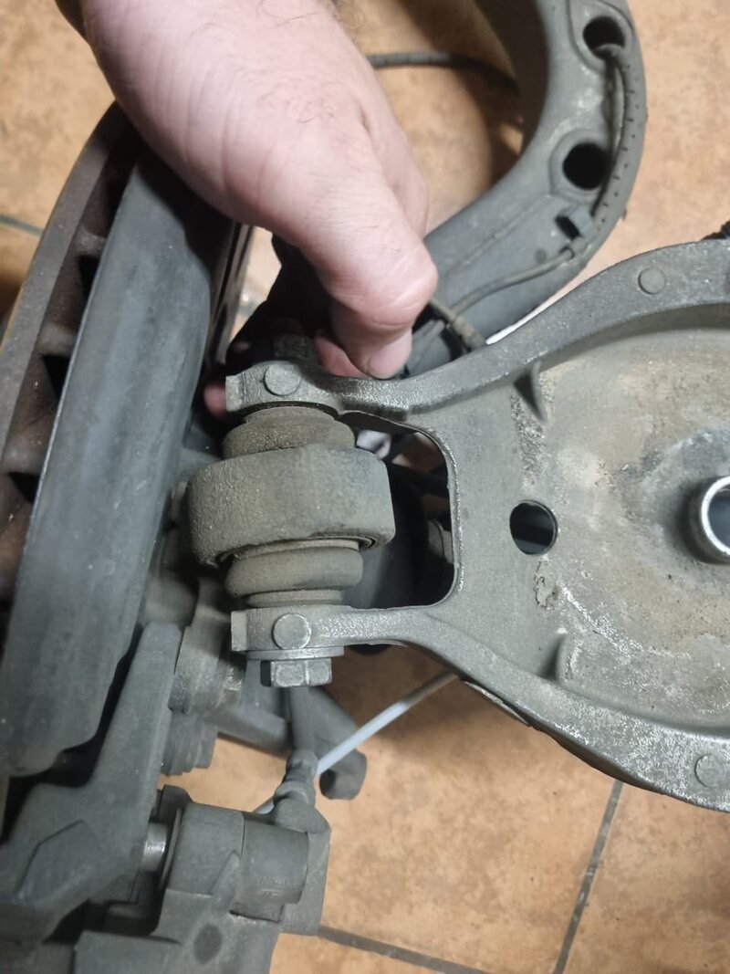

The trailing arm upper balljoint was very worn and had noticeable axial play

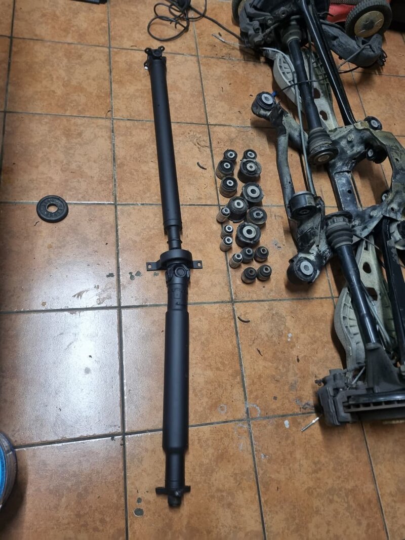

Start "swearing in languages you didnt know you can speak" to remove all 17 subframe bushings. Got the propshaft serviced and rebalanced while it was out

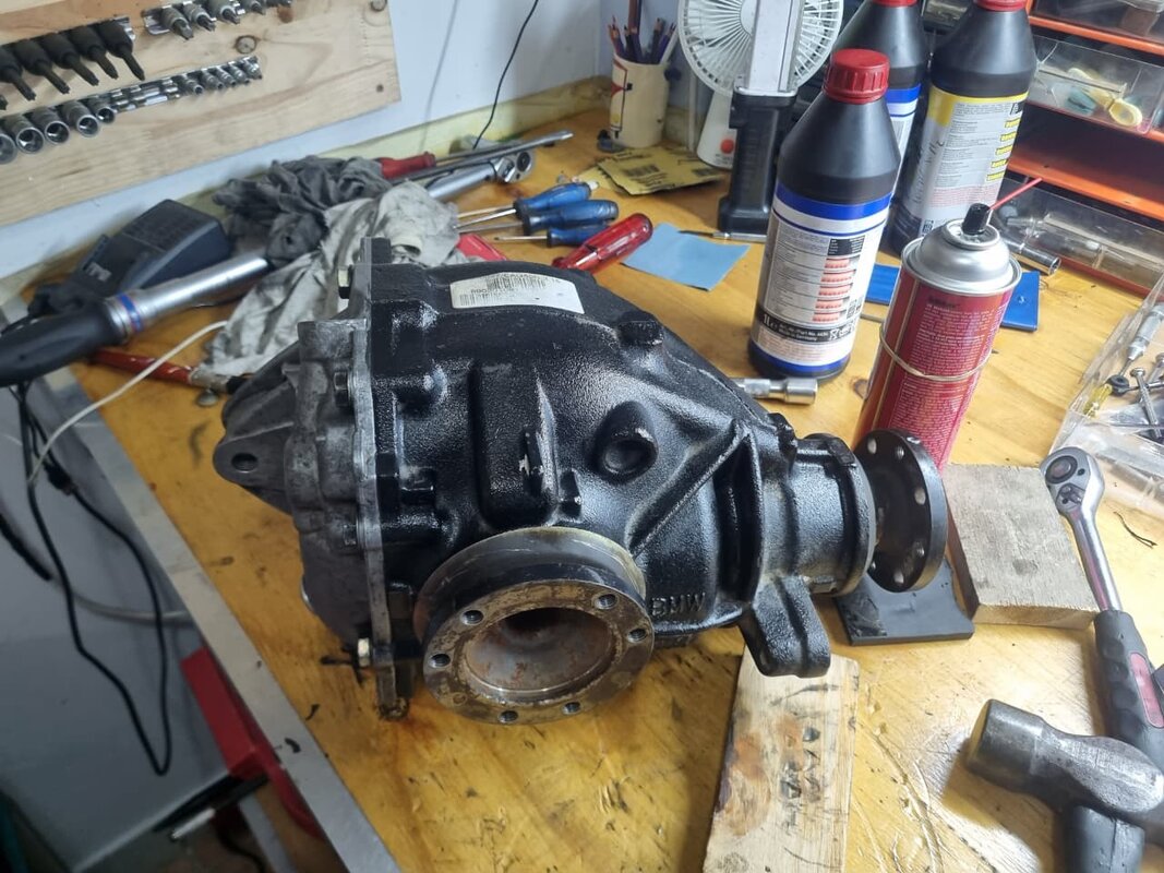

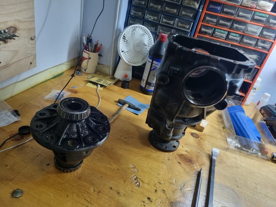

Explode the diff

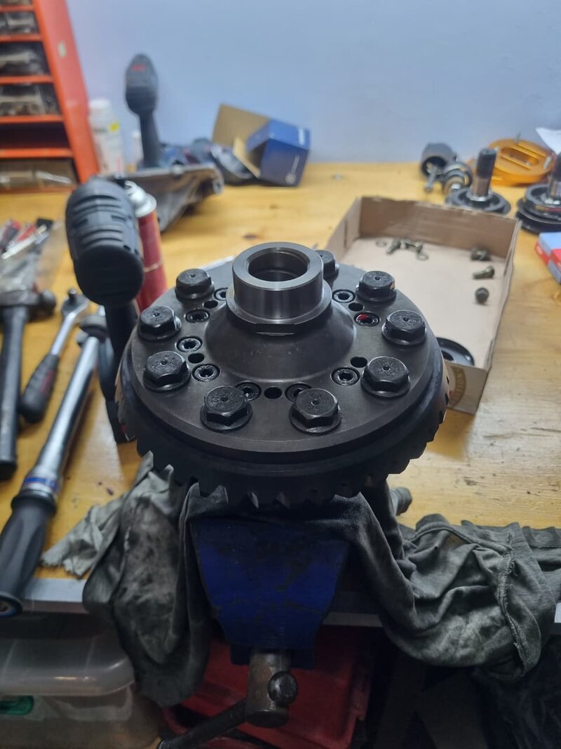

Install Blackline LSD. As far as I can tell, this is a Chinese copy of a Quiffe helical LSD, but it has good reviews, will see how it goes.

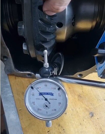

All done, backlash measured at 0.11mm, same as before I removed it, thankfully no shims needed

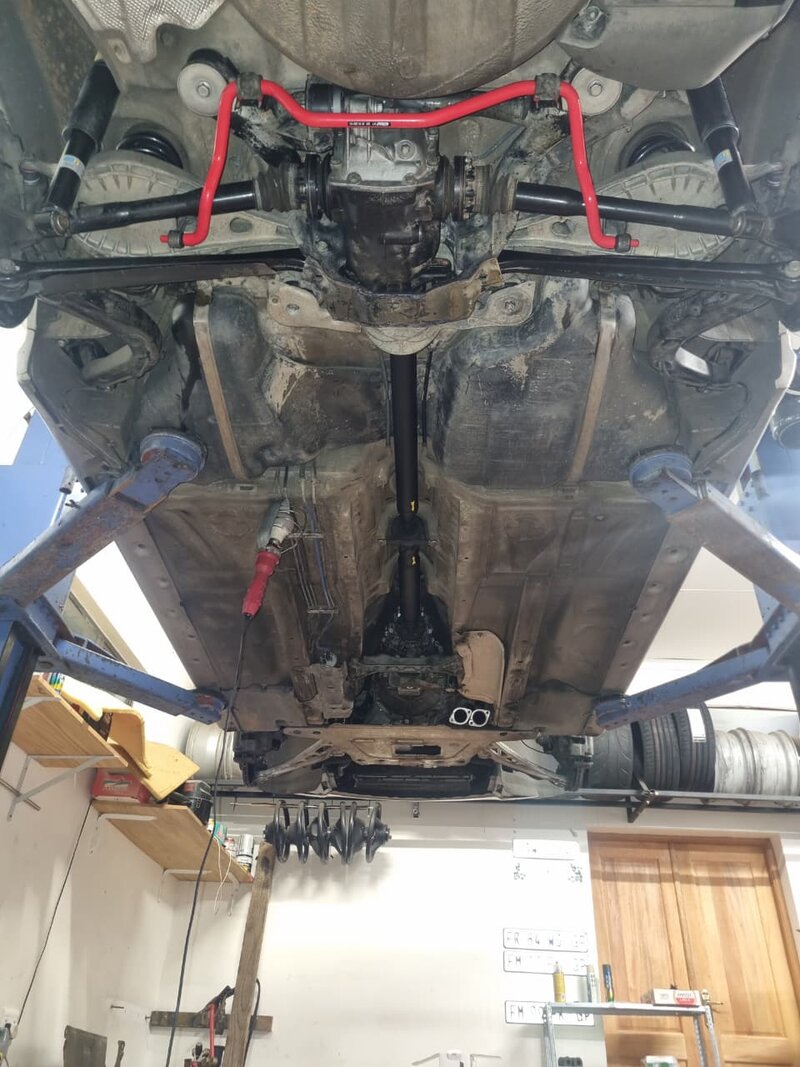

Throw it all back in with a 21mm Eibach stabiliser bar

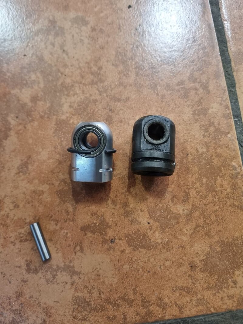

Mandatory side quest: thought I would try this upgraded selector rod joint with a ball bearing instead of a bushing. It has noticeably less play compared to a new OEM unit, quite pleased with it and will be throwing one in all my cars going forwards. Would have been rude not to change the shifter lever bearing and gearbox oil while I was in there.

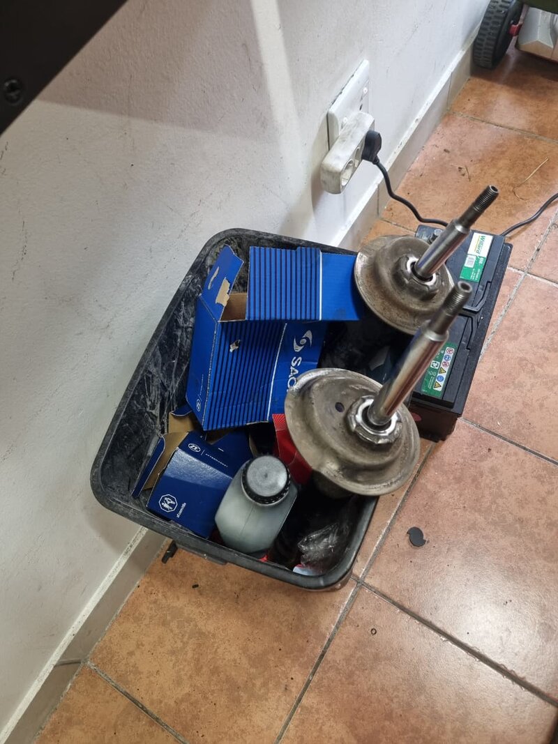

Monroe front shocks in the bin, where they belong

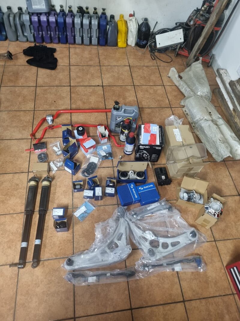

After much deliberating, gnashing of teeth and debating, I decided to go with Bilstein B4 for M-sport which are around R4000 for a set, compared to not-available for B6, 15k for Koni FSD and 20k for OEM. I still have PTSD from how hard the B6s in my E39 are which has ruined that car for me. Weirdly, only the fronts are specific to M-sport, the rear Bilsteins are generic for E36 and all E46 but RealOEM does have different part numbers for M-sport. The rear definetely feels softer than the front tho, maybe it is the extra weight of the touring. I am not sure what I will do about this. Probably nothing.

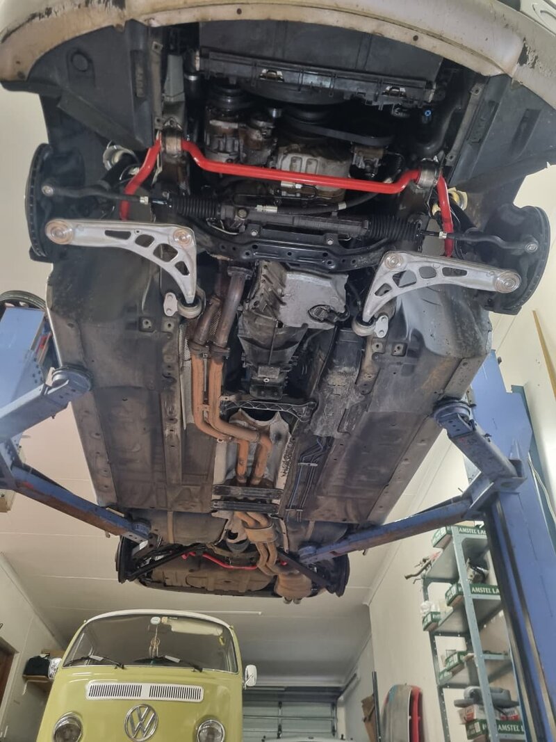

I threw in some E90 ix front shock mounts which supposedly lowers the front of the car by 5mm...but as far as I can tell, my old mounts were collapsed by 5mm...Throw it all back in with matching 27mm Eibach stabiliser, new control arms, tie-rods and stabiliser links:
The eagle eyed reader may notice the rare beast that is a BMW with no oil leaks.

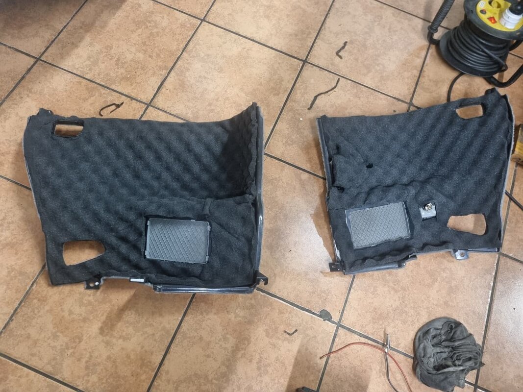

Second side quest: After adding sound deadening to the back of the touring, it accentuated this weird road noise, almost like a door was ajar. I added some sound deadening mat to the front halves of the rear wheel wells (previously only did the rear halves) and some sound absorption foam to the front boot trims. It is weird that the rear trims have a sound absorbing layer, but these front ones dont...

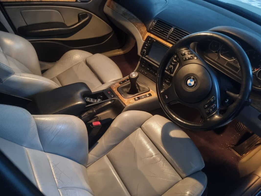

Fourth side quest: Install a black centre console. I prefer this to the grey, I think I will keep it, just need to find a set of black cupholders and rear ashtray

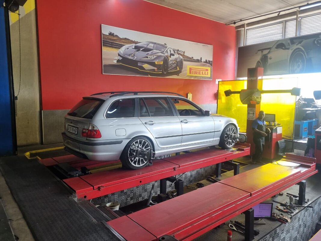

Took her in for an alignment. There is life before LSD and then there is life after LSD...if you know, you know...
Really enjoying it, she will step out in 2nd gear in the dry :devilish: The E39 would only step out in the wet.
Also I forgot how cool this car sounds with the exhaust valve open :cool: As you can see, the front is not any lower really...
