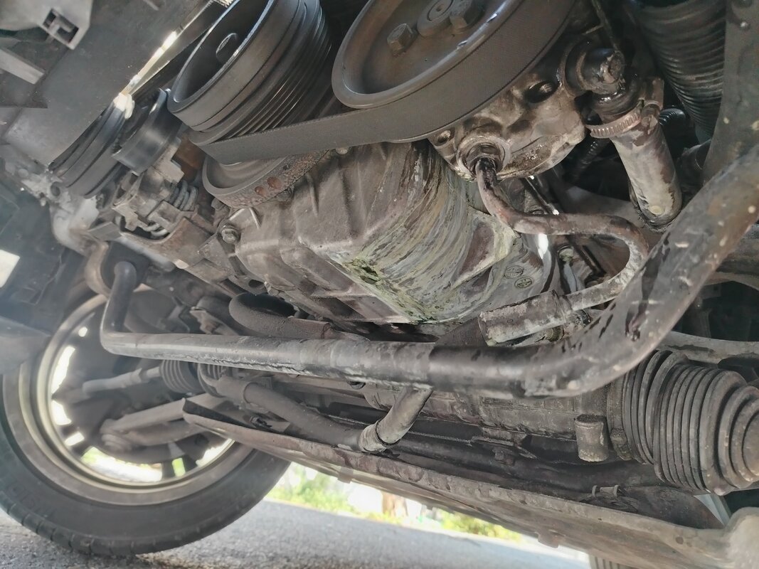

Nothing like blown coolant lines on a Saturday afternoon when The is no chance on getting parts till monday.
Thankfully i was home when i saw the puddle on the floor
the 1 was brand new line i installed when engine was rebuilt (one that runs along the head)

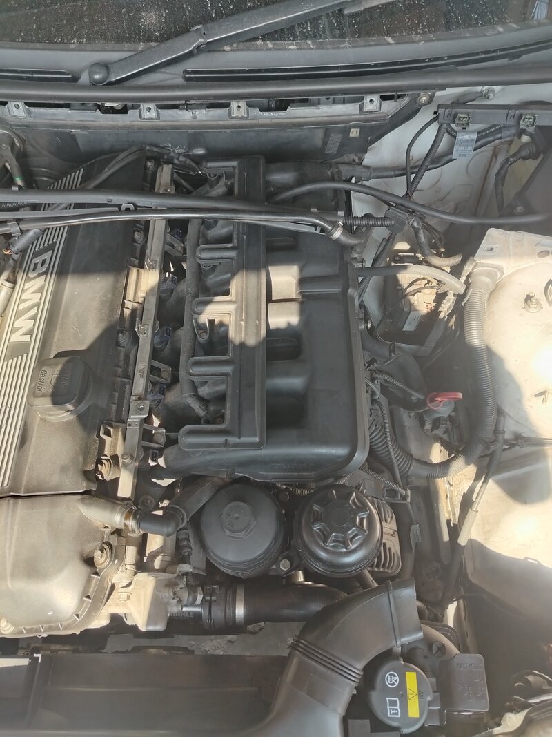

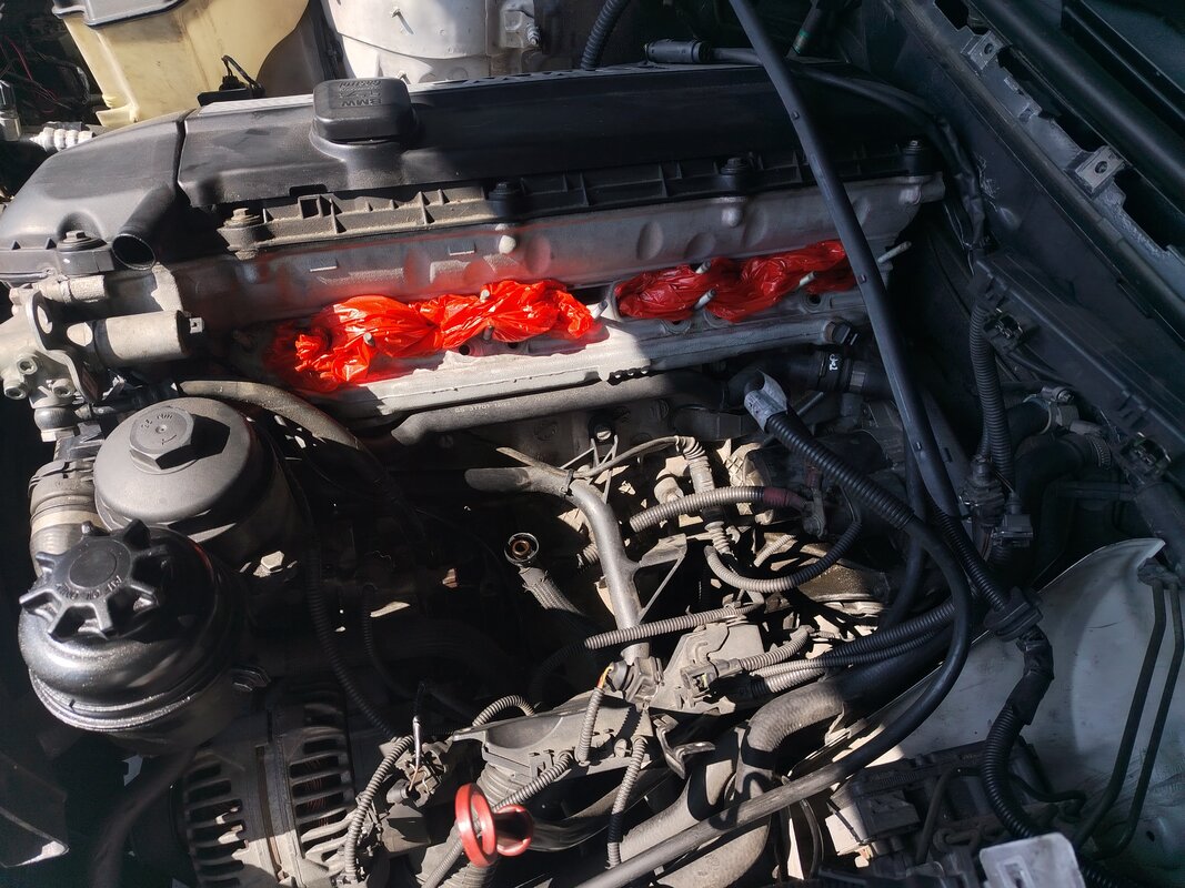

Will tear into her today and pull the intake.
Will use the time to install the new stearing rack boots too thats been on the shelf for some time now.
evnmopwr

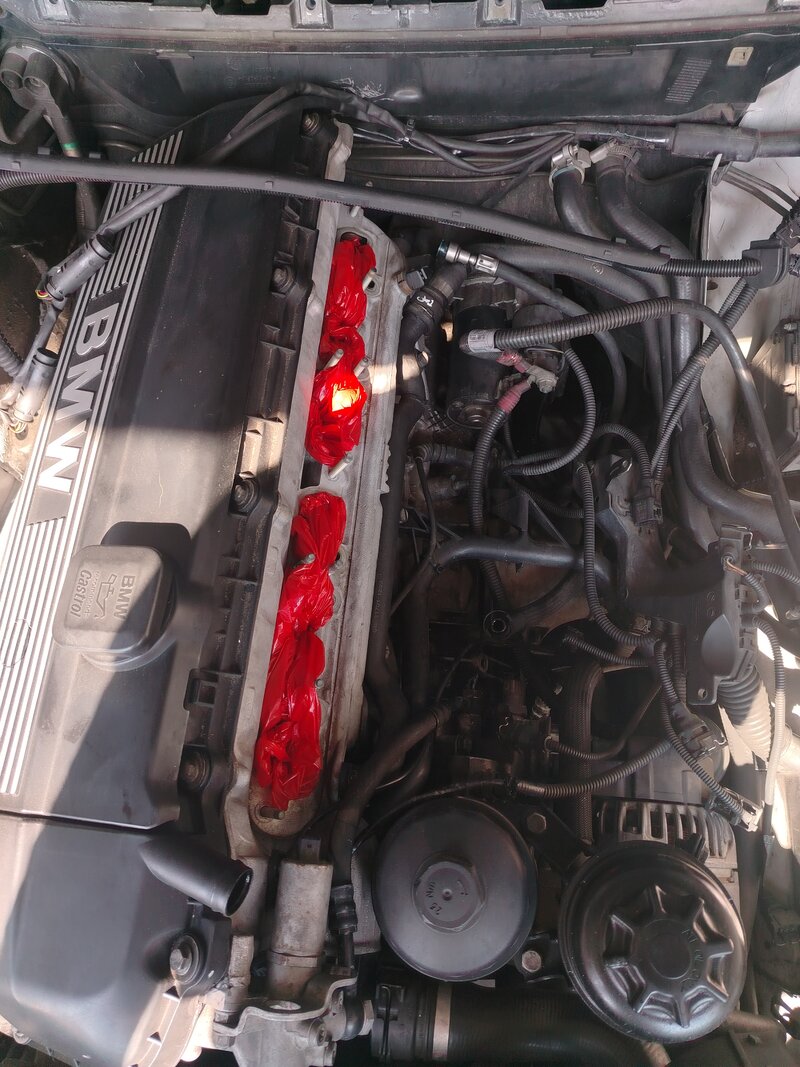

Teardown started
Intake off

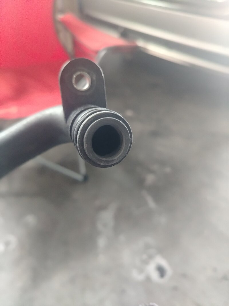

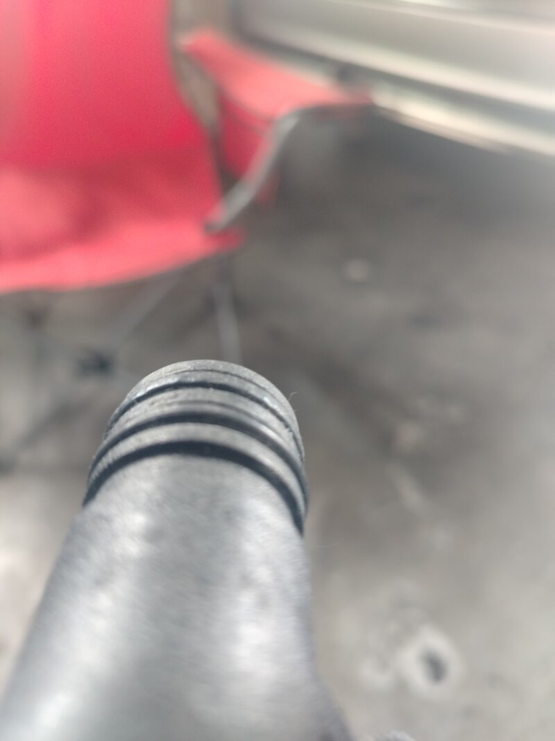

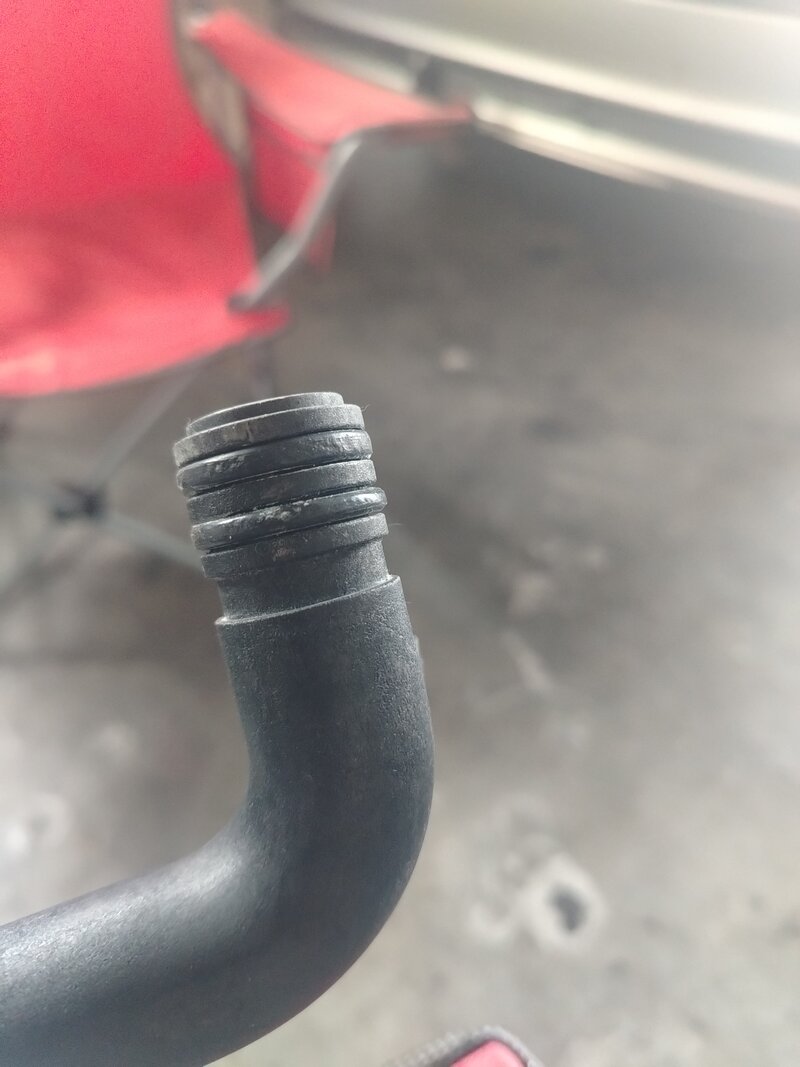

And my guess is the new coolant bottle and new 2.0bar cap preasured system nicely.

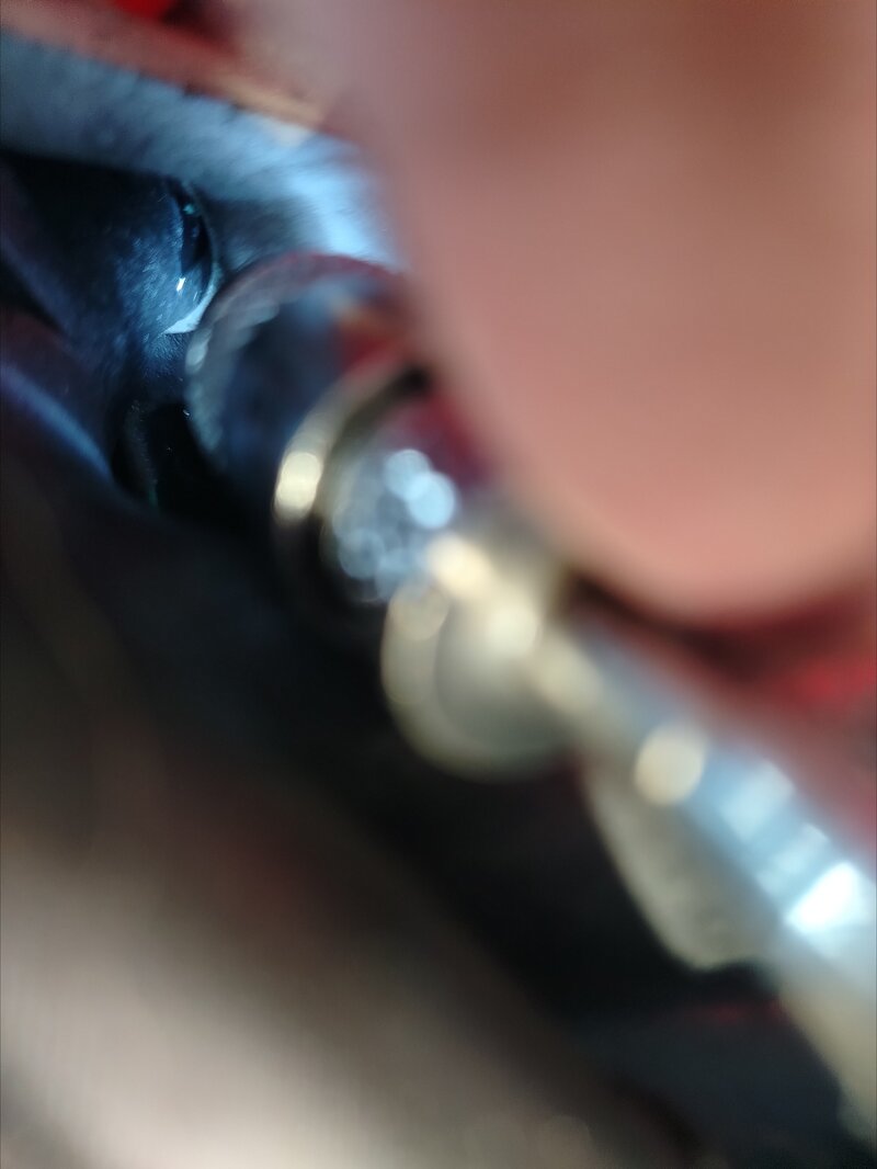

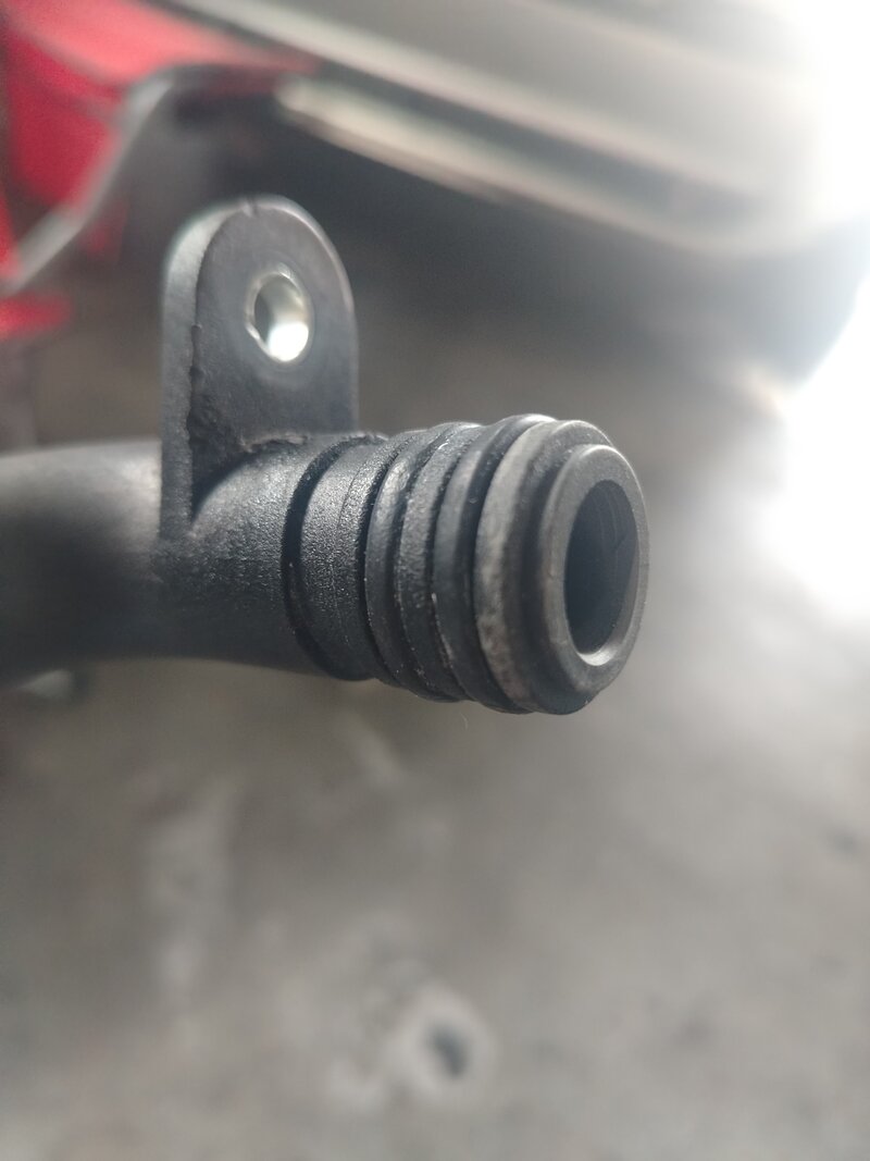

and this pipe backed out??? Not sure if you can see, but the 1 O-Ring is clearly visible. it like it backed out 1cm or so.
bare in mind, Since the rebuild, 19000kmish i replaced the bottle and cap.
Its been 100% ok up until i replaced these 2 items. since then i needed to top up.
Thoughts??
Will order OEM pipes tomorrow from dealer.
hopefully this fixes it as i dont want to take this intake off again

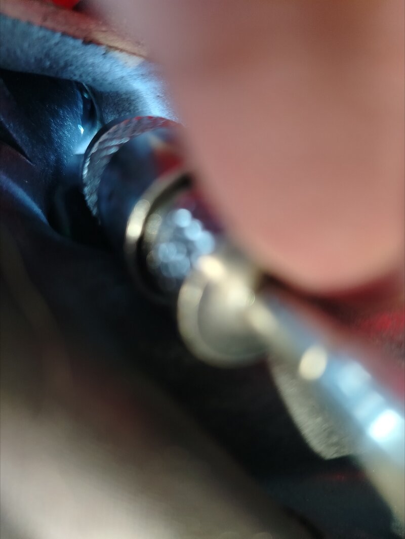

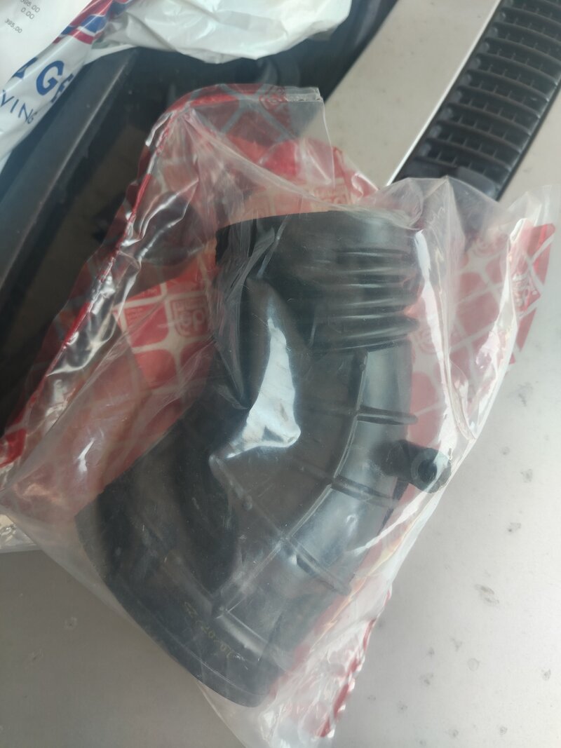

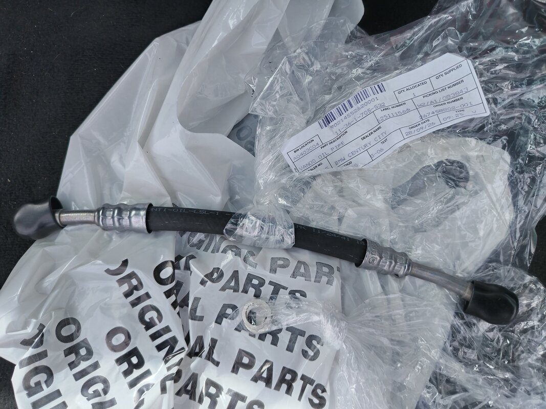

Also I either Found a tear in the upper intake boot or i caused it while removing it and the Vanos line is leaking
so that needs replacing tomorrow too.
2 x Plastic Coolant pipes
1 x Upper Intake boot
2 x steering rack boots
1 x Vanos Line
