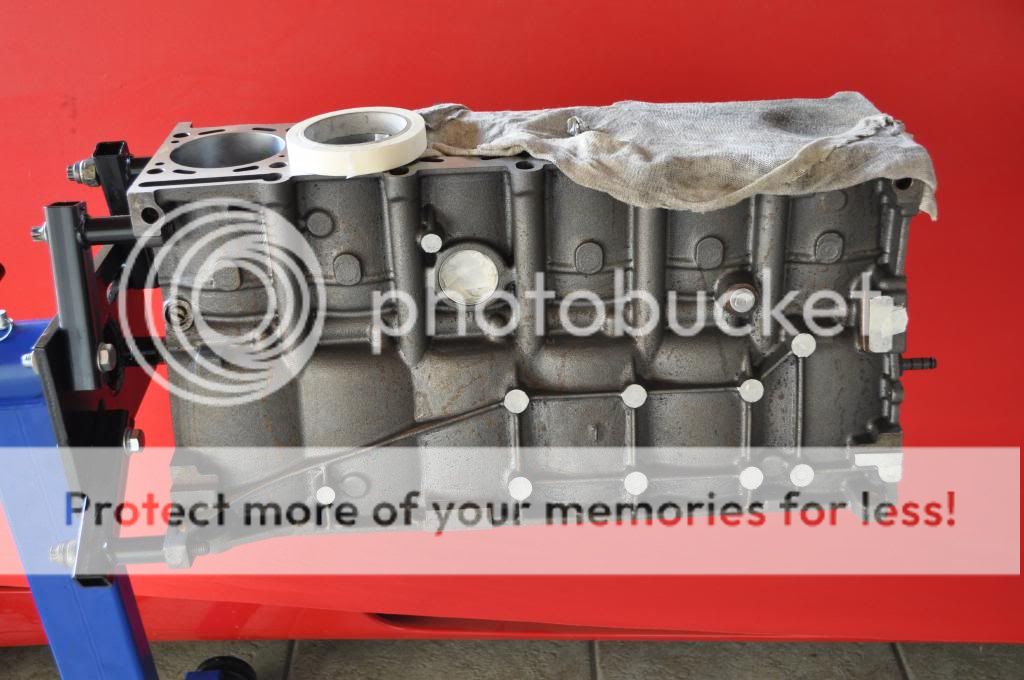

Bare block

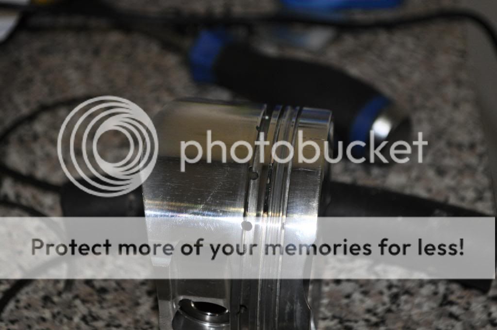

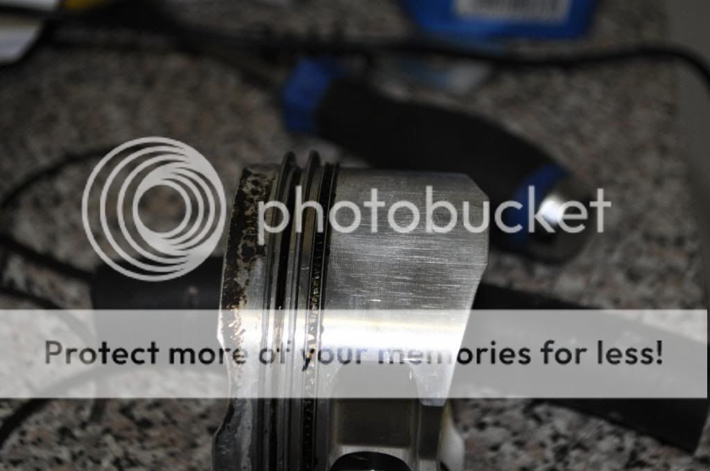

A piston after the first clean and ready for polishing.
Final product ready to soak in cleaner overnight to get the rest of the gunk to dilute from the ring lands.

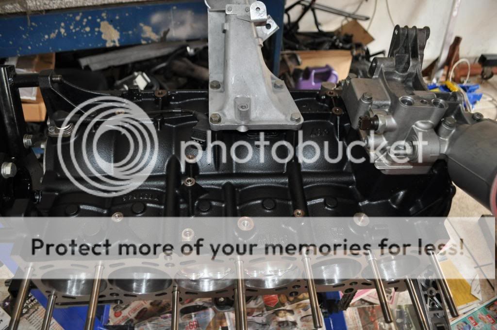

Screwing in the ARP studs.
The angle of the block is correct for ease of screwing in the studs.

Peter you said you use prepsol and parafin for cleaning? Anything else you use that makes i shine so nicely?
Rommies
Thunder said:
Looks really awesome guys.
Yes...called elbow grease :D

Besides that. Any funny cloths or sponges or so?
Peter@AEW
Bruce I use ATF and 2000 grit paper as well as Prepsol and elbow grease.
I think elbow grease is a must.
I then also use a buffing wheel and compound to get the shine.
As with all things moderation is a pre requisite because if one gets carried away one may well end up with pistons that are too small for the bores.
Aluminium in general responds well to prepsol provided it is not left in the solution for a long period of time as it has a tendency to make it black.
