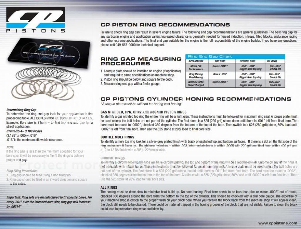

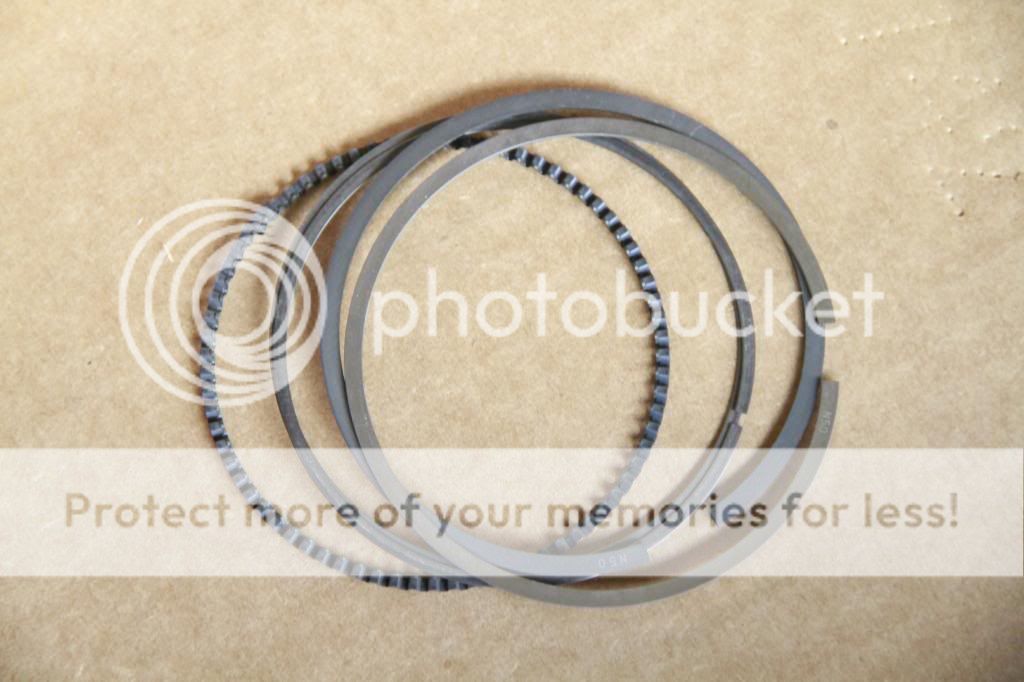

Just wanted to post some info for you guys to see the Piston Rings and how they are set up to work with Jezebel.
Goch & Cooper, who originally did an amazing build on this engine, never gapped the rings. They were too tight and in the end seized.
Peter saw this right away upon opening the engine and knew something fishy was up. After inspecting the old rings and the new ones, he realized they need to be gapped for the car.
I contacted Tony at Vac Motorsports and he confirmed that the rings need to be gaped and emailed me these instructions which I will post below.
Peter has already gapped the rings, as you will see in the video. Without even being told the tolerances from Vac, he had calculated pretty much correctly how much needed to be filed off.
Here are the specifications from CP/Carrillo for the N50 piston rings.
The CP/Carillo N50 piston rings.
moranor@axis
as they say the devil is in the details...
you can have the best parts but if not installed correctly they will not deliver what they should :(
It is even more important to get things right on a build like this because tolerances even smaller... its not like an S54 is a pig iron engine to start with...

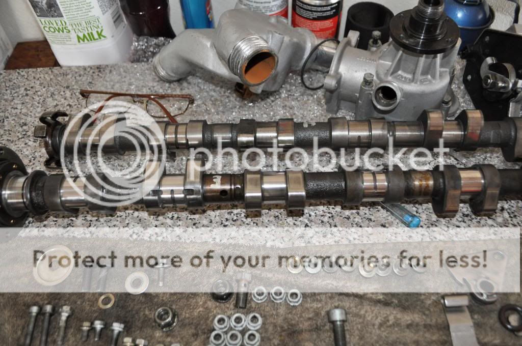

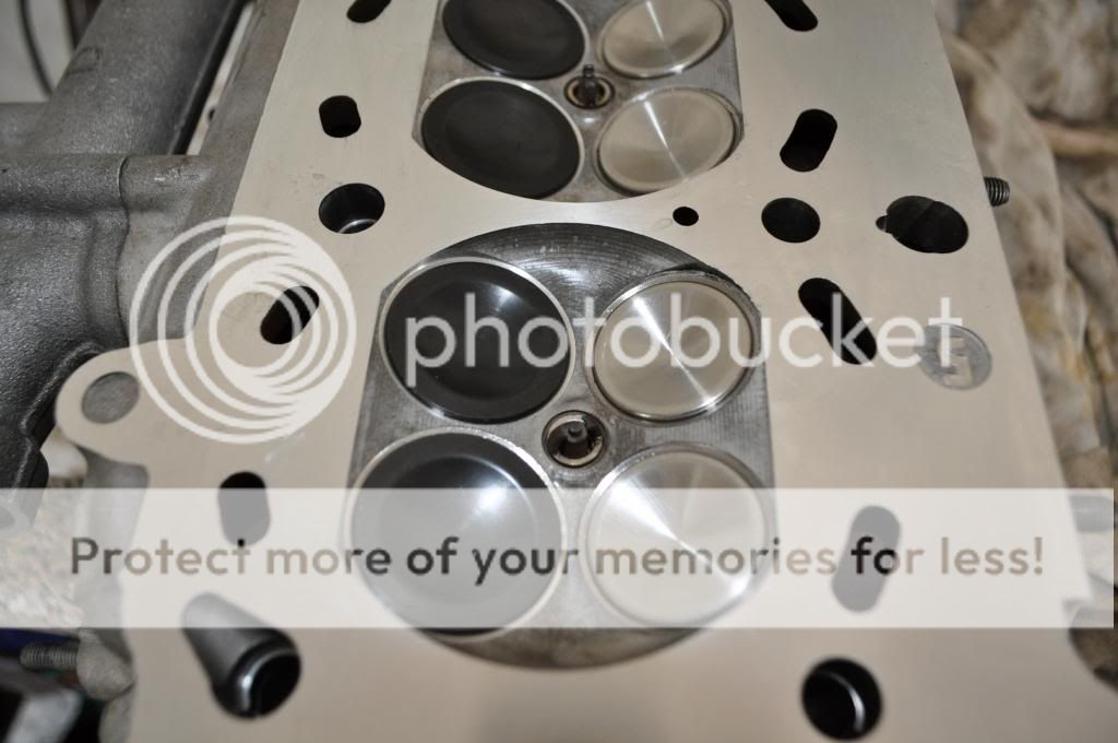

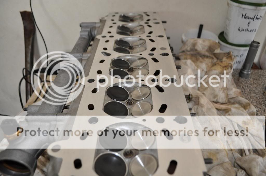

Cylinder head gratuitous pics
Which is the cam with the polished journals?

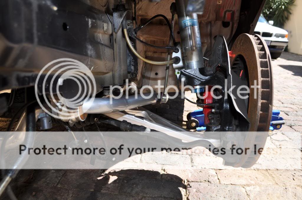

Left front wheel well and suspension after having been cleaned off from oil splutter.
I guess per wheel well the cost must be in the region of R50 000 in performance parts.
Just a guess mind you.

PS. That cylinder head looks great!!! Cannot wait to try out these new Vac valves with the 3 angle cut. That's the one thing I am most excited about.
