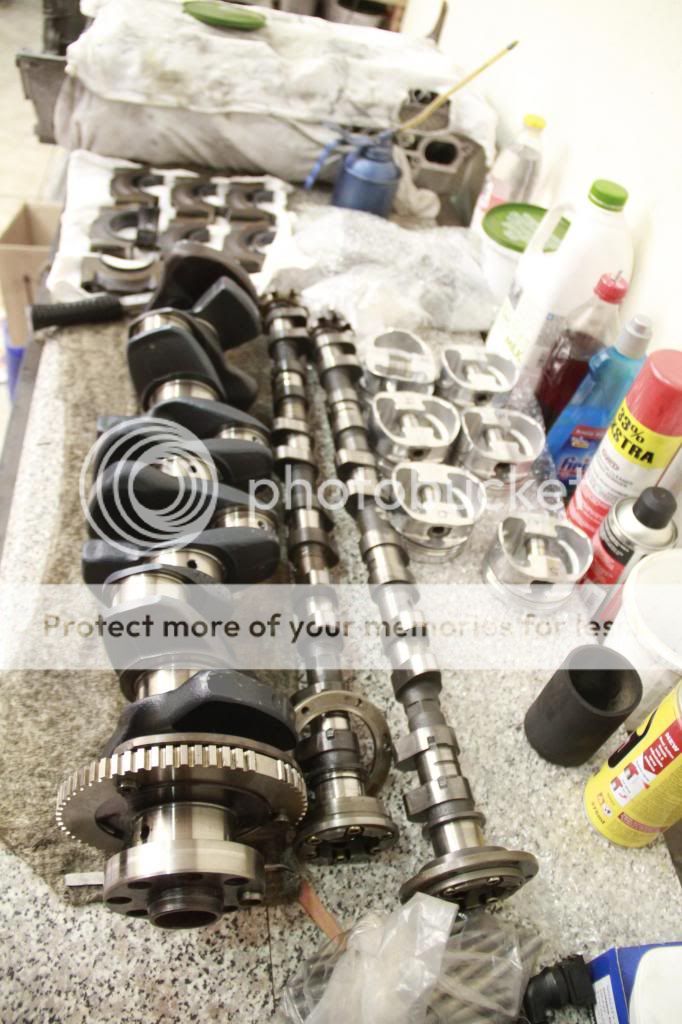

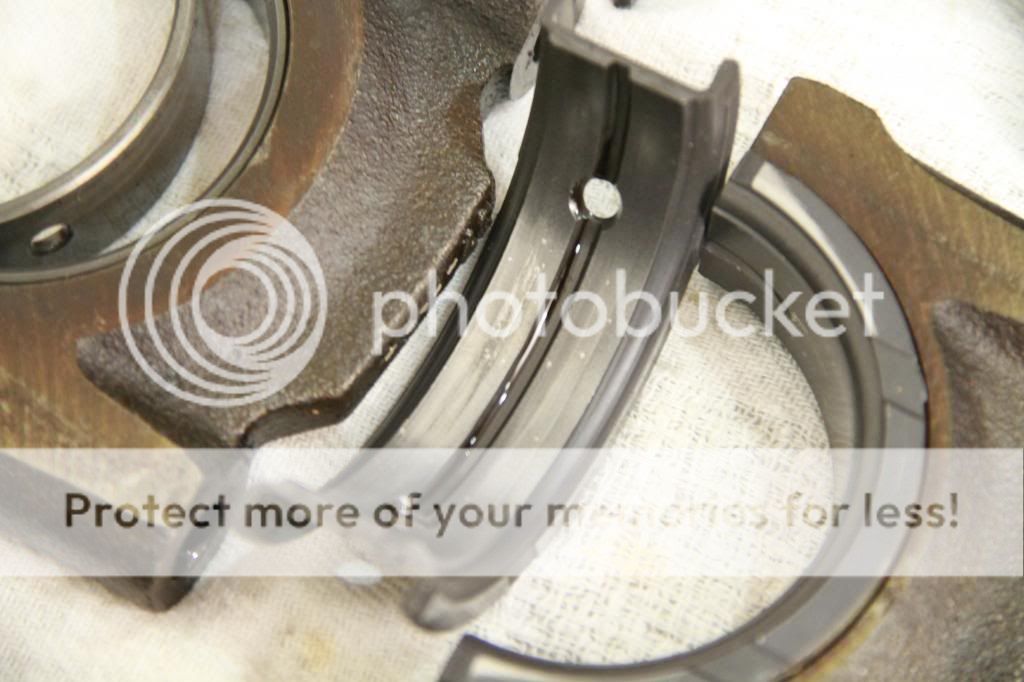

Just finished cleaning pistons and rear main oil seal housing.
Bolts are clean and sorted
Will fit rings just now and the we wait for the manicurist to arrive

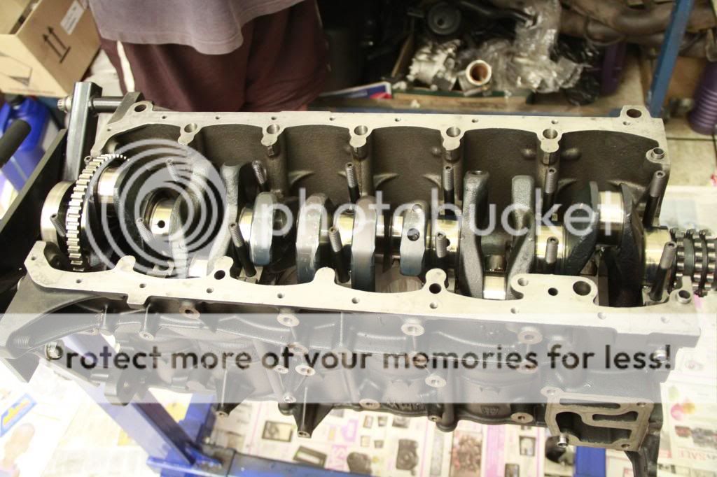

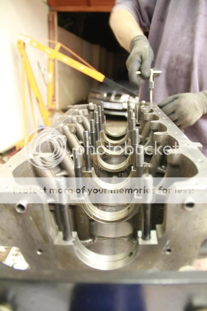

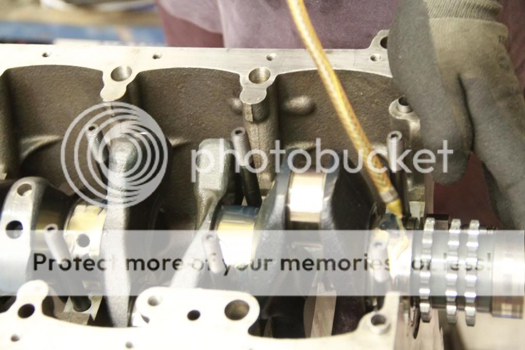

Just finished the assembly of crank and pistons.
Video and pics to follow courtesy of Crash
Crash_Nemesis

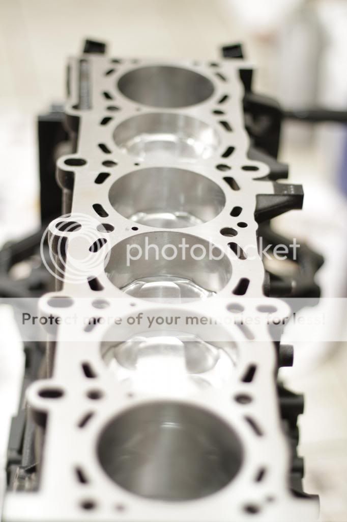

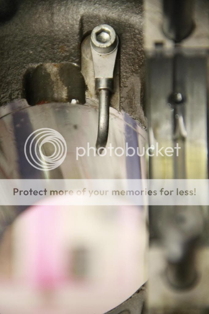

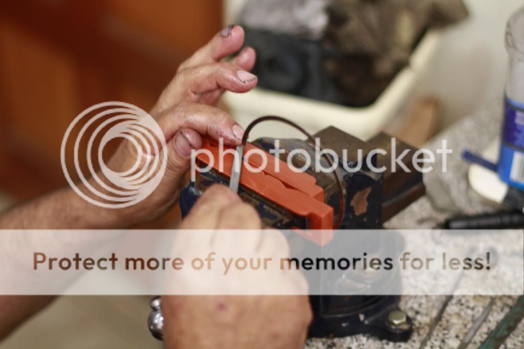

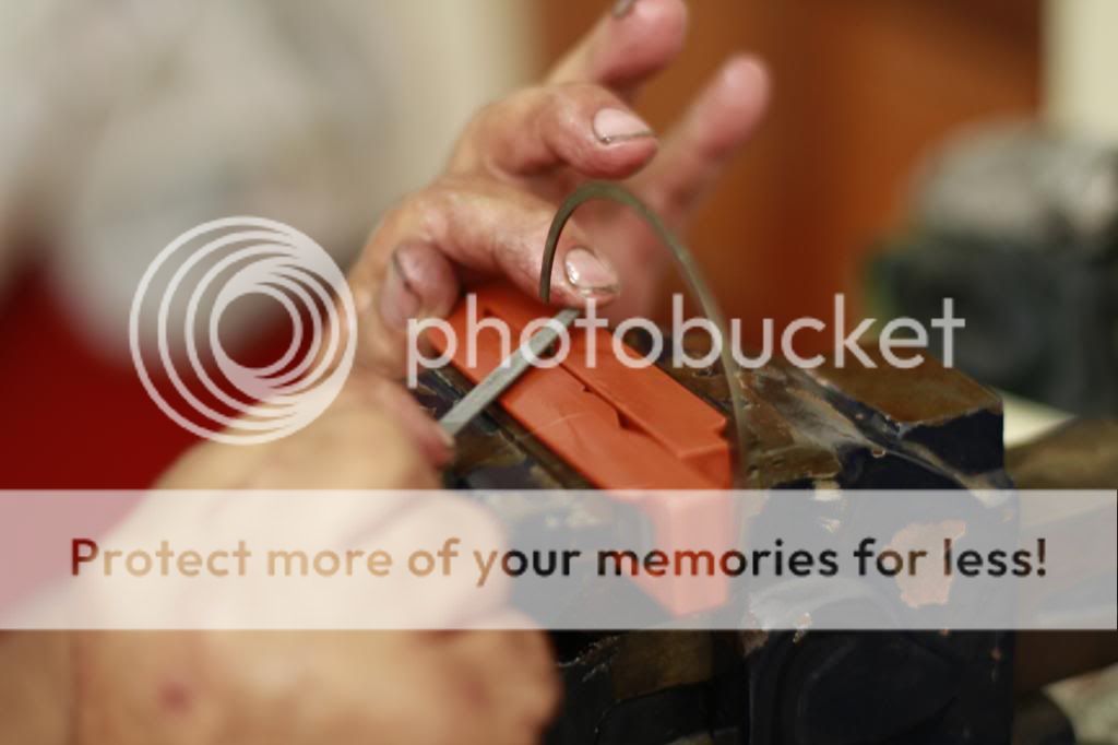

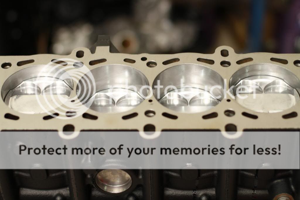

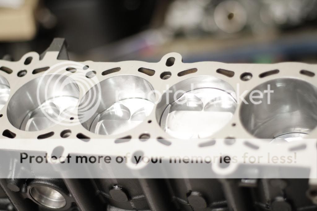

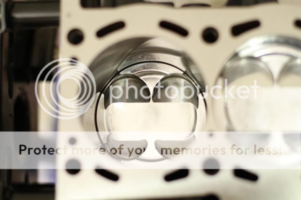

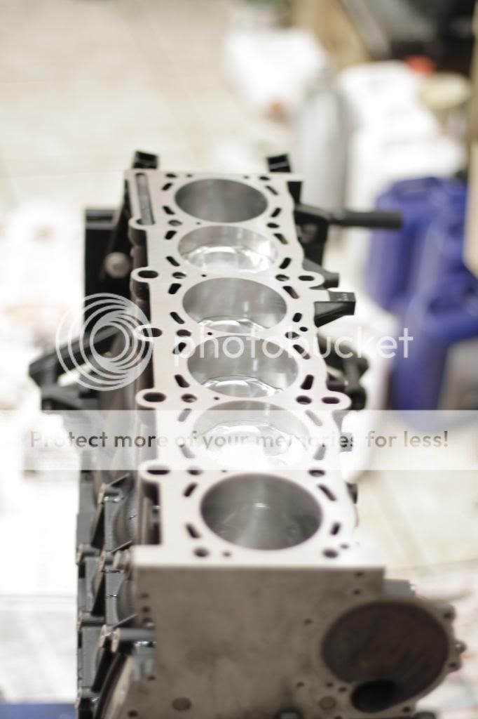

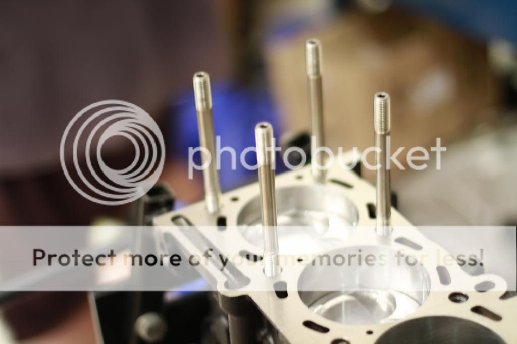

Here be some photos.... I've put them on Photobucket so Peter's machine doesn't blow up. It seem's to not like IMGUR.

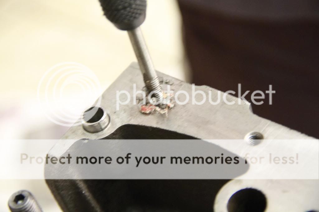

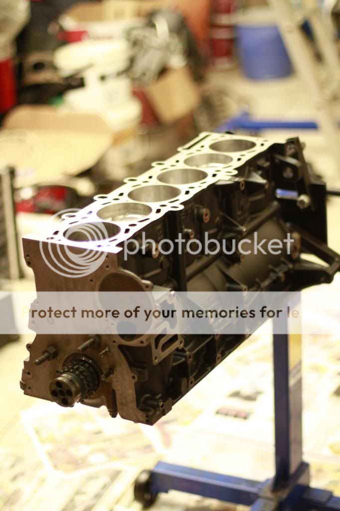

Even though the Head and Block were Acid Dipped to get rid of excess silicon, Peter still had to try screw some out.

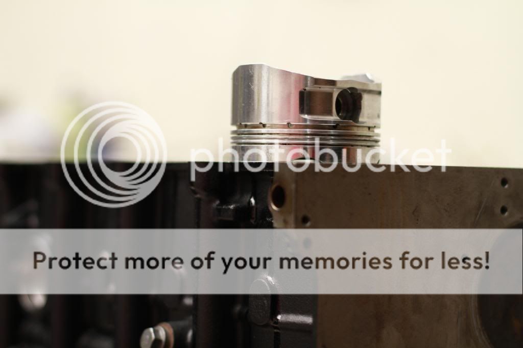

CP Forged Piston

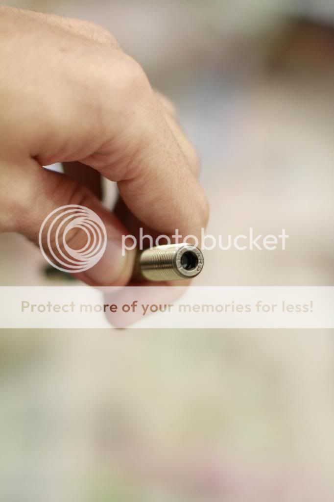

ARP L19 Head studs/Bolts

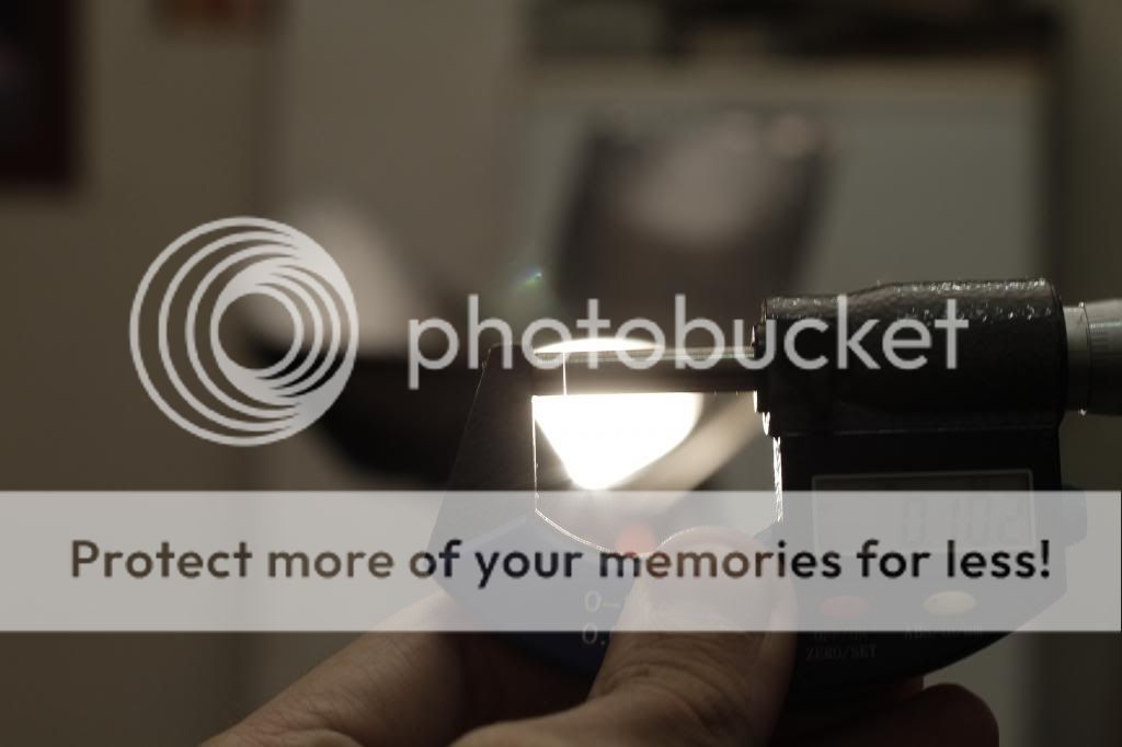

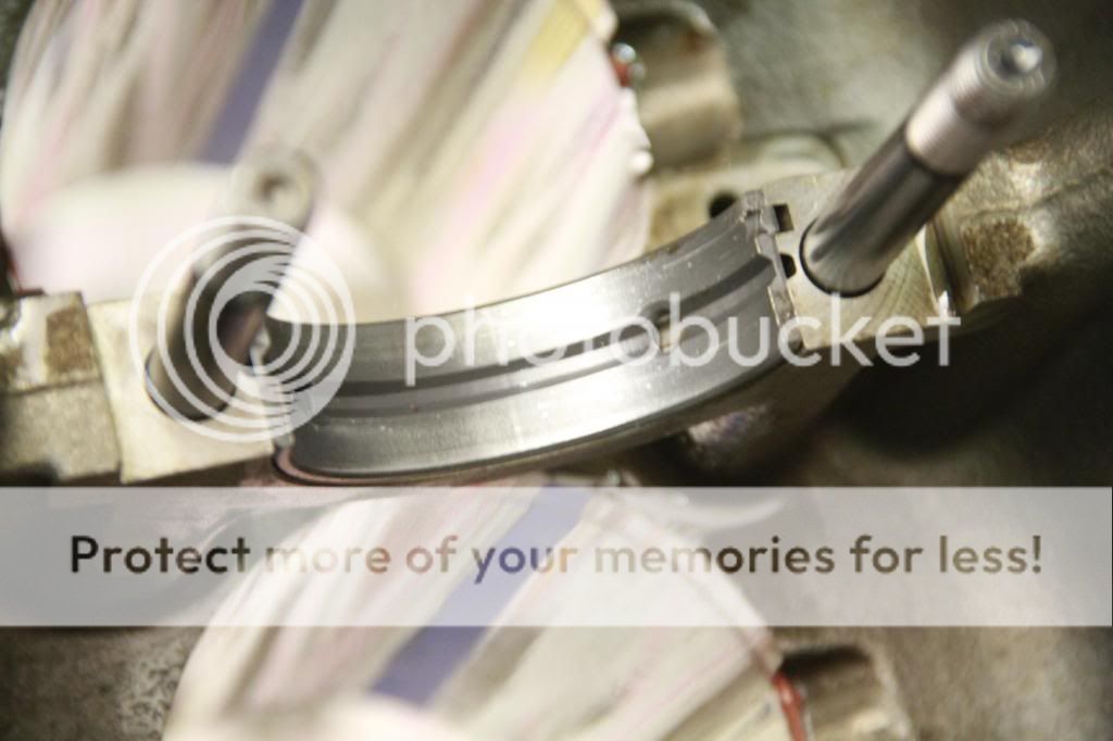

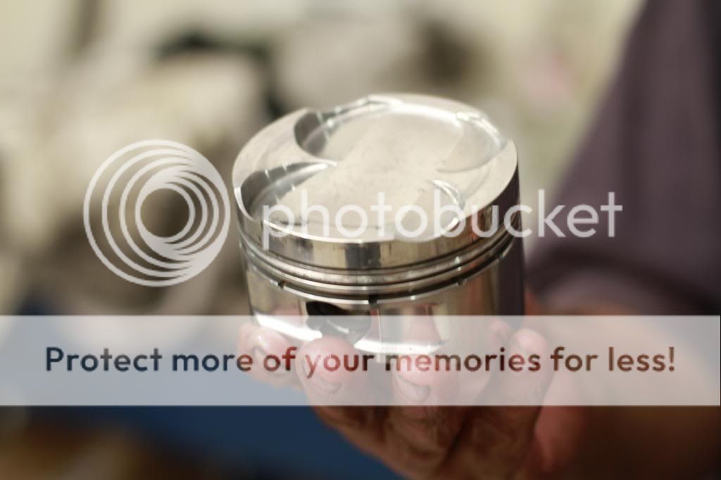

Checking Piston Ring sizes.
Filing down the piston rings to get the gap within acceptable tolerance
The gap that was filed out of the piston ring to get it in tolerance
