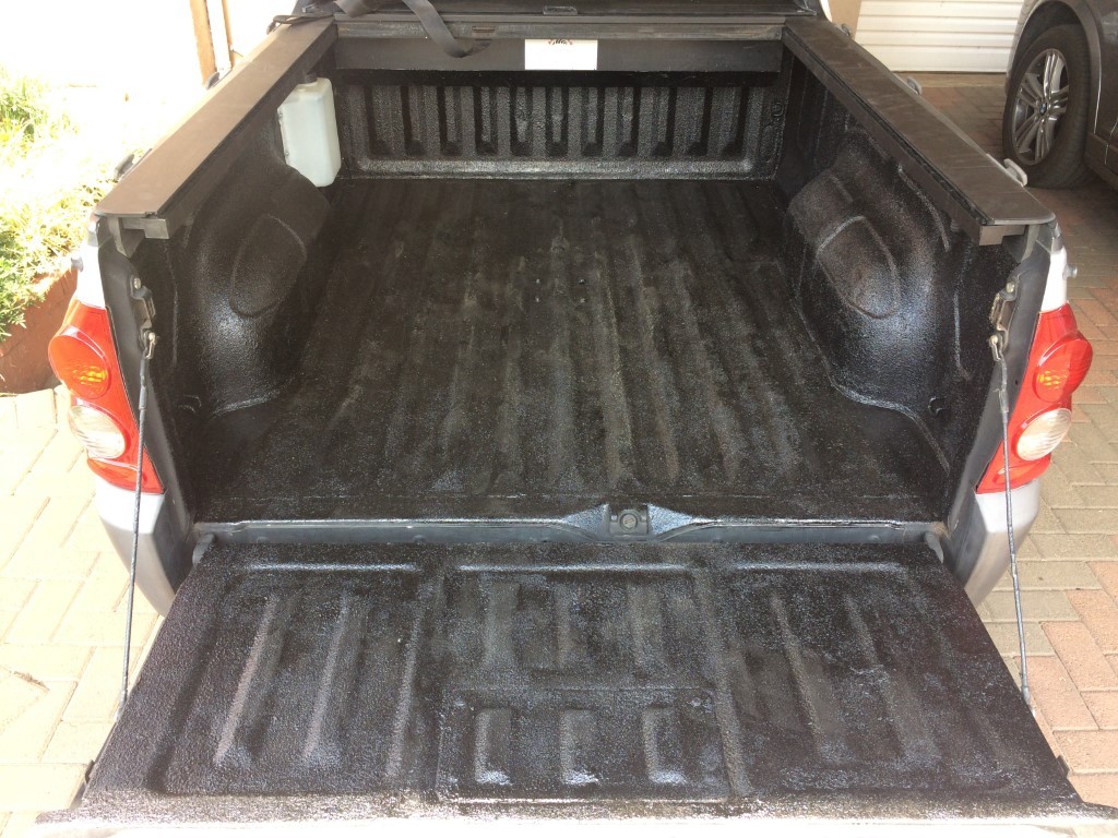

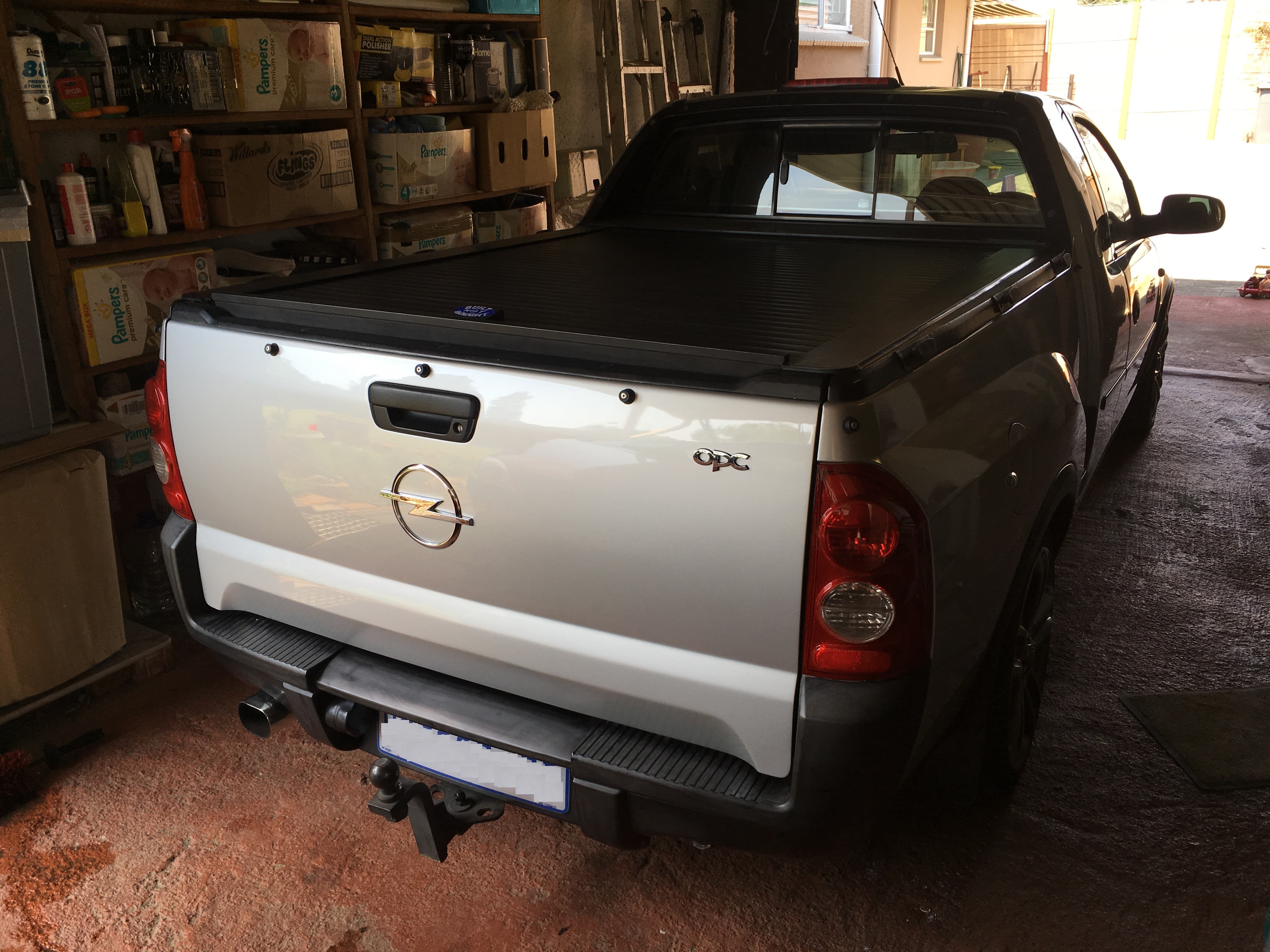

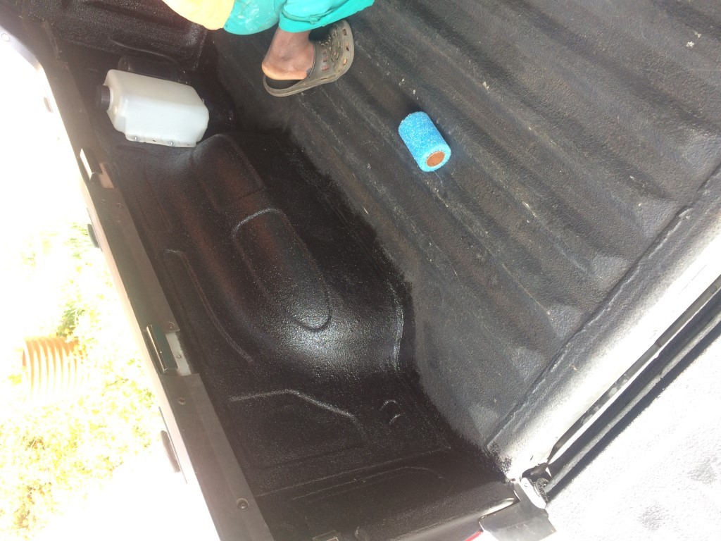

I decided it was time to give the load bed a refurb. The Durabak which I used has been lasting really well, so this was more a refresh than anything else. I only did 1 coat this time round.
Some pics of the job in-progress and then the end result:

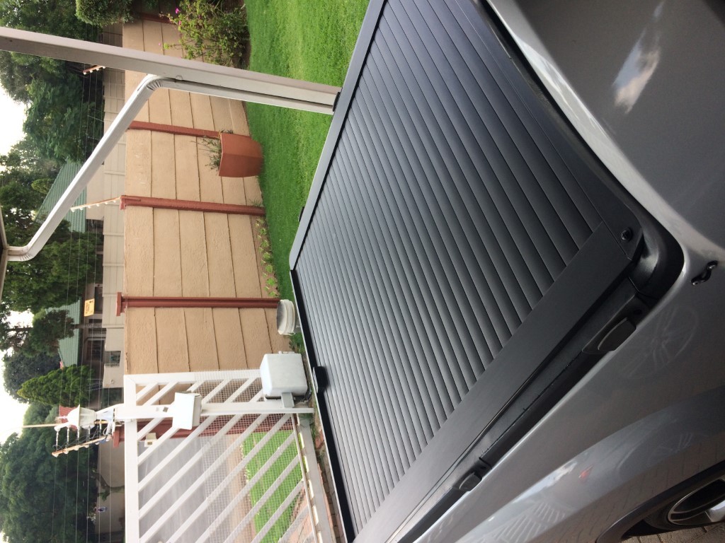

Also, over the December holidays last year, and into the new year, I was also busy overhauling my Armadillo roll-a-door. I repainted it completely, and also fitted some new foam sealing tape etc.
Here's a pic of the end result:

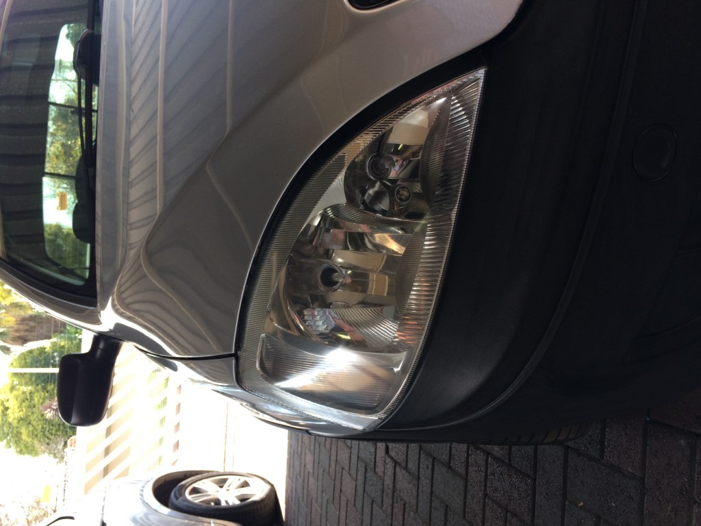

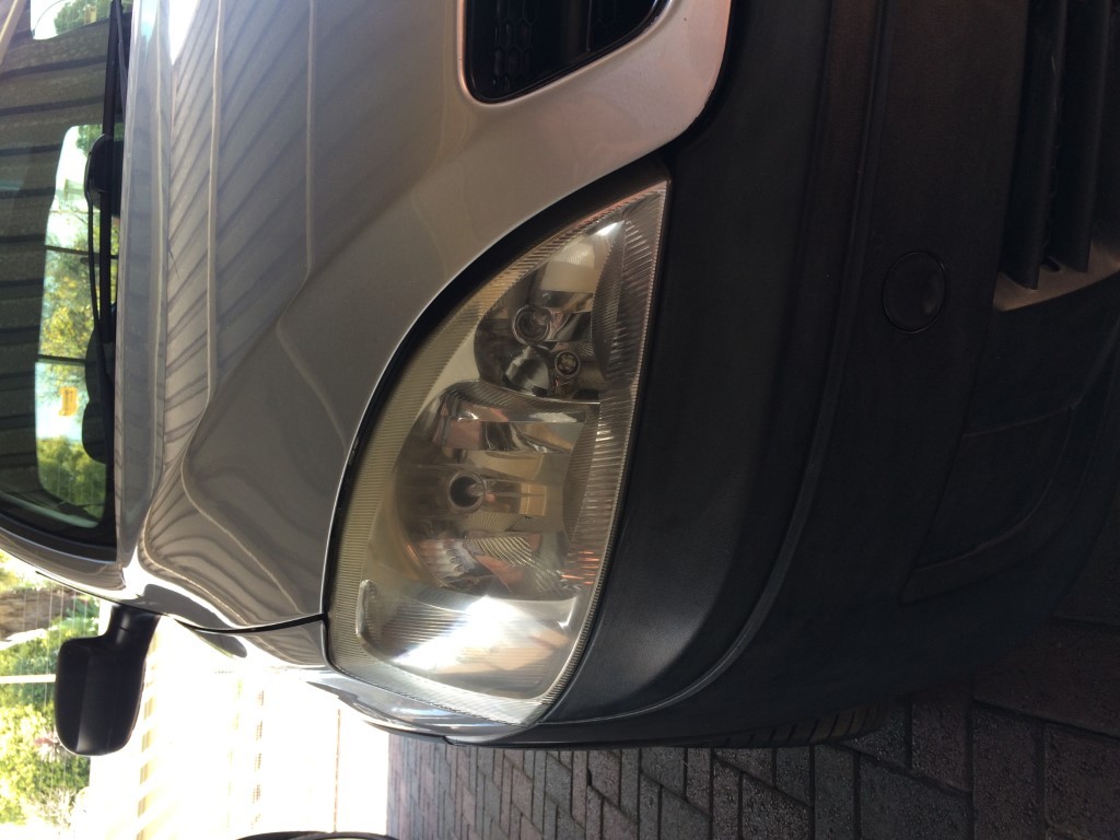

MY headlights were looking a bit dull again, so one weekend when I had some free time, I tackled the headlights with water paper, my machine polisher and some various compounds of polishes and sealants.
Before:
After:

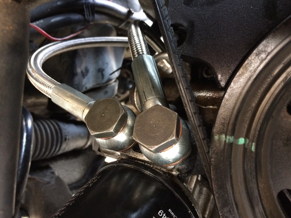

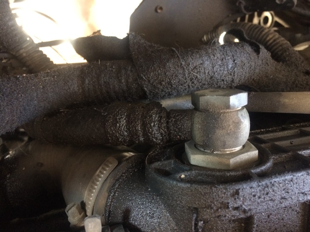

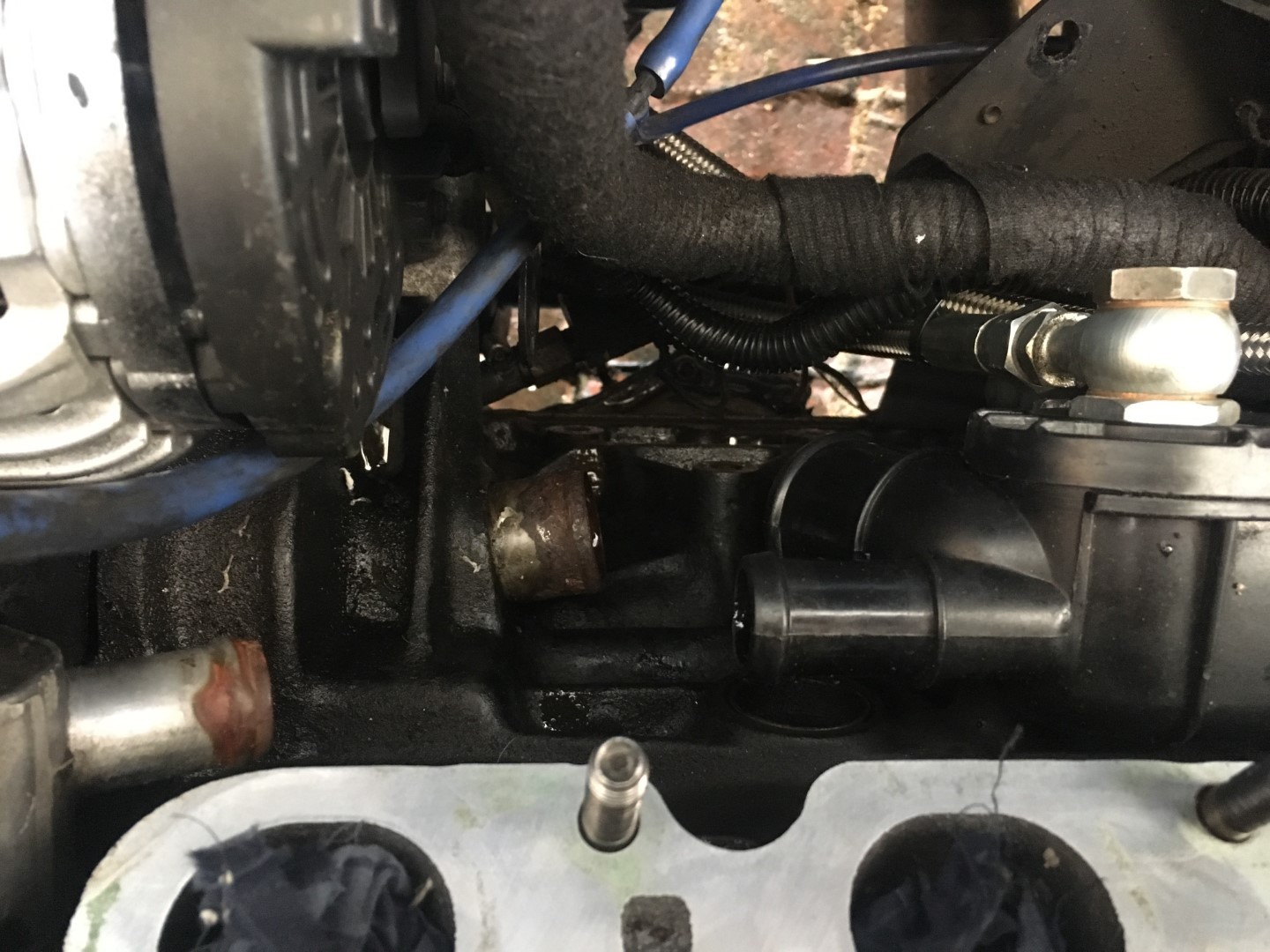

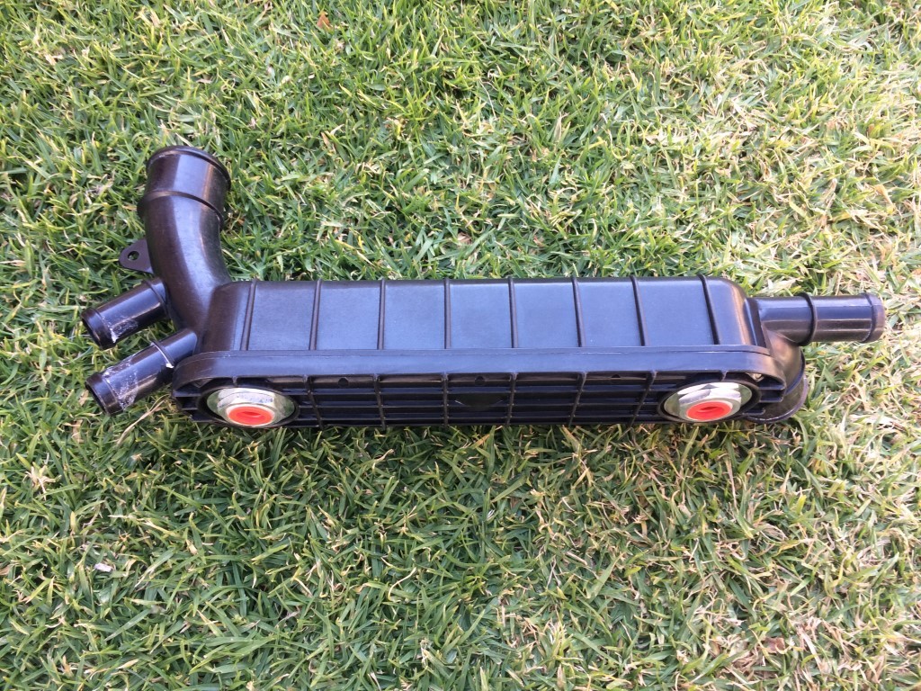

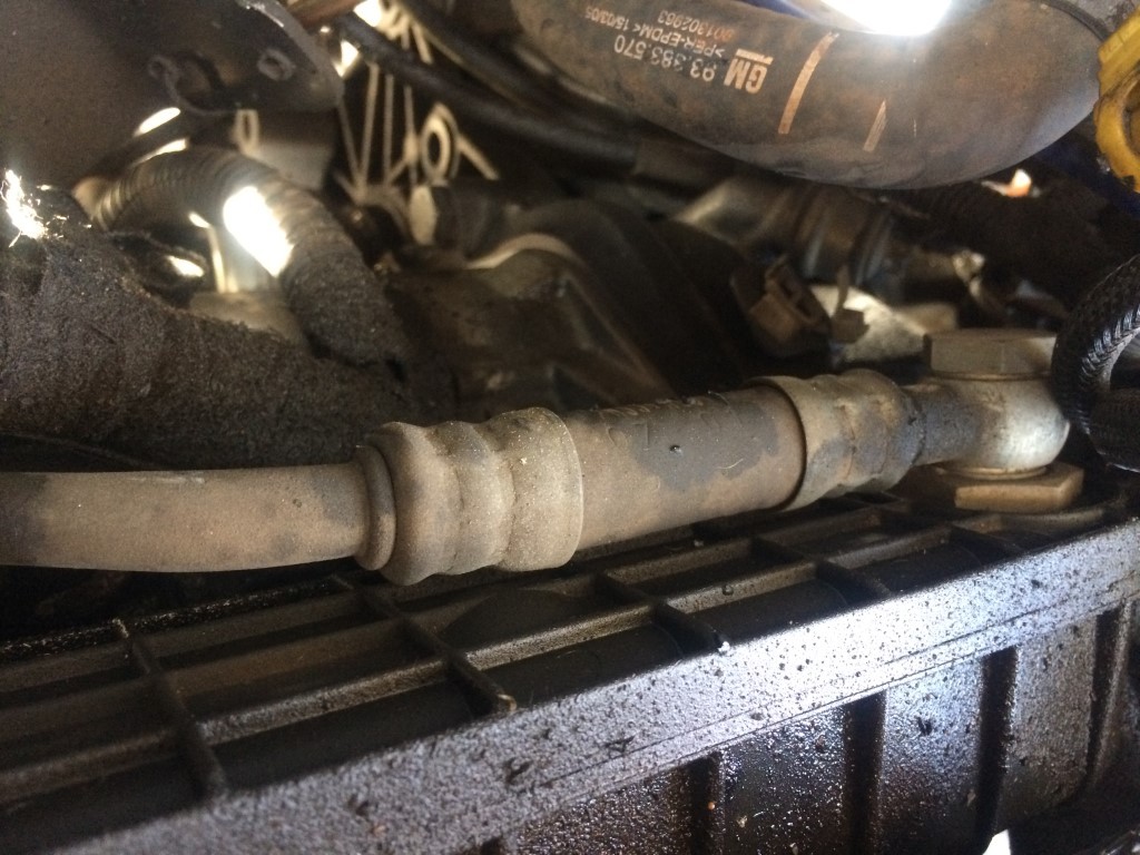

Having postponed a lot of mechanical maintenance, it was time to tackle some important jobs. I've had an oil leak for some time, which I seemingly traced to the oil cooler. This is a real PITA to get to, as it sits at the back of the motor, right under the intake manifold.
First step was to source all the parts I needed to get this job done. First off was a new oil cooler, this I managed to get from Goldwagen for around R1000 (the agents want R7500 for the OEM one).

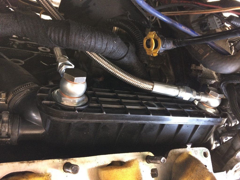

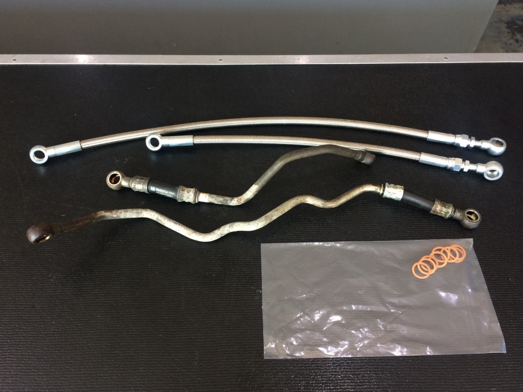

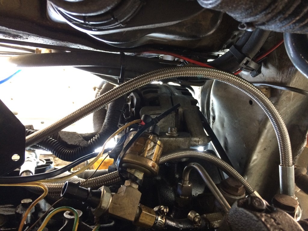

Next up, replacement oil cooler lines. I ended up buying a 2nd hand oil cooler and pipes (from the UK of all places), so that I could get lines made up before taking my Ute off the road for surgery. I ended up getting some Teflon braided hoses made up at my local Hydraulics shop. I also got some new copper washers at the same time. Cost for these was R1100.
For shits and giggles, I again popped into GM (now Opel) to enquire how much new OEM lines cost. The parts guy advised me to sit down. "The supply line is R2500 and the return line is R15700. Both pipes with VAT will be over R20000" :roflol: (And Yes, that is not a typo. R20k for 2 pipes).
Moving along, I had everything needed to begin with the work, so the Ute was parked in the service bay (aka back yard) and I commenced with the job. I didn't end up taking too many pictures throughout, as it was a real dirty job and I was pressed for time.

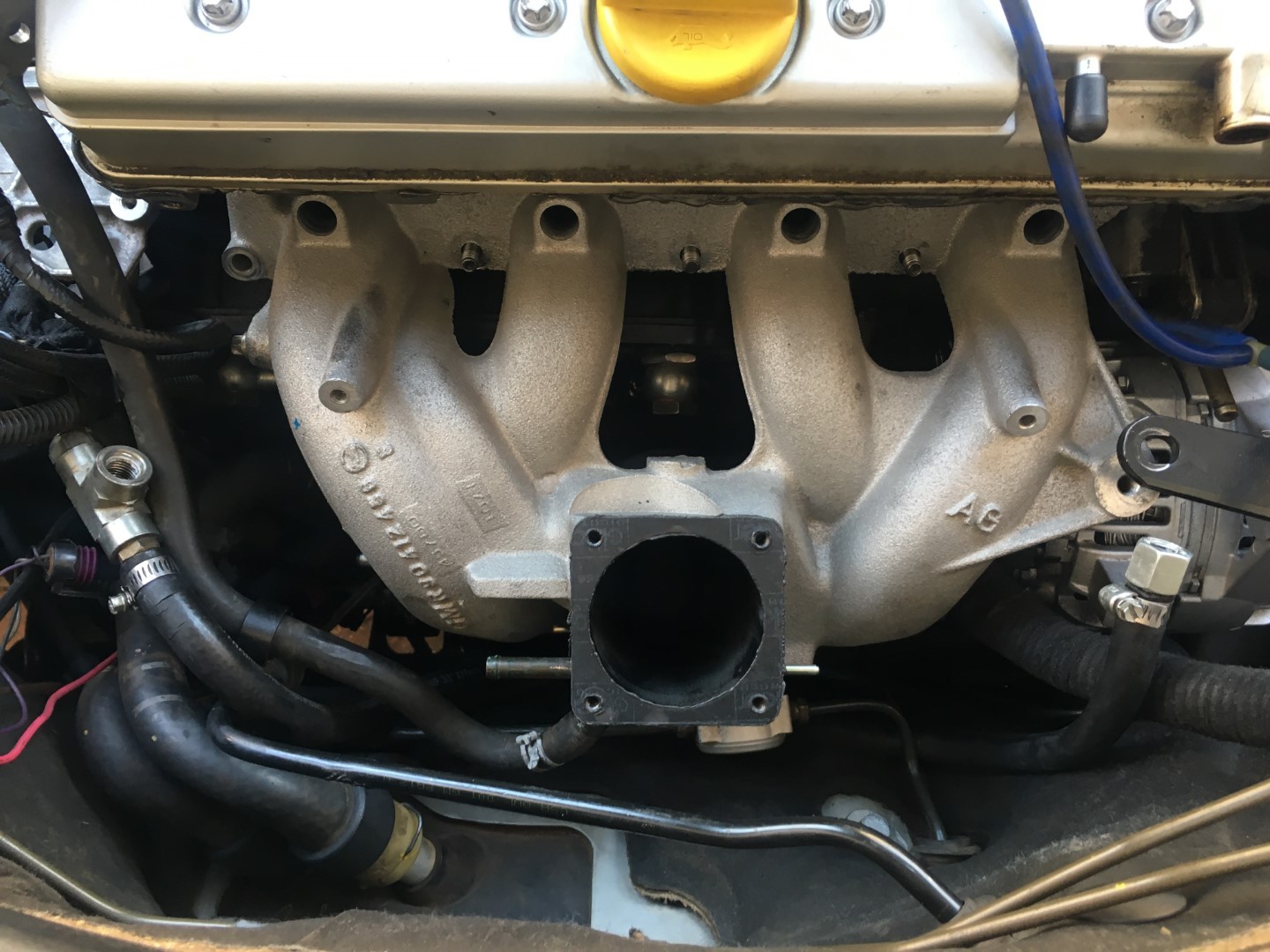

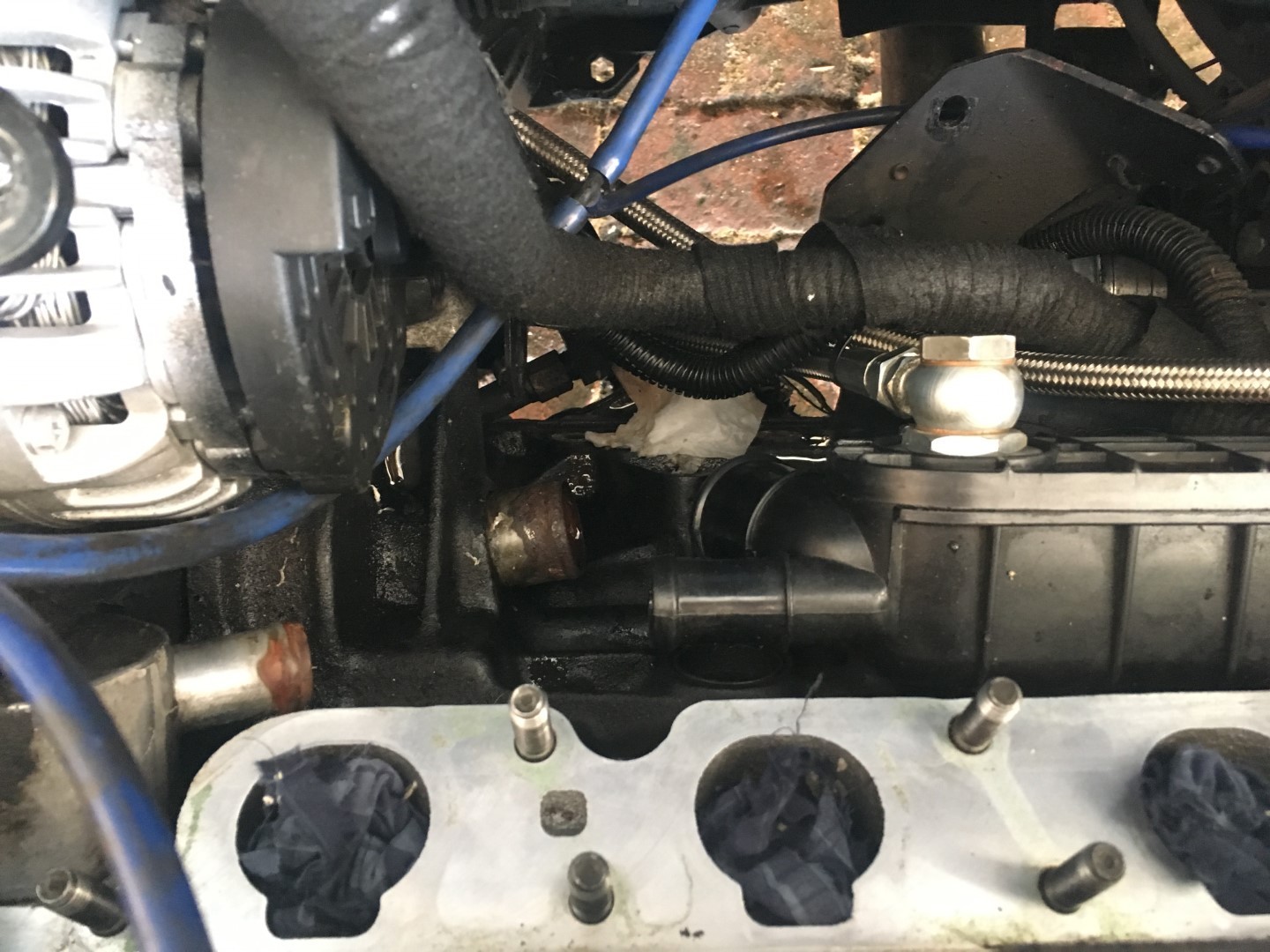

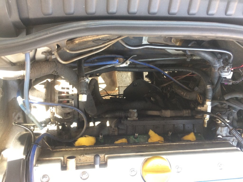

Intake manifold off, to reveal the oil cooler and lines:

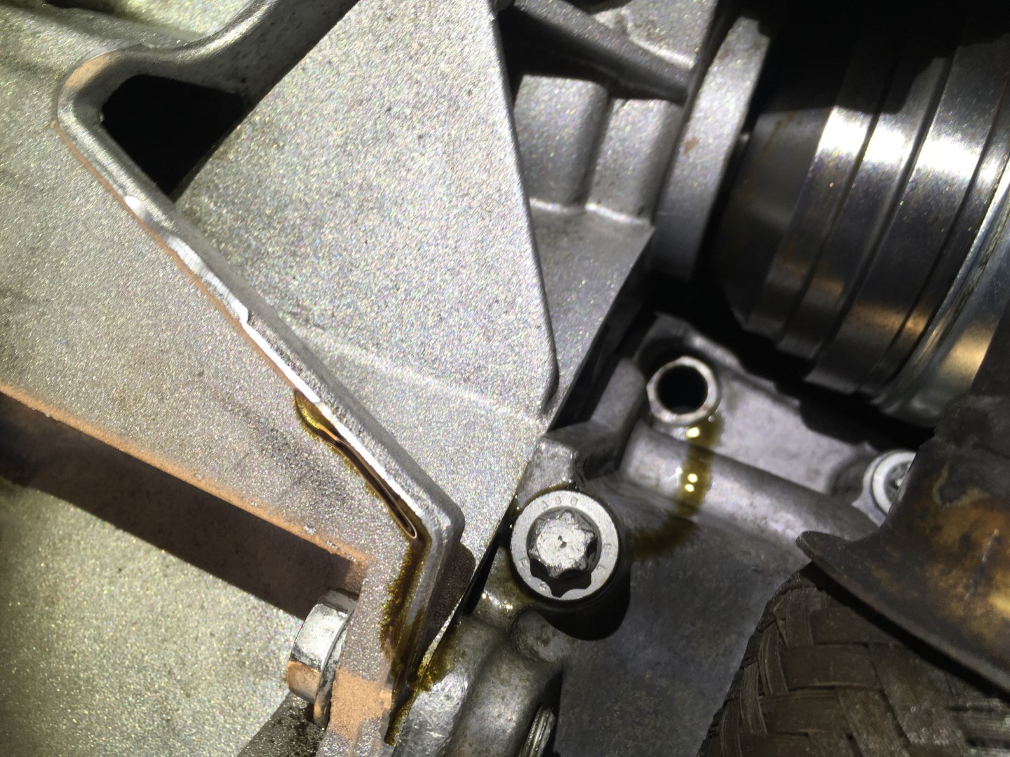

The offending pipe (supply) which was leaking on the join:

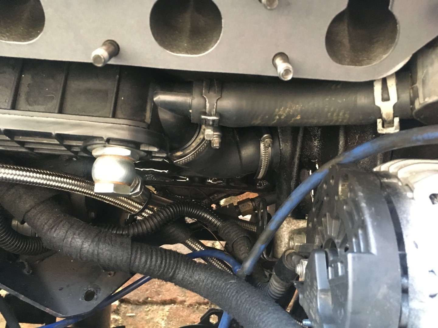

The return line looks ok:
I did some cleaning while everything was off (as best as I could, before fitting the new oil cooler and lines:
Space is minimal by the crank dampener pulley:
After this, I refitted the intake manifold (with new gasket), throttle body, boost pipes etc. I started the car, and thankfully the oil pressure was good, and no puddles or leaks. Job done :smilebounce:

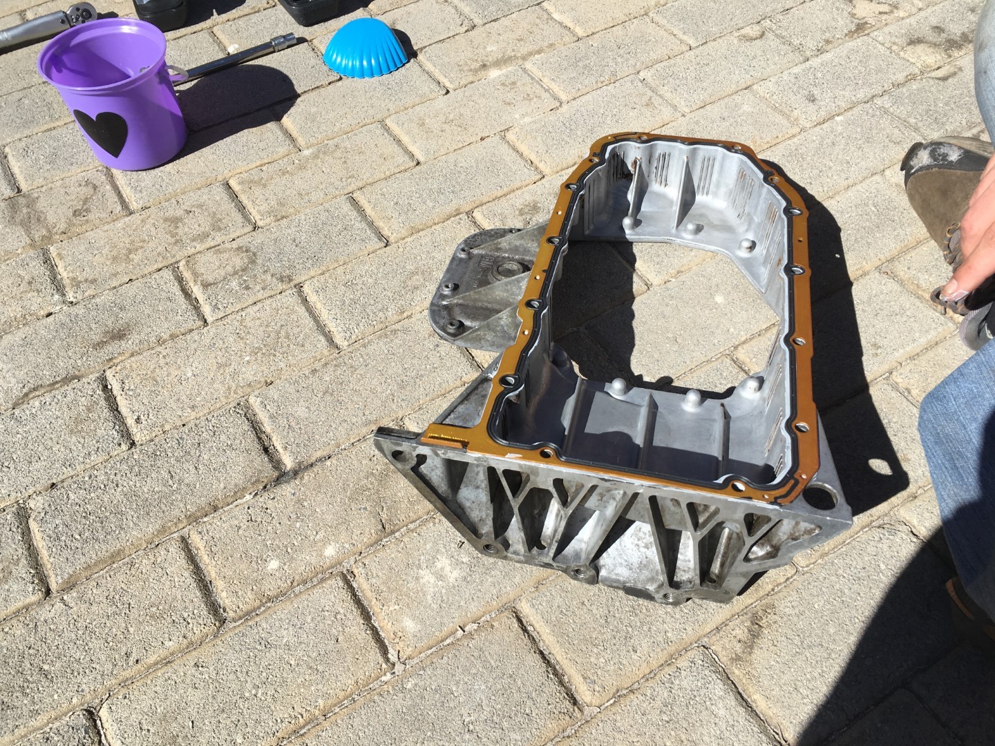

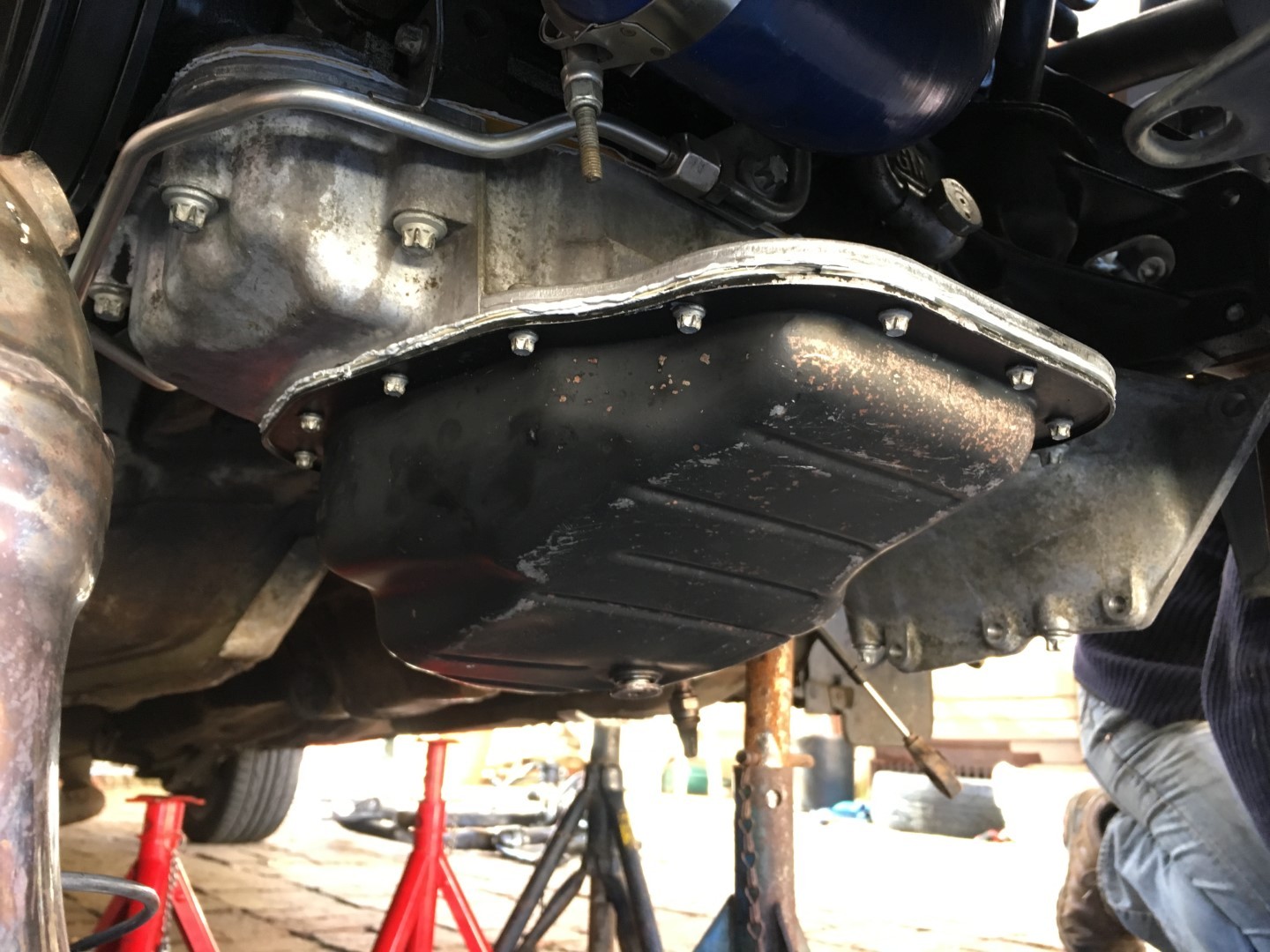

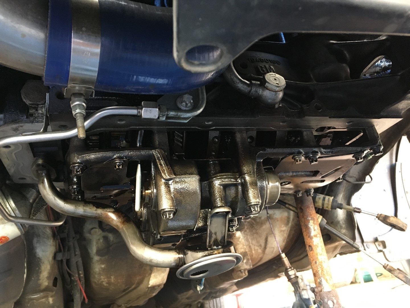

Now that this major job was done, it was time to tackle the next major items, those being changing the sump gaskets (because I suspect there was a leak there too), and that would be followed by an overhaul of the turbo.

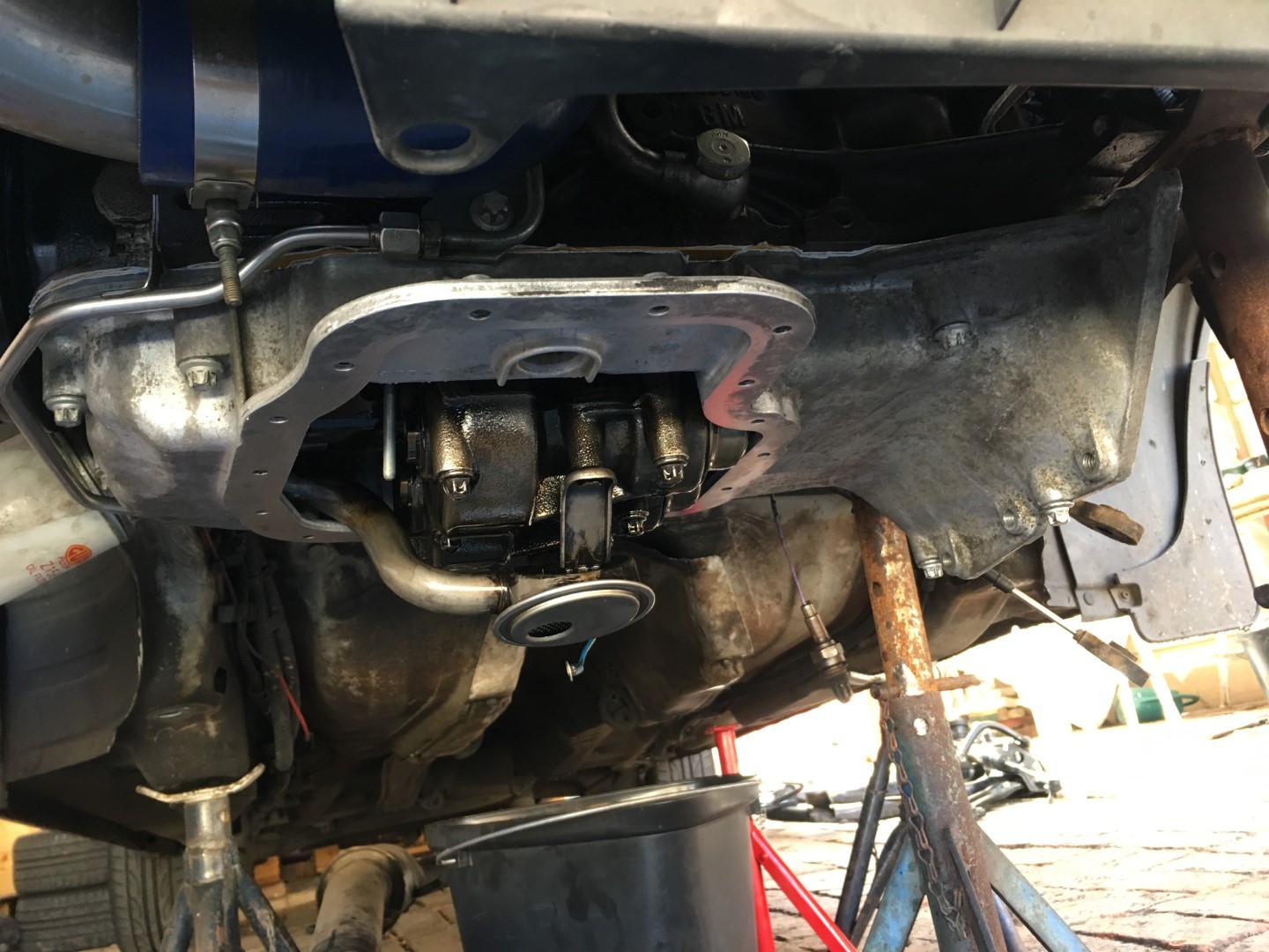

So up the Ute went on trestles, I drained the oil and coolant in preparation for the jobs which followed.
For the sump gaskets change, I didn't take any pics (sorry). It was a real messy job, and in this application, also a PITA (my new favourite word it seems, lol). On these motors, the sump is a 2 piece unit, the upper aluminium section which mounts onto the block, and then a steel lower section which essentially holds the oil.
To get the lower sump off, I have to loosen engine mounts, and actually lift the motor up, to free up space so that I can get to the bolts hiding behind the sub-frame. The upper sump also has some issues wangling into and out of the tight space.
Nevertheless, after lots of sweating and bruised knuckles, the job was done.
