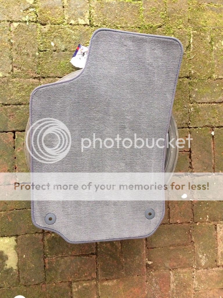

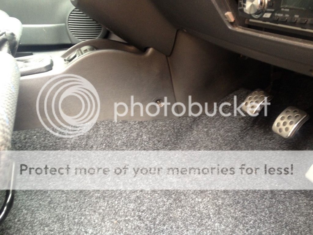

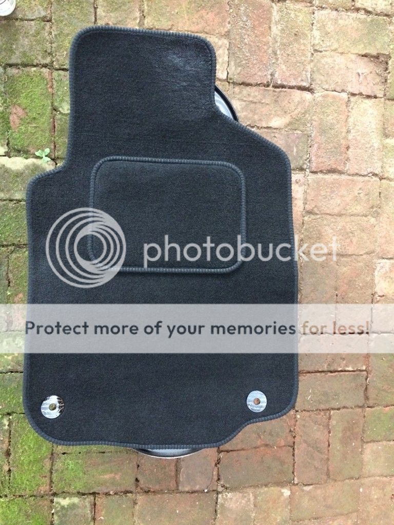

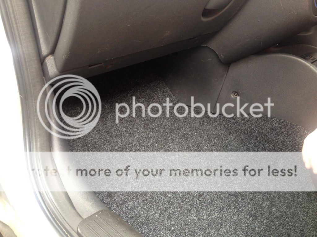

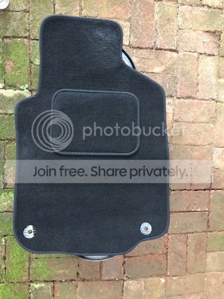

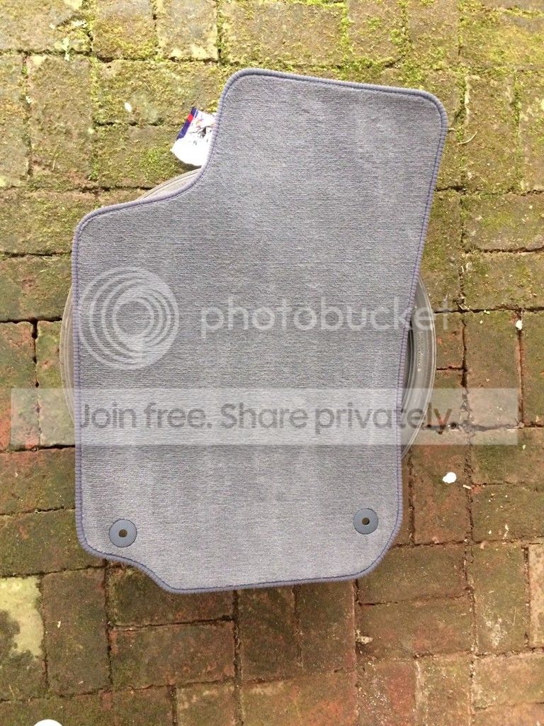

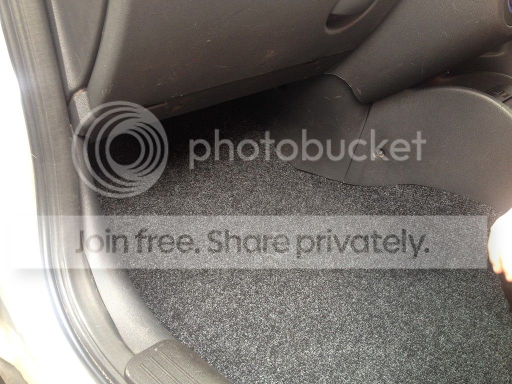

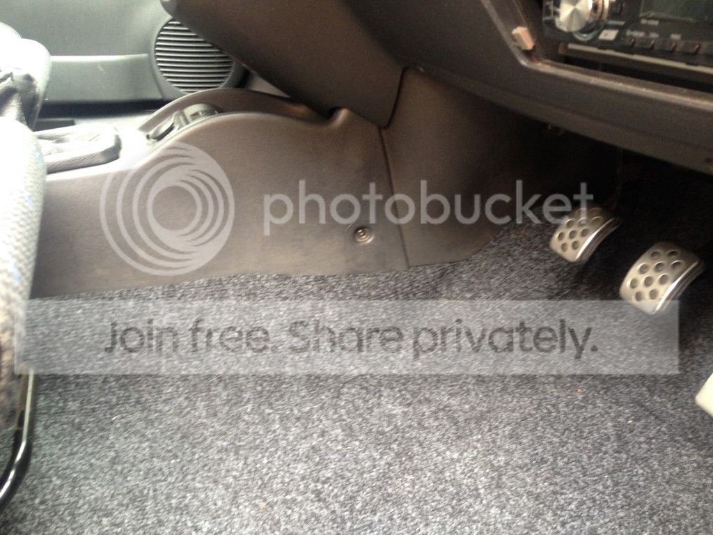

In January, just before going back to work, I decided to try make some fitted floor mats. The process was quite straight forward, and the end result looked really good. See pics below:
Having lived with them for a few months now, I can’t say things are still as good. The carpeting is rather thin and not as hard-wearing as traditional floor mats, so it is already wearing thin where my heels rest, and also due to not having any sort of sticky stuff underneath, it does tend to move around a little. Not ideal, and I had plans to try sort that out, but time is short. So I’ll leave them as-is, until I get time to try out floor mats v2.0.

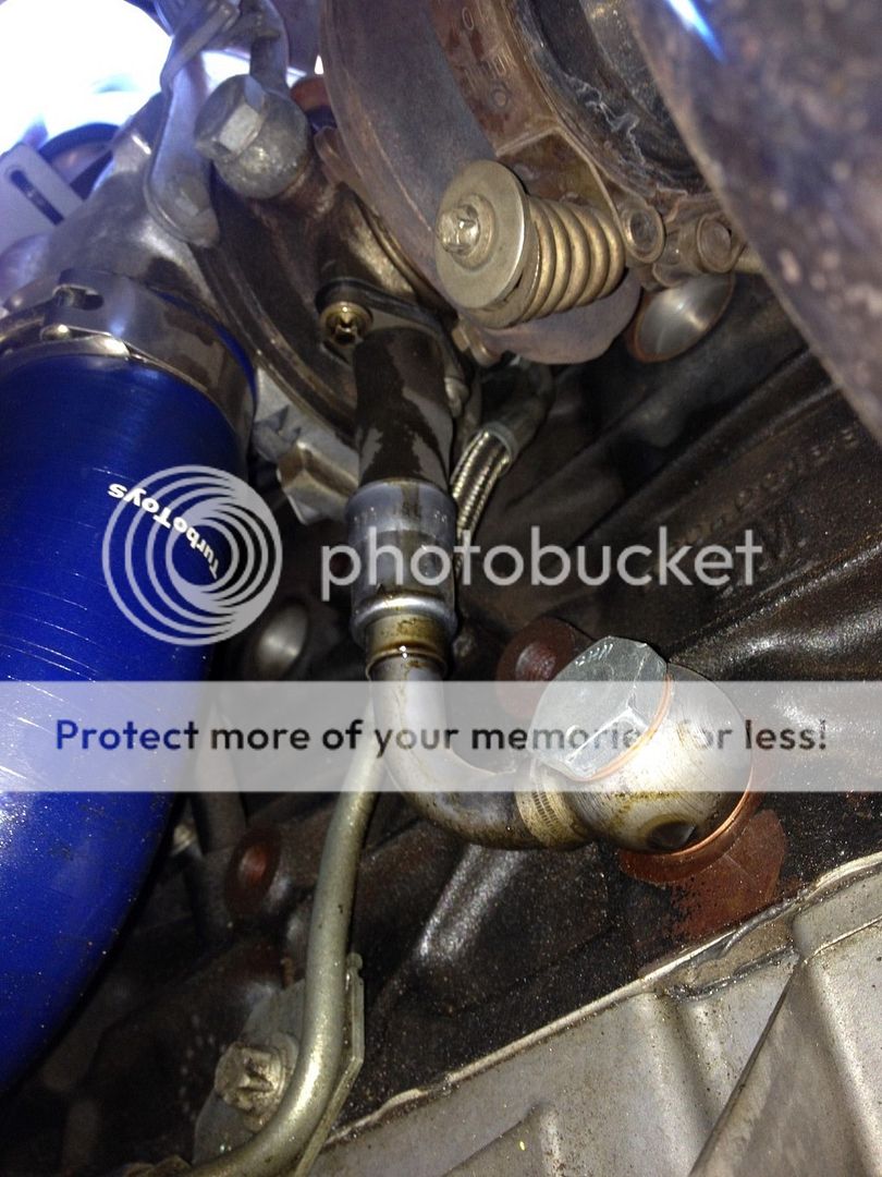

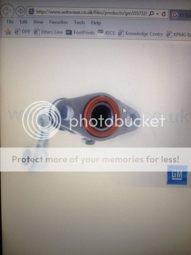

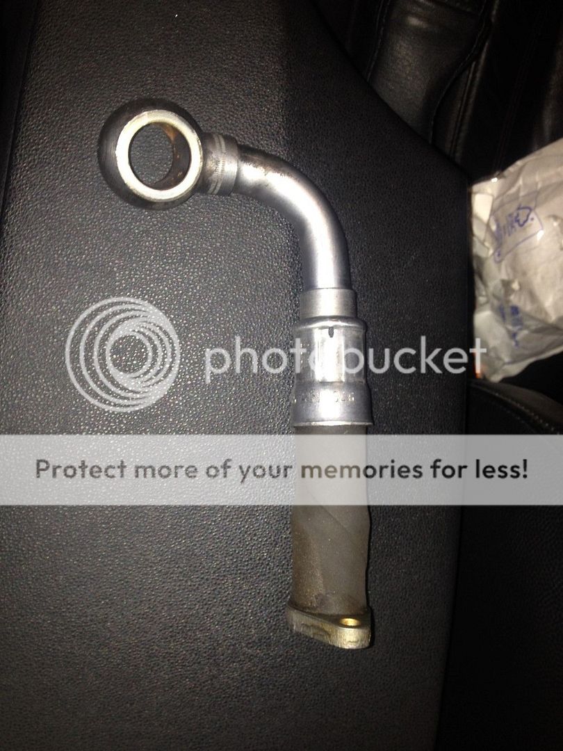

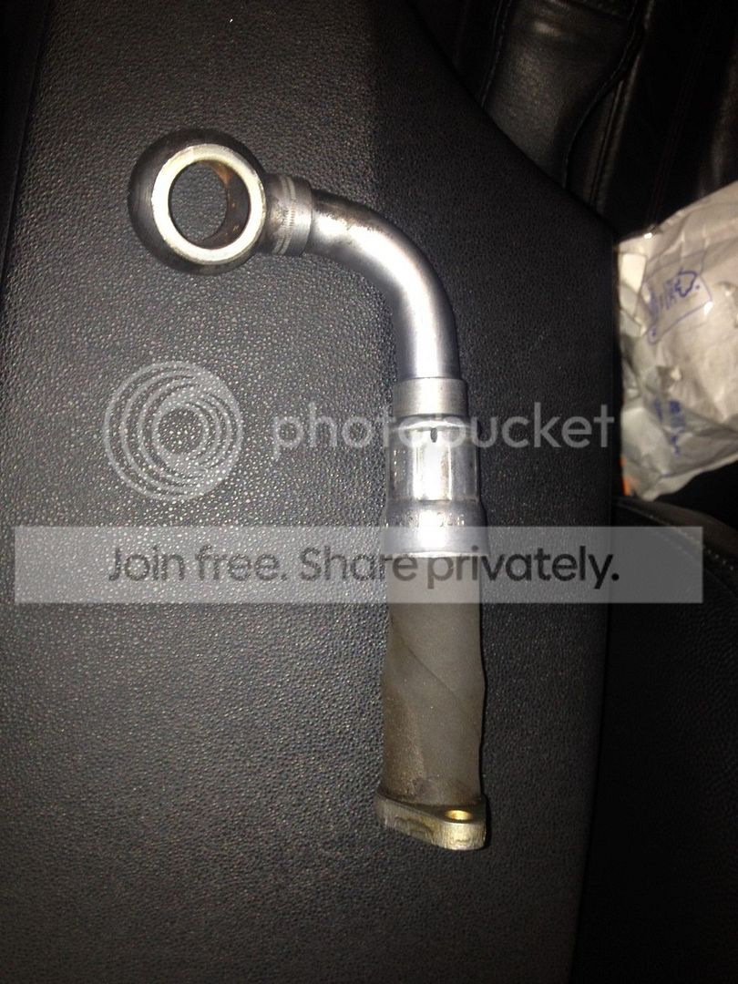

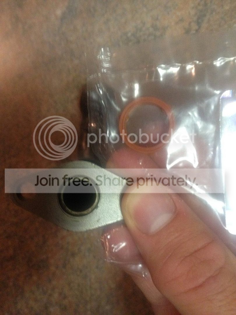

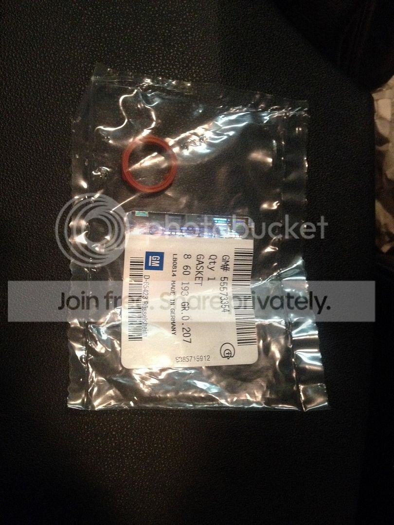

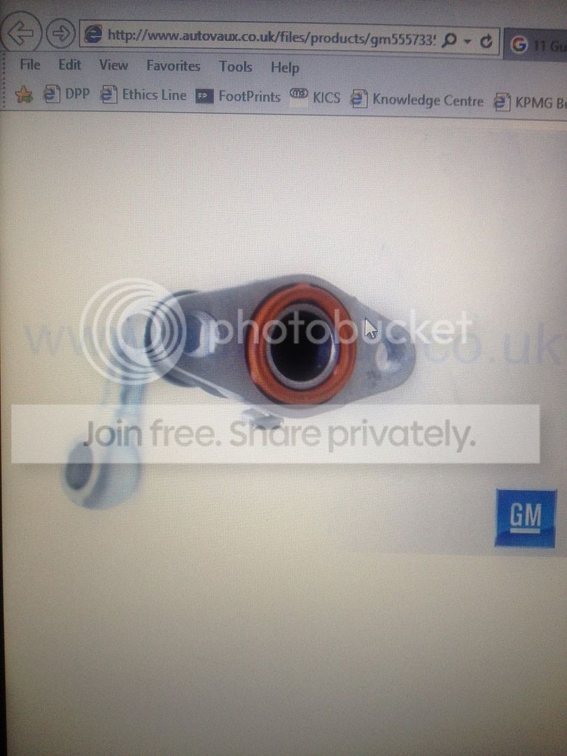

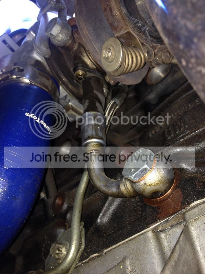

Around this time as well, I managed to source a replacement turbo oil return pipe from the UK, along with a replacement seal to fit between the pipe and the turbo manifold. What I initially thought would be a good deal, turned out to be expensive thanks to customs, shipment costs and other admin fees from the local courier company. Anyways, this is what arrived from the UK:
Unfortunately, I was also done a dirty, because it is not the part that I actually required. Looking at the top flange, it is not machined bigger to accept the newer version of the o-ring seal:
This is what it should have looked like:
This is what the original pipe looks like:
So all-in-all, some school fees were paid from my side. I was hoping to fit the newer generation pipe, which has a rubber section instead of the metal flex section, as well as the o-ring seal instead of a steel gasket. Being halfway there, I decided to fit the pipe anyway and managed to source a new steel gasket locally. I’m glad I did, because testing my original pipe afterwards – there was a small leak on the steel flex section. Hopefully this would cure the puddle of oil I left wherever I ended up stopping.

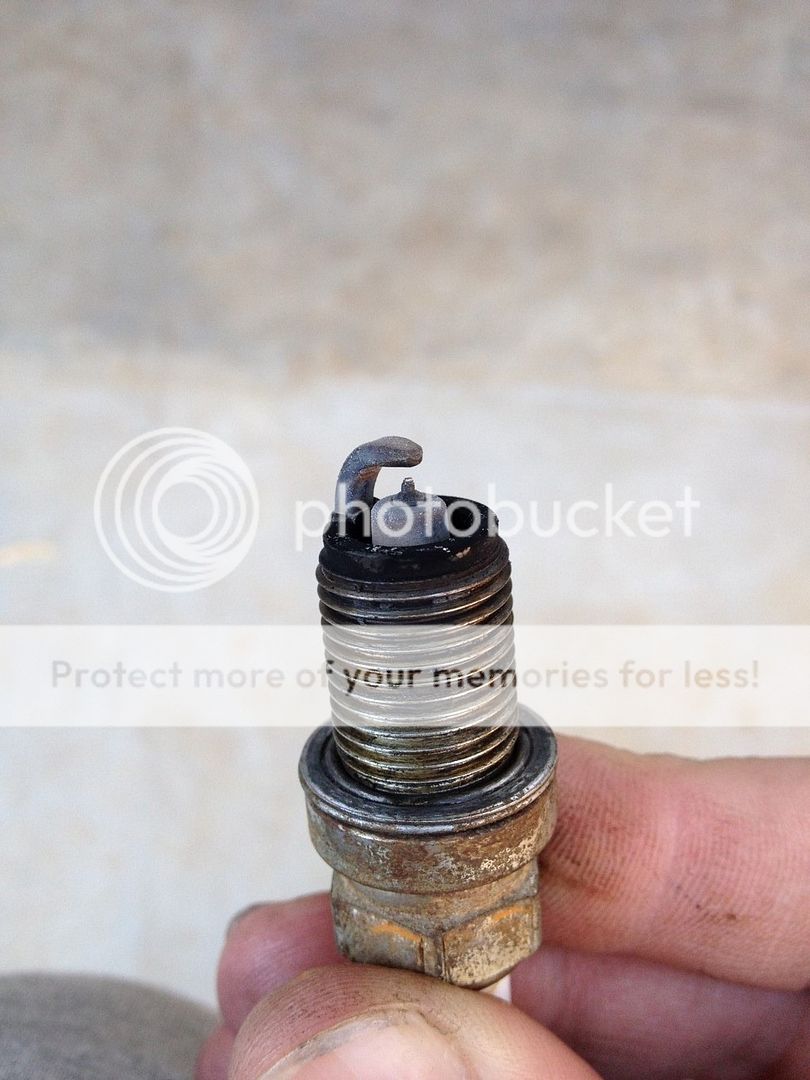

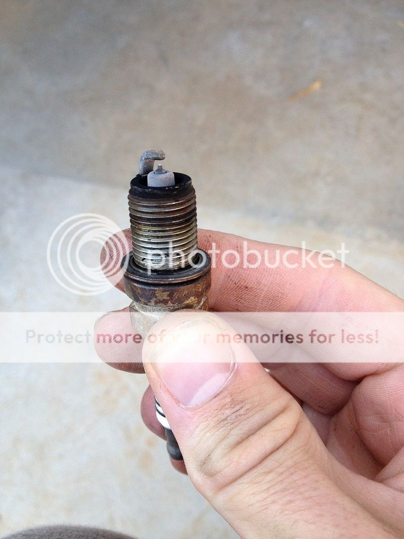

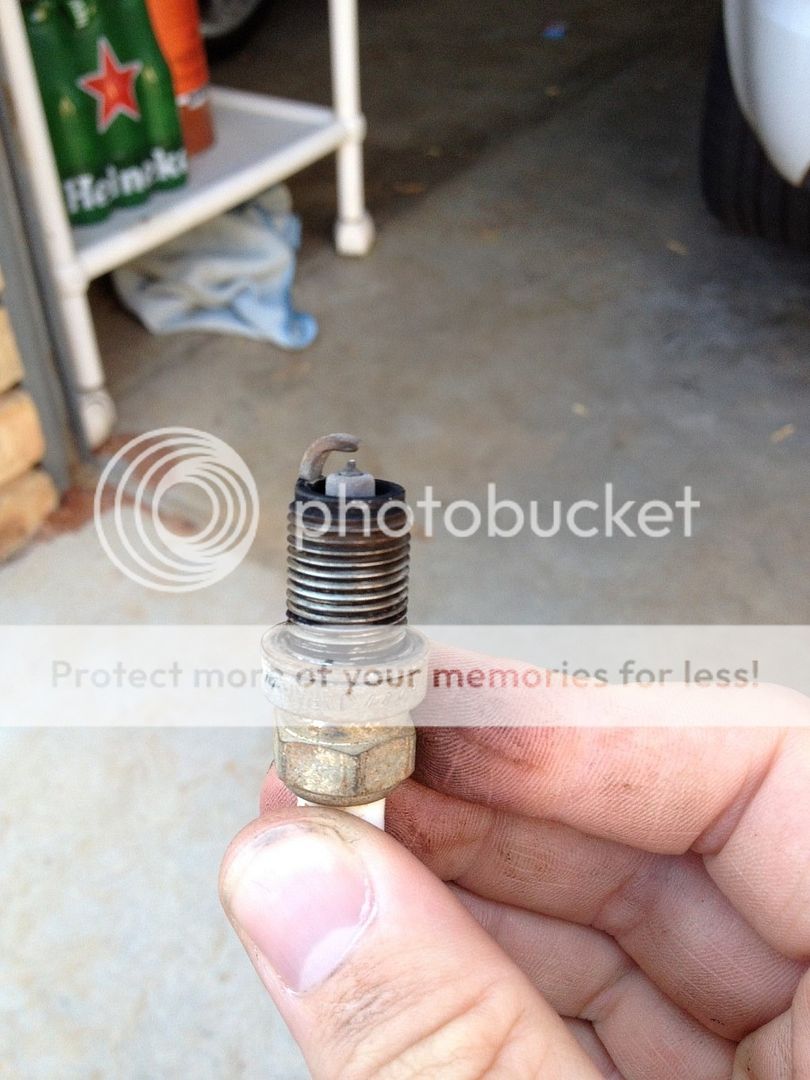

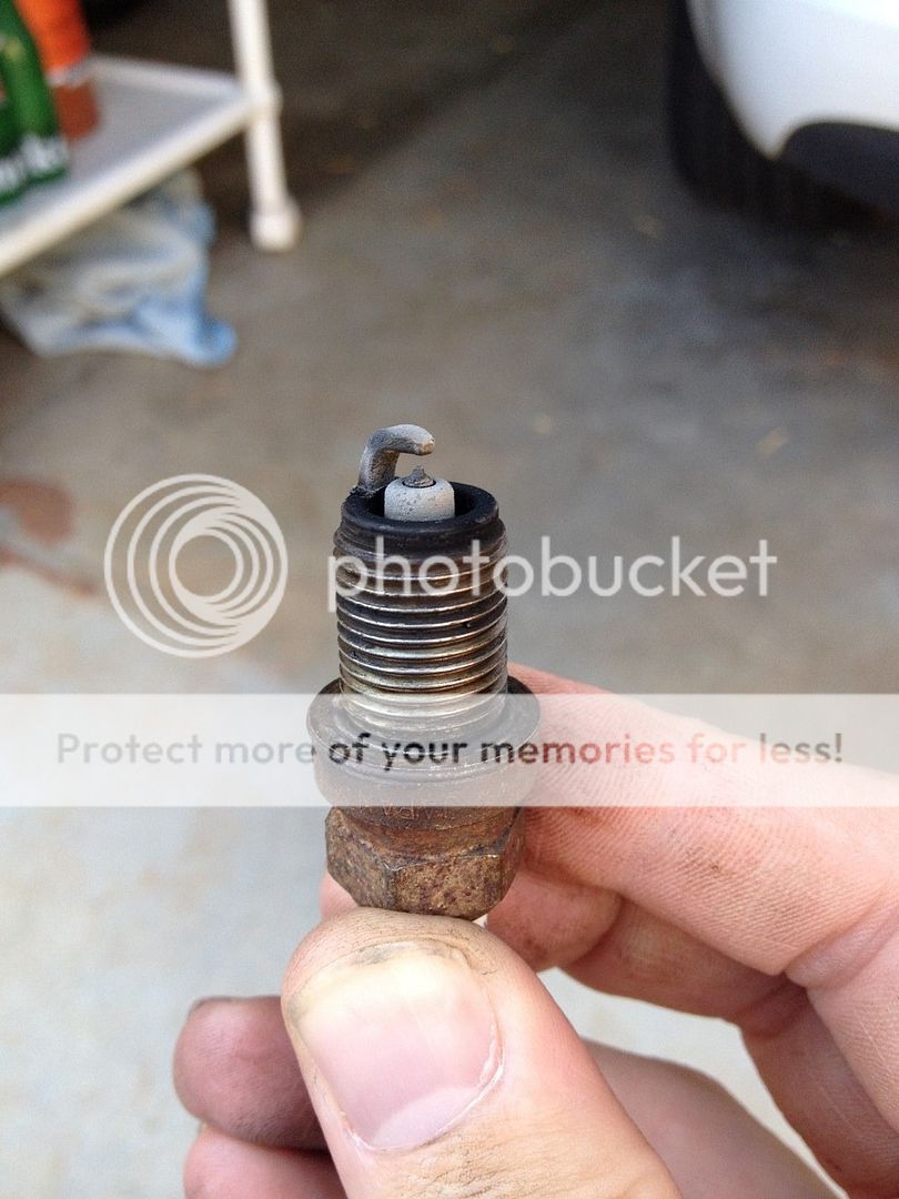

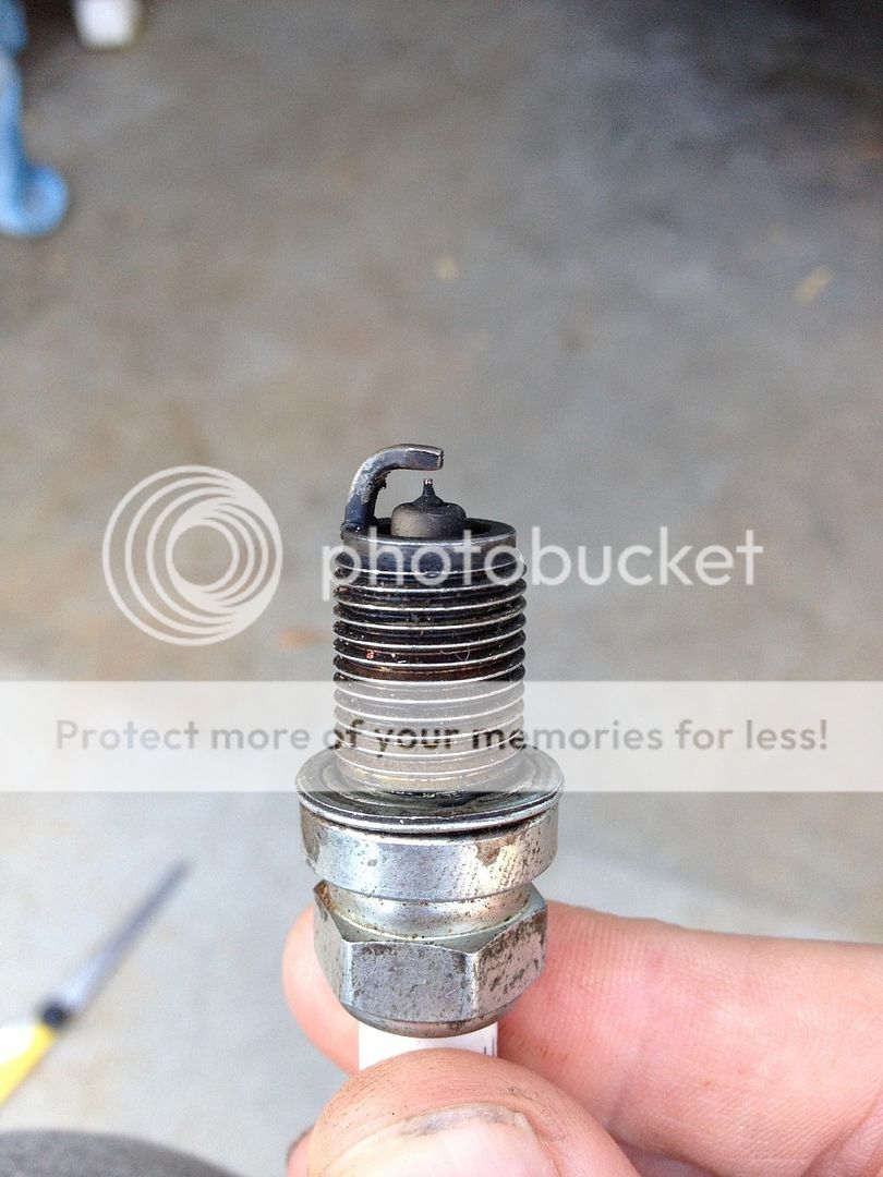

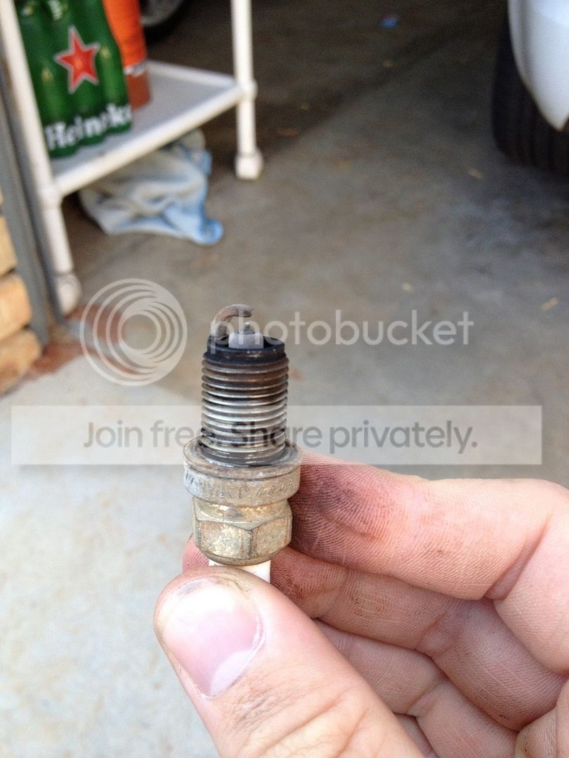

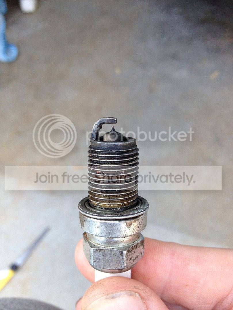

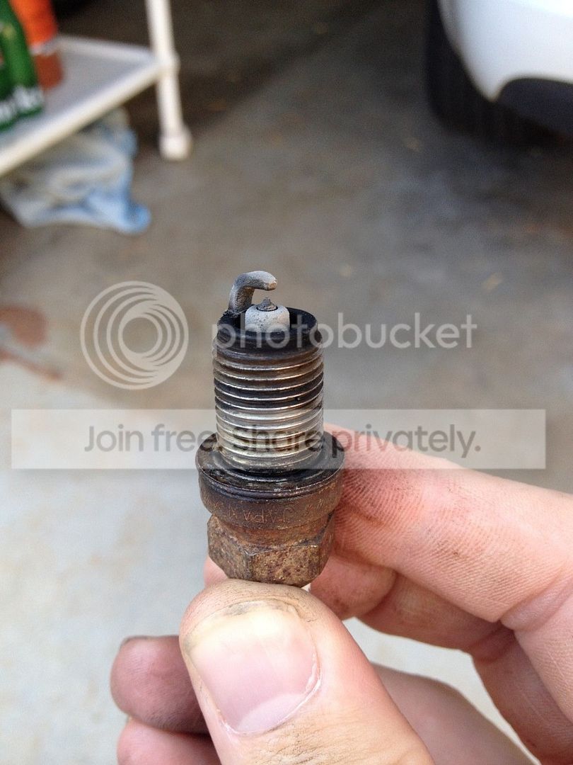

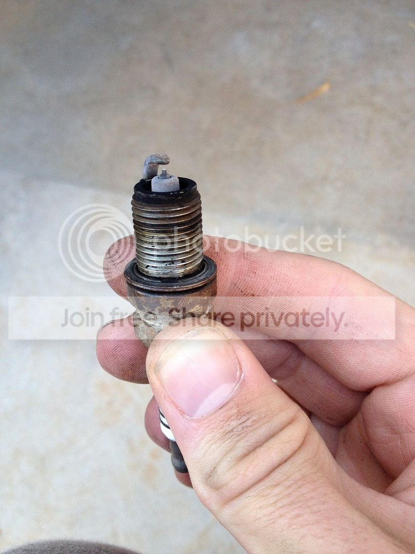

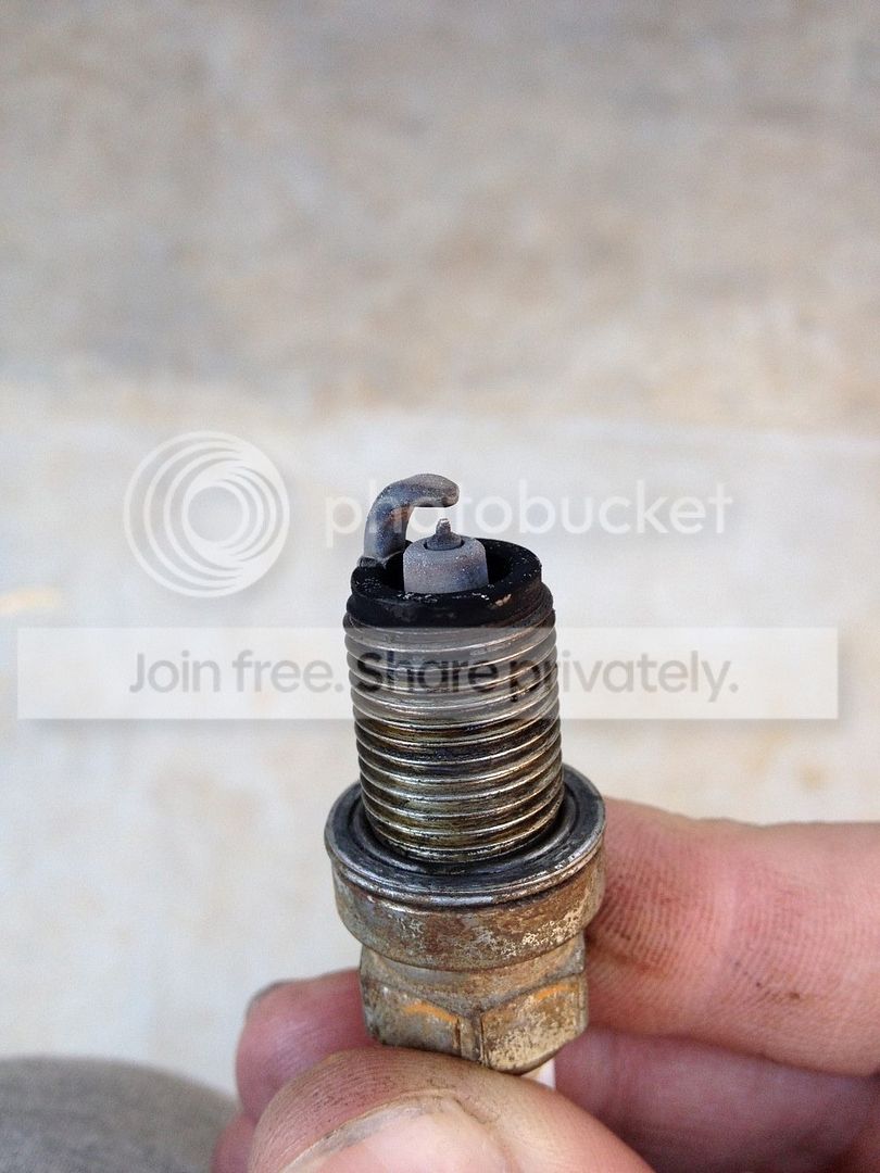

Moving on to April 2016, I began to notice that the Ute was beginning to perform really crappy when using high boost and meth injection. I thought it may simply be a change of season, and the colder air going into the motor was messing with the air-fuel ratios when under load and injecting meth. I tried adjusting the meth controller, but the problem persisted and eventually got worse – as in the Ute would not pull at all when injecting meth. This led me to believe that maybe my spark plugs are kaput, and the meth is essentially extinguishing the flame.
Below are some pics of the plugs. Note that using a feeler gauge gapped to 0.8mm, it fitted comfortably in each of the plugs – this gap is too big, and most likely explains the reason for the misfiring. Also to note is that these plugs were fitted in Feb-2013 when I fitted the new turbo, they have done approx. 35000kms (20000kms of which subsequent to installing the water-meth kit):
Plug 1:
Plug 2:
Plug 3:
Plug 4:
I scratched around and found my old plugs from when I first fitted the 2l motor to my Ute. These were approx. 6months old / 10000kms, they still looked good, so I checked that the gap is 0.6mm and then fitted these again:
After swapping out the plugs, I am happy to report that all was well again, Ute was pulling like a machine with the water-meth.

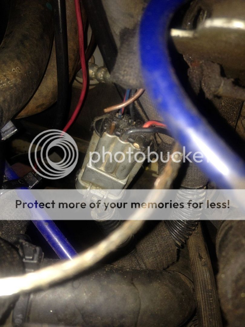

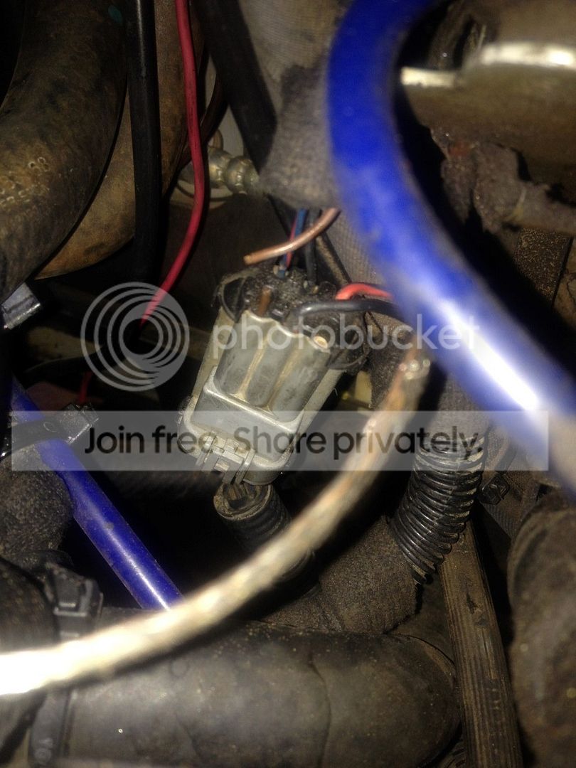

But the happiness was short-lived, as the next issue arose. My speedo began doing all sorts of funky things, reading intermittently, and what was strangest of all, is that it kept dropping speed (like the rev counter) between gear changes. I suspected either a dodgy speedo sensor, or a fault in the wiring somewhere. There is also no space in the engine bay, and my speedo pickup fits into the back of the gearbox, between the motor and the firewall.
One day I managed to reach down and fiddle with the plugs a bit, and after that – no speedo at all. So I then knew that there was a wiring issue. Further investigations that weekend revealed the following: a broken speedo wire on the engine harness side:
I managed to strip away a few things to get better access, and after a relatively simple job to solder the wire together again, all was well with the speedo.
Having replaced the turbo oil return pipe, I thought all was well, until about a week after I did the job when I noticed another drip on the paving. This was very annoying, but further investigation revealed that it was now leaking at the steel gasket where it connects to the turbo manifold (now you know why they changed this to the o-ring type of seal).
Quite frankly I was irritated, and didn’t have another few grand to fork out on another pipe. I decided to rather try fix it again, so I pulled the pipe off, and after cleaning up everything, I applied a very thin layer of gasket maker to each side of the gasket and refitted the pipe (this is the same gasket maker I used when I changed the sump over). So far so good. I haven’t seen any leaks yet, so holding thumbs that all is well.

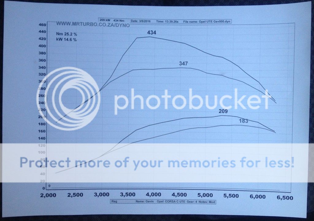

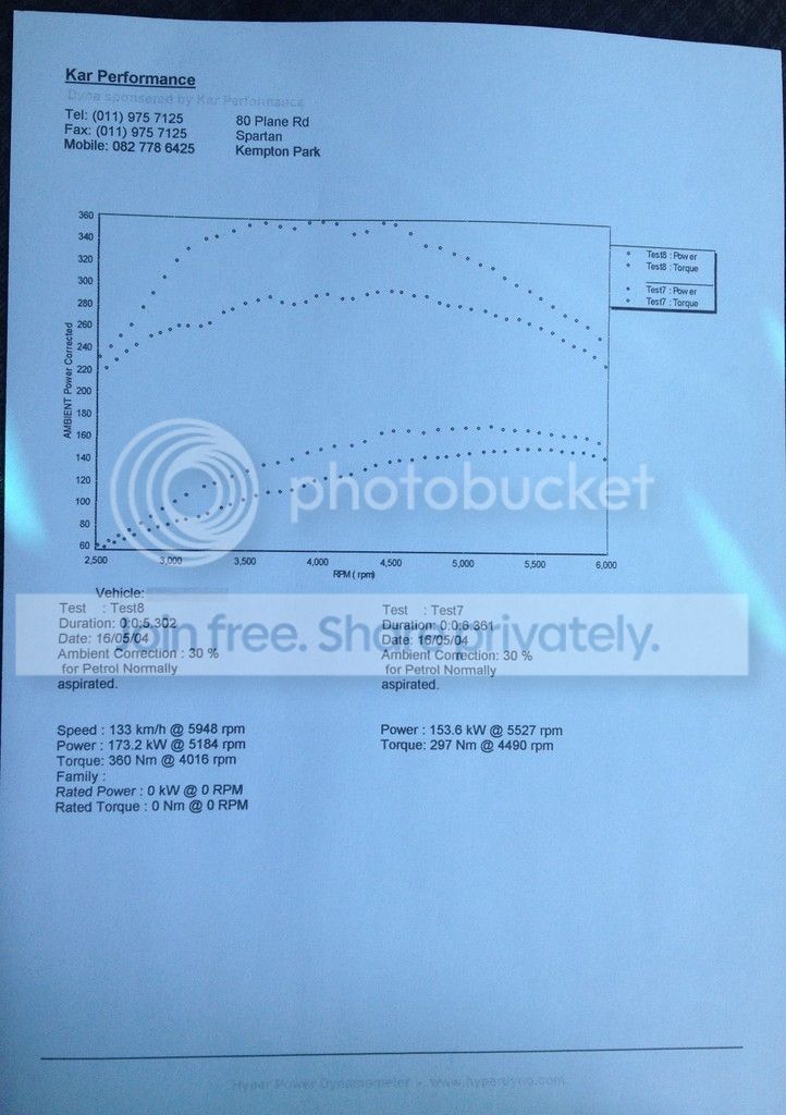

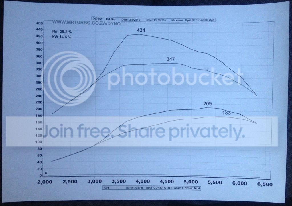

Lastly, more recently this week, whilst on leave, I decided to go visit my mate Donovan at his shop in Meyerton. He has also installed a Mr Turbo dyno, and with things quiet at the shop, we strapped my Ute onto the rollers to see what it pushes out.
These are the results, and please note that this seems to be converting back to flywheel power:
The lower graphs are at 0.7bar on pump fuel only, and the higher graphs are at 1.05bar and with water-meth injection.

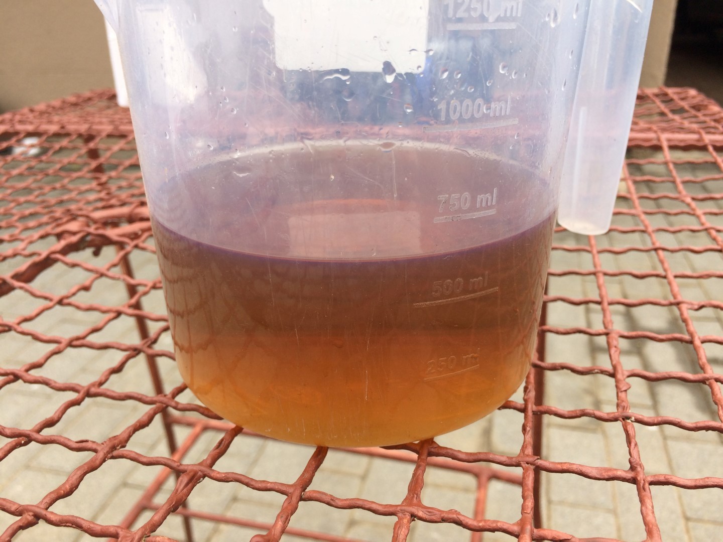

Then out of curiosity, and also to put the keyboard warriors at ease, I took some time to go visit Shane at KAR, and put the Ute on his rollers, for what is considered to be one of the “benchmark” dynos in Gauteng. These are the results, and please note that these figures are at the wheels:
Both graphs are the same as before: low boost and no meth, and then high boost with water-meth injection.
Using that handy power converter calculator that can be found on the internet, if I input the figures from KAR, that gives me flywheel figures of 214kW and 433Nm. This is almost in line with the figures from my mate’s dyno.
I also partially did this as an exercise to reinforce the theory that you cannot compare 2 different dynos, on different days etc. In this case, it is a Mr Turbo dyno vs a Hyperpower dyno. The air temperature also differed by about 3 degrees on each day. Never mind all the other factors such as heat soak, warming up of the dyno rollers etc.

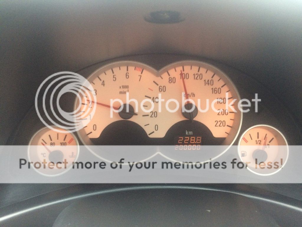

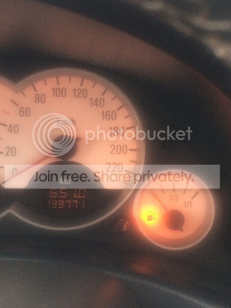

Another quick update: hit another milestone early this morning on my way to work:
> 200000kms on the Ute
> 168300kms on the engine and gearbox
> 55500kms since I did the conversion in June 2012
I'm so pleased with my little Ute. It has been fantastic.

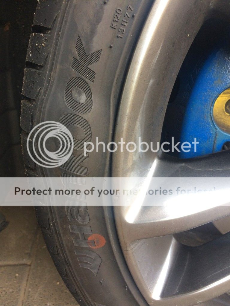

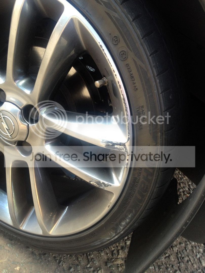

There have been some recent developments in the past couple of months. One morning I noticed that one of my rear tyres was looking badly worn on the inside. Further inspection revealed that things were bad, and it was time for some new tyres.

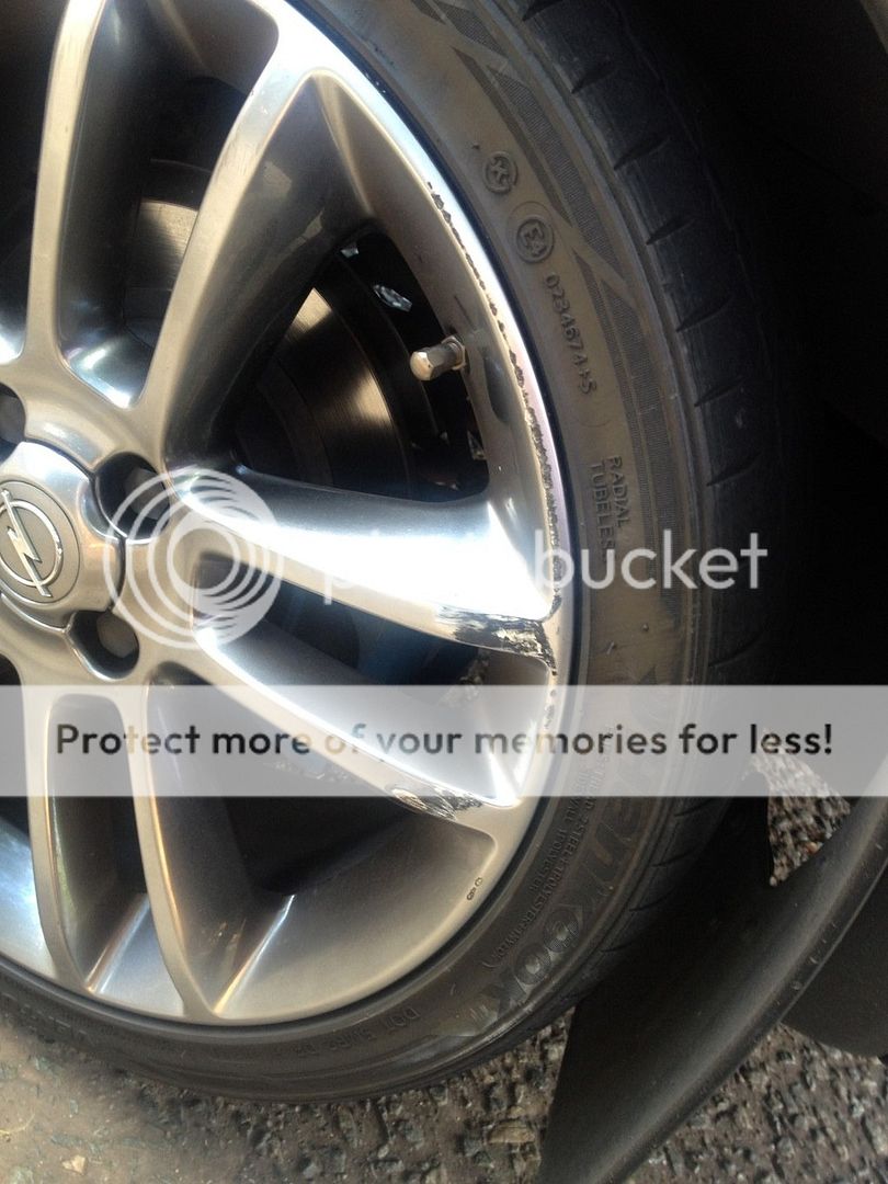

At the same time, I wanted to get the rims checked for buckles. So off I went to Hi Tech Mag Repairs. One rim needed to be repainted, following an incident at a client's basement parking a while back, and 2 others needed to be straightened.

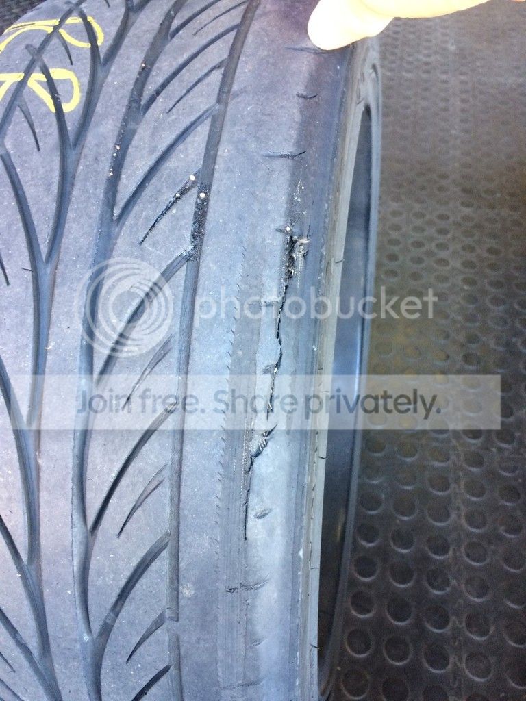

Here is the offending tyre:
I must say, that these Hankooks have been brilliant. I've managed to do 65000kms on this set of tyres. (Note that the others were in better condition than this one).

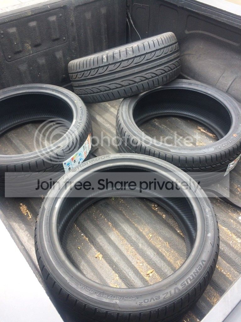

While my rims were being repaired, Hi Tech kindly offered me a set of loan rims, so I was pimping with the ricer look for about a week :rollsmile:
About a week later, my rims were ready to collect. I had decided to stick with the Hankook tyres, but this time round I've gone with the newer version of the tyre which was fitted: Hankook Ventus V12 evo2.
I haven't driven the Ute much since fitting the tyres, but immediately there is a significant improvement in ride quality. The old tyres had obviously worn off funny, and coupled with the buckled rims, things were a bit wobbly at speed.
Also during this time, I have the Ute a service, so things are good for another 6-12 months.

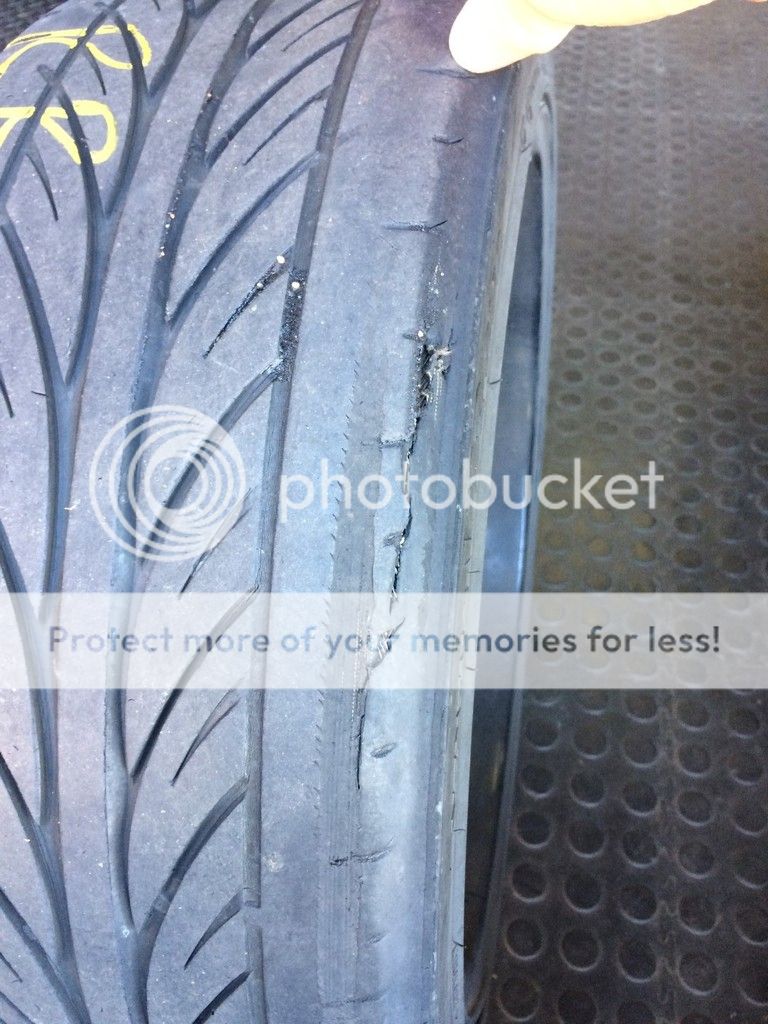

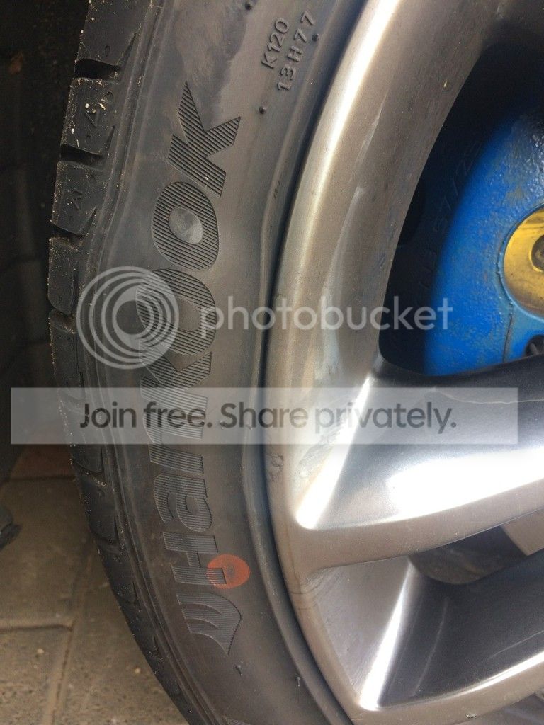

So, after fitting my new tyres, the Ute pretty much parked off for a month or so before I began using it again.
After leaving work in the wee hours of a Monday morning (3am), I was cruising home, when I hit a pothole / lump of tar on the N3 north just past Van Buuren offramp. It was quite a knock, and I was rather annoyed about it.
Inspections the next morning revealed this:
160kms of mileage done, and the tyre is stuffed. I checked the other tyres and rims and thankfully they were all ok.
I went ahead and purchased a new tyre, and now have a brand new Hankook serving duty as a garden ornament, lol.

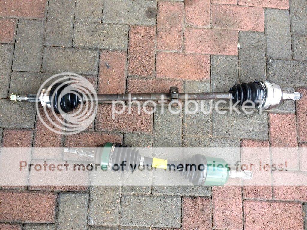

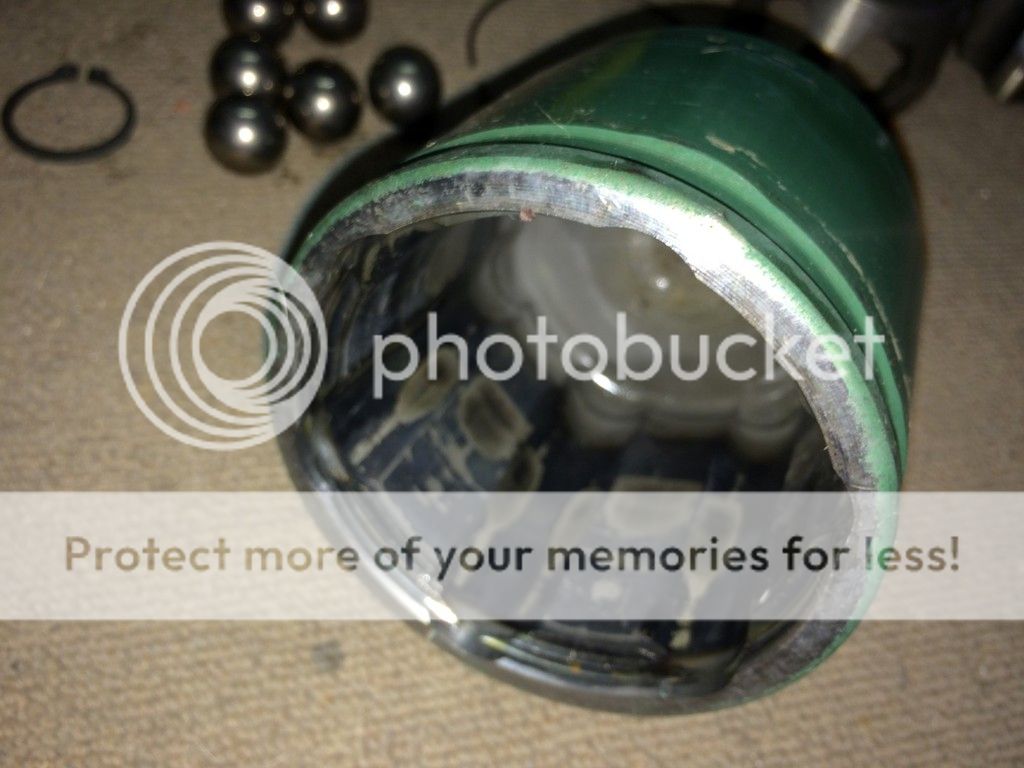

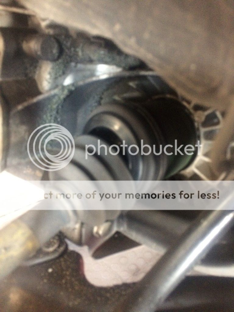

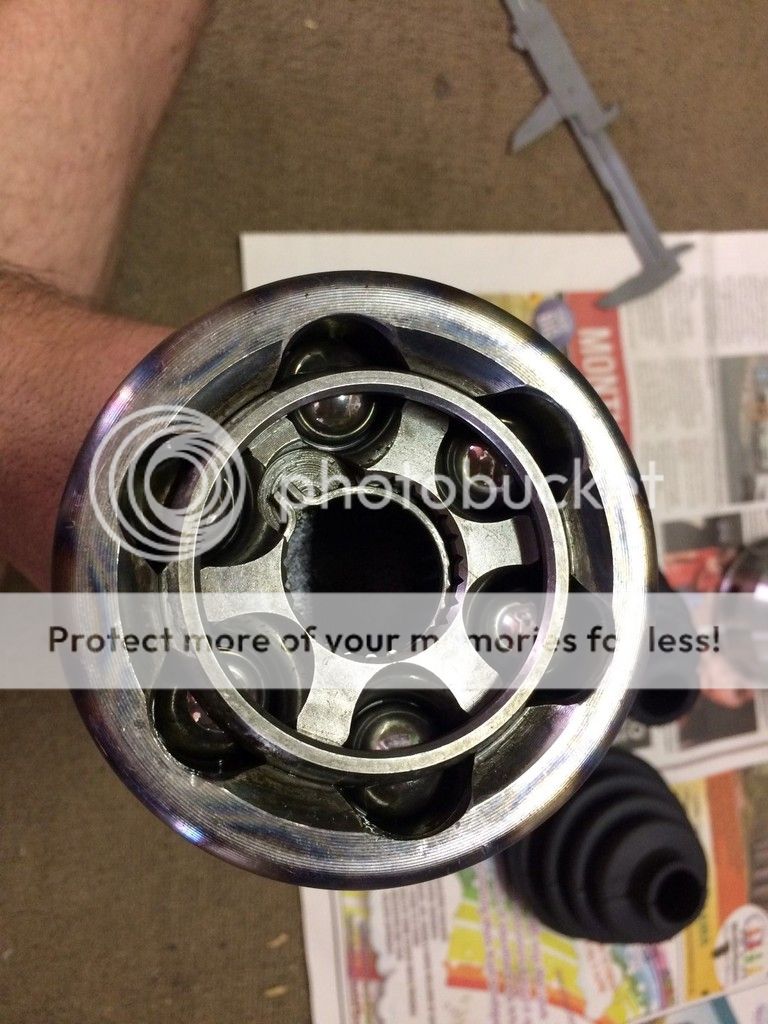

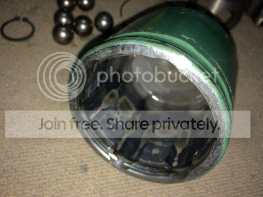

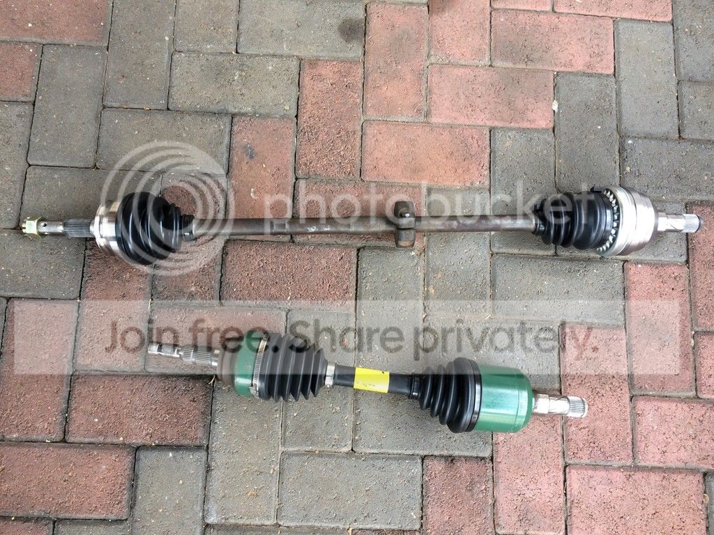

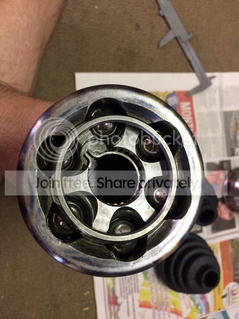

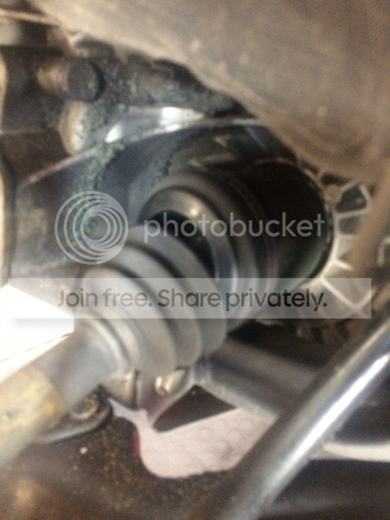

Then in May - tragedy struck. On my way home, there were some awful protests coming from the drivetrain when freewheeling / coasting in gears. Further inspection revealed that my RHS inner CV joint was crying for mercy. I also noticed that the LHS inner CV boot was torn, so there was grease everywhere.
I decided that seeing as I am pulling the RHS driveshaft, that I would replace both CV joints.
LHS Inner CV boot:
RHS inner CV:
LHS inner CV:
Completed driveshafts:
Not sure why some of the pics aren't loading, but I see some did load.
For the record: CV grease, coupled with brake dust are 2 of the dirtiest, messiest things you can ever get your hands stuck into. It was a long day of cleaning and repairing, but all is well again.

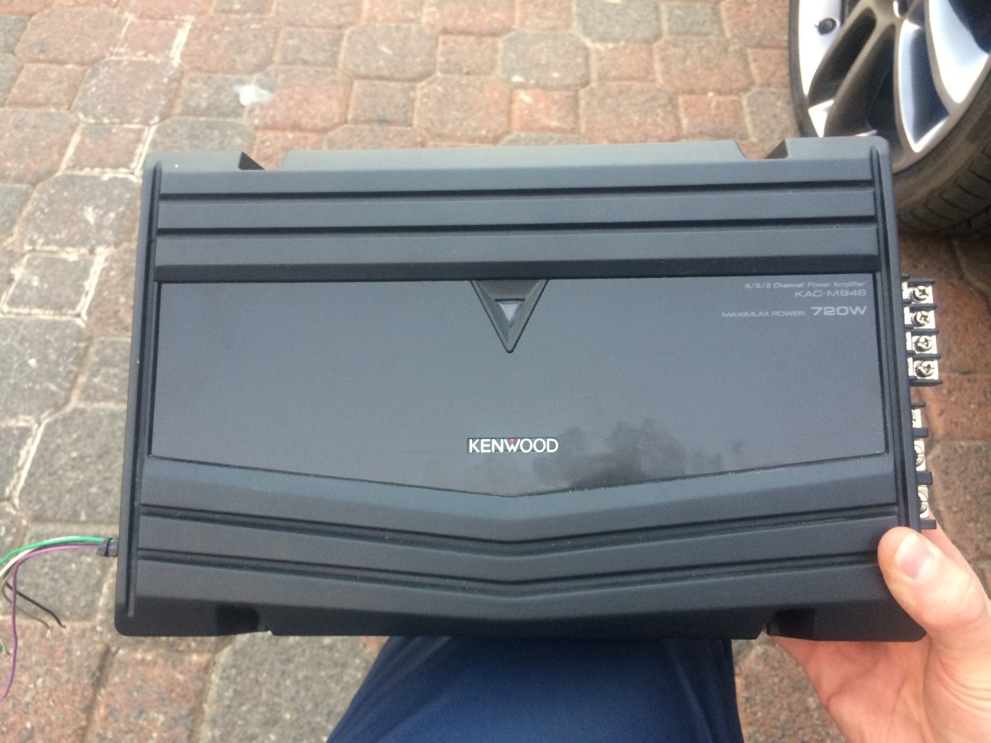

A few months back I was having some issues with the sound install. Loooooong story short - one of the issues was my amp.
So I sourced a nice Kenwood 4ch to replace my old Starsound unit was was fitted at the time that I initially bought the Ute:
It's been playing well since then. There are still some issues with the head unit, but at this stage, nothing critical. Thanks to all of those who assisted in the troubleshooting etc.

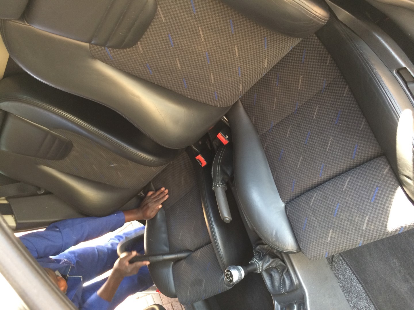

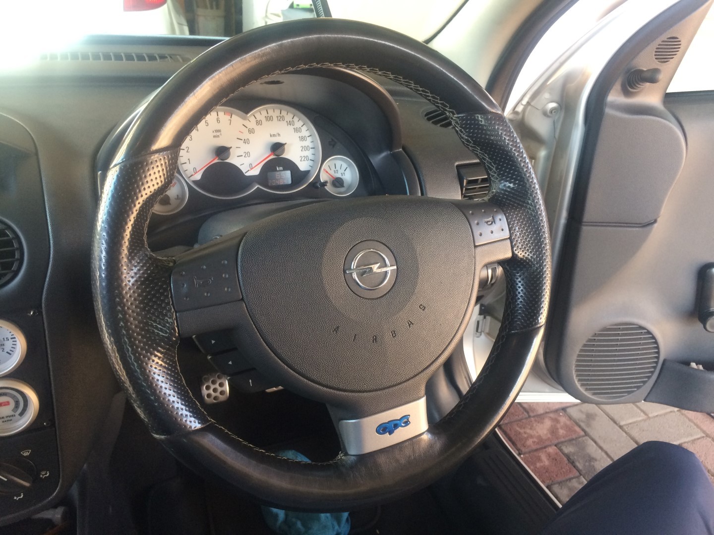

Then more recently, I decided to whip out the steam cleaner, and have a go at cleaning the seats and other leather bits. Over time, they have developed a bit of a shine and the stitching was looking a bit dull.
It's quite a process, but glad I did it. I initially started with some APC and the steam cleaner (working through a microfiber towel. Step 2 was a clean using some AutoGlym leather cleaner, and step 3 was some AutoGlym leather conditioner.
Here's some pics:
Seats after treatment:

Steering wheel before:
Steering wheel after:

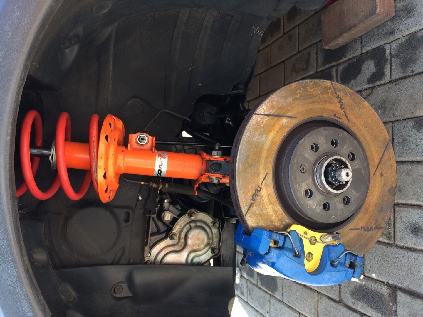

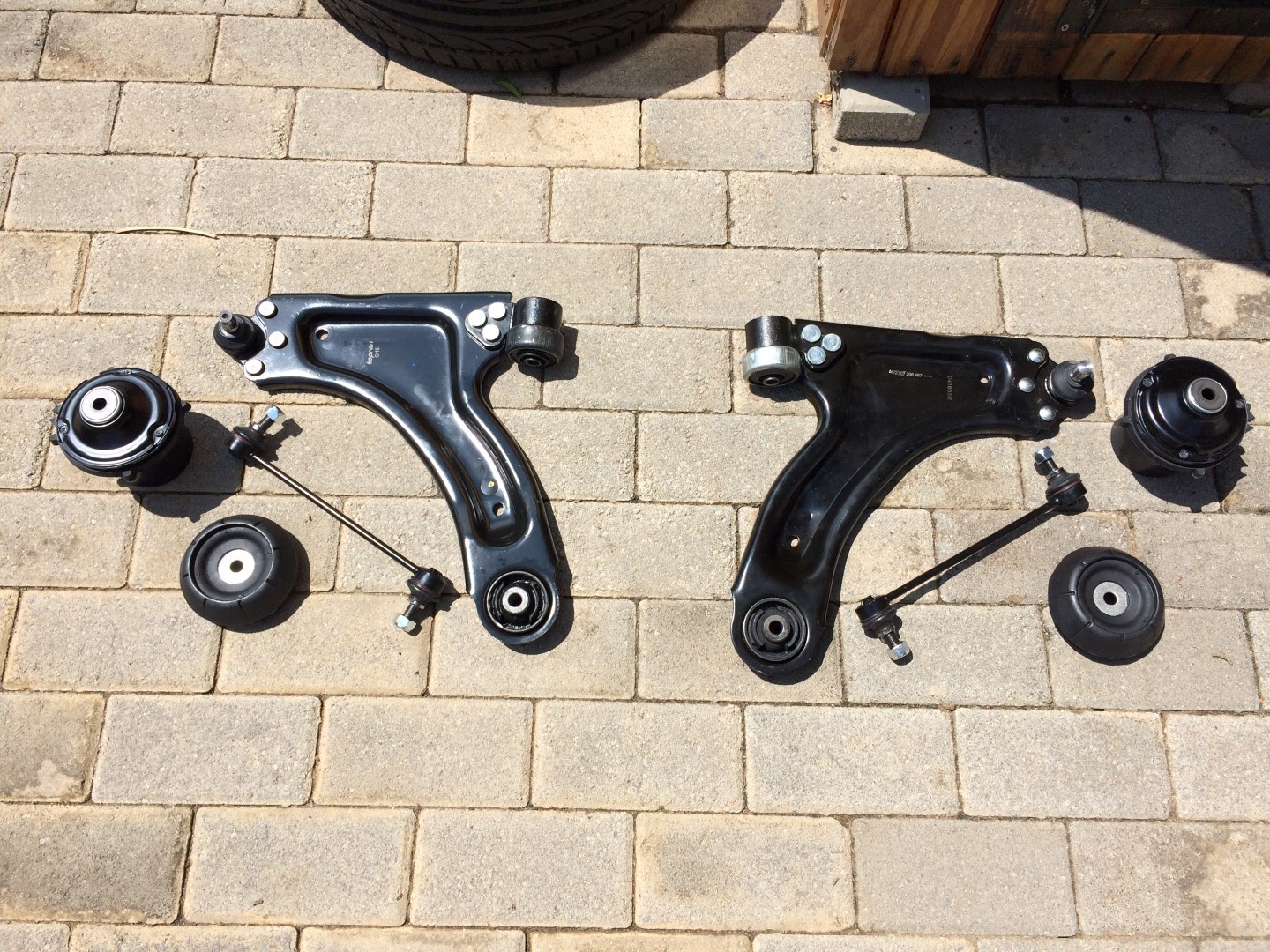

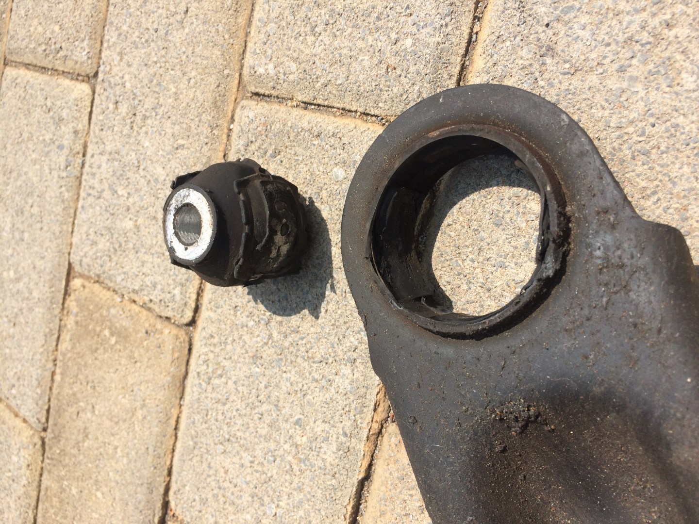

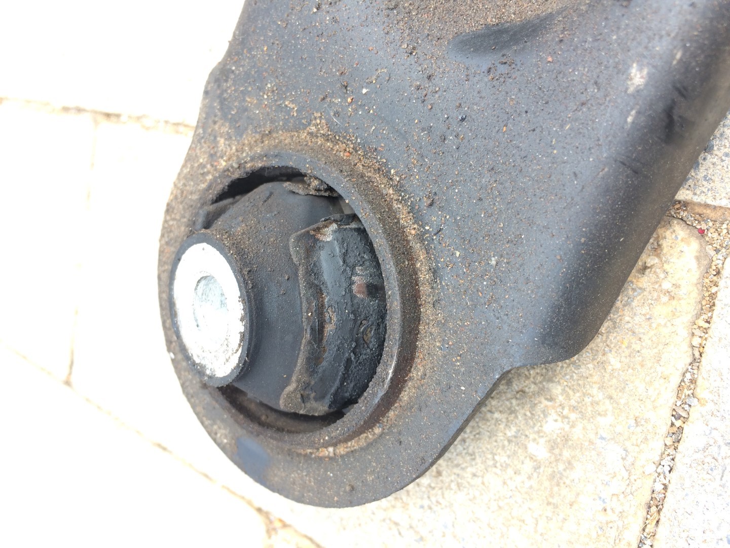

In recent times, I've had a lot of odd noises coming from the front when driving. Things also seemed to get worse, and now and then it felt a bit floaty up front when going through bends etc.
So while I was on leave, I decided to inspect the suspension. Good thing I did, found that both control arms were kaput, and the left front shock mounting had seized.
LHS control arm bush had enough:
RHS bush also on it's way out - literally:

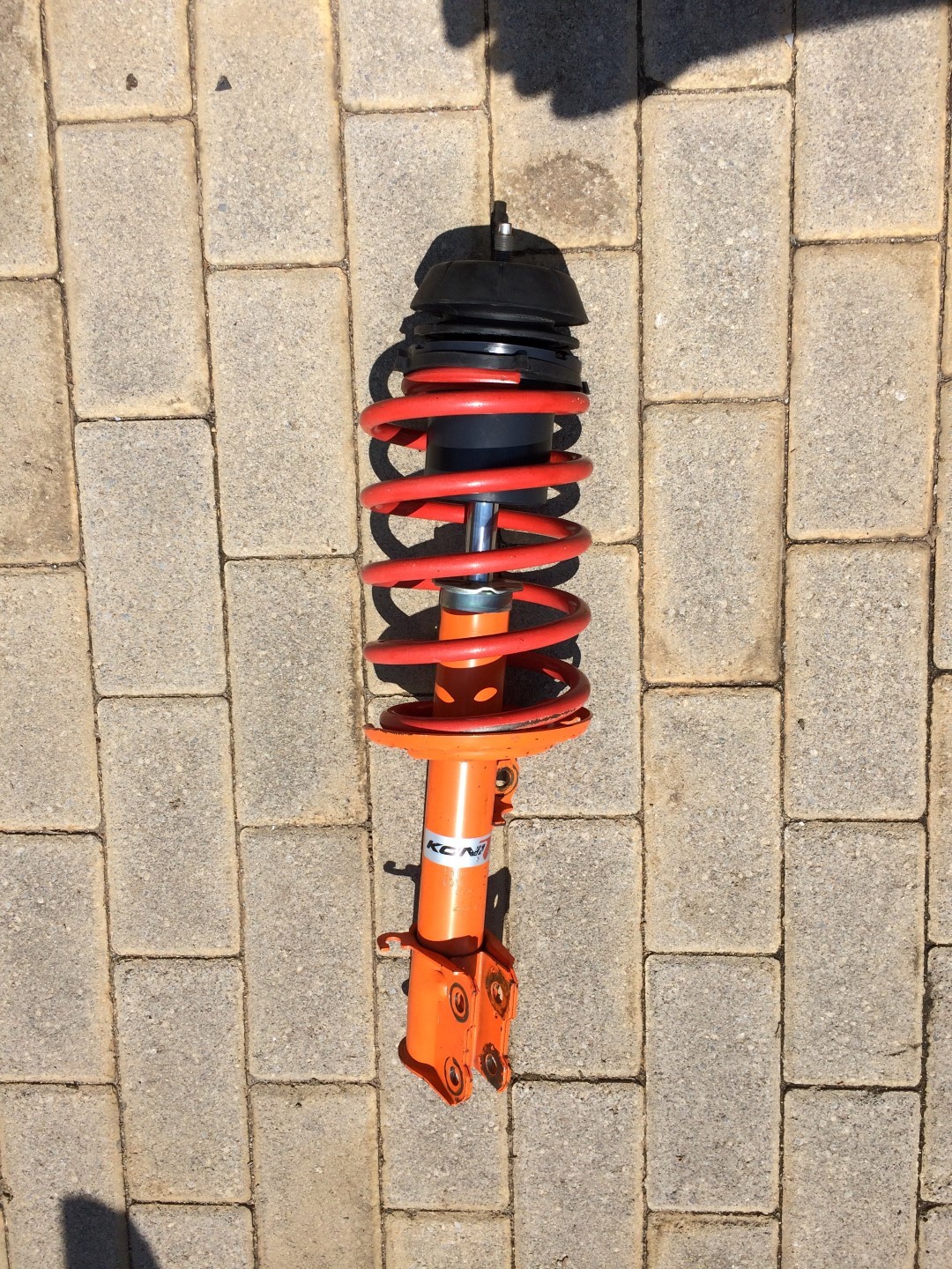

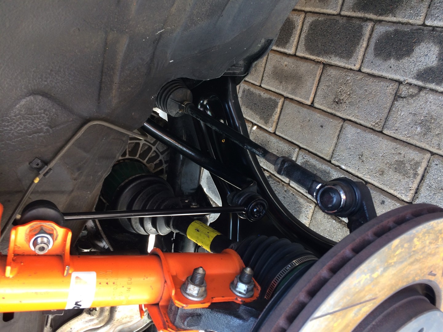

So off I went to shop for some parts. New control arms, drop links and shock mounts:
Fitted the new stuff, and also cleaned up a bit underneath as well:
Even my daughter got stuck into helping / learning:

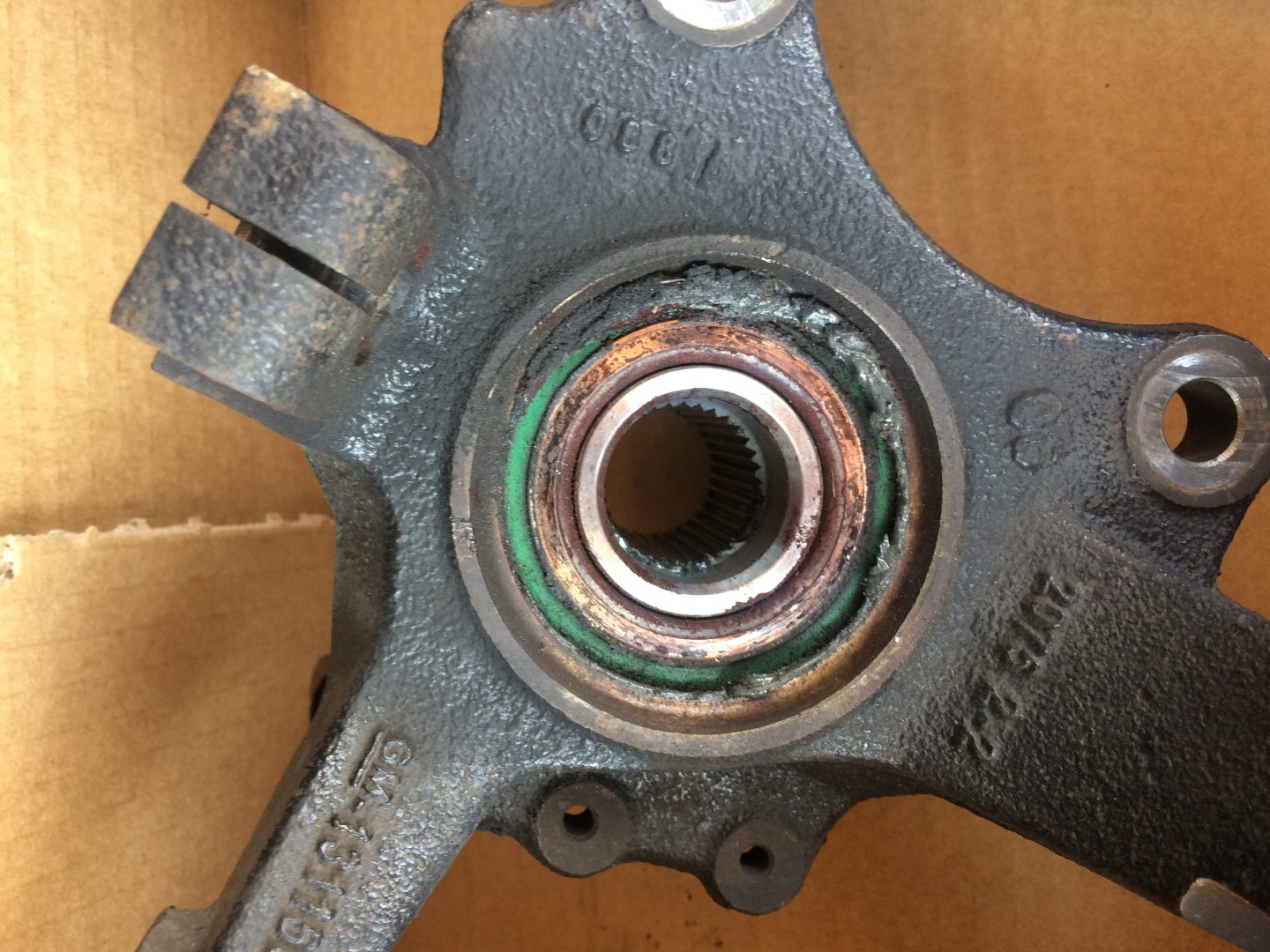

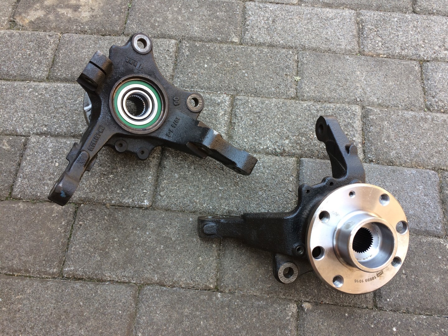

Put everything back together, and then discovered that my RHS wheel bearing was shot (I repaired this a few months ago). So stripped everything off again.
The offending bearing:
So back to the shops again, and spent more hard earned cash. Had new hubs and wheel bearings pressed into the steering knuckles:
While it was still on trestles, I convinced the Mrs to come and help me bleed the brakes. It's been 3 years since the last change, so a good time to change.

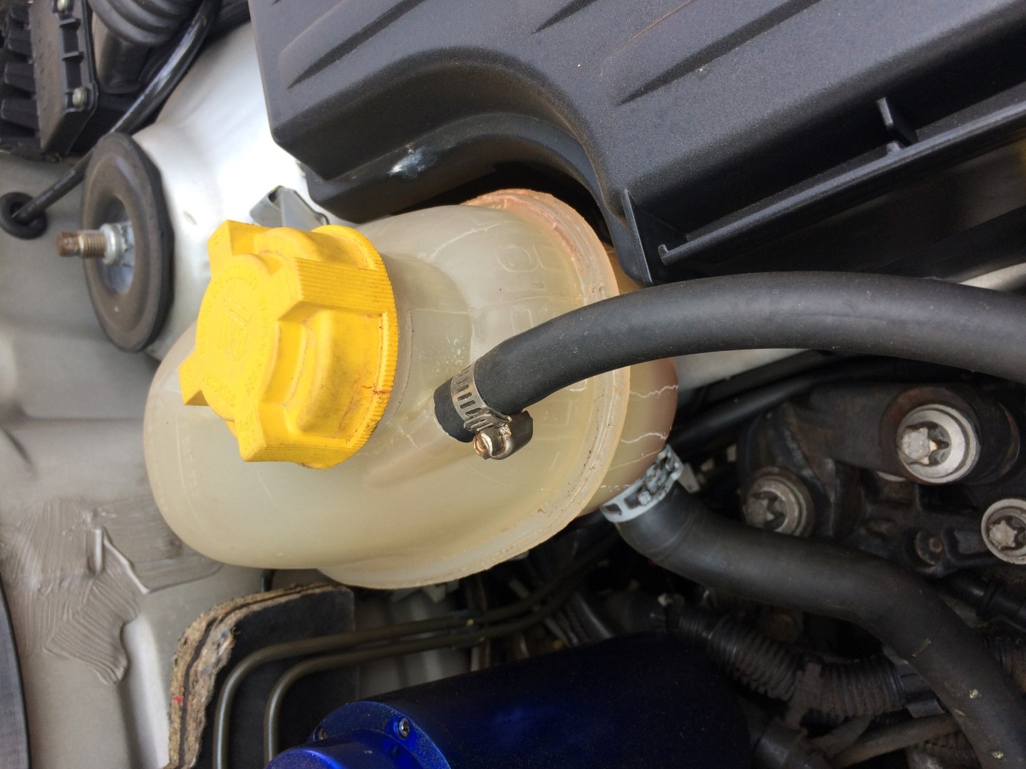

Aaaand, my water bottle cap was leaking, so decided it's time to refresh that as well, new bottle, cap and overflow pipe from the turbo to the bottle.
Before:
After:
I drove it this morning for the first time since fixing everything. It feels much more solid on the road, no clunking or clicking noises, no floatiness either. All I need to do now is the wheel alignment and then it is good for a while still.
Next repairs should be early in the new year, when I service the Ute, I'll be redoing the turbo seals and also my oil cooler pipes.
