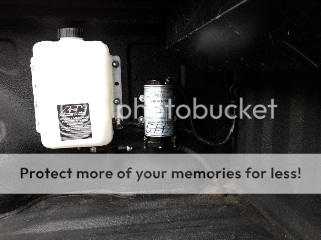

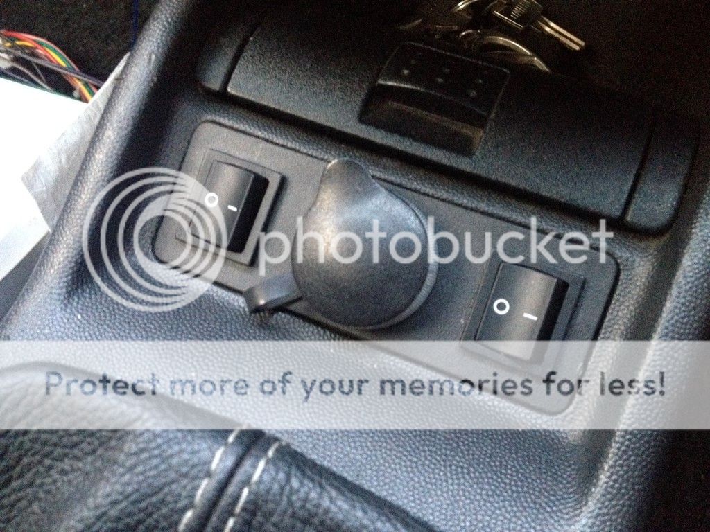

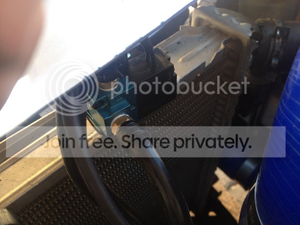

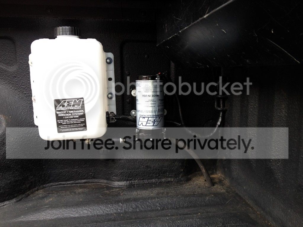

On to the install. Referring to my earlier posts, the 2nd switch in front of the gear lever would be used to arm the meth kit. I decided to mount the tank and pump on the side of the load bin, out of harms way, and where it is currently mounted, it is fairly protected from water thanks to the Armadillo.
Here's a pic of the install:

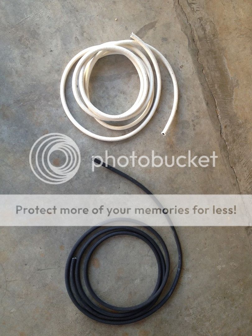

Subsequent to this, I installed the pump cover, which is essentially a silicone sleeve / sock which fits over the pump. For the meth line, I ran this under the Ute, and then up into the engine bay. I also didn't want the meth line to be too exposed to the elements and possible damage, so after some scratching at my parents house, I found a roll of braided fuel hose which my dad had from years ago. Luckily the meth line was able to fit through this nice and snug, with some mild persuasion. So very happy about this - just another layer of protection.
Here's a pic of the aforementioned fuel hose. I decided to paint the braiding black - just for that extra bit of stealth install:

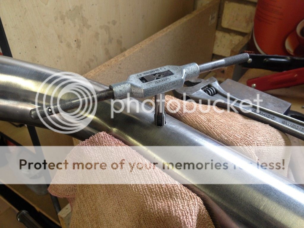

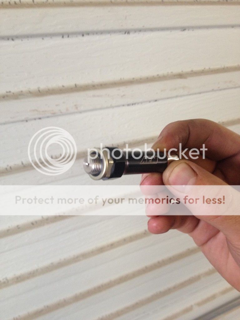

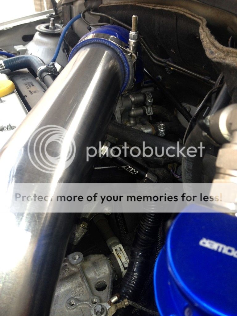

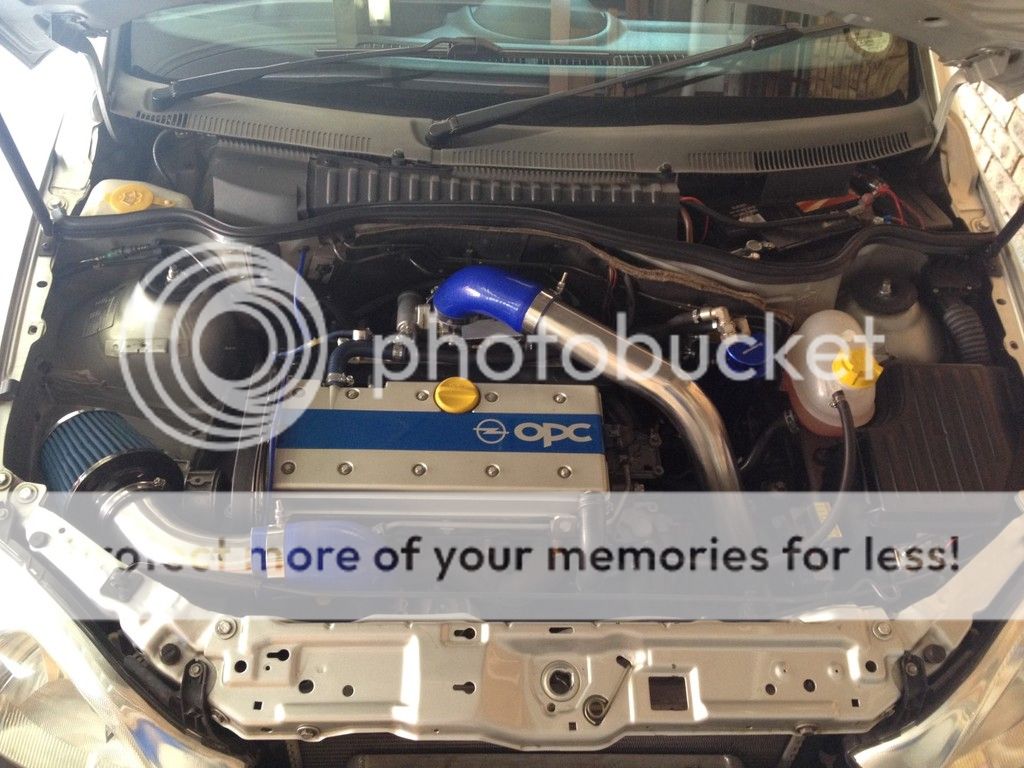

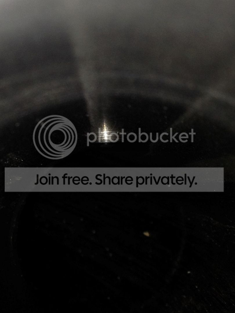

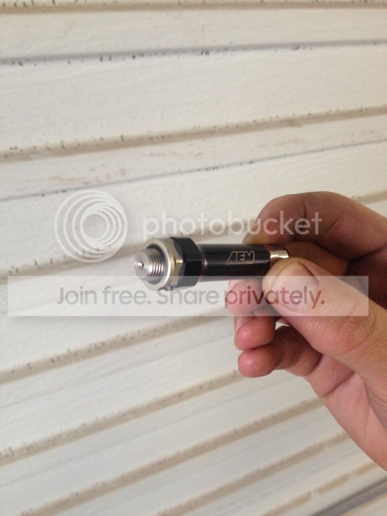

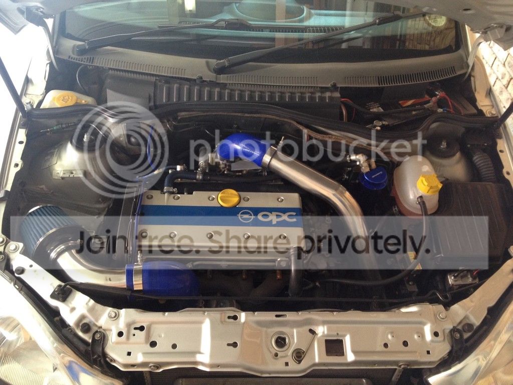

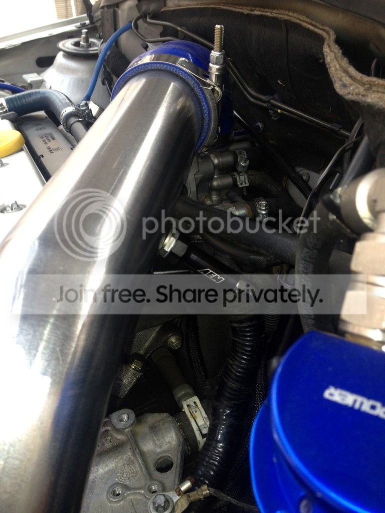

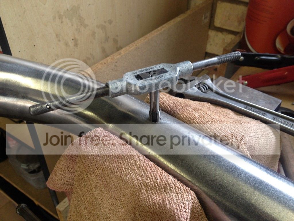

Next up was to sort out the plumbing for the nozzle. My stainless boost pipes meant that it would possibly be problematic to braze a bung onto the boost pipe, so I tapped a hole for the nozzle to fit in, and it seals with a dowty washer (great little thing this). Here is a pic of the nozzle installed into the fitting which houses the integrated check valve, and the dowty washer:
My plumbing efforts - going well:

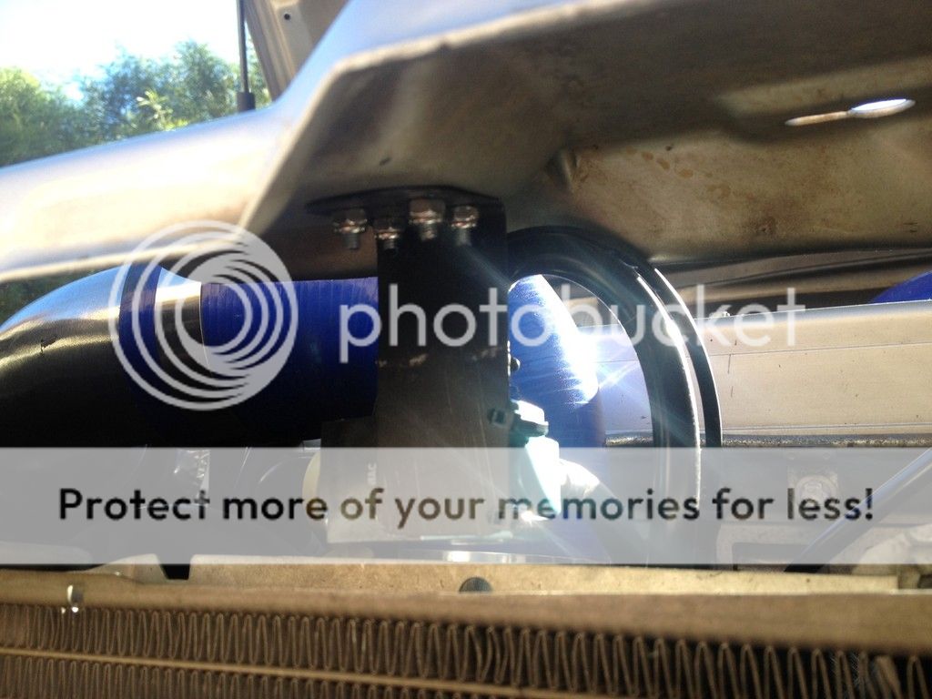

I installed the nozzle at the back of the boost pipe, so you don't really notice it unless you look for it:
View inside of how the nozzle sits:

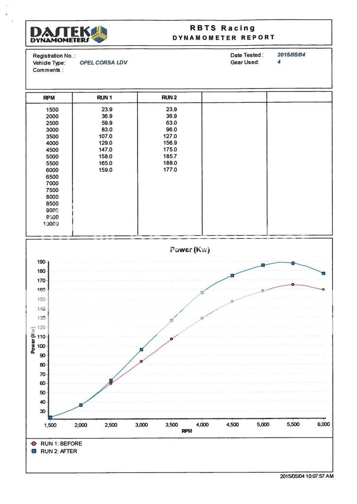

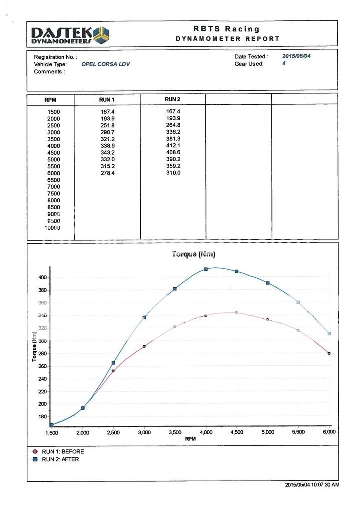

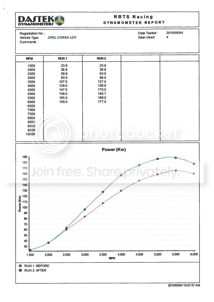

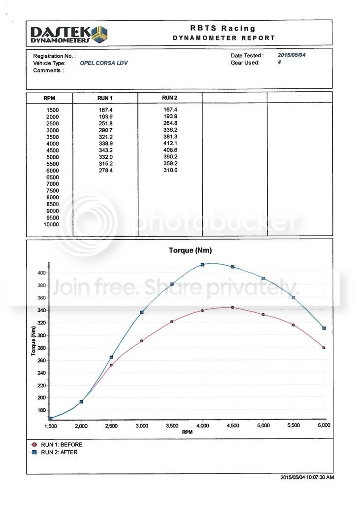

Next up, tuning time with Ross @ RBTS Racing. Went through early on a Monday morning, and after setting the Ute up on the dyno, he proceeded to work his magic. After a while he popped out the dyno room and told me the meth controller is cutting out (as it did with me during testing). He thinks it’s something to do with the boost safe output, so we disconnected that, and then he had no problems after that.
30mins later he was finished and ready to go for a test drive. When he got back, Bern asked for comments to put on the job card. His response: “It now brakes traction in 2nd gear, otherwise great to drive”.
So we all had a good laugh about that. He is happy with the outcome, there are no worrying noises of detonation etc, and it’s very driveable. He’s set it to around 1bar boost (give or take a few decimals depending on atmospheric conditions).
These are the results:
Leaving RBTS, I gave it a few squirts down Pomona and on the highway – much much stronger. You’ll see from the graphs that the powerband is the same, just bigger curves. It feels great on the road, smooth with no funky peaks and troughs. The mid-range is awesome! Just what I wanted for a daily driver.
