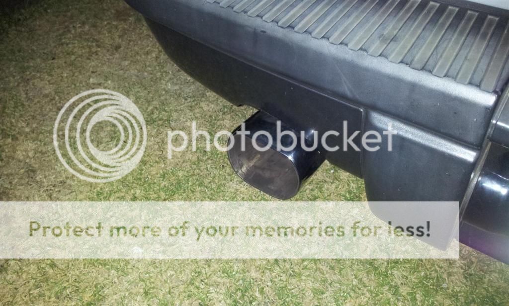

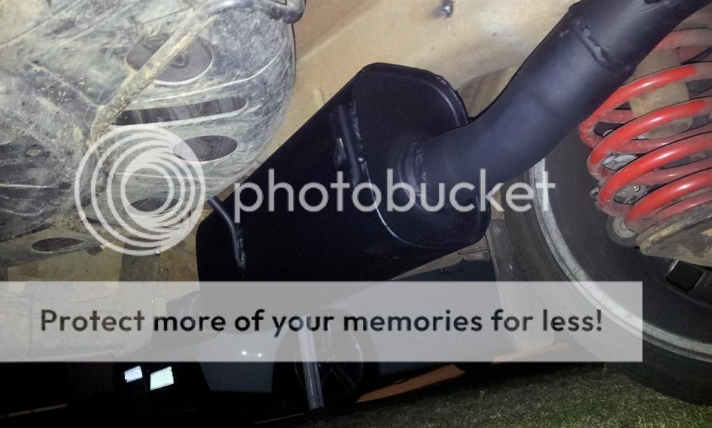

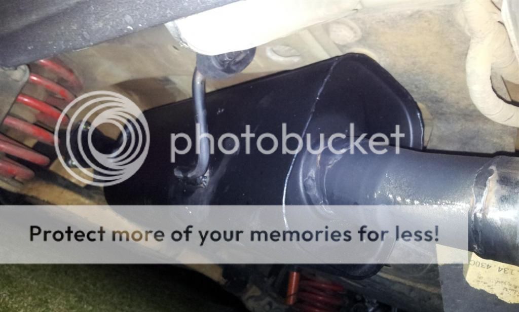

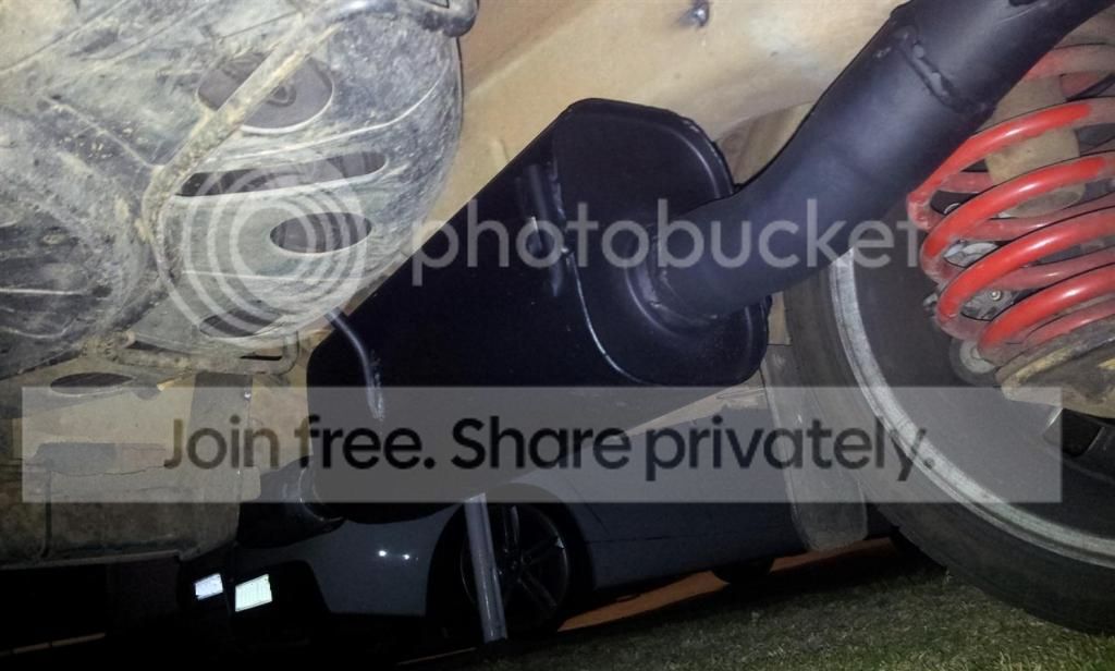

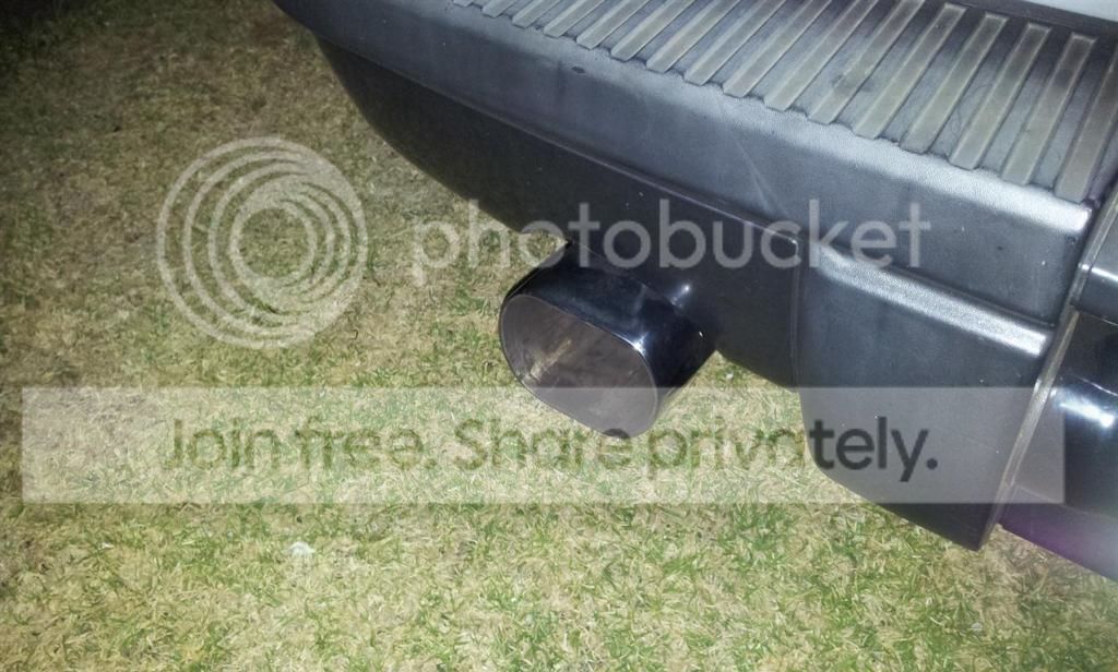

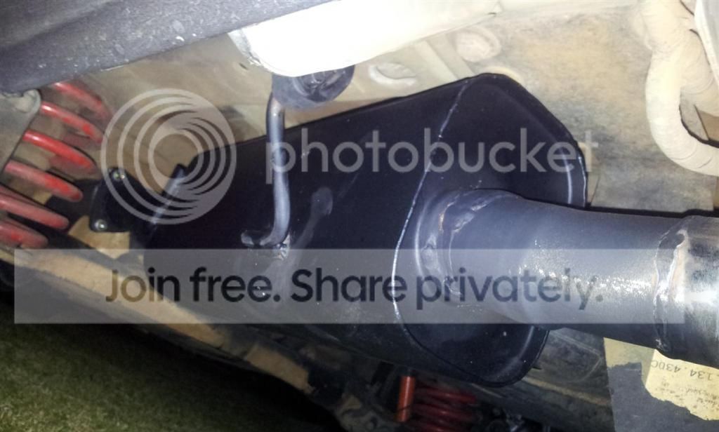

Anyway, something I did have done was fit a new back box to my Ute. It was just too noisy and droned like a donkey on the highway, So I hooked myself up with a Remus OPC H back box. Had it fitted at TNT earlier this week, and I am very happy with the outcome.
It sounds just like a stock car again. Nice and quiet on the inside. I was worried that it would still drone a bit because of the tiny middle box, but so far so good.

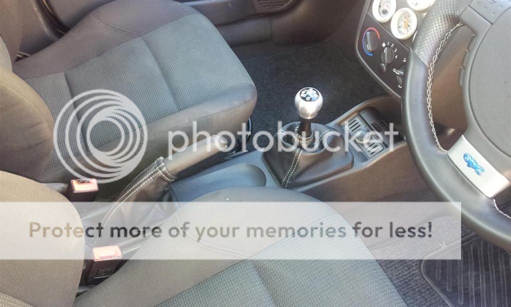

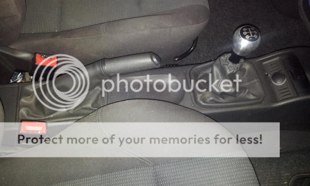

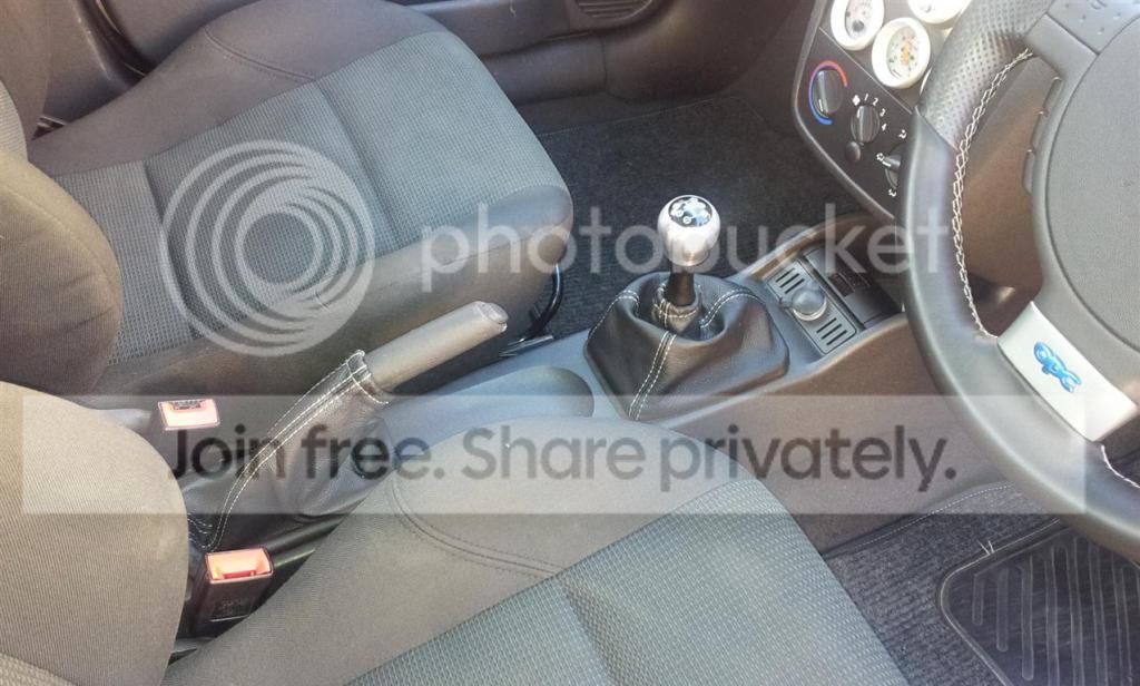

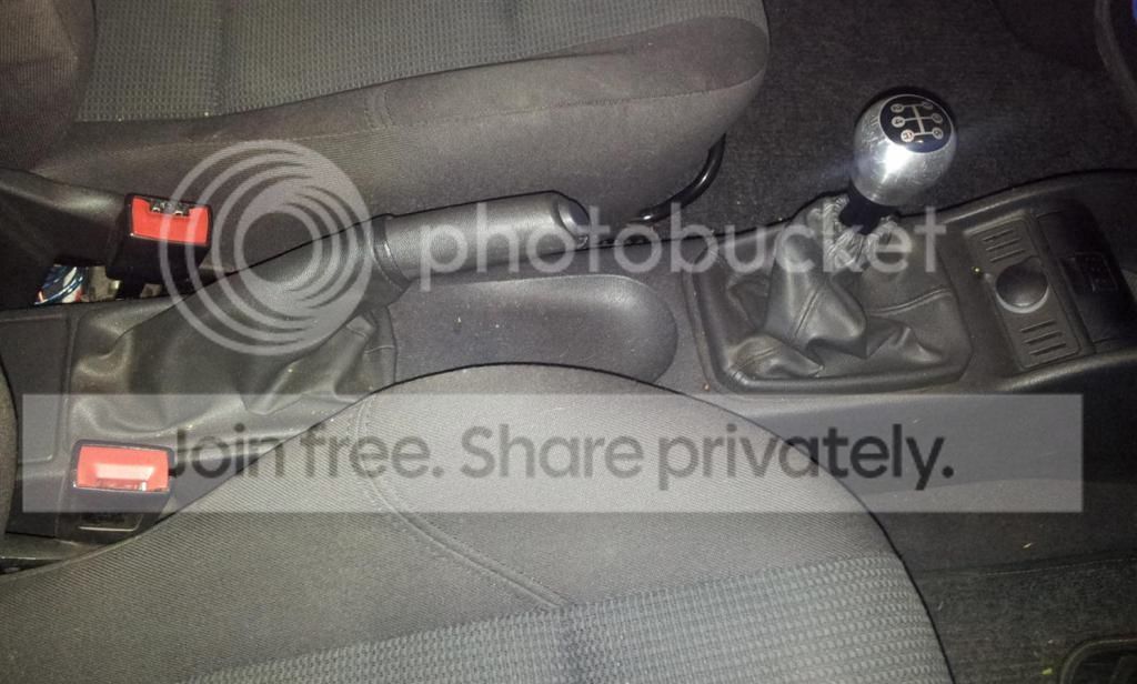

Quick update, got some other bits in the post at the end of last week. Custom made, with stitching to match my steering wheel.
Before:
After:
Now I just need some OPC G seats, and I'll be sorted on the interior :D

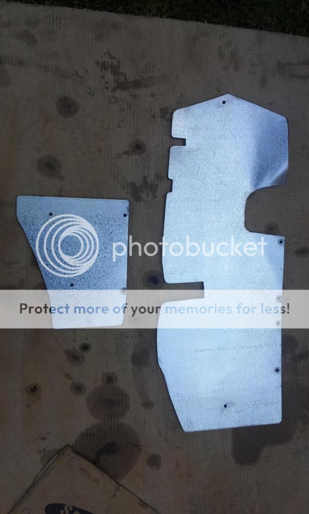

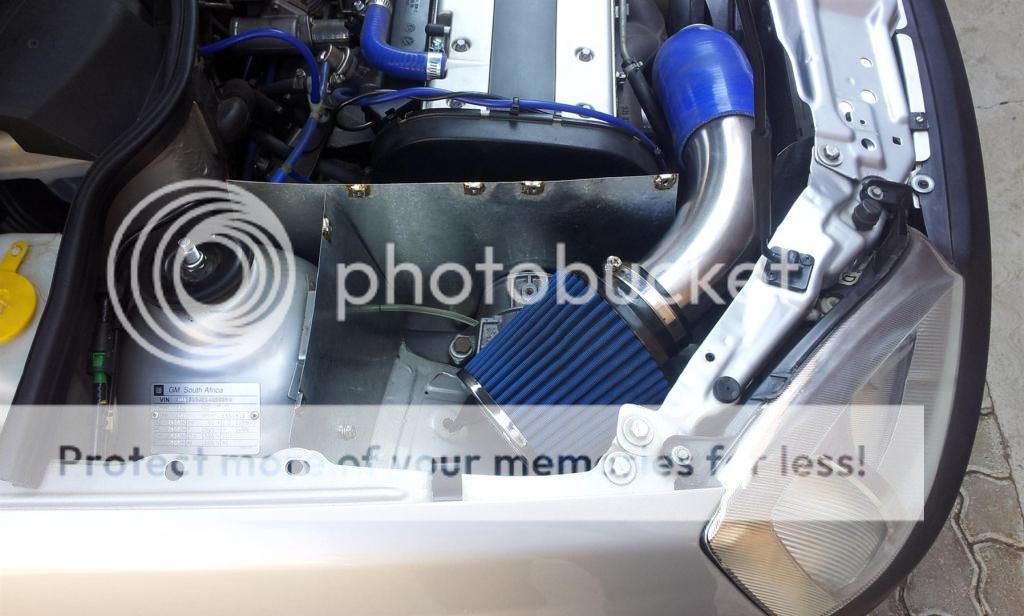

Following on from measuring intake temperatures, I wanted to build an enclosure for the filter for the following reasons: 1) insulate from some of the heat, 2) tone down the induction noise.

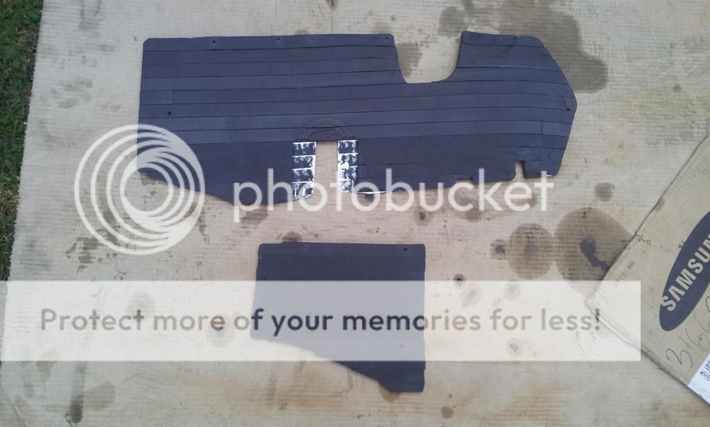

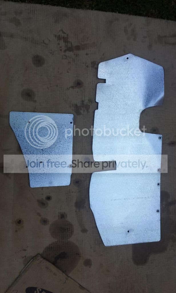

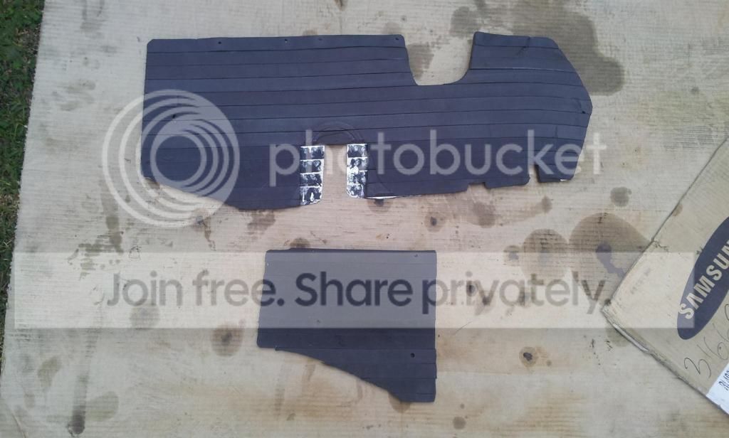

I started off with some cardboard templates, and after much cutting, measuring, fitting, cutting, and so on, I ended up with the following:

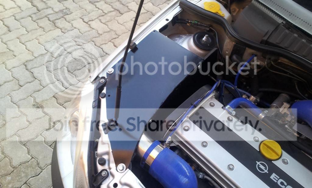

I also made a lid for it too:

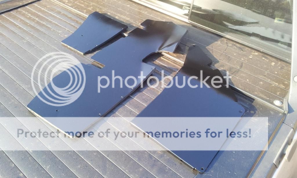

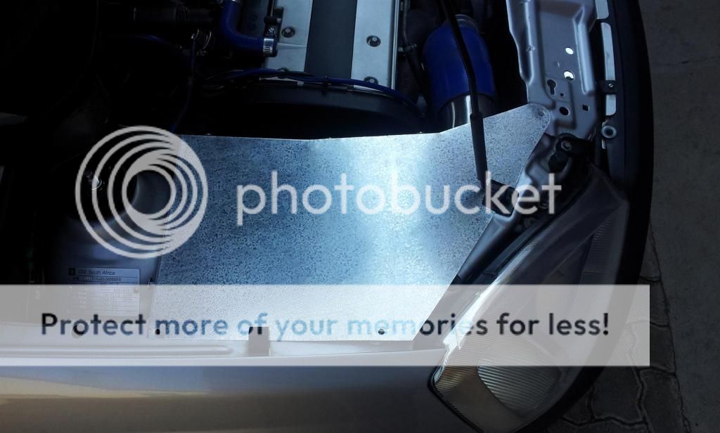

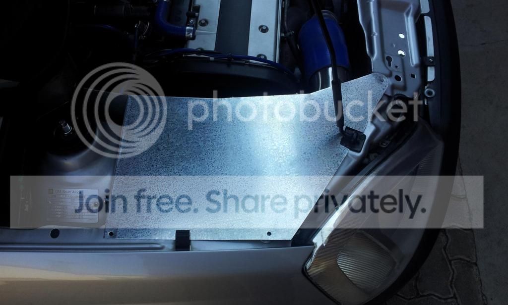

After some more trimming, these were the final bare pieces:

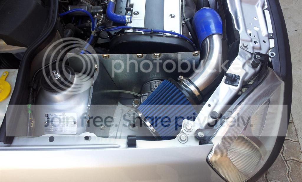

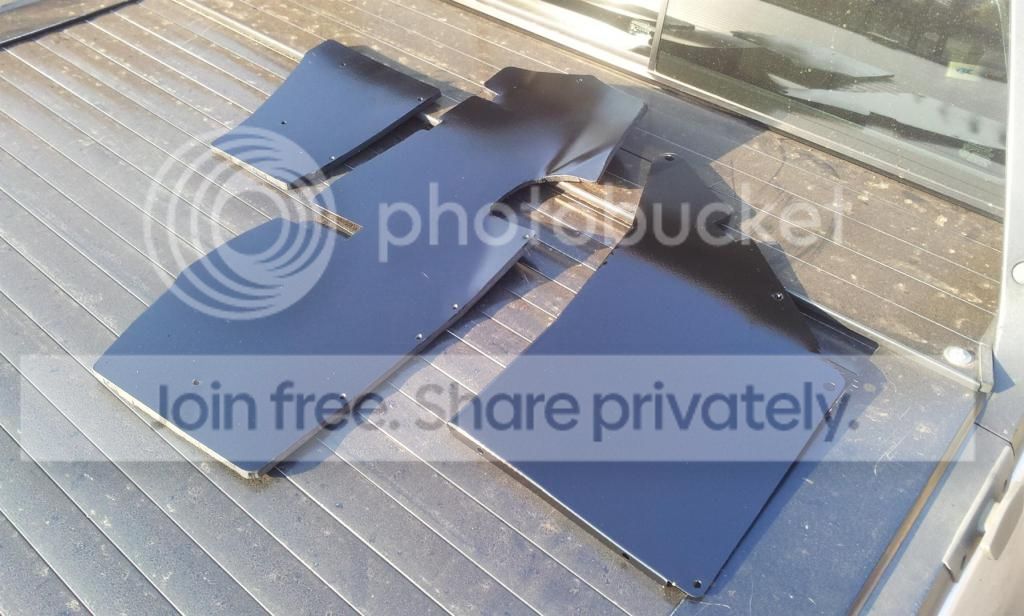

For heat insulation, I used heat-resistant paint on the one side, and then insulating foam on the other side. I did a couple of scientific tests using open flames etc, and I can confirm that the insulation properties are pretty good, lol.

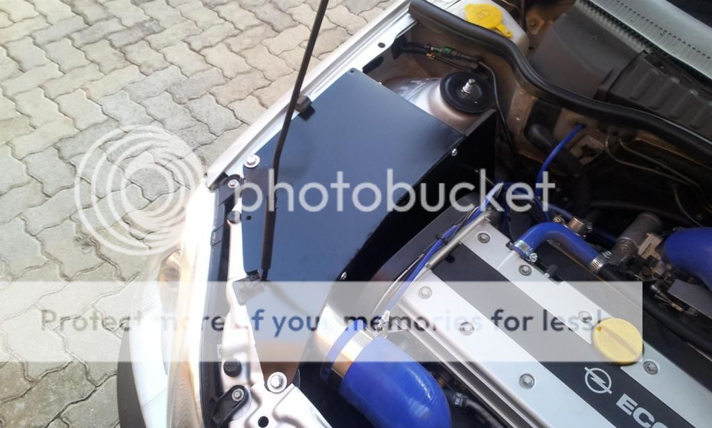

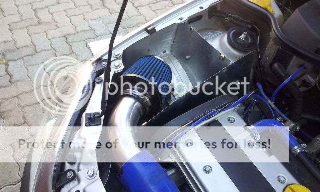

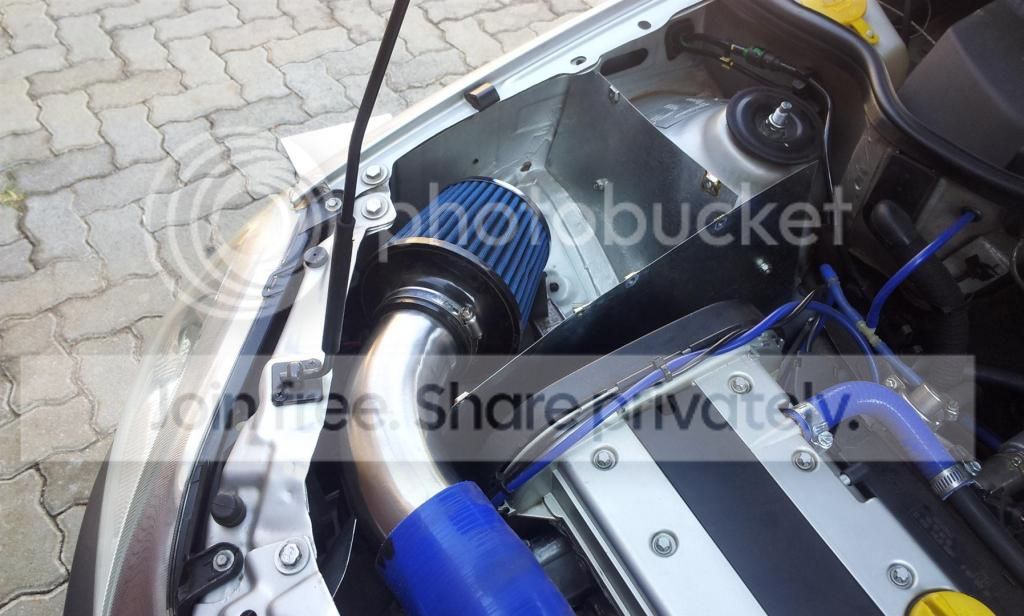

And here is the final product, all fitted:
Onto the results. The noise is definitely toned down quite a bit, but you can still hear that there is something cooking under the hood. But overall I am happy with the result.
In terms of heat insulation, I have tested for a while now, and I can honestly say there is no noticeable improvement in the temperature of the air which surrounds the cone filter. The figures are pretty much the same as without the heatshield in place.
So, the above results can be for various reasons. 1) My airbox effort is not a 100% tight seal everywhere, there are some small gaps, where hot air could still enter. This also applies to the noise. 2) It could also be residual heat filtering through the chassis leg, and fender. 3) I didn't have millions to R&D a proper plastic airbox that seals 100%.
So in conclusion, the noise has been toned down a bit, but there is no real improvement in air intake temps. Plus the turbo heats up the air anyway, so effective intake temps will always be 3-7deg above ambient (based on my previous testing).
