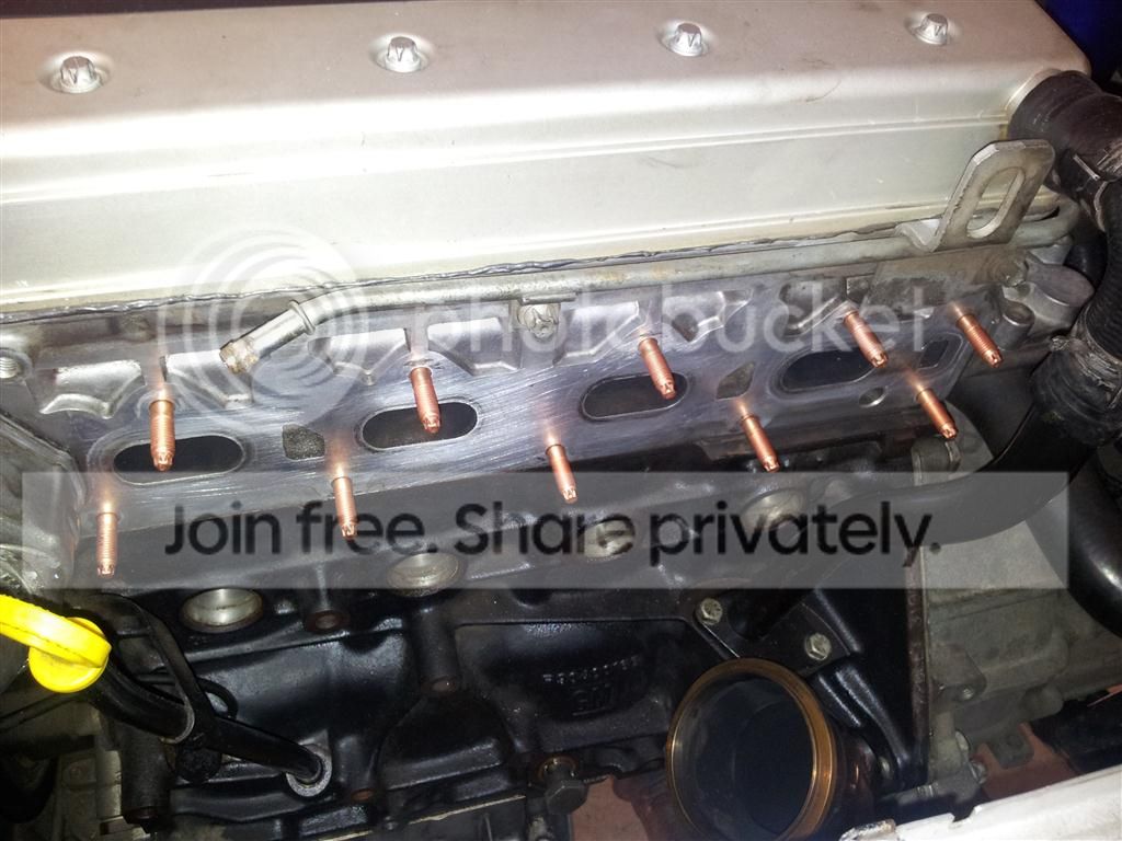

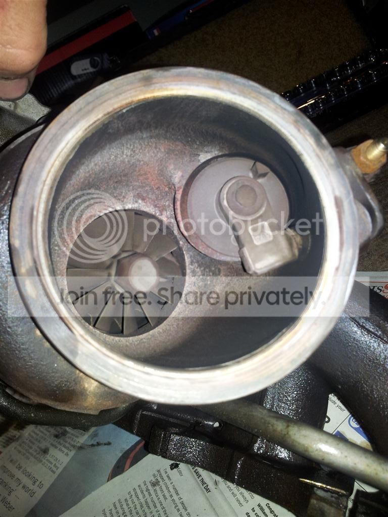

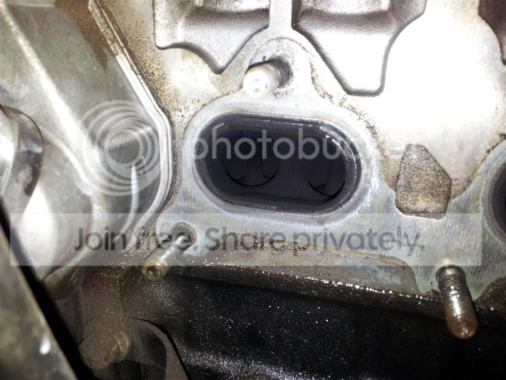

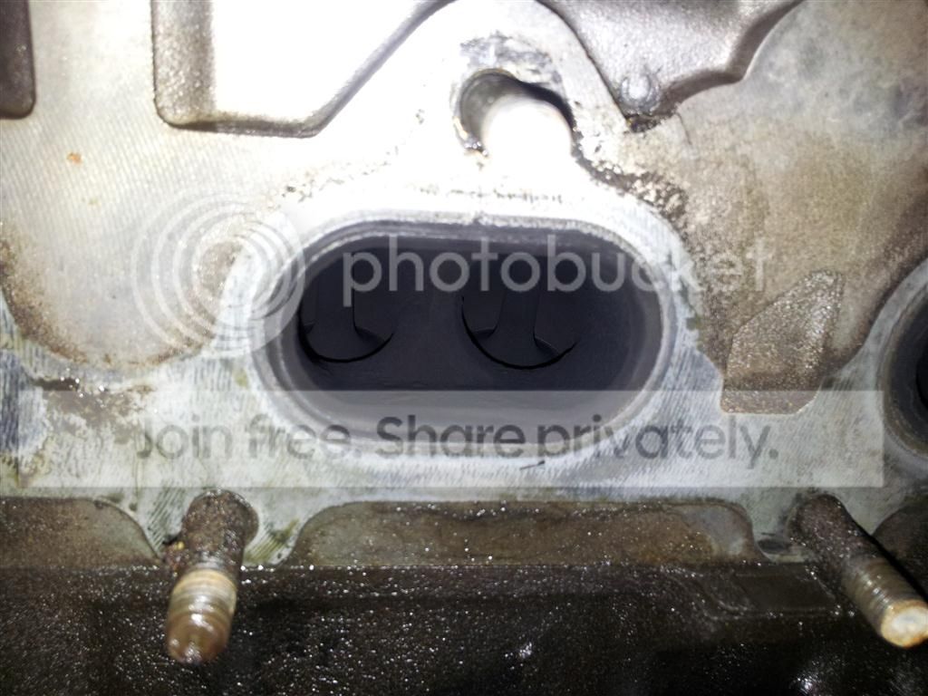

Late yesterday afternoon, I decided it's time to do the turbo swap. The Ute has been smoking a lot more recently, so I decided to give it a bash. Everything has gone smoothly so far. What I managed to get done yesterday was remove the turbo, strip the water and oil lines off the LET turbo, and clean up these pipes, along with the face of the head. Tonight I'll pick up where I left off, and hopefully get the new turbo fitted.
Here are some pics:
Pic of the turbo removed, and the head studs removed:

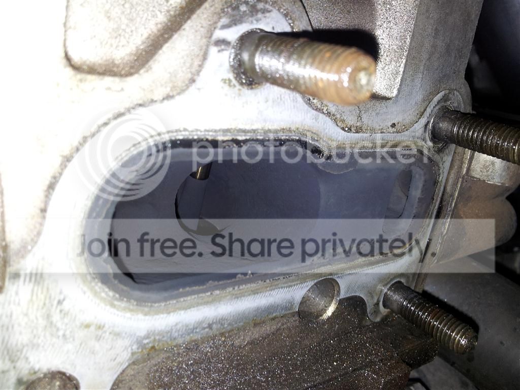

Port 1:
Port 2:
Port 3:

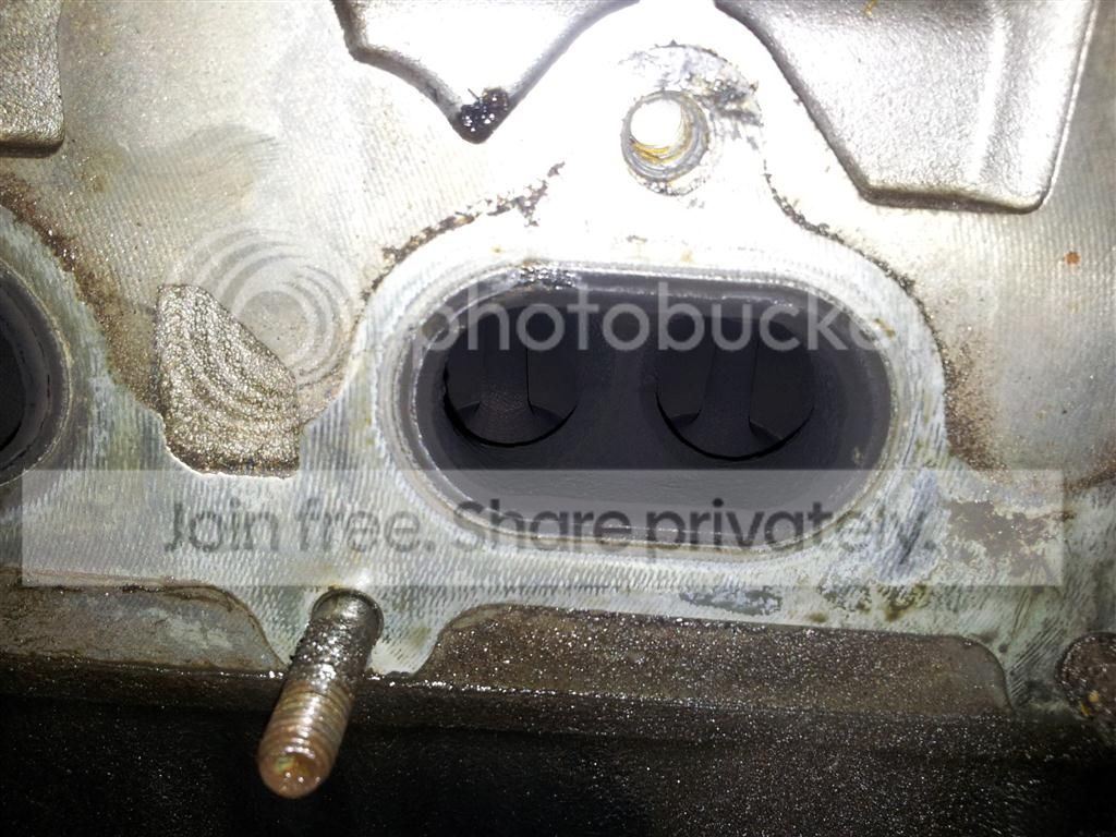

Port 4:

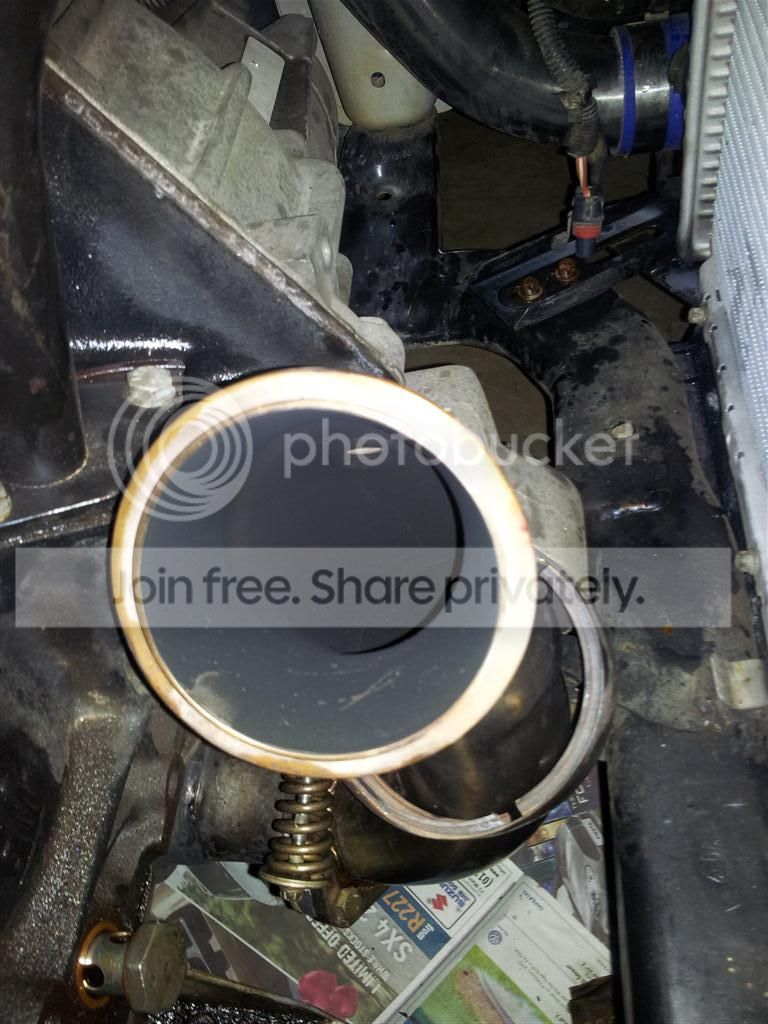

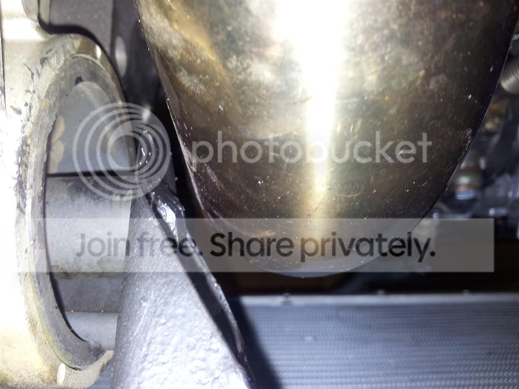

Downpipe:
So as you can see, it's fueling lekker, lots of soot in there :D

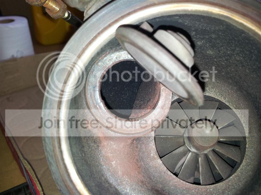

Then I just had a quick look at the LET manifold, but I haven't seen any noticeable cracks anywhere - so that's a good thing. Here's a pic of the actuator flap:

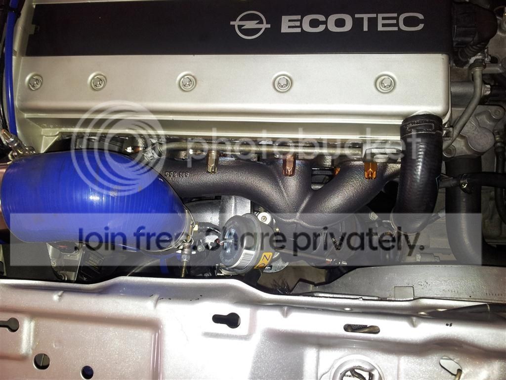

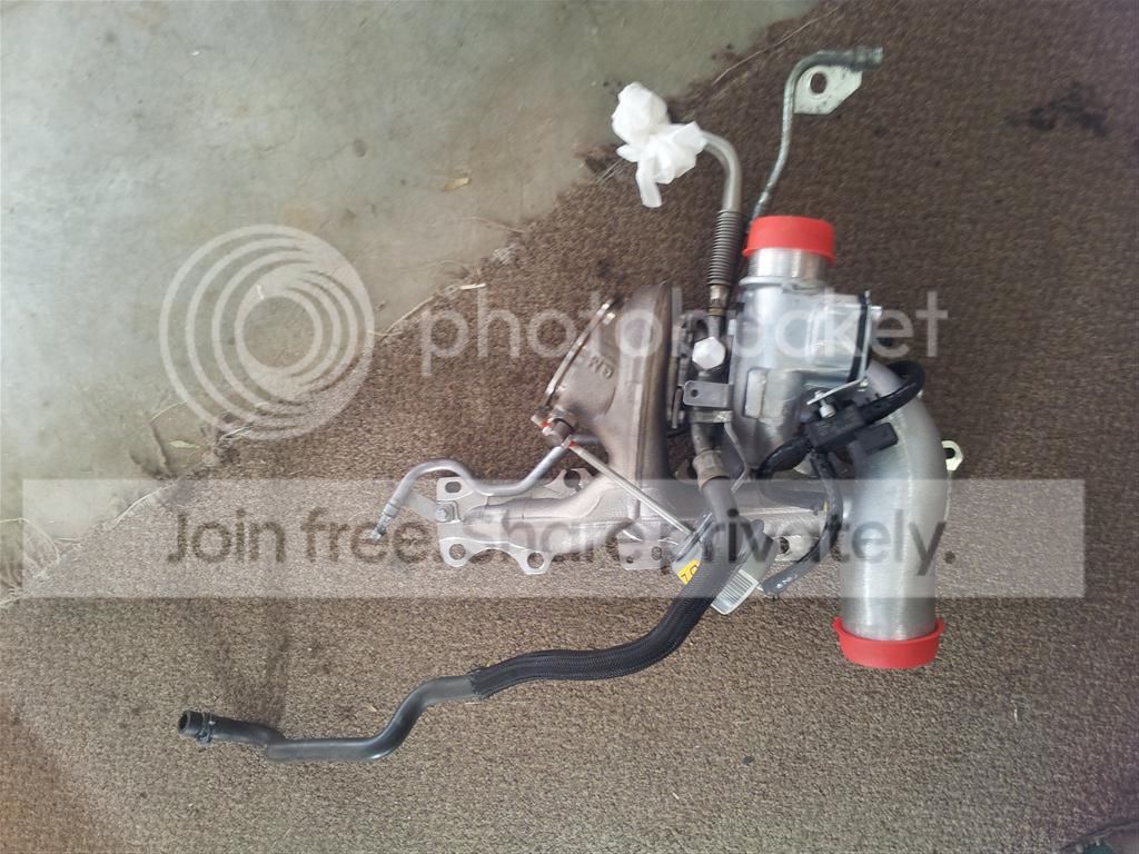

Ok so on Friday evening, I completed the fitment of the VXR turbo.

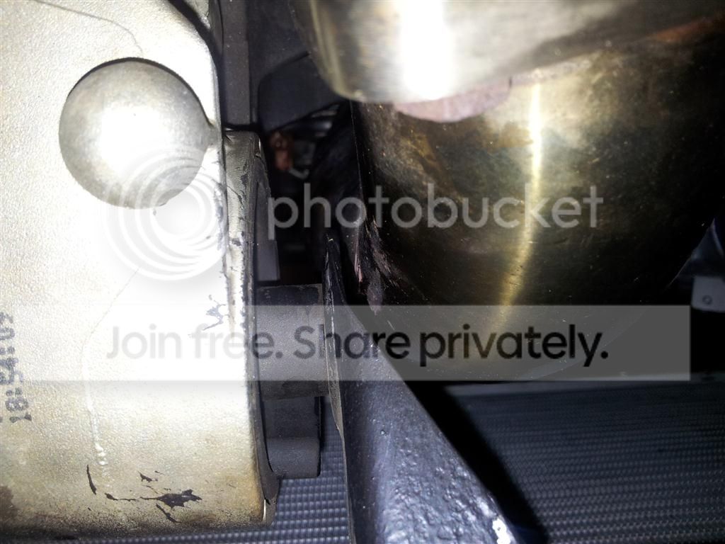

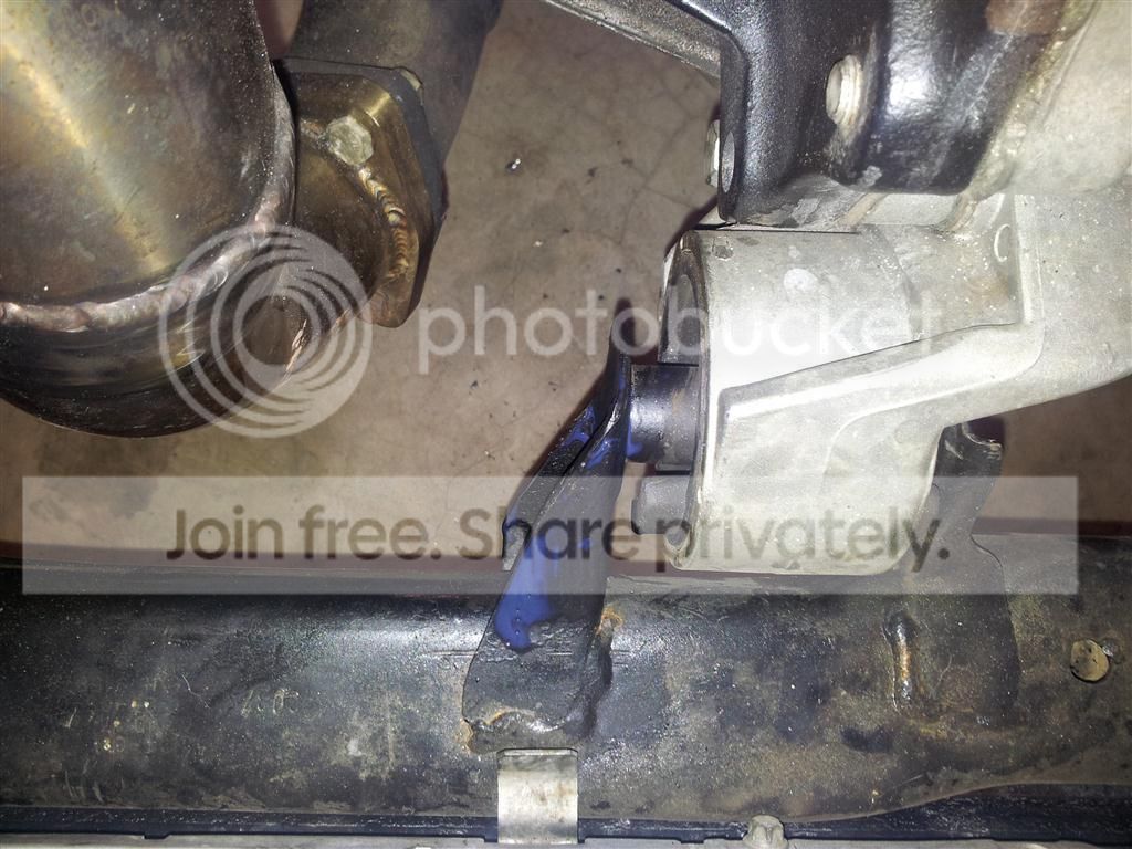

Before I did that, I had to make some minor mods to the front mount, as the downpipe was still touching on it when under partial load - very annoying. So in the pic below you can see I ground away some of the end of the mounting, and also flattened off the nut and bolt:

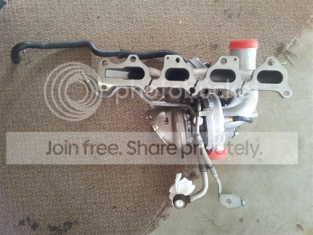

Then here's some pics of the LET turbo's oil and water lines fitted on the new VXR turbo:

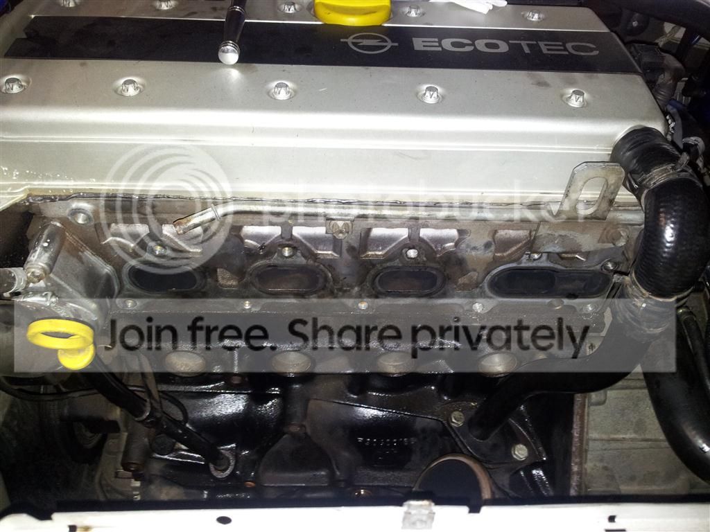

New head studs fitted:
Turbo fitted, job complete:
Here's some pics underneath, you can see how little space there is between the downpipe and the mounting. That gap is approx. 4mm, after making some space for it :)
I started it on Saturday morning, all is running 100%. No leaks :party0031:
Then went for a brief drive this morning, everything feels good, the rattle from the downpipe also seems cured.
Special thanks to Allen & Danny for the tips and advice, and also Fox for his post with all the torque settings. This came in handy. Oh - and also thanks to Chris Hart on YouTube for the very useful step-by-step vid on how to do the swap.
Then lastly, I had a more detailed look at my original turbo - loosened the wastegate, and found a couple of small cracks behind the wastegate:

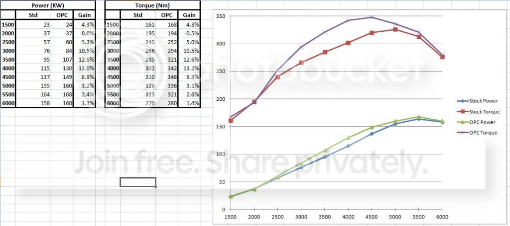

The results are as follows: 168wkW and 348wNm - at 0.7bar boost. :D
He wasn't able to boost higher due to pinging. Unfortunately so, but rather reliable than destructive.
Overall, the Ute is nicer to drive in real-world driving conditions. There is more mid-range power and torque. At the top end it's about the same. The turbo is also quieter than the old one, but give it horns and it chatters and chirps like a budgie high on fermented fruit, lol. I also noticed that there is an addictive crackle and pop out the exhaust on the overrun (if anyone has driven the Turbo Mini Cooper S, you will know what I'm talking about).
So overall, I am happy. It would've been nice to have 180-200kw, but I would much rather have a reliable daily driver, which doesn't break the bank each time I need to fill up with fuel + whatever other fancy additives are required.
Graph comparisons below:

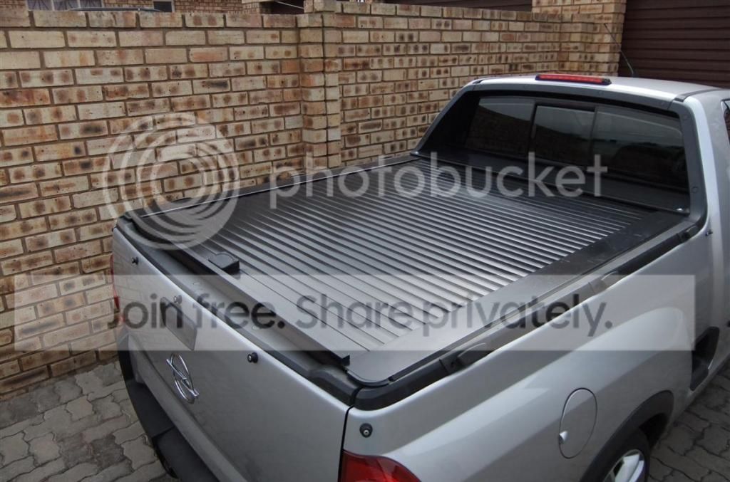

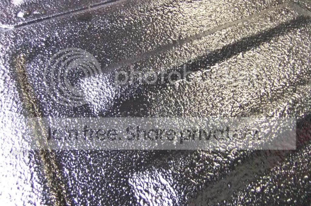

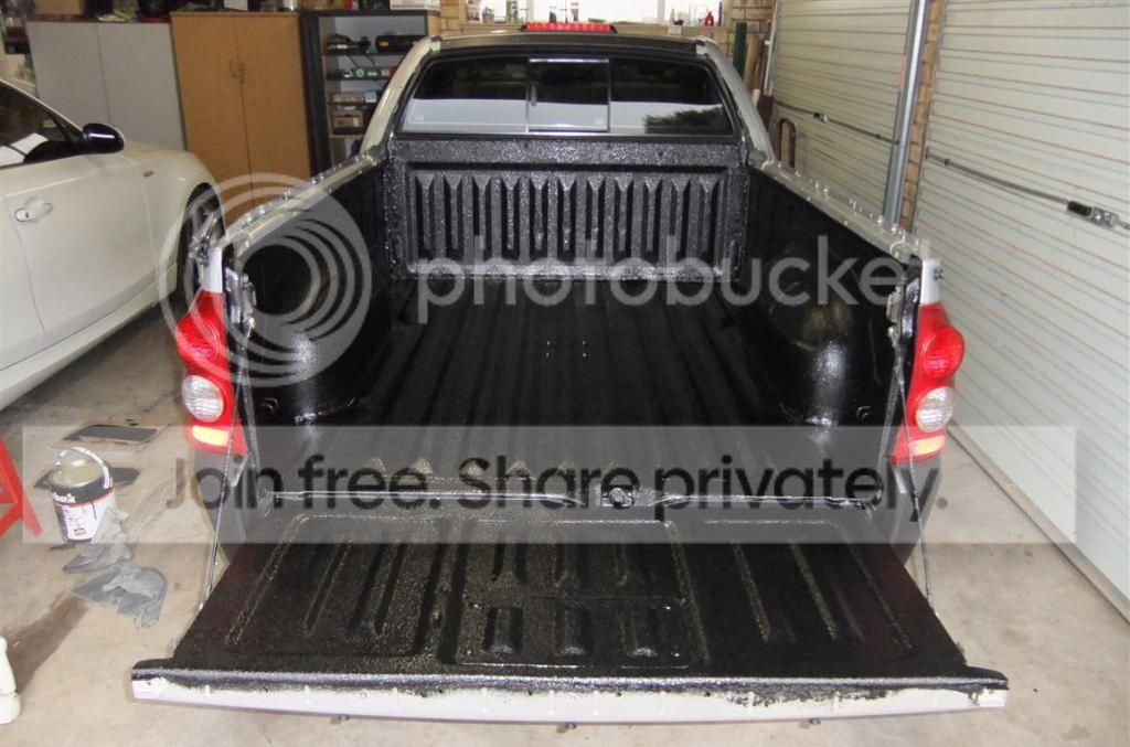

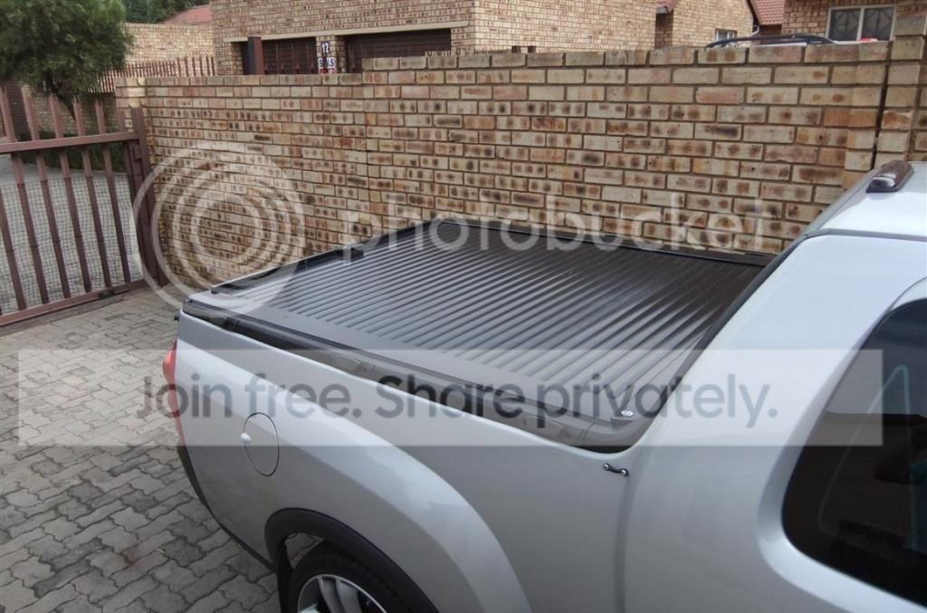

On another note, I decided to change to an Armadillo roll-a-door at the back. Managed to pick one up for a good price. It's got a few nicks and scratches, but I'll sort that out over time. I also rubberised the back with some Durabak (birthday present from my wife last year). That was a mission, that stuff is super messy. I suggest anyone who uses this in future wears gloves! Nothing takes that stuff off your hands if you mess, lol.
Here's some pics:
Apart from the security benefits of the Armadillo, I thought it might be better at high speed. With the vinyl cover, it started to make a horrible "clapping" sound at about 190km/h. Now with the Armadillo, that threshold has moved up to 200km/h. Then it still makes the clapping noise. I guess I will need to research some aerodynamic changes I could do if I want to do anymore top-end runs, lol.
