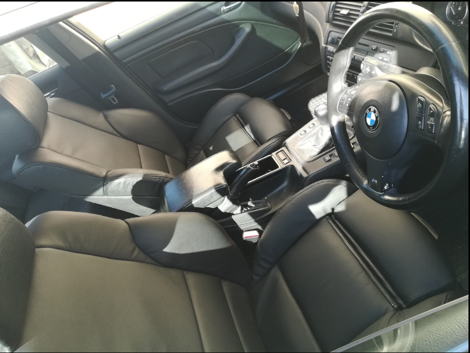

Installed The seats into my Car...
they dont look bad. can sport them for a while..

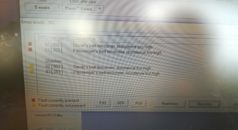

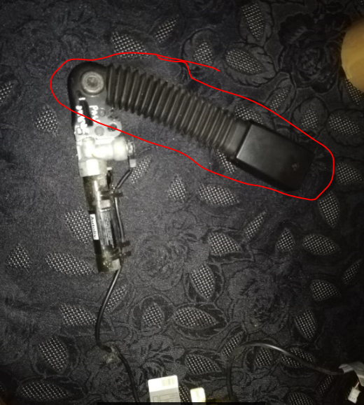

Airbag light was on. Plugged scanner in and found this:
learnt that When this section is "COMPRESSED", then will cause this error.
Compared to OLD seats ones and i saw they not compressed. Need to install
Blue Shirt
Make sure that you have all the connectors underneath the seat plugged in correctly. It is also possible that the tensioner on the new seat is bad, just swop it for the one on the old seat.

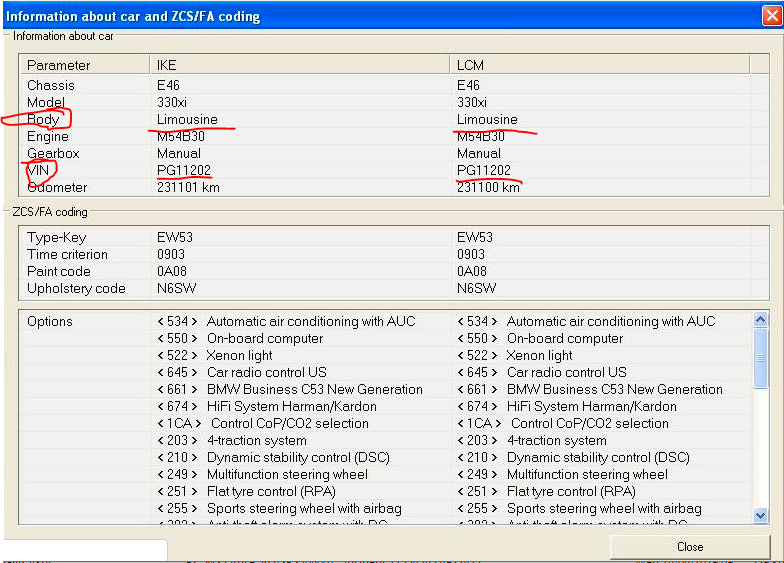

another question i have for guys using PA Soft, @Tinuva , maybe you can advise
not that it matters, but is there a way to change these items using PA Soft??
Would like to change Limo to Touring
and set the Touring's Vin
If it requires NCS Expert or the likes, then im going to leave it as is. LOL

PASoft can change the VIN and Mileage. Look at page 7 in http://www.aikawa-net.com/bmw_data/PASoftLCMCodingv1.1.pdf
To change the Limo to Touring you need to modify the VO string in both LCM and Cluster using NCSExpert.

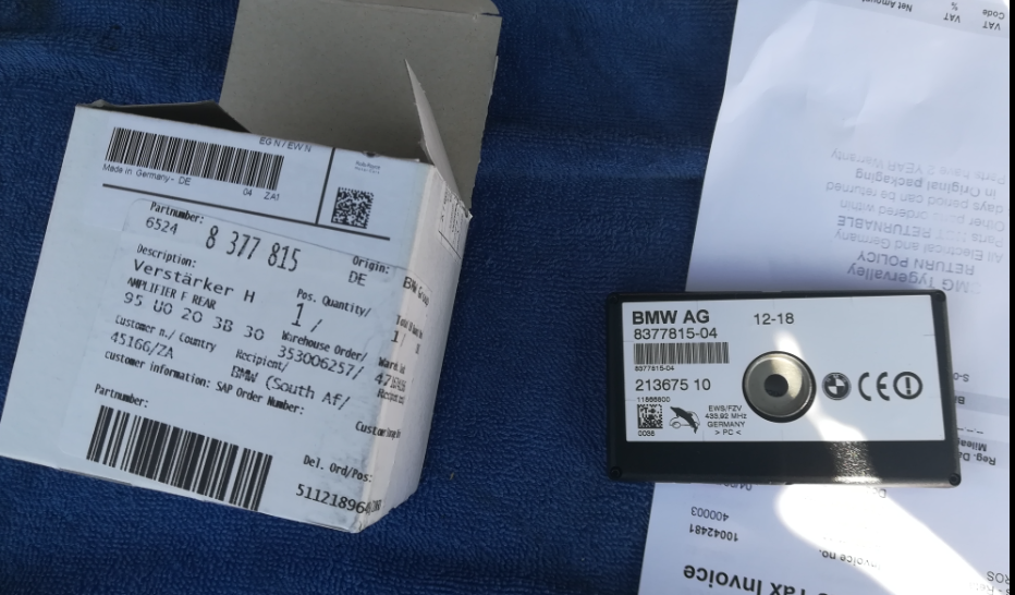

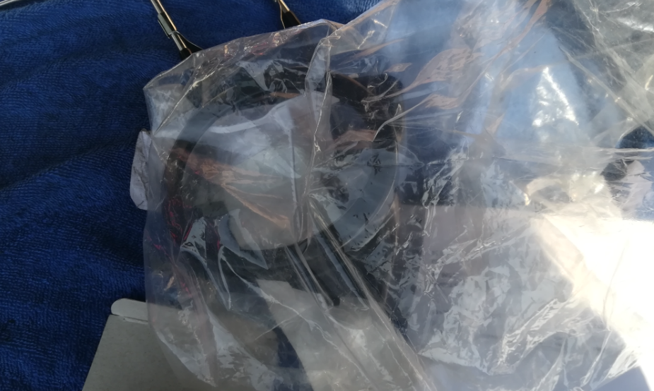

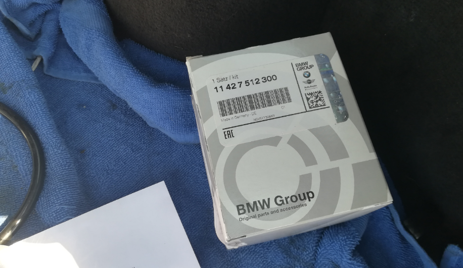

Just visited SMG tygervally for the parts i ordered
My Antenna Booster arrived from Germany sooner than expected 7 to 10 working days.
Hoping this fixes the issue where keyfob buttons dont work and the alarm does not activate
same time, My Driver side SPOT surround for the Mtech 2 bumper arrived
And while i was there, picked up a New oil filter for planned oil change this weekend..

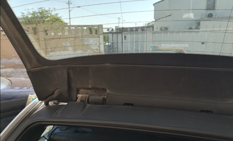

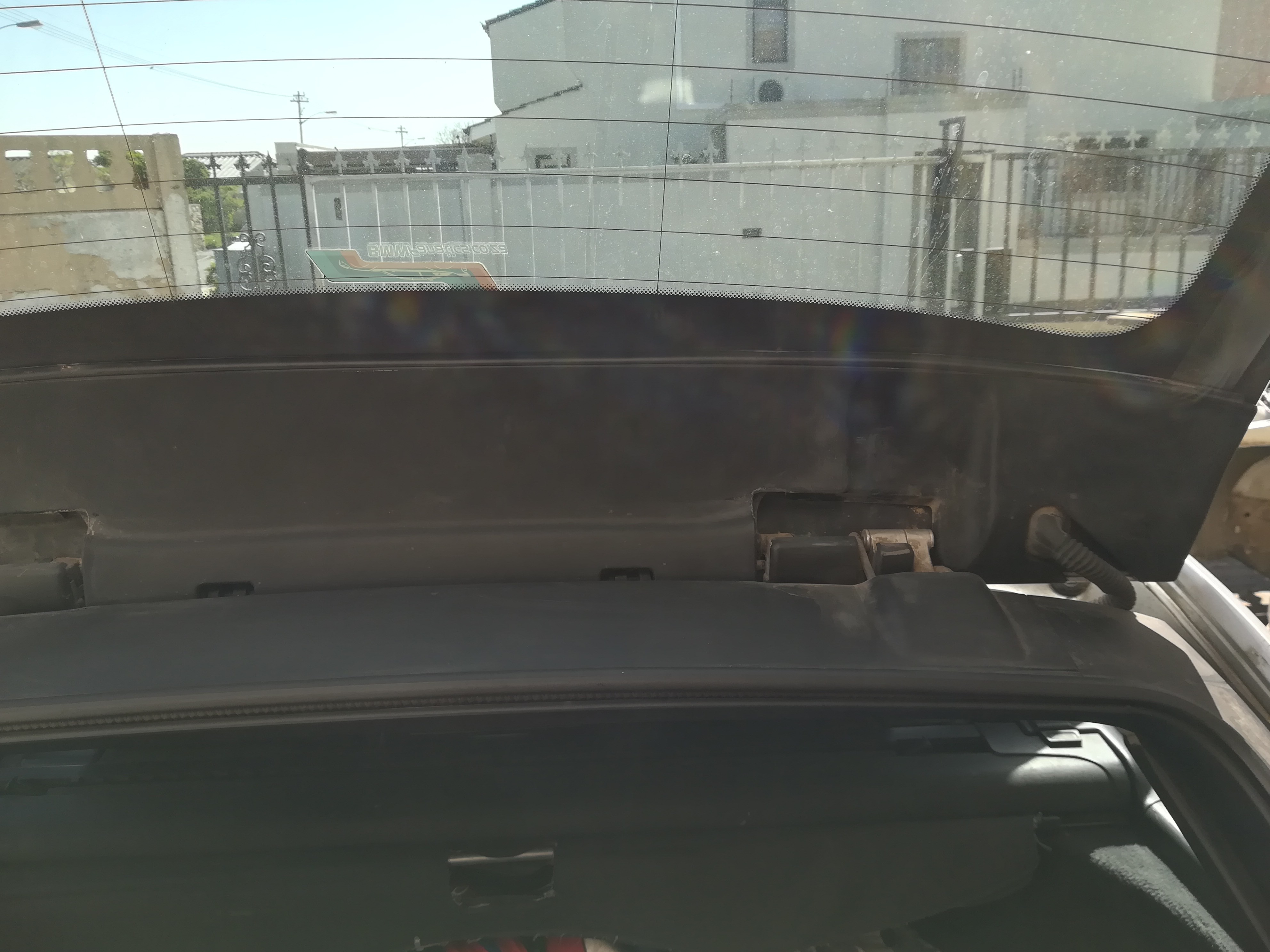

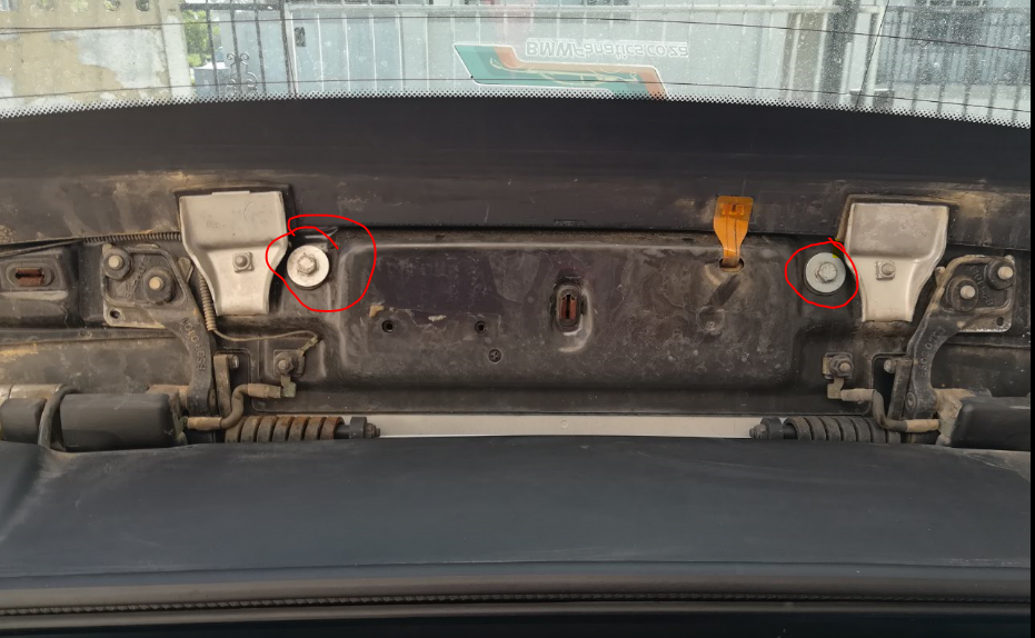

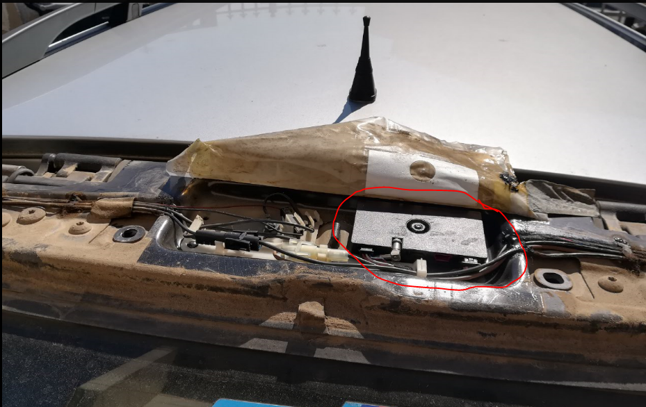

After convincing myself that my Antenna Booster is Busted, Cause my Keyfob Does not work, I went ahead and replaced the Booster.

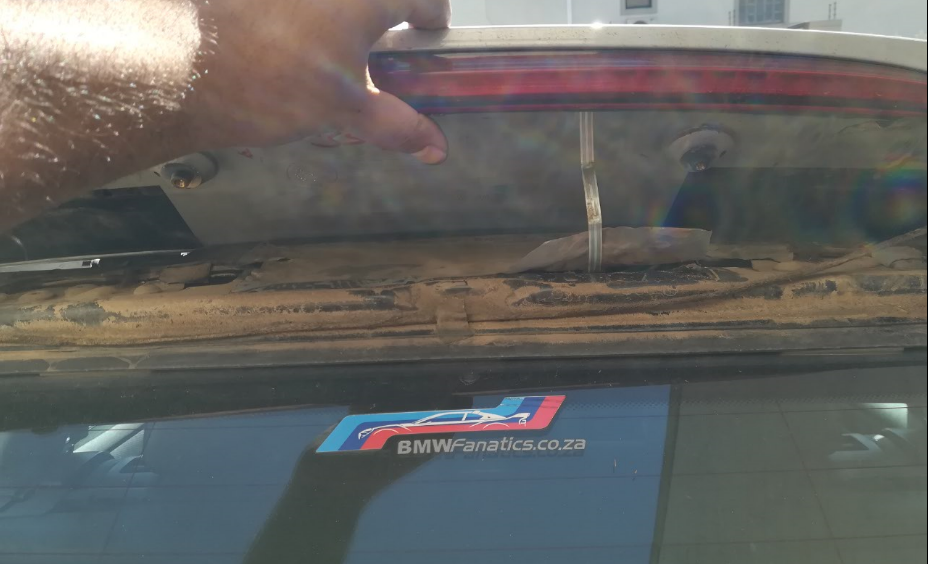

Removed this plastic cover ( must be done gently cause the Clips are very Fragile )
Remove these 4 bolts
Spoiler can now be lifted
The part was replaced
And the results are good and bad.
Good - it has a new Antenna booster
Bad - Keyfob still does not work ...:roflol:
tried Pairing the key to the car. Does not work.
Tried the spare keys. does not work.
So i could have spent that R1500 on a new barrel Key lock instead. LMAO
Looks like i need a pro to have a look at this instead..
