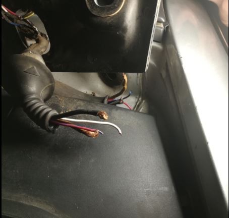

not being able to figure this out, i printed out some info from BimmerForumUK and 1 guy had a break in his wire but as he traced, he realized his break was under the roof liner so he had to remove his.
Out of frustration, i cut open the tube Right-rear next to the Glass lid hinge and to my horror, this is what i found..
ALL MY WIRES BROKEN!!!!
Whether someone replaced the tailgate and cut the wires or the Wires got ripped to bits when the boot was closed, i dont know...
Anyway, i was happy to see that it ripped in an Awkward place and NOT in a DIFFICULT place like under the roof lining.
So i went to the Parts car, Trimmed the same color/gauge wires from it and i proceeded to Extend them abit.

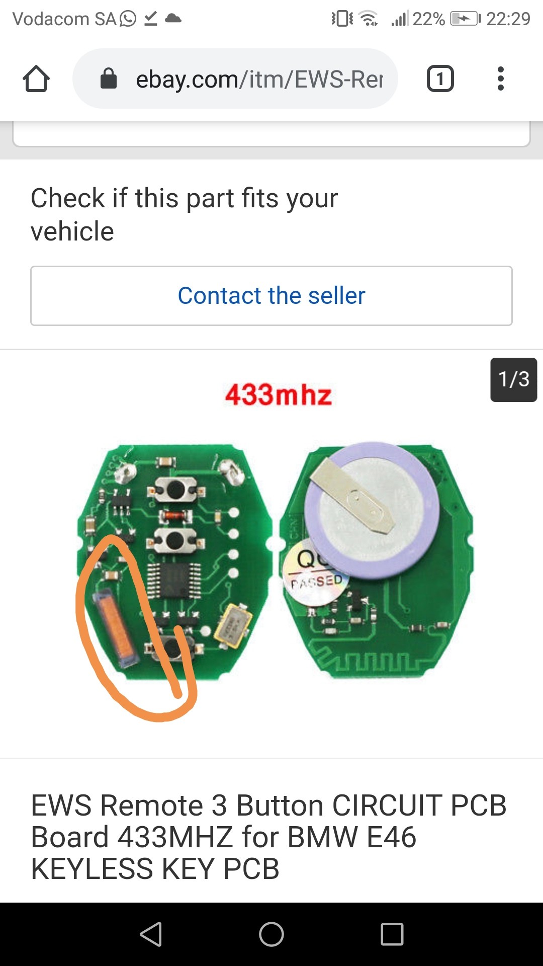

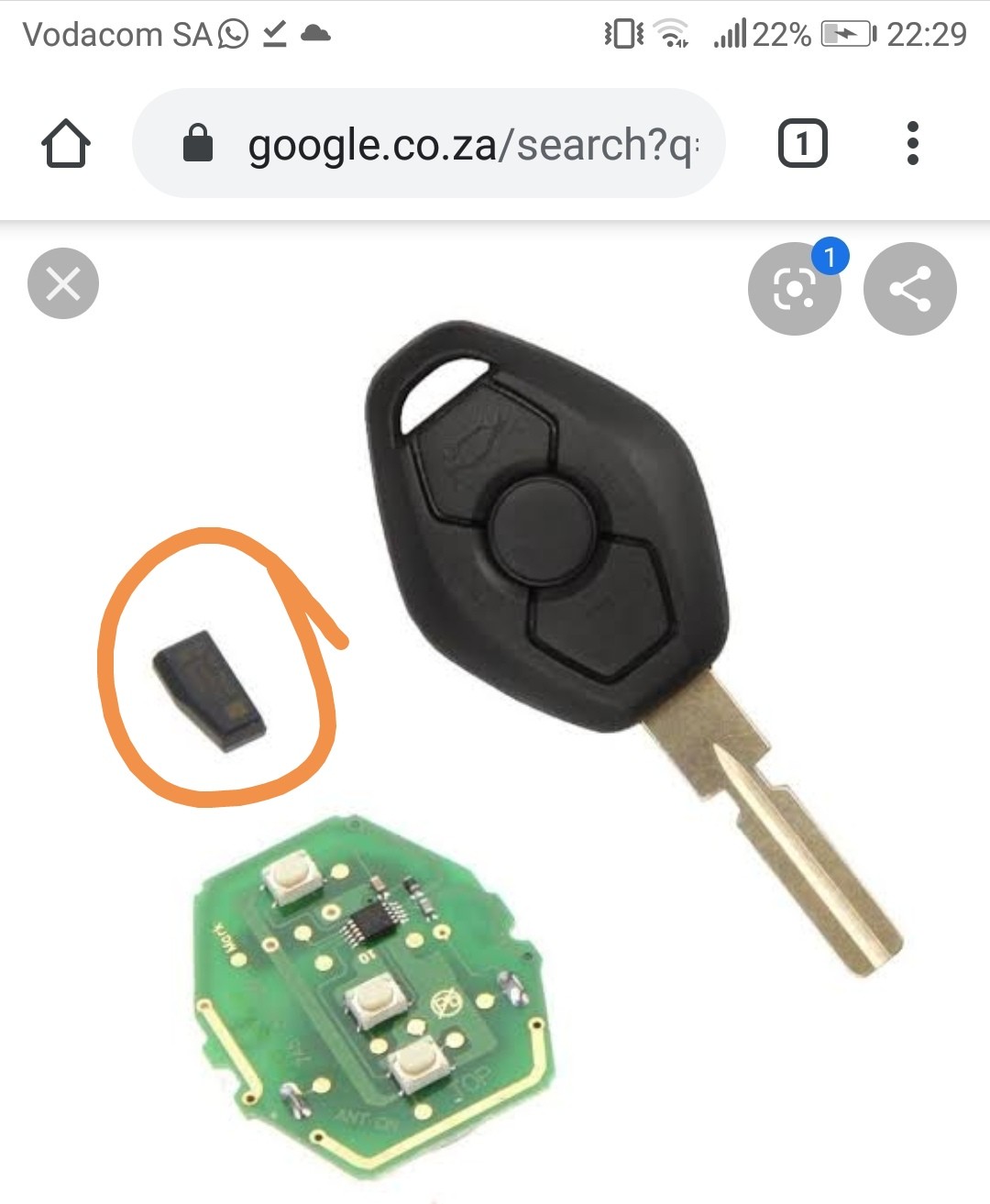

So i went back to the boot area where all the Split open keys were in and picked up the 1 spare keys circuit board and i realized something important..
The 2 chinese keys "CHIP" were loosely glued on a slot on the key
Like these:
The original key has the chip ON THE BOARD!!!!
Like These:
So i opened my key i paired again.
now saw 1 Loose Chinese Chip and low and behold, the Original CHIP was still on the board for the 320i
