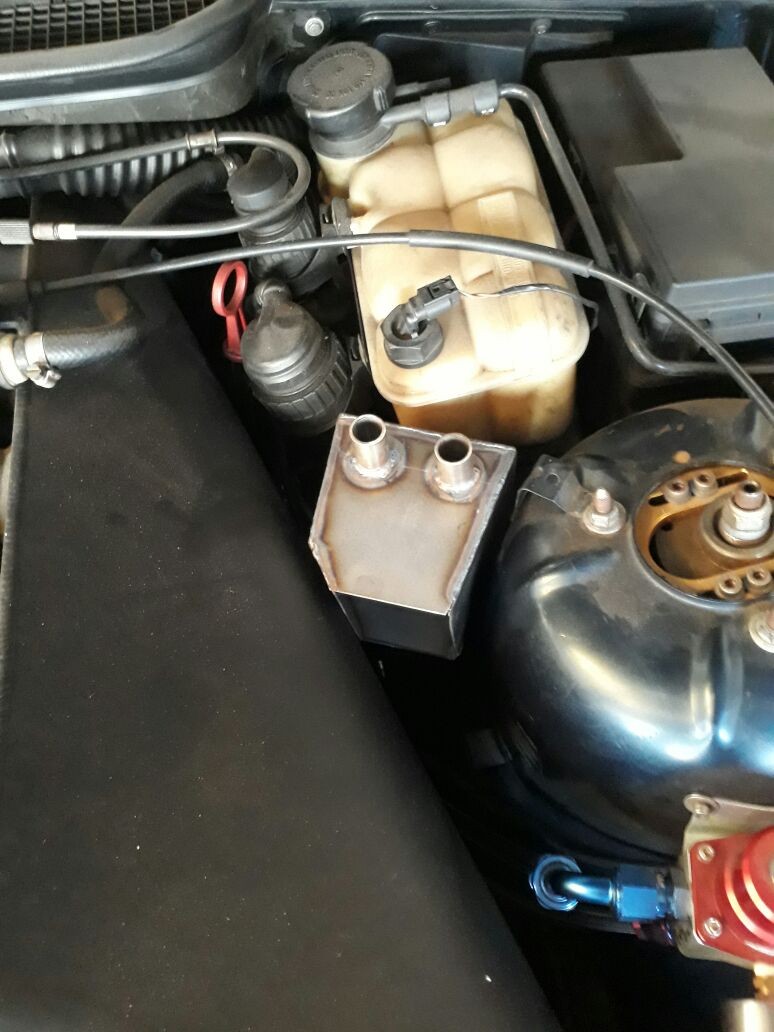

Both.. On my days off my relaxing time is cutting and welding what ever stuff I want to add on.. I made my own oil catch can and the oil drain piping.. Forgot to take pics.. I was bad when I was younger with all my time on my race car.. Once I raced and broke my car bearing knock on Friday night.. Towed car home and the very same night took the engine out and got a new one Saturday morning from gearbox center.. Motor fitted and went for tuning on Saturday afternoon.. Bearing knock on the dyno..i was nearly devoiced a few times due to time and money on cars:smilebounce: it's something I can not stop.
nait
Pic of oil catch almost complete

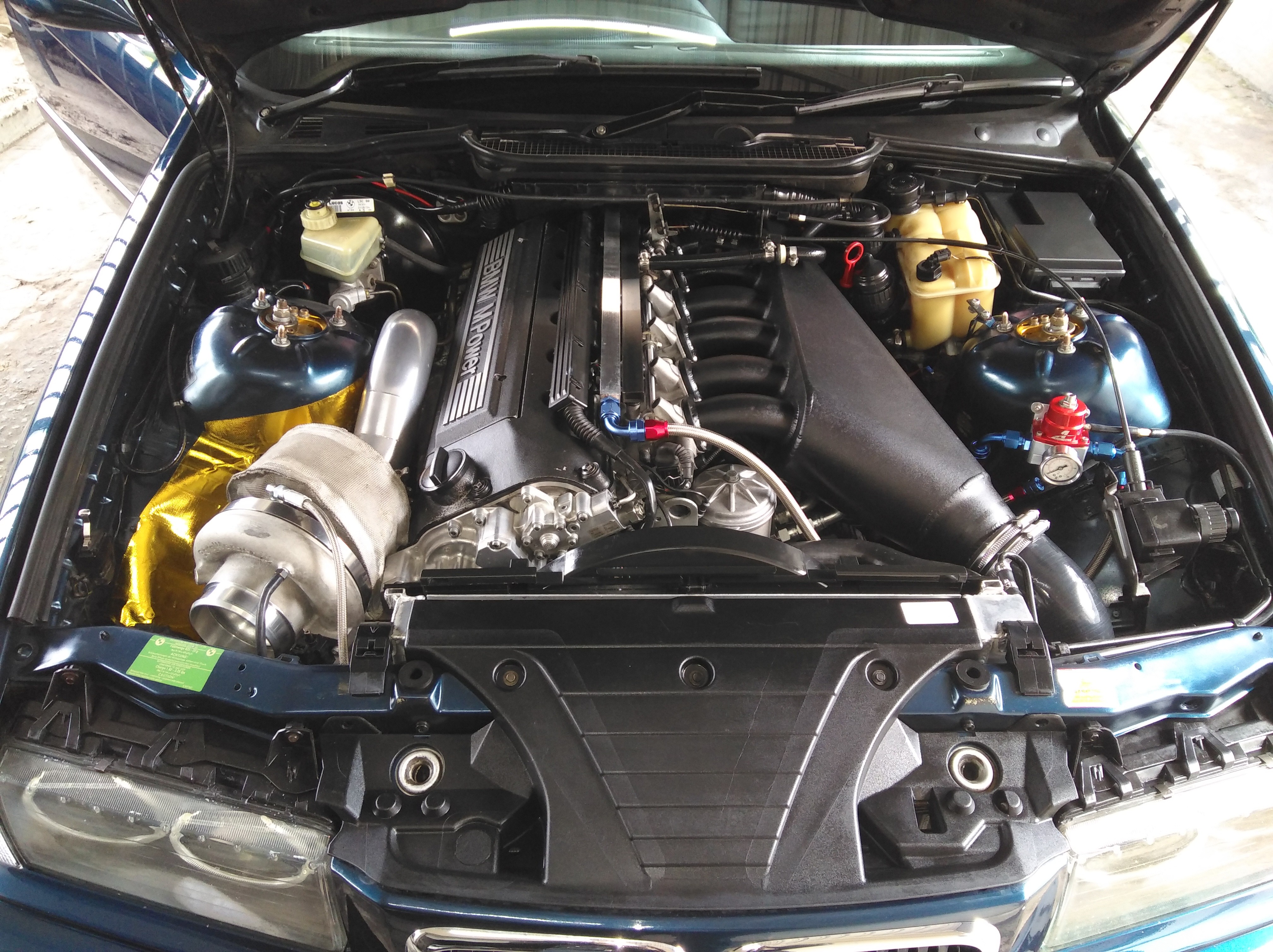

Car is off the the stand. Just to run oil and water lines to turbo and then ready for startup
osiris
That looks insane. Love it!!!
I think you should invest in a turbo blanket though, Your oil cap will melt and the tappet cover gasket will take a beating and your bonnet lining and anything else in that vicinity is going to take a beating.
Just a thought.
Otherwise that is looking beautiful!
Just a thought.
Thanks. It's a must..going to get one tomorrow.
