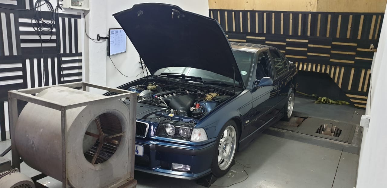

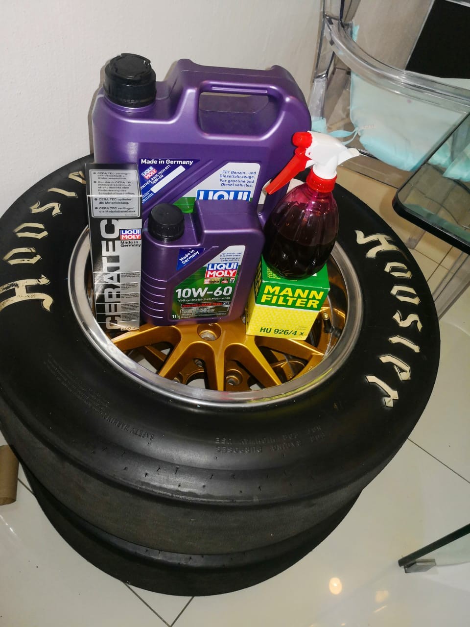

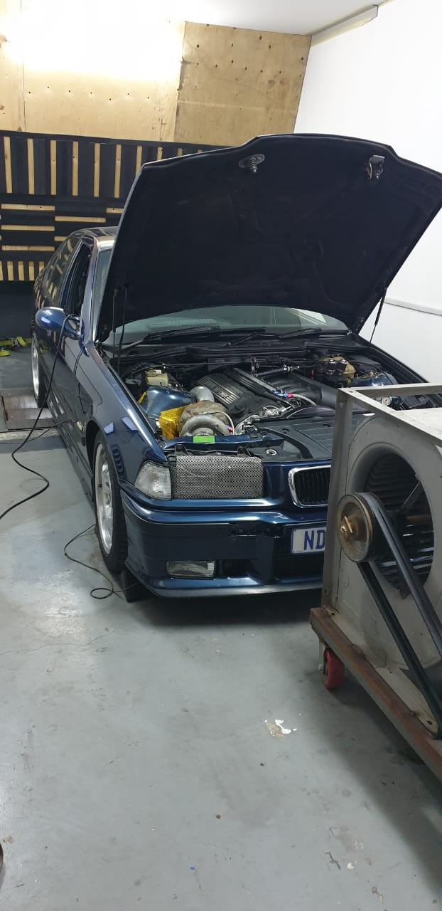

For some reason fuel pressure was not holding and we were at 85% duty cycle on injectors.. After checking found that one fuel pump fell out of housing into the tank. So car is going in for a retune and should see some gains. A quick oil change and trackbite this time:thumbs:
nait

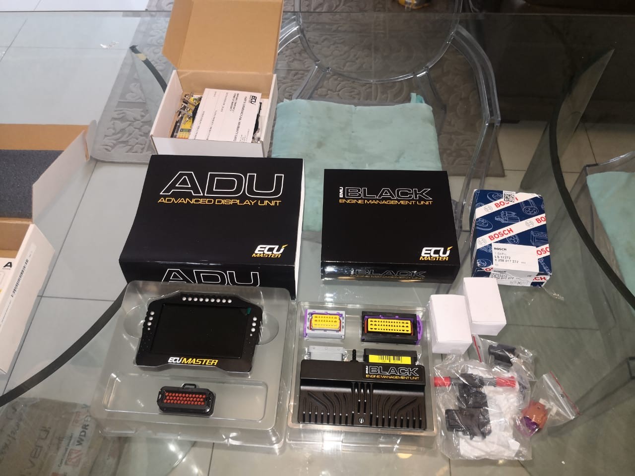

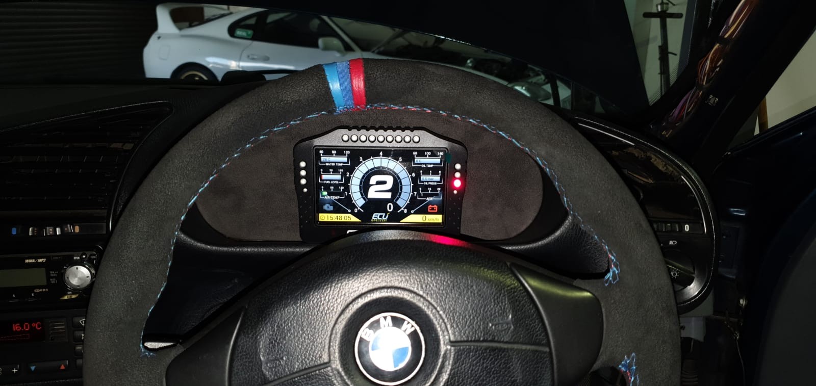

Hi guys so almost a year with car now around 800hp and everything is fine beside the following that i had to change or fix in a year and this was only with roll racing.. 1 gearbox, new clutches, 2 x fuel pumps, 1x dampner rubber, exhaust manifold leak,exhaust vanos selinoid seals, 1 x leaking rear coilover shock..alot of maintenance and picking up weak points. Heres some new upgrades that im currently busy with

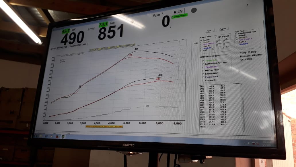

it made a super smooth 500whp on a drive in pump fuel map with new ecu.
Tareeq
That ECU!! Brilliant choose Nait and surely a needed one with this monster setup you have. I'm glad to see she's doing well and performing like a beast.
nait
[video=youtube]http://https://youtu.be/LkOcMQI3_jk[/video]. as requested a video. The tightest dyno in kzn. 1bar boost on pump fuel.

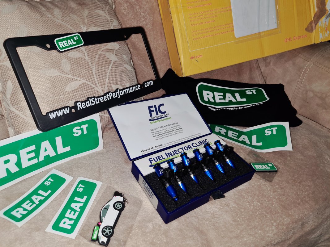

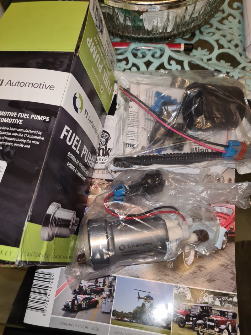

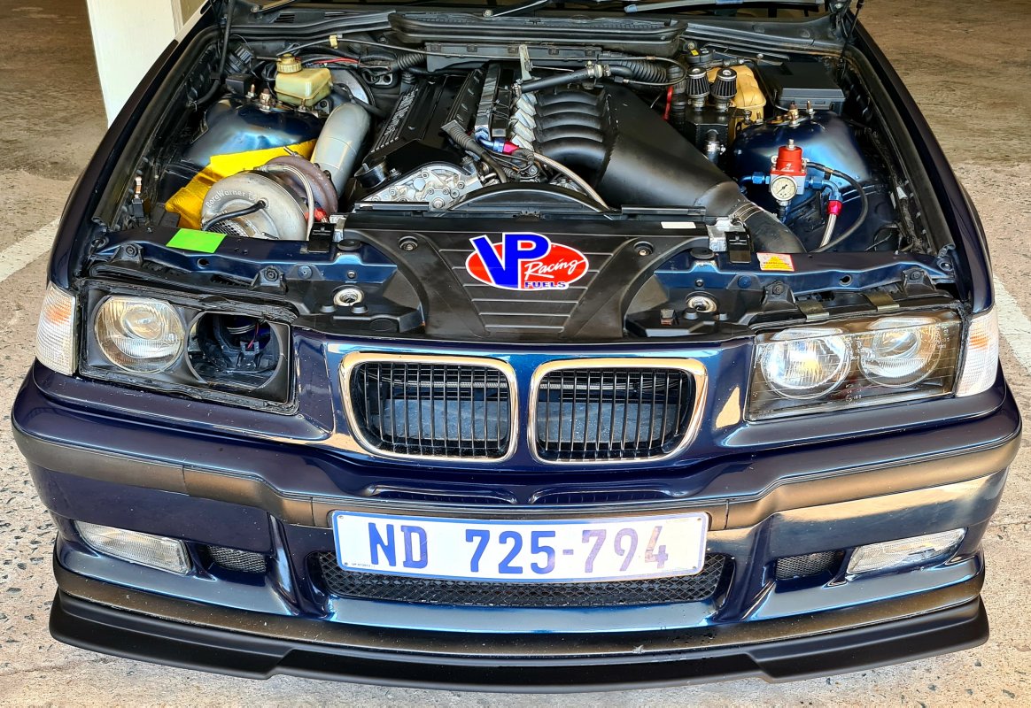

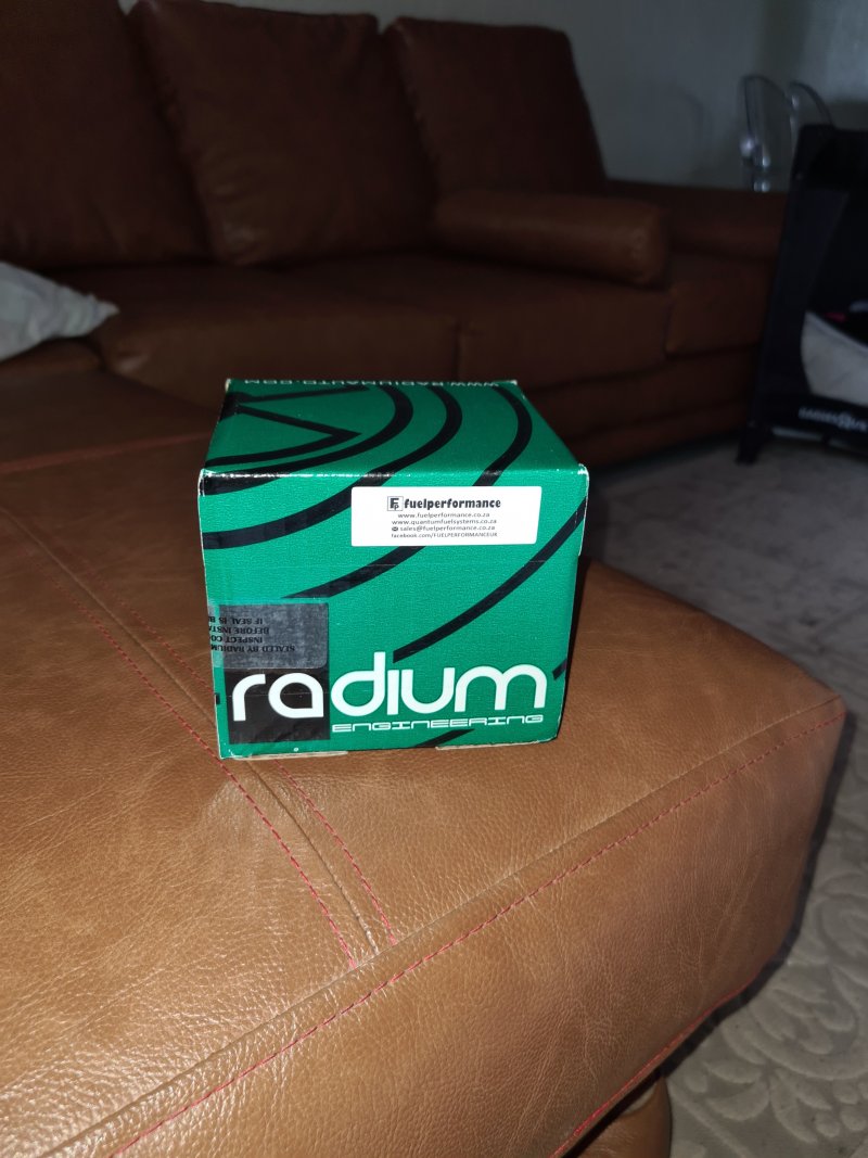

Over a year later and everything is still going strong. We where on 60% DC with injectors on pump fuel so decided to step up the entire fuel system before we do our flex fuel tune. I went with 2x 525 walbro helcat pumps, radium venturi kit and 2150cc fic injectors. Our goal is the magic 1000hp number around 1.8/2bar. With that all the fun features the ecu has like rolling launch and flat shift.

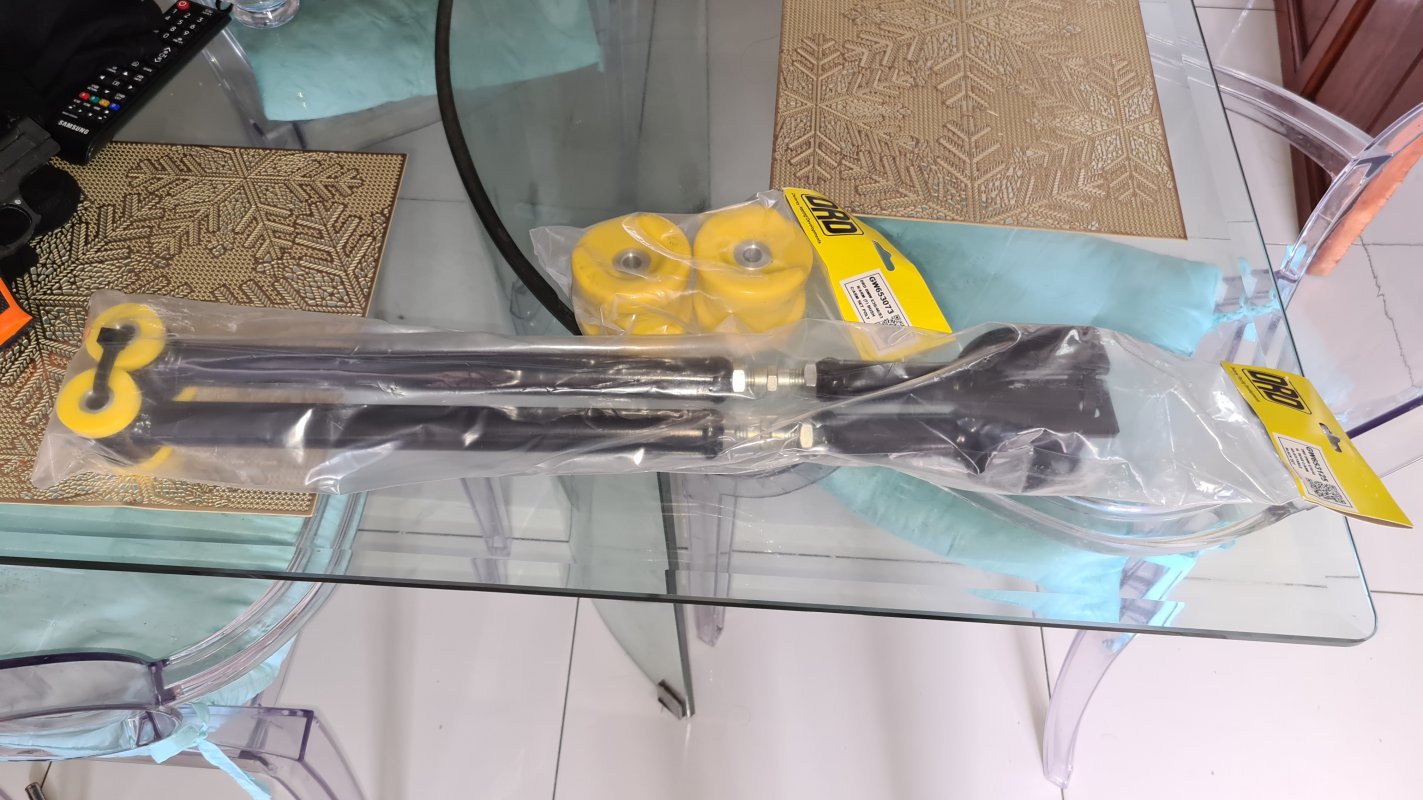

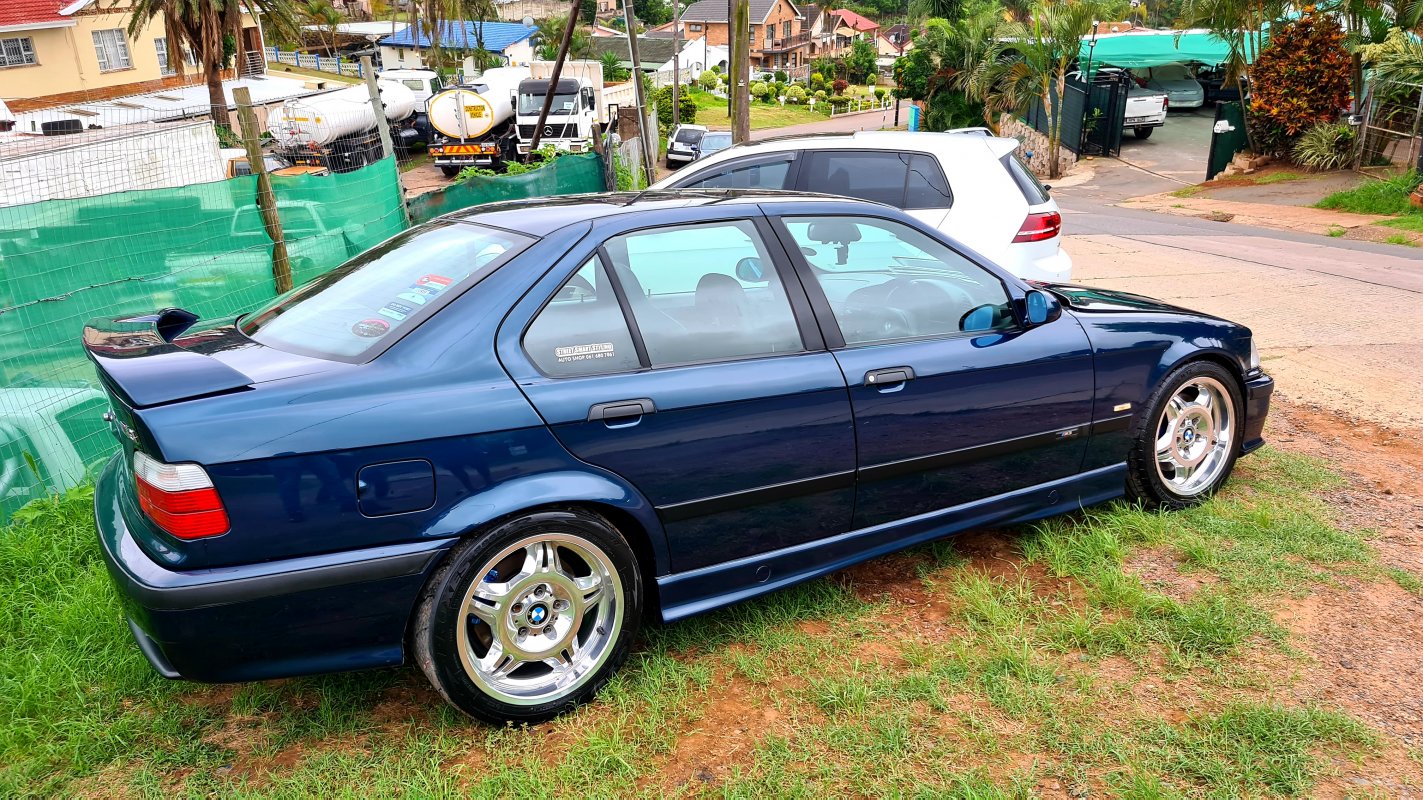

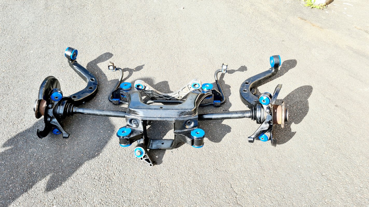

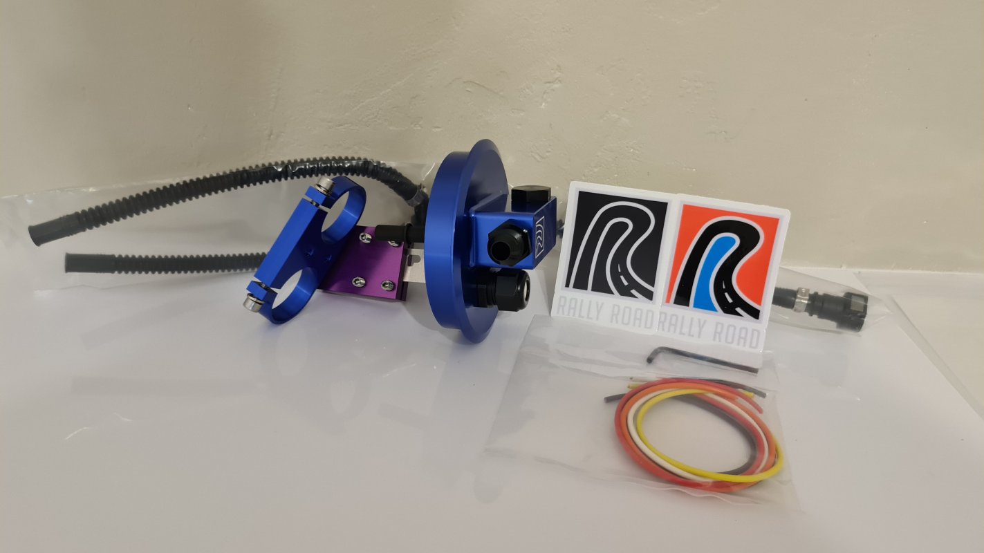

Hi guys. Just wanted to update my thread with our new mods. Sent car in for some touch ups and paint correction. We then removed rear subframe and installed all new bushing with adjustable trailing arms. Rally road dual fuel pump billit hanger. Vp race fuels durban noticed the car at the gas motor show at dezzi and offered to sponsor me for upcoming events.

shauwn
tjirrrrrr epic build journal boss..all we need now is the invoice book in total :)
osiris
Wow, the paintwork looks insane! Loving this so far! How does the car feel with the new bushings?
