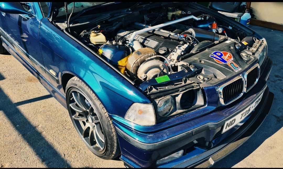

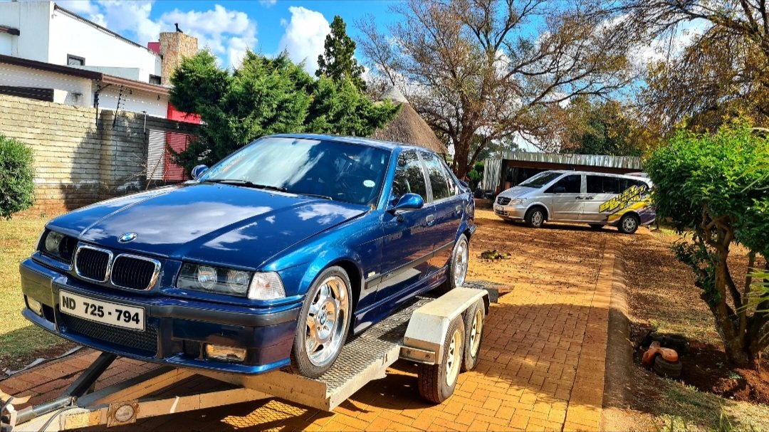

Lol said it before never ending. However I'm enjoying it..as much as it's got so much done to it I can still take the family out and drive like a stock m3😄
Thanks buddy. It looks 10 times better in pics but it's still the original paint..the rear fenders where painted as we flared the rear abit. It feels like modified m3 should feel like..super confident cornering!

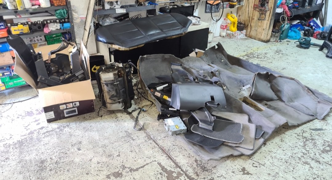

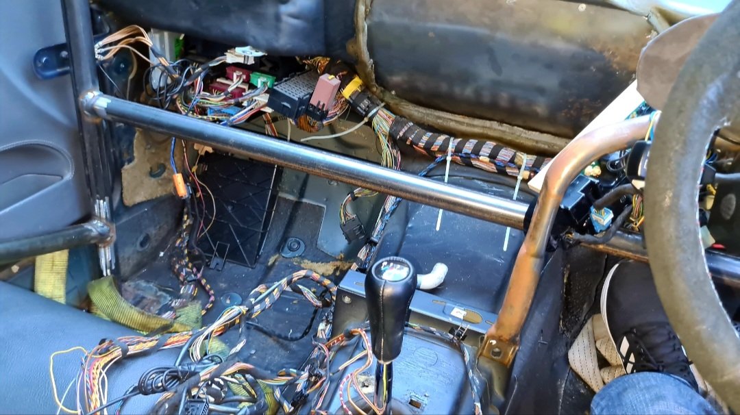

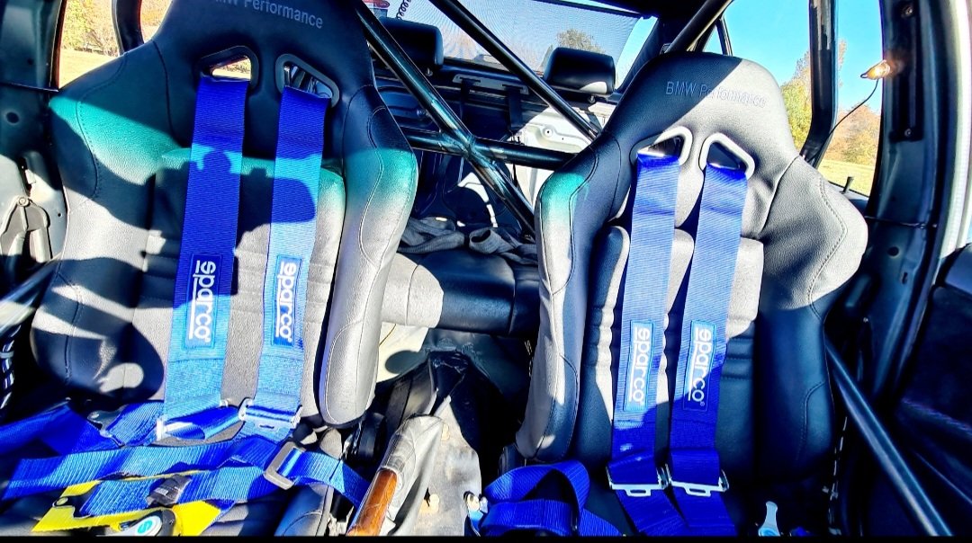

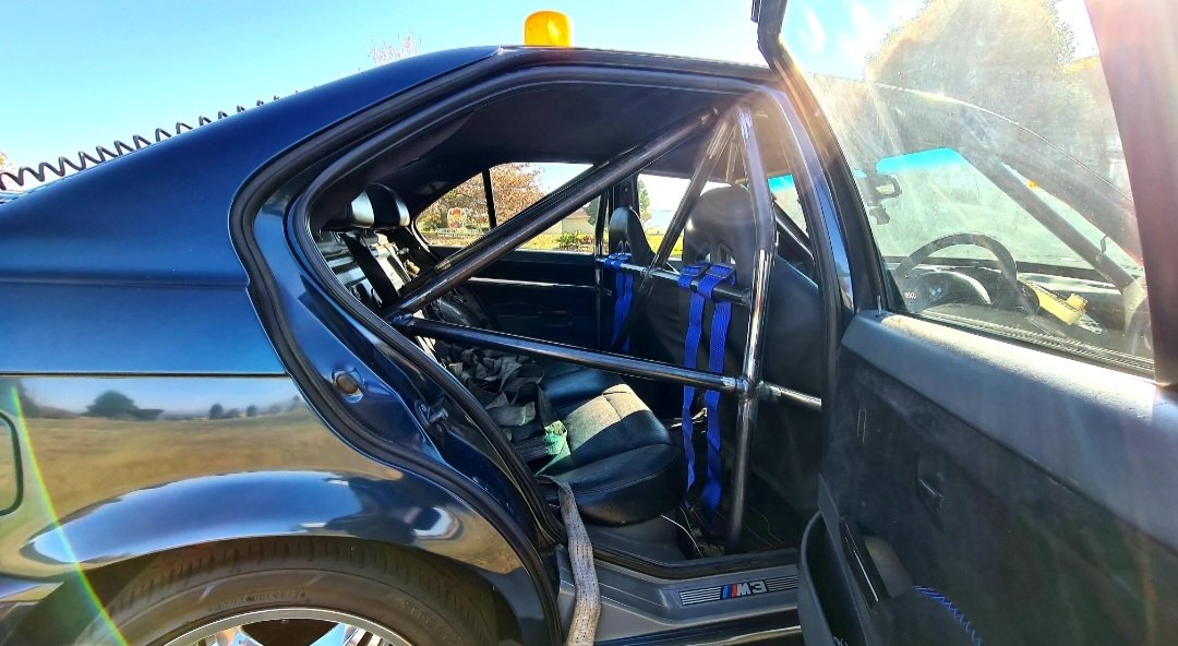

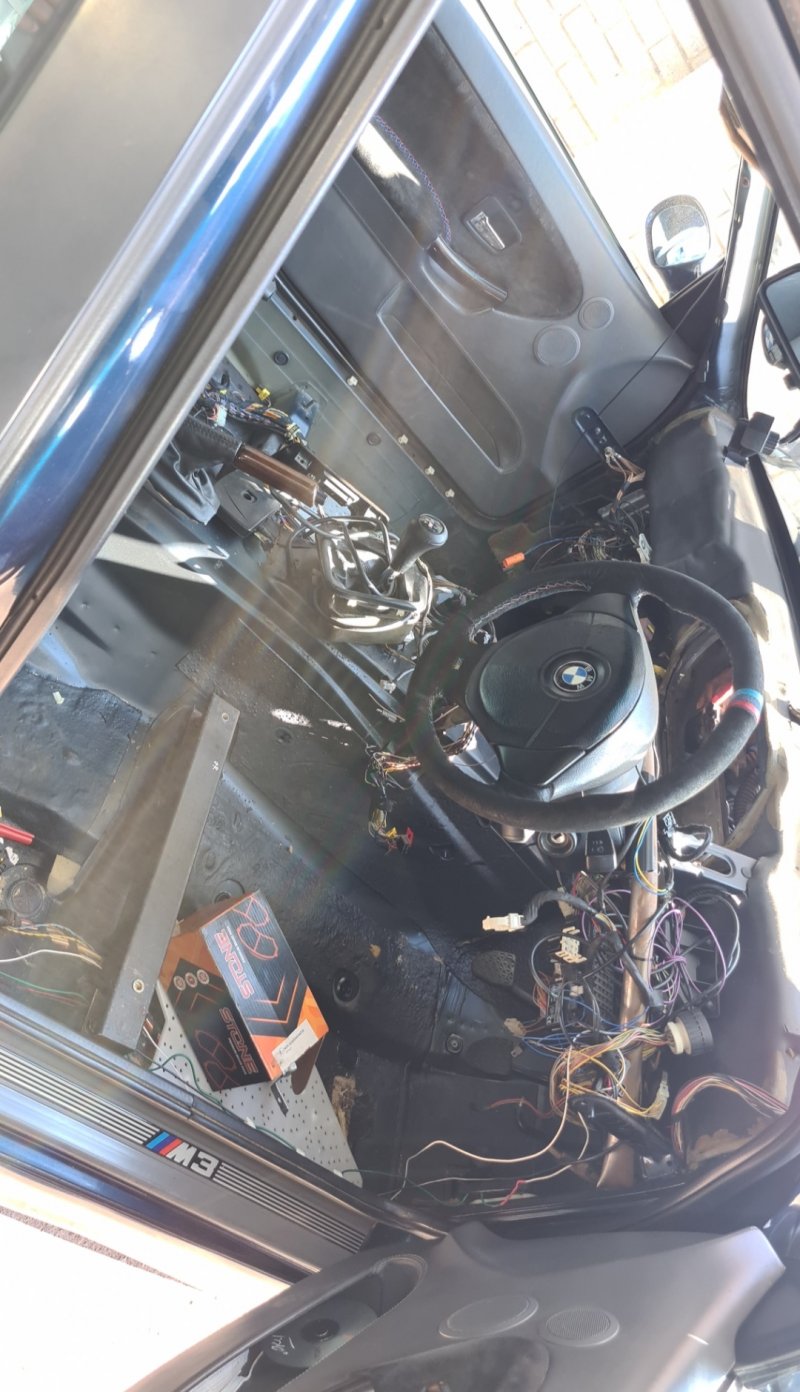

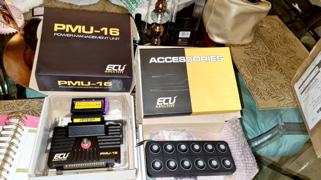

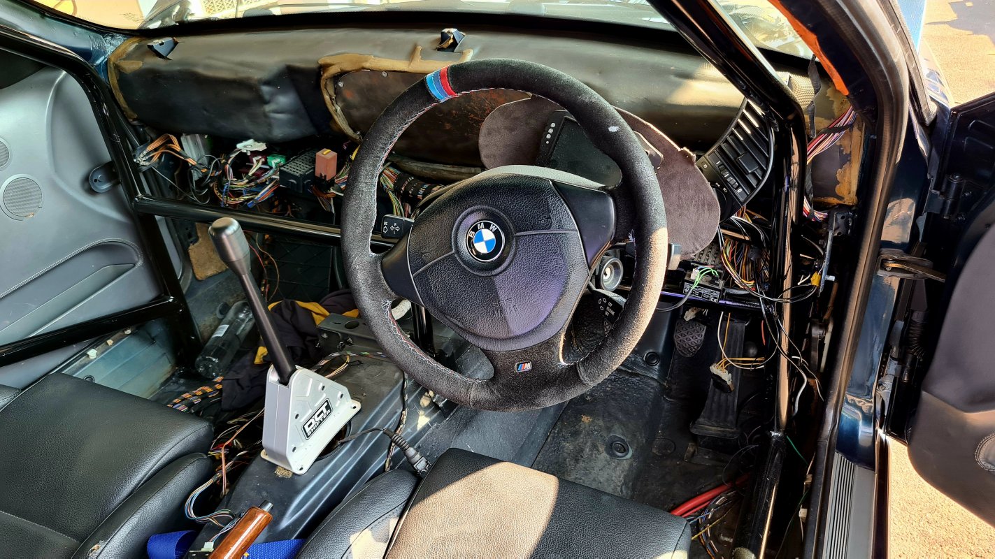

Hi guys. I decided to install a rollgage. The car was taken to bulletfab..excellent workmanship was well worth the 7hr trip. Unfortunately as much as I wanted back seats the gage and bracing that I needed could not accommodate for it. While the interior is out I also decided to get rid of all unnecessary wiring and install a pmu16.

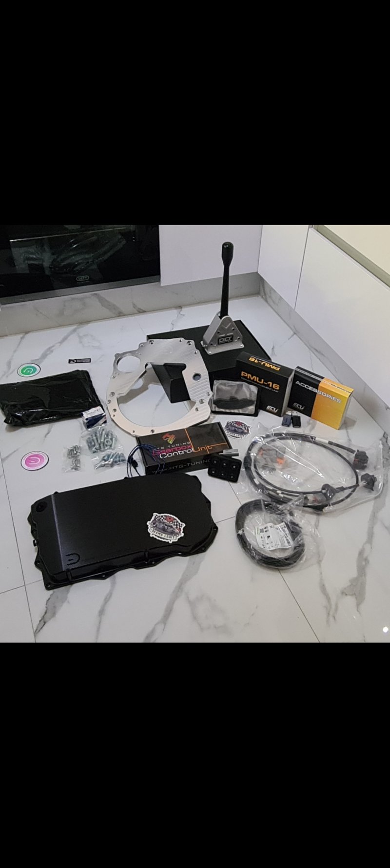

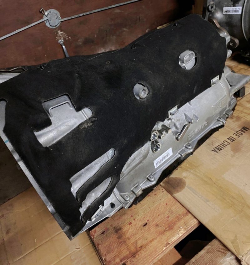

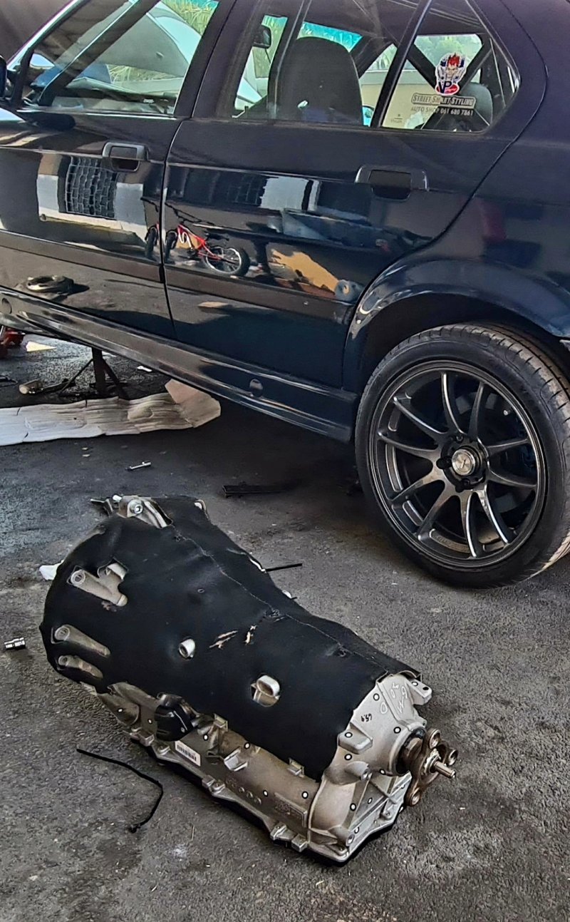

After much research and thought I decided that a 8hp swop was the way to go to bang into gears in boost. I decided to go with the 8hp75, htg gcu and some nice accessories

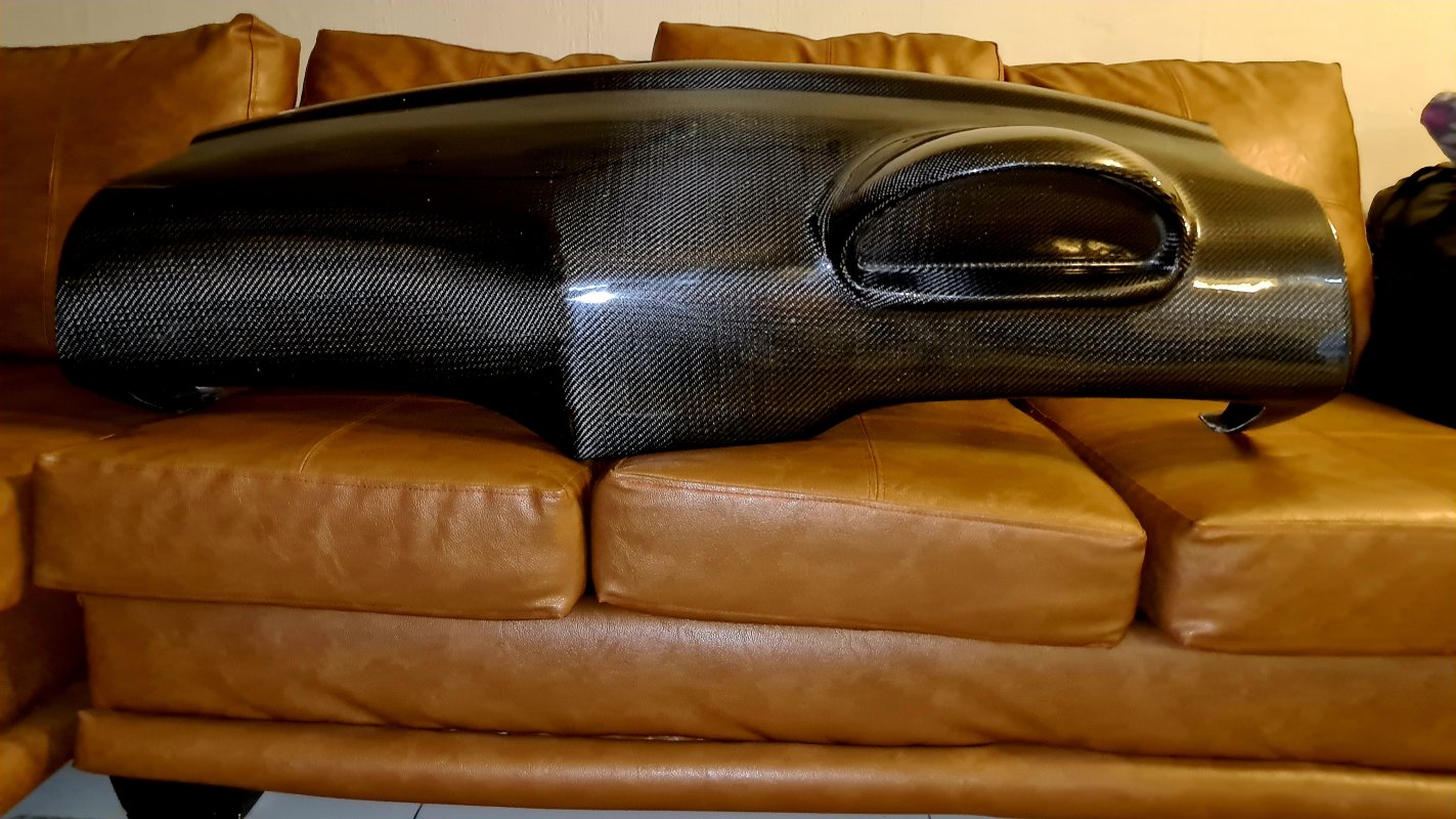

Since most of the standard switches will be removed and replaced with the pmu. I decided to go with a full genuine carbon fibre dashboard which also does some weight reduction. We able to shave off a good 30kgs from this upgrade as we no longer using the heater box with vent system.
So far ECUMASTER is excellent for me. I'm no expert but able to make changes safely on the maps after logging at the track. So perfect for a street strip car.
