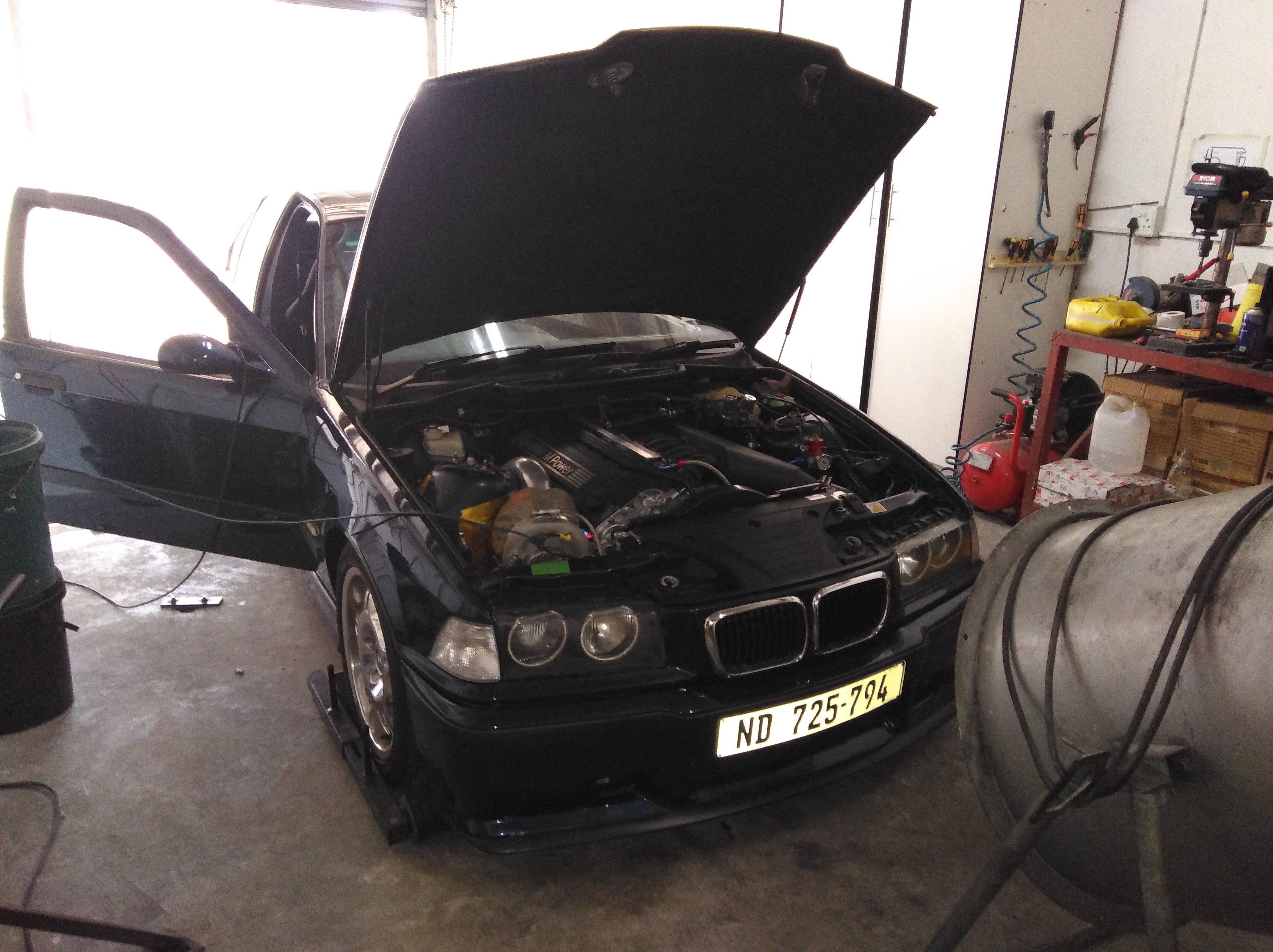

It was a terrible dyno session When I saw we could not tune over 0.6 bar so didn't worry about videos lol..

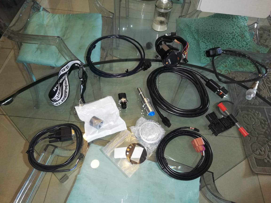

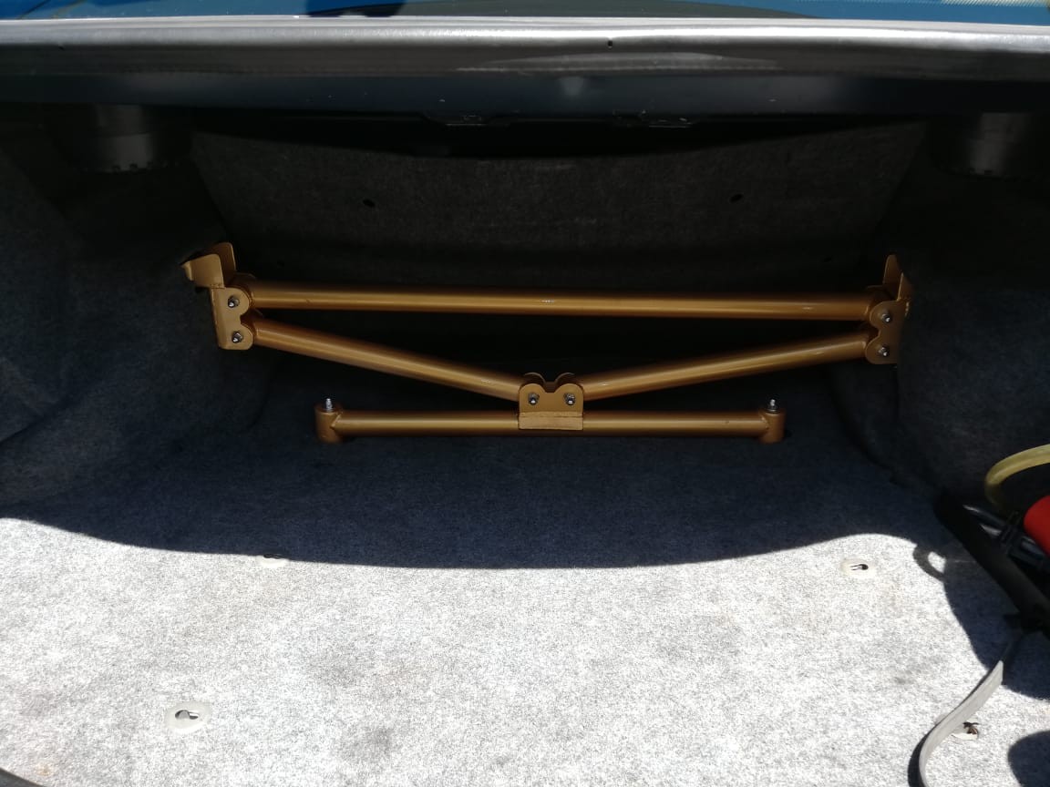

Been a while since I did any update. I did some rear bushing and braced rear end. I also got the ecf-1 kit to tune for flex fuel which should happen next week.

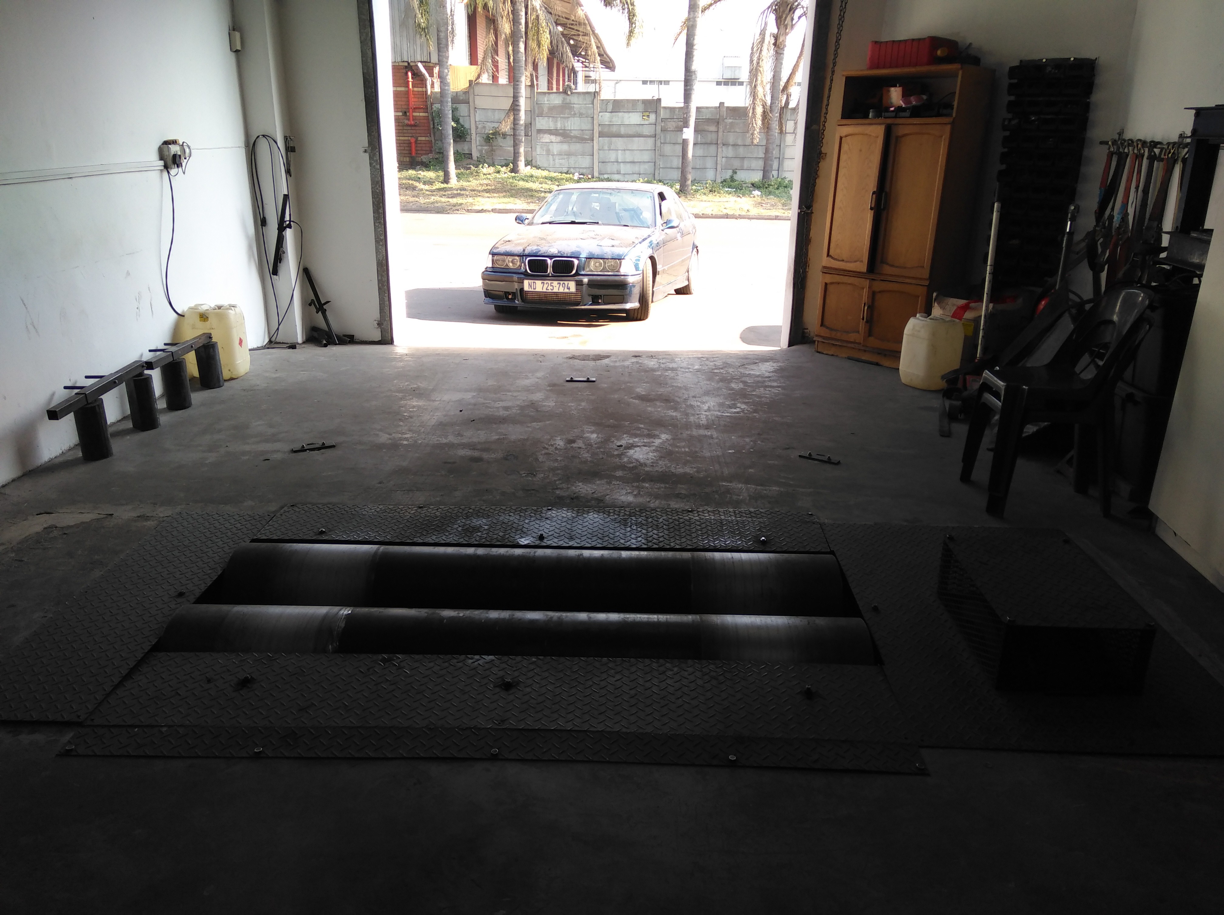

We finally put the car on the dyno today for the first session of mapping..our aim was to boost till 1bar on pump fuel with water methanol..unfortunately the boost solenoid could not handle the pressure of the dual wastegates and only could get boost to a maximum of 0.64bar to be exact on the eboost and didn't switch watermeth on. The spool on this turbo is unbelievable..it comes on so quick but also progressively with the rpm enough to sprain your neck even on low boost.

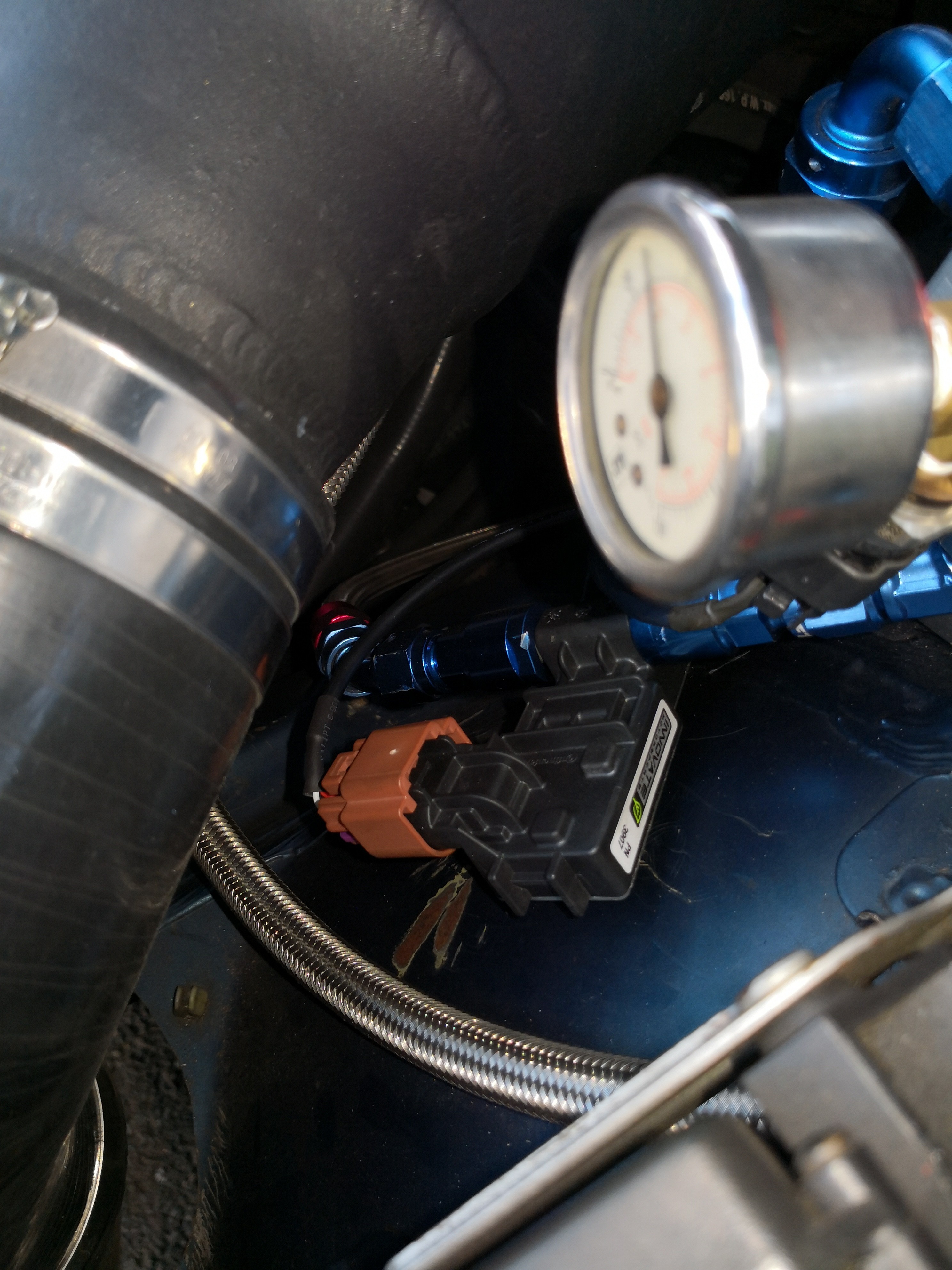

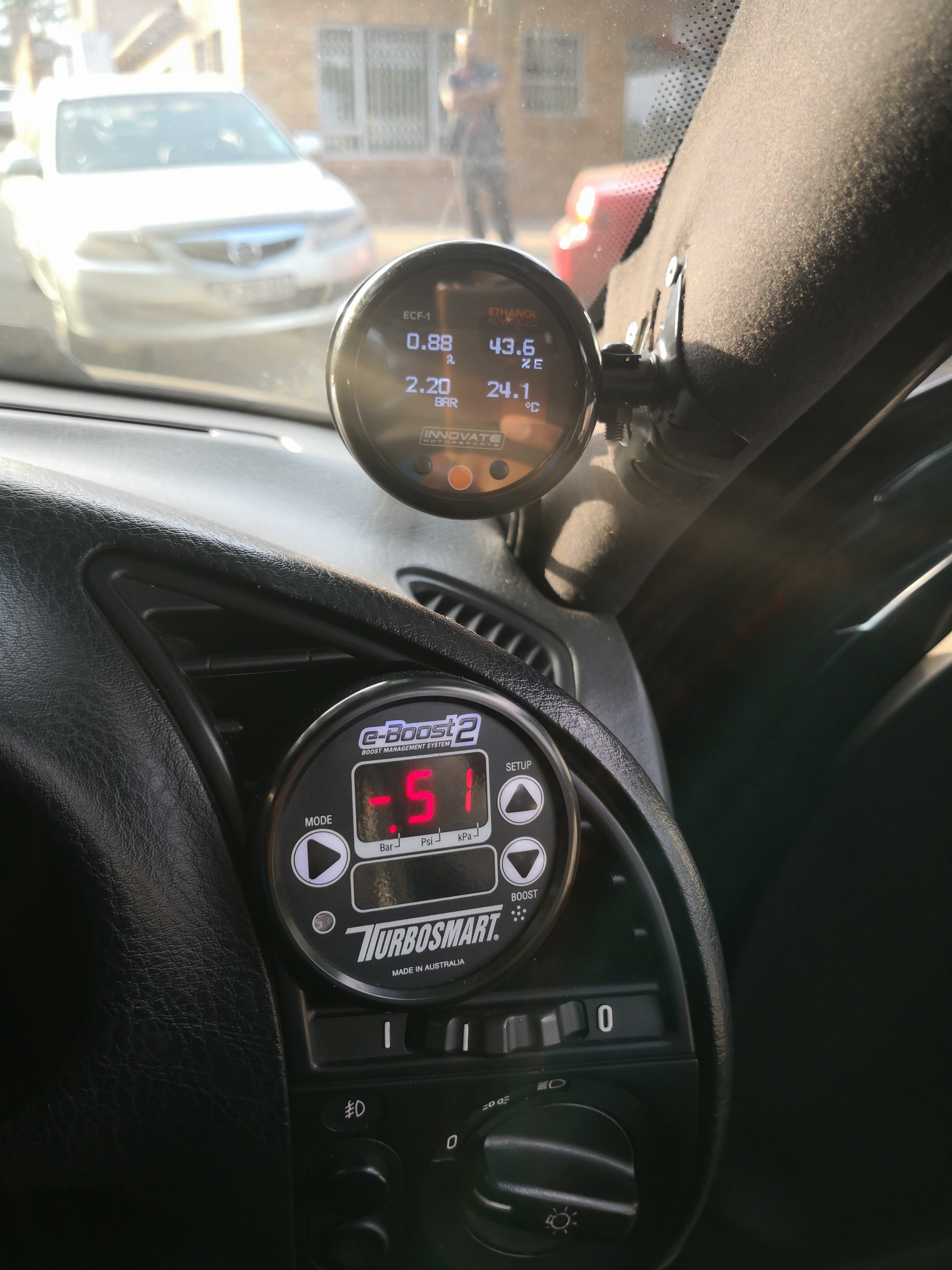

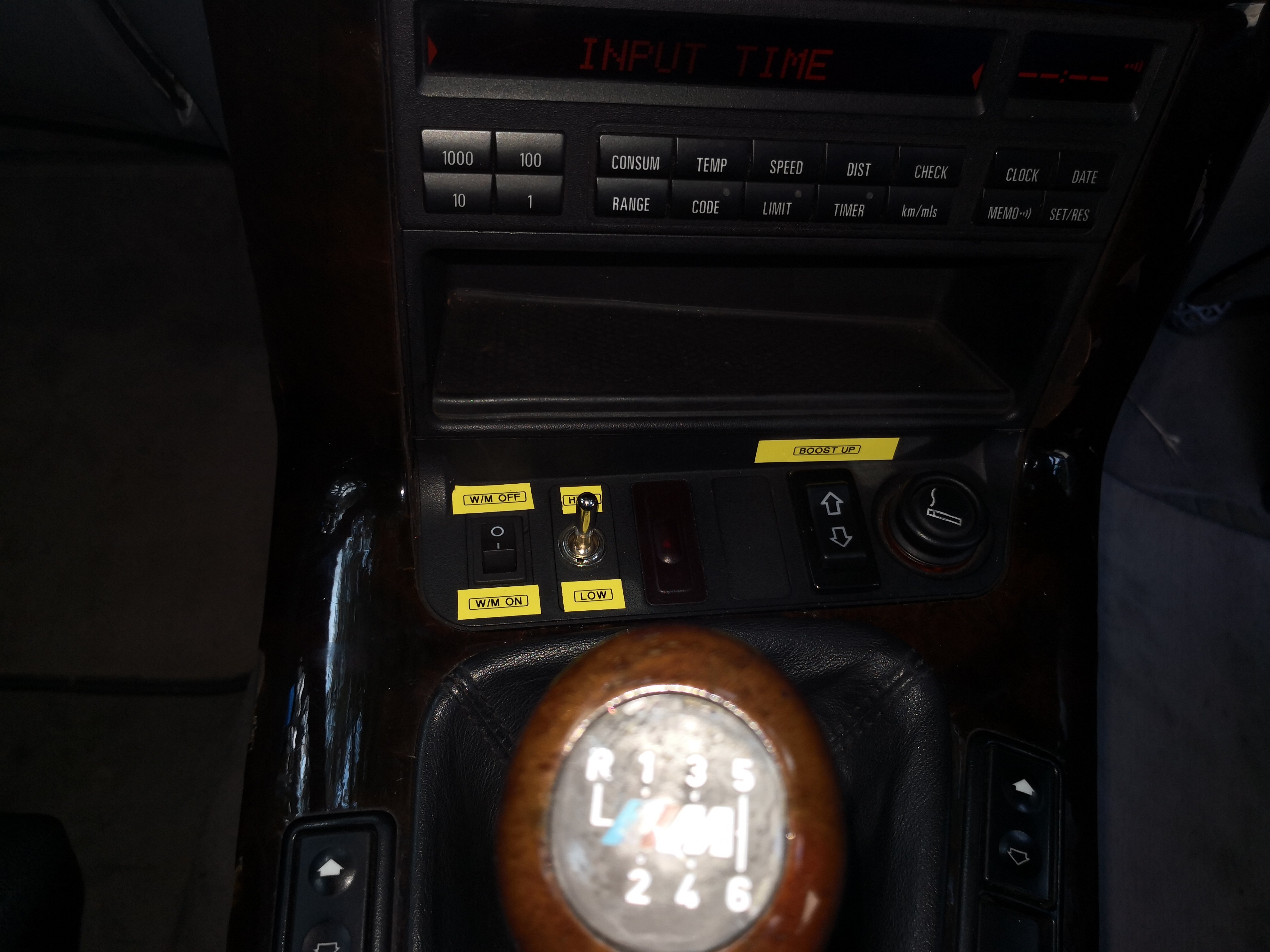

Hwzit guys.. Been using the car for almost a year an did about 8000km with no issues. About a month ago started working on car to turn it up abit. Installed ethanol content sensor with all ftf fittings

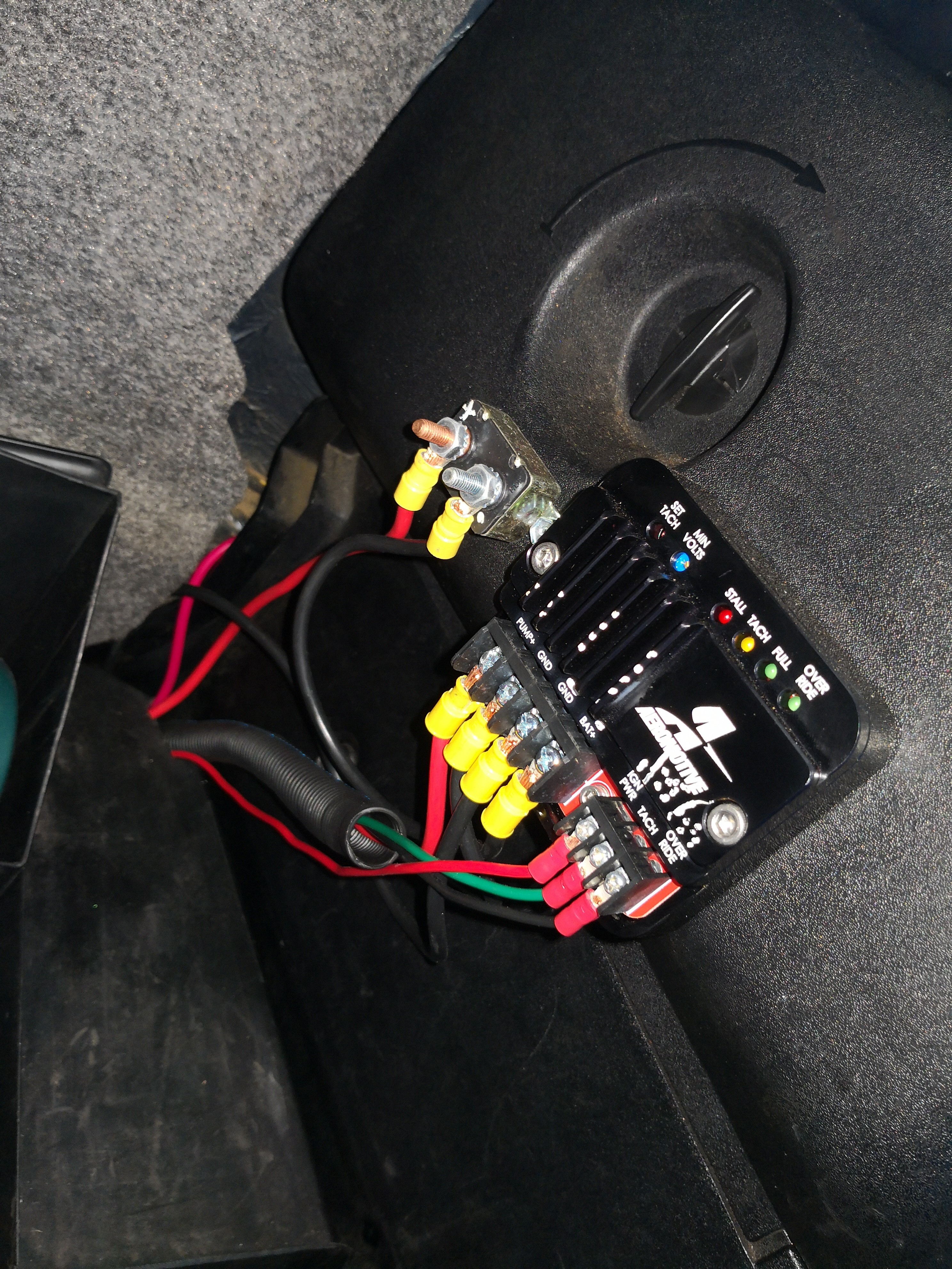

also got a fuel pump speed controller installed to keep fuel cooler for street driving. Switchs to control fuel pump and water methanol aswel as boost control switch for boost per gear for now.

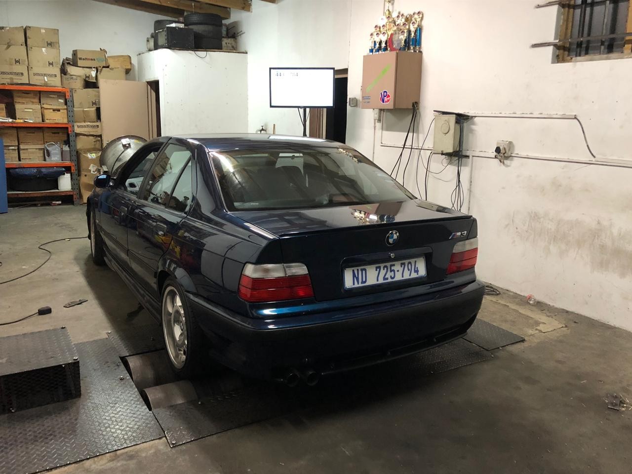

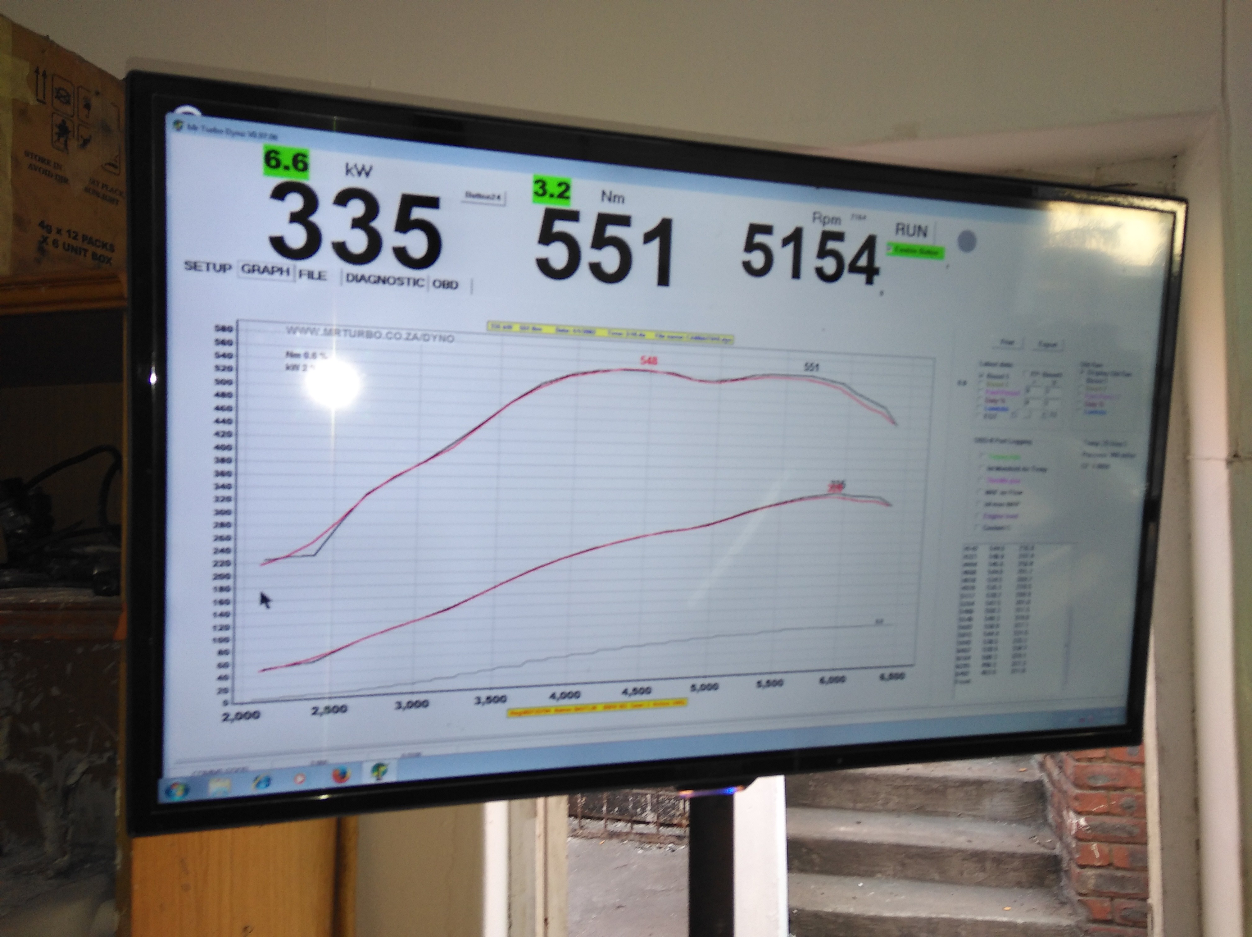

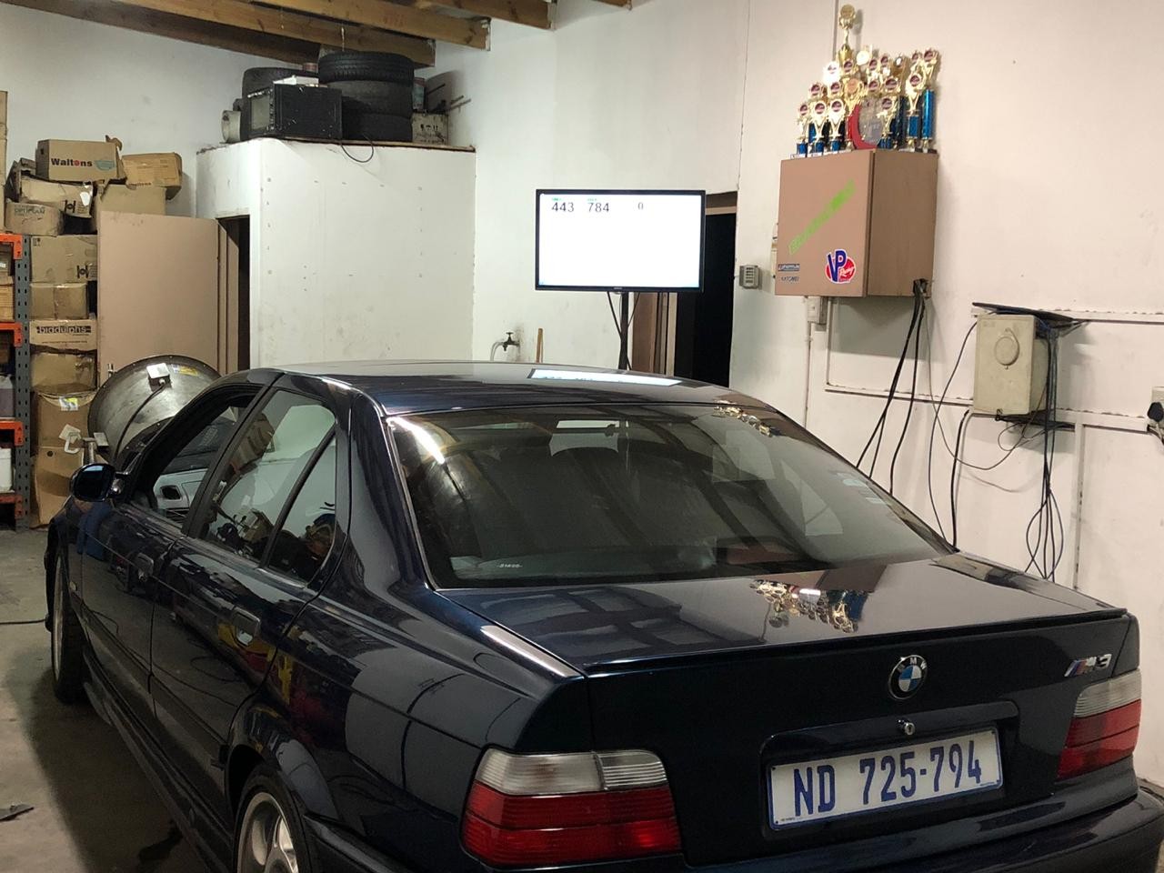

Got it to dyno on flex fuel and managed to put down 600whp on 1.1bar boost and o degrees timing still and no water methanol as we had a problem with jet on dyno.. Anymore boost and the car was spinning off.
