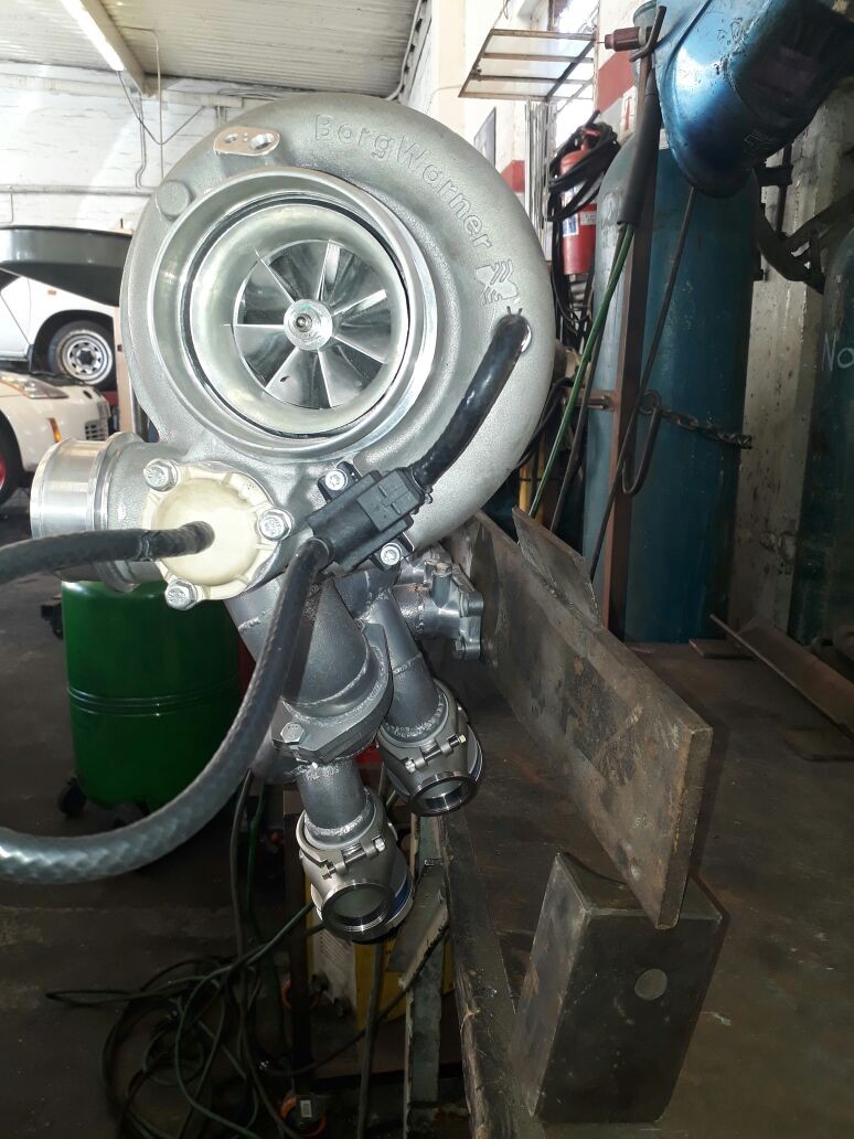

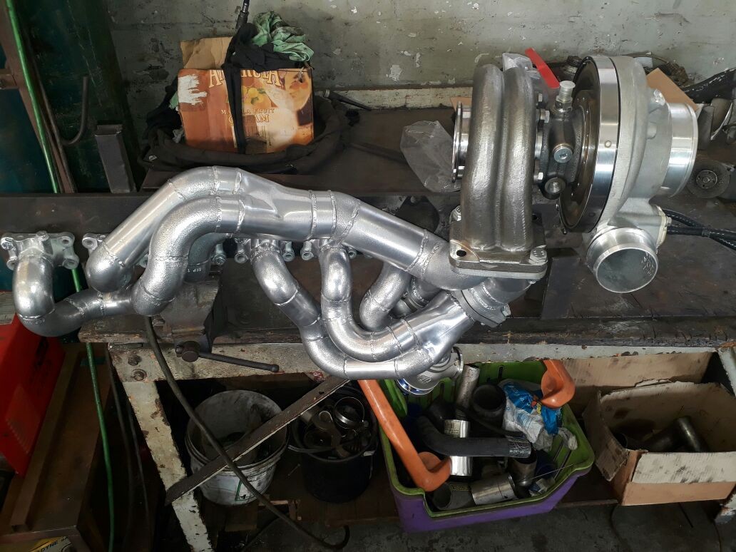

Some slow progress. Ceramic from inside Manifold had some flakes so had to be redone.
waste gate pipes to atmosphere.

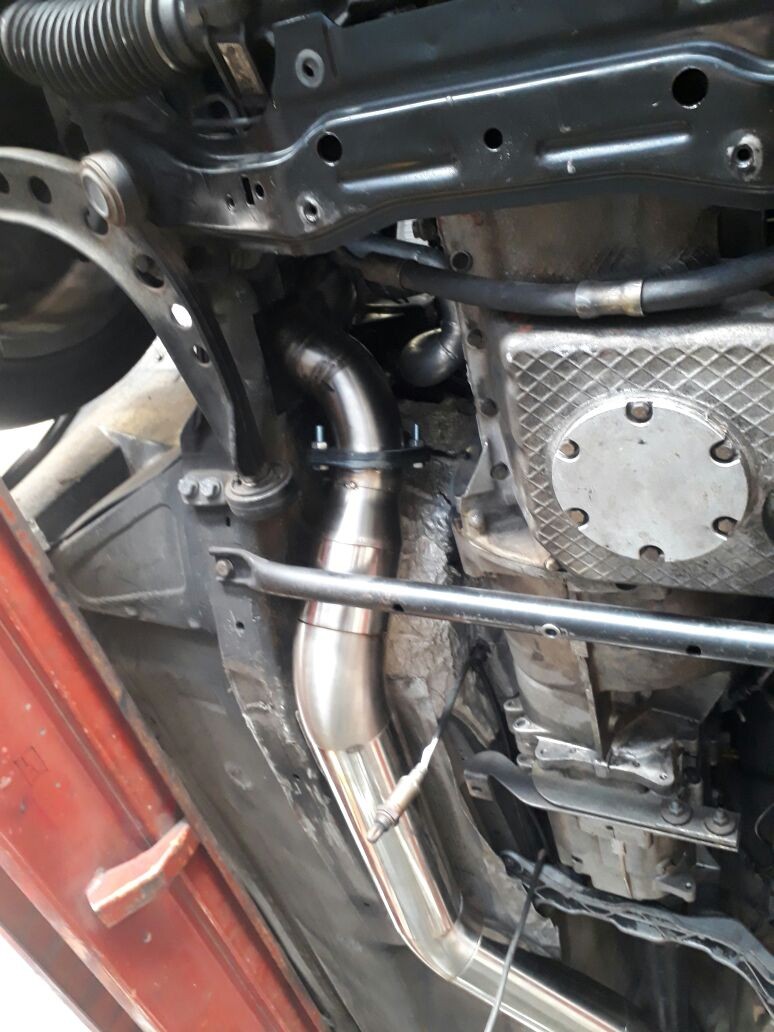

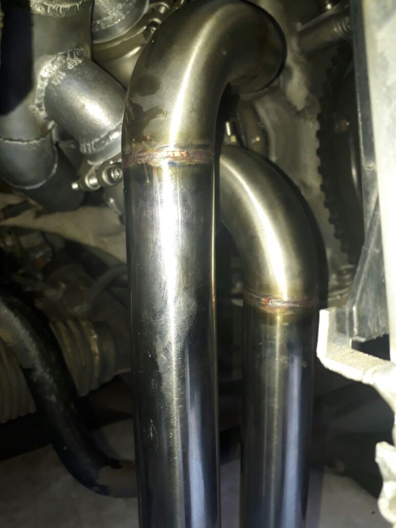

downpipe will also be coated inside and out.

Unfortunately not..Yes this design was to make up the most space for downpipe with the idea of dropping it like this
but then felt like it will restrict flow with a sudden bend

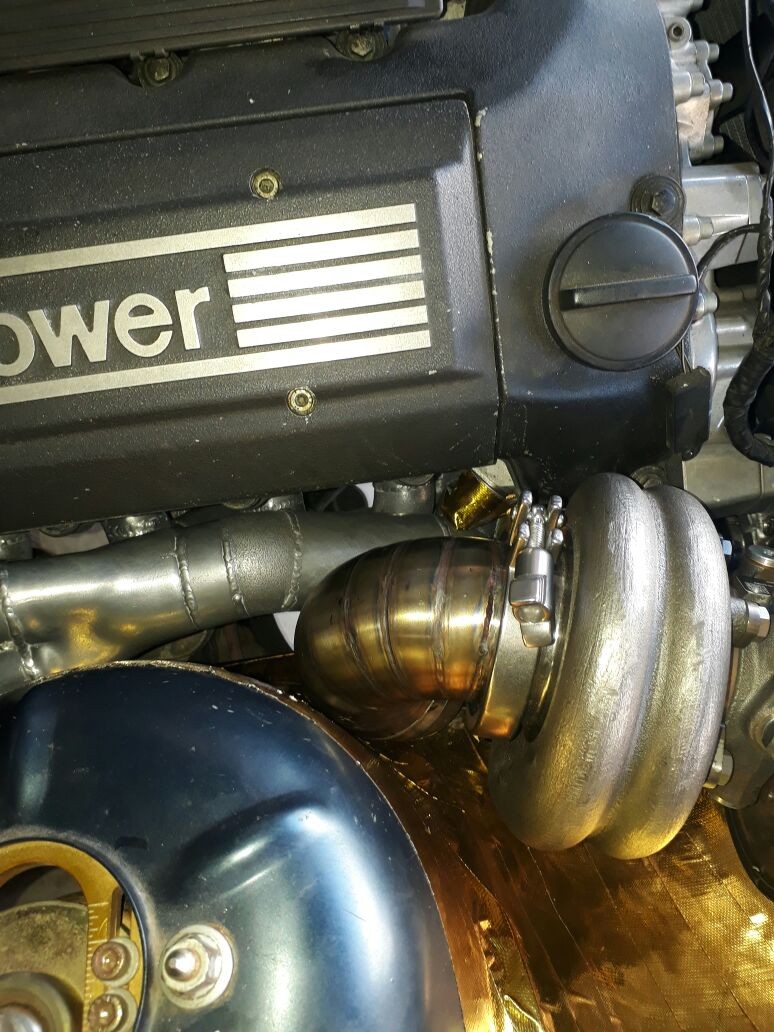

Loving this build! figured I would share my manifold pics I also used M3 flanges on it that turbo makes my Garett Gtx35 look tiny lol

Coming together nicely bru:praise:

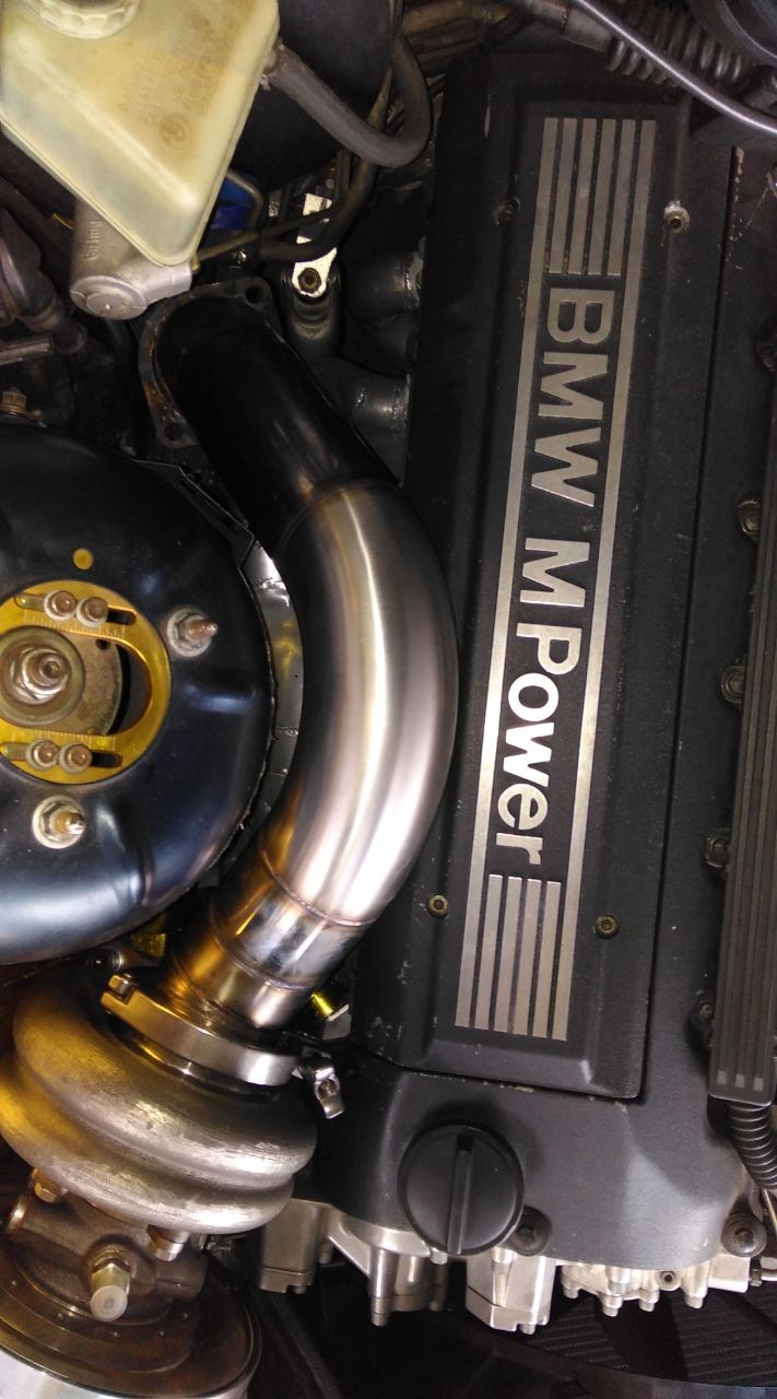

Peter@AEW
Very nice pipe work

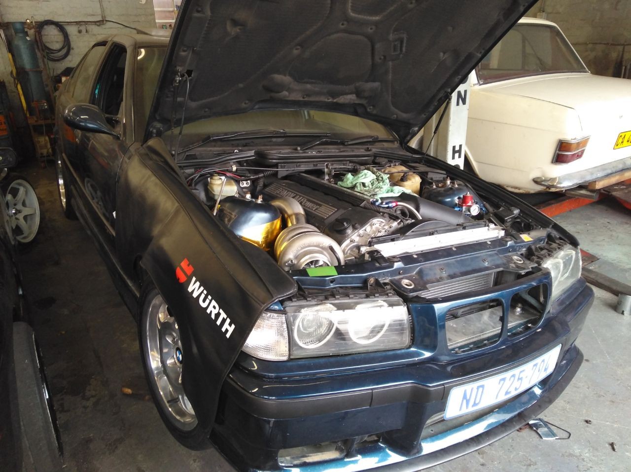

With all that power you might wish to brace the engine against torque movement with a shock absorber like they used to do.

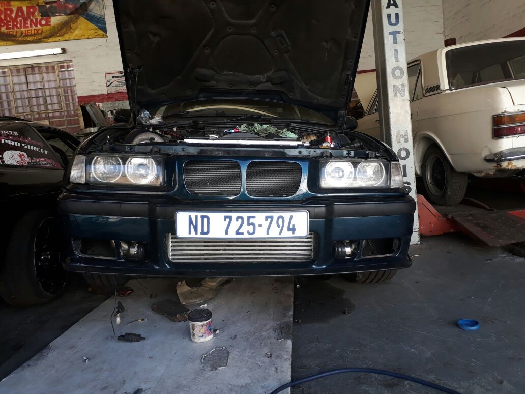

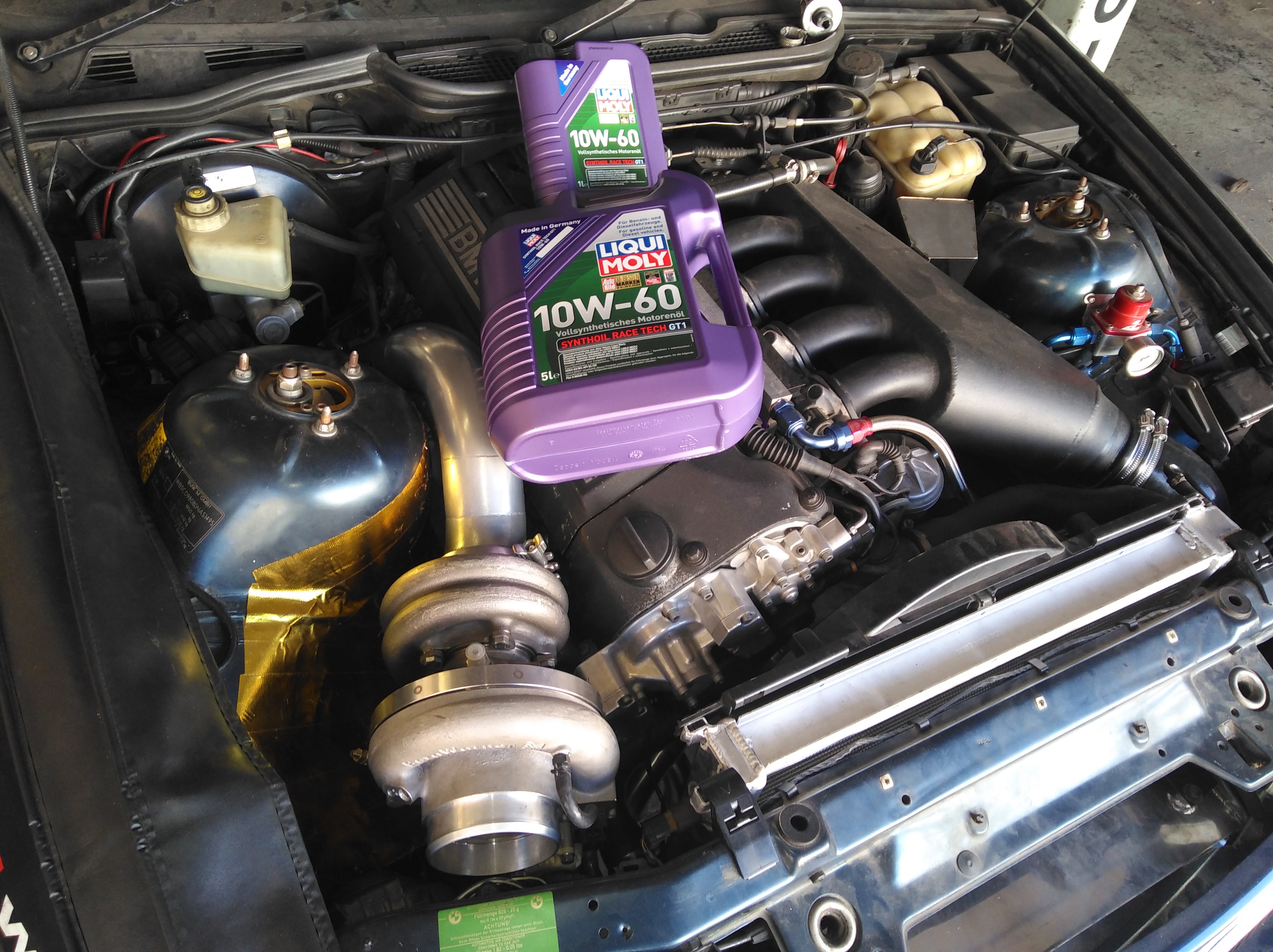

KingKalie

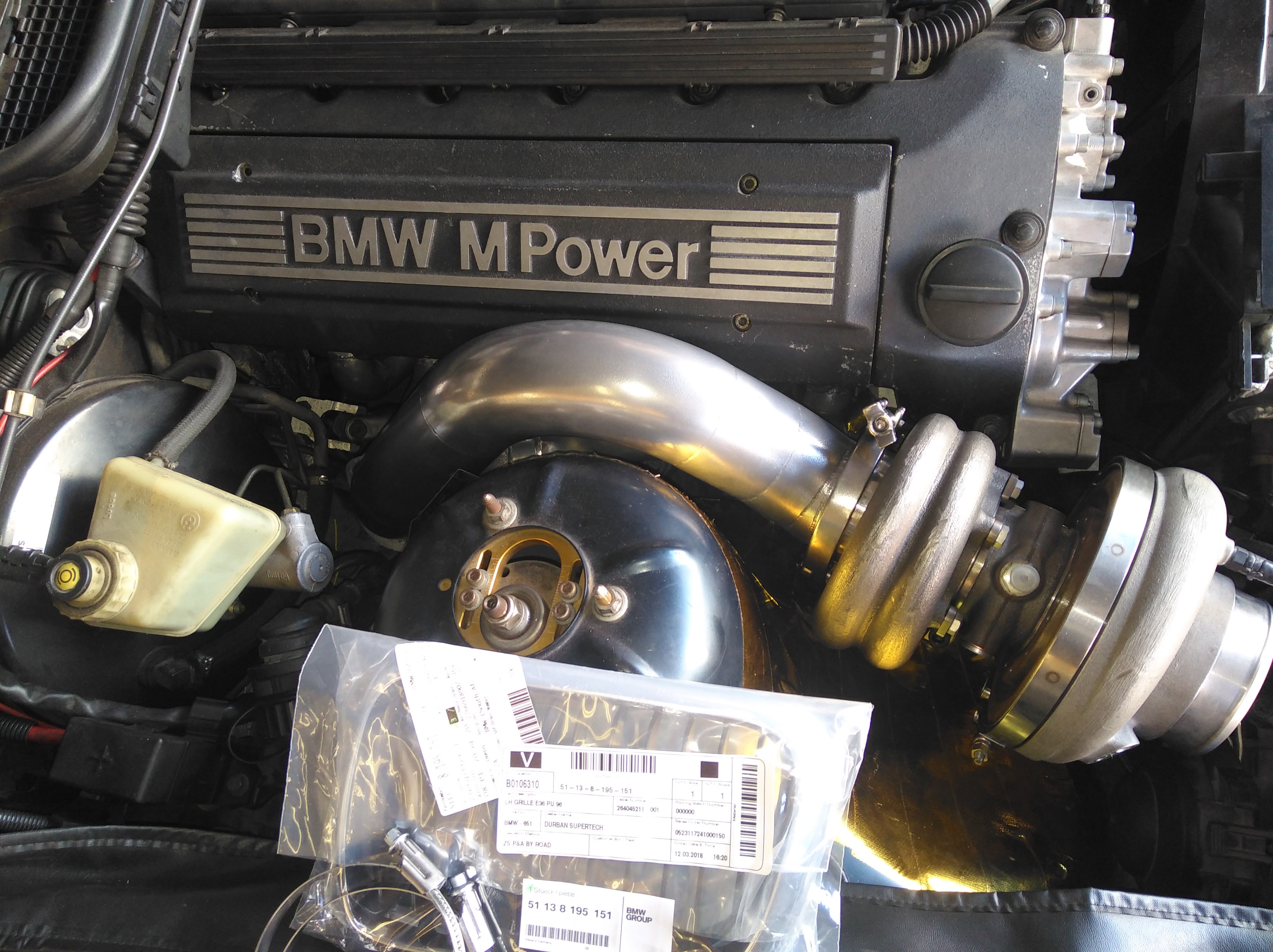

That turbo is sitting pretty in that engine bay :thumbs: although is the heat not going to cause a problem over the valve cover like that? thinking plugs wires and rubber gasket? or are you going with the pipe straight down from the turbo?
nait
I'm going to ceramic coat that pipe inside and out and currently working a fat induction to the hot side..if it still too hot then I will heat wrap over the coating.
Peter@AEW
nait said:
Ceramic coating in and out will reduce radiant heat by almost half.
When I was speaking with Gary of Powerkote he told me that many under ground vehicles have their exhaust manifolds ceramic coated to reduce radiant heat.
nait
Peter@AEW said:
nait said:
yes and also keeps the hot gases inside to help spool fastest

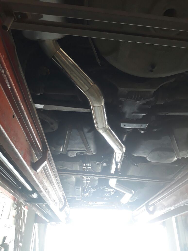

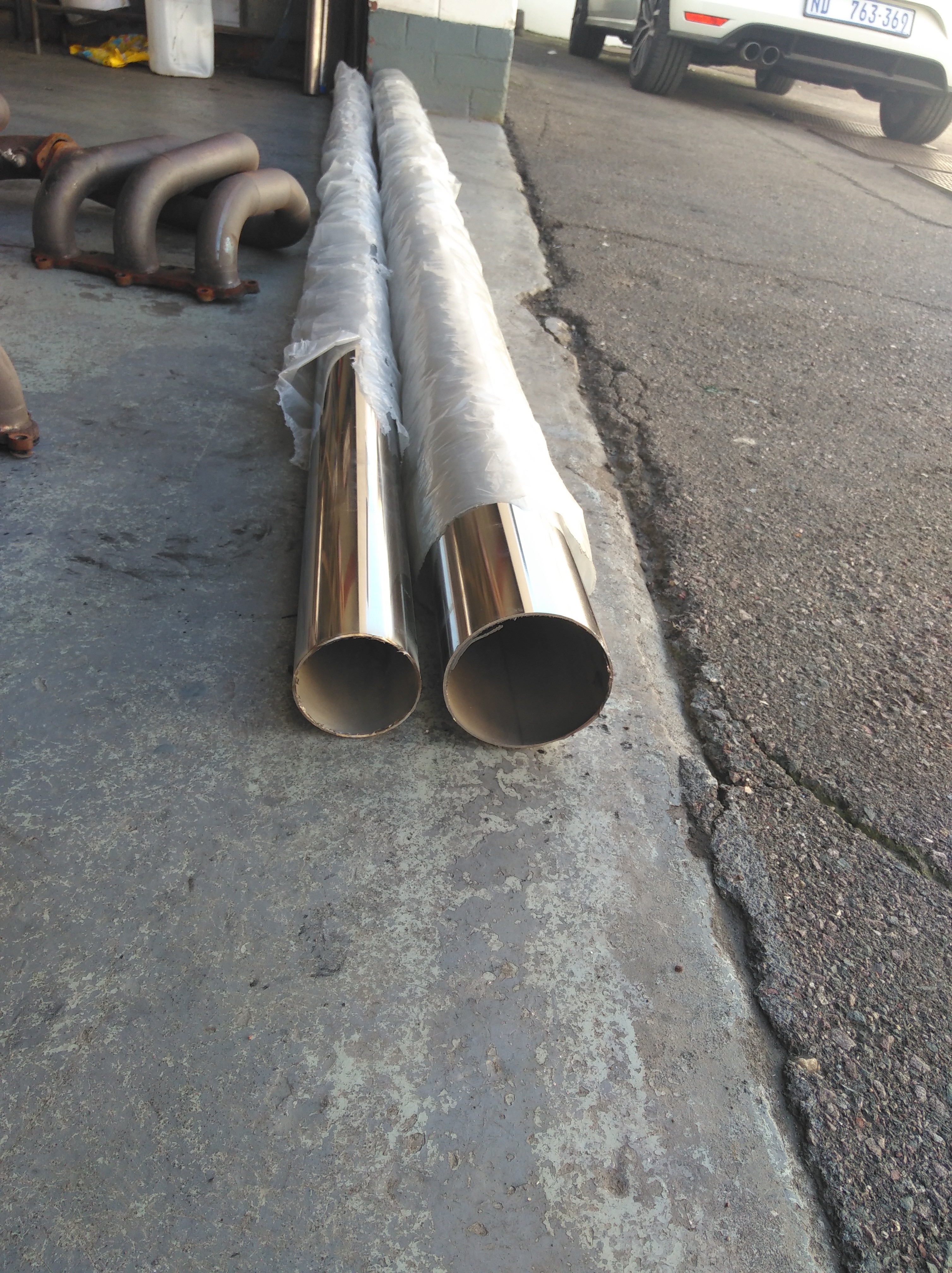

Want it to sound like a Scooby especially the dump:fencelook:
individj said:
reminds me of the bus exhaust on a Ford 3.0s
It's as thick as a wooden light pole :smilebounce:
