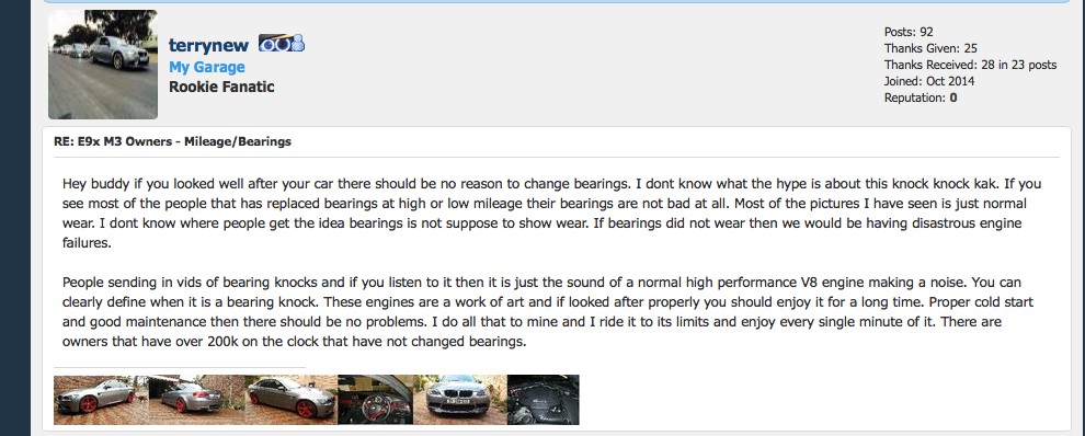

terrynew said:
Hey buddy if you looked well after your car there should be no reason to change bearings. I dont know what the hype is about this knock knock kak. If you see most of the people that has replaced bearings at high or low mileage their bearings are not bad at all. Most of the pictures I have seen is just normal wear. I dont know where people get the idea bearings is not suppose to show wear. If bearings did not wear then we would be having disastrous engine failures.
People sending in vids of bearing knocks and if you listen to it then it is just the sound of a normal high performance V8 engine making a noise. You can clearly define when it is a bearing knock. These engines are a work of art and if looked after properly you should enjoy it for a long time. Proper cold start and good maintenance then there should be no problems. I do all that to mine and I ride it to its limits and enjoy every single minute of it. There are owners that have over 200k on the clock that have not changed bearings.
So the engines that had disastrous failures failed because the bearings didn't wear?

Peter@AEW
@terrynew
On the engines which I have worked on after they have experienced catastrophic bearing failure I have noticed that the main bearings are comparable to new and the big ends are showing copper.
Bearings do wear no argument on that however ones definition of wear needs to be within manufacturer tolerance and anything beyond that would be considered as failure.
During October November and December last year I rebuilt 3 engines which had covered (from highest to lowest) 198000Kms 165000Kms and 80000Kms.
The 198000 kM engine failed due to the fact that the chain tensioner piston backed out its housing and the subsequent oil loss destroyed the engine.
The other two engines failed due to big end bearing wear being excessive.
Draw from the above your own conclusion however I can tell you that on my son's S54 we replaced bearings at roughly 110Ks and they were down to copper...all of them.
Should you wish pm me your email addy and I shall send you some pics.
