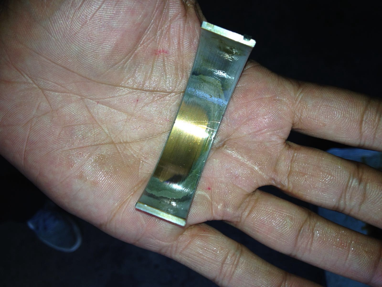

Had my bearings done in February 2016 at 91900km on the S85. Full service history etc had the books everything. I did the bearings because I wanted to create a base for the car from my ownership forward. Went to Tunetech to have them done.
The image below shows what was found and they all look like that, all down to the copper. I now sleep a bit easier.

Hi
How much did it cost? I'm also thinking of doing the same as a preventative measure.

Hi
Came to R27000 for the V10

Ya hey a rebuild on the V10 starts at R160k+ so that R27k was well worth it. It's because of forums such as this and abroad that I identified that this was a potential issue and went ahead and had them done.
I do think there is a issue and glad have peace of mind now. Tunetech also gives a 12month unlimited Km warranty after the job.

I did not do an oil analysis, just bit the bullet because i knew I was going to have to do it sooner or later.
