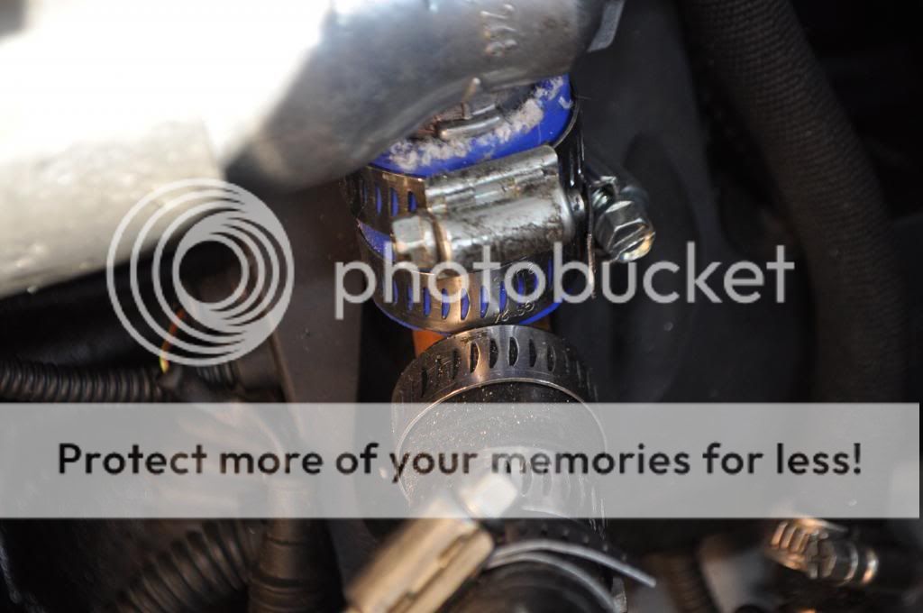

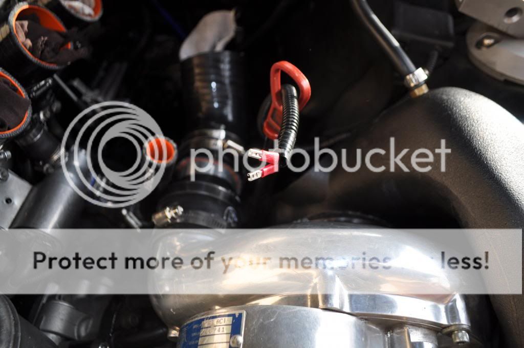

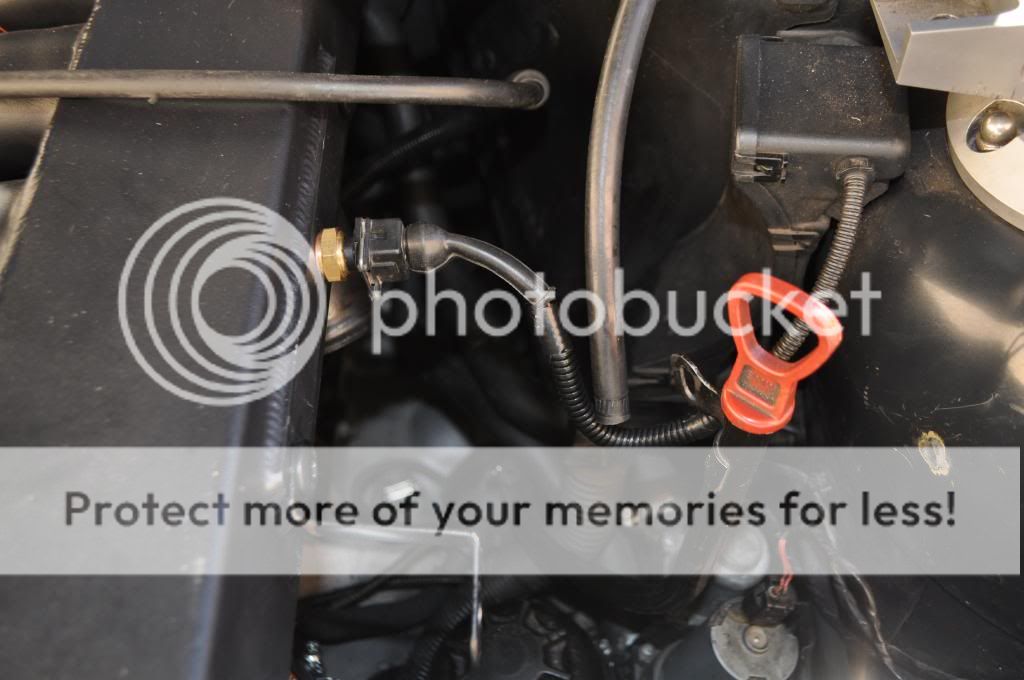

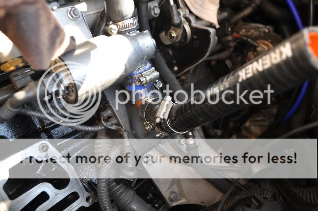

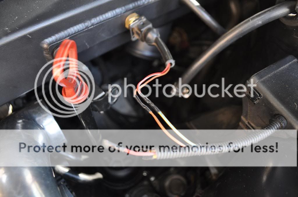

As to the supercharger installation I present the following for those that may not have followed the thread in its entirety....and once again reiterate my earlier statement that I advised that there would be a charge for my time.

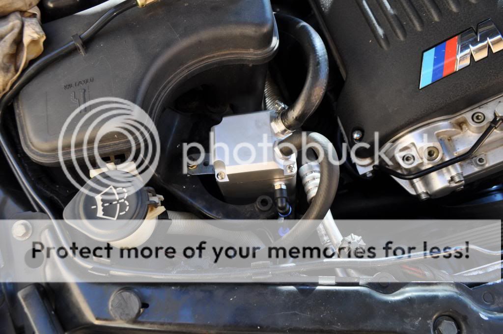

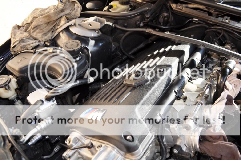

Oil catch can located in ecu box area
After Oil catch can relocated

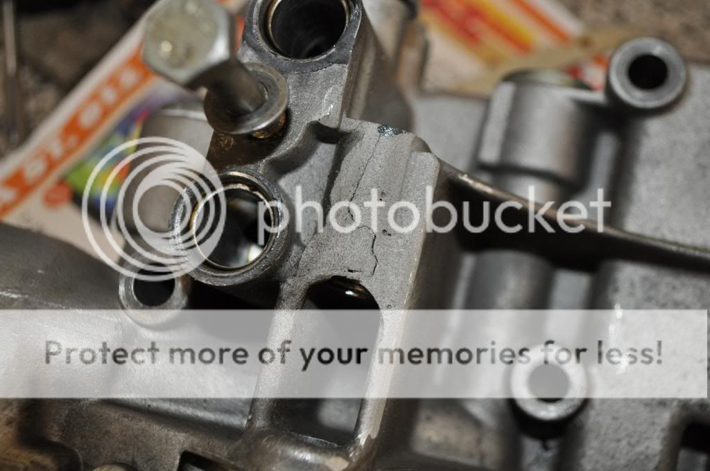

Alternator retaining bolt mounting cracked from over tightening bolt.
The oil filter housing had to be welded a second time after it was cracked on a previous occasion from over tightening

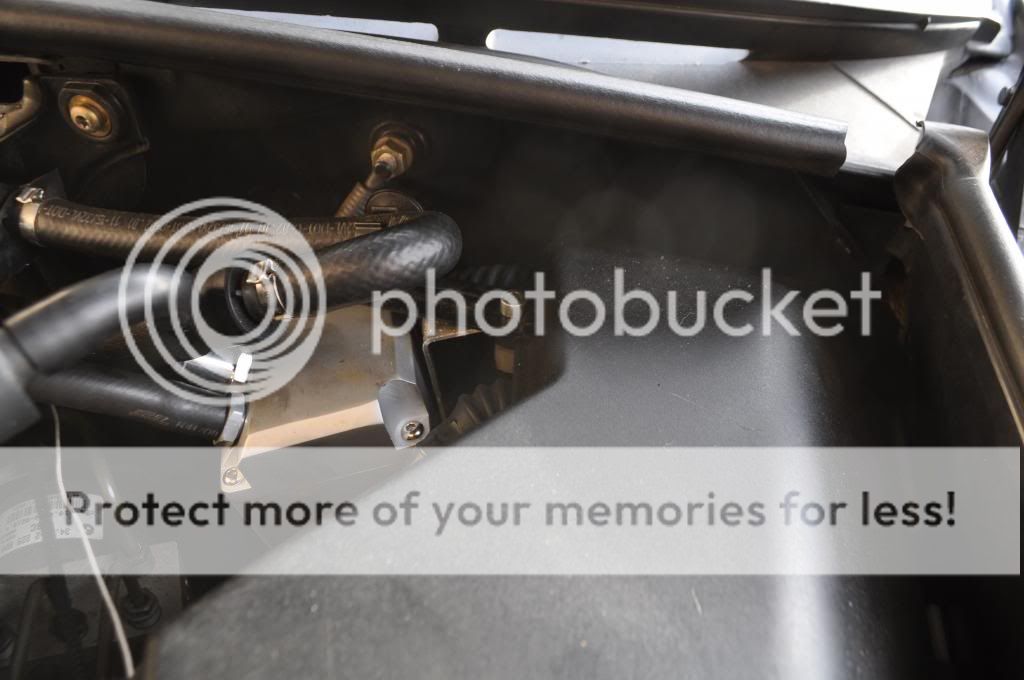

Before Idle control valve to plenum pipe
After
Before Air temperature sensor wiring
After

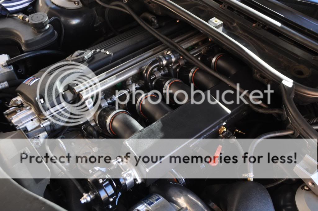

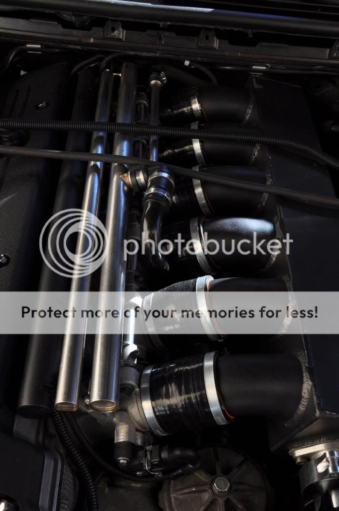

Before Plenum to throttle body pipes.
I unfortunately did not take a pic of the clamps that were originally used nor their location.
After
