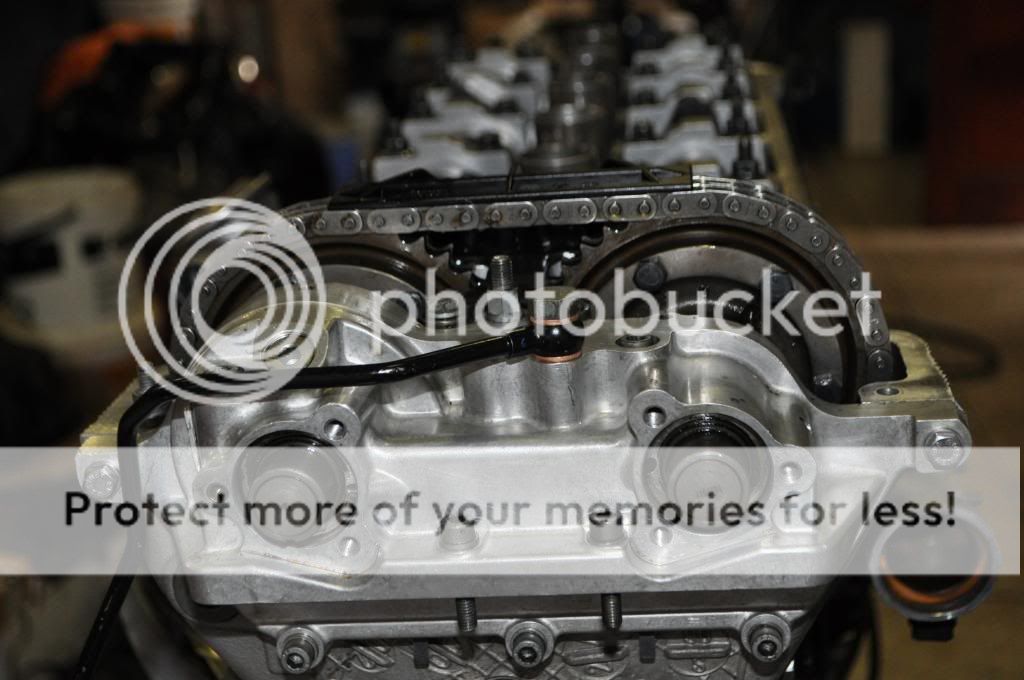

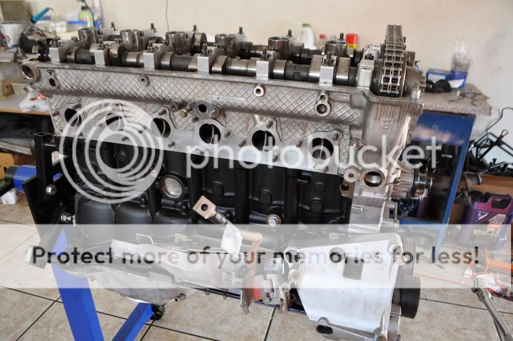

Alex thank you for the clarity within your post.
With regards to Exhaust spline shaft placed on intake camshaft hub/gearbox and intake on exhaust.
If one looks closely the exhaust side of the motor has the spline shaft protruding
The below picture clearly shows that the pistons are equal in protrusion within their respective chambers, something that would not happen if the spline shafts were mixed in the cams.
The above pictures refute your allegations as does the video evidence presented by Christopher, which specifically indicates that the exhaust spline shaft is located in the exhaust camshaft hub.
One can equally see that the hub has not been disturbed as it is covered in engine oil as are the hub bolts and the spline shaft. Clearly at that point of the video you are still in the process of discussing things with Christopher.
For those that are not familiar here is a link to the different sizes on the spline shafts with the exhaust being longer than the intake.
With regards to your assertions of the spline shafts being incorrectly mounted I need to tell you that you are far from the truth. If one were to mount them as you propose the vanos piston would push into the end cap and cause it to leak oil profusely.
With regards the 15 degree "story" it was you who said it to me twice; once when I first phoned you, and the second time when you came to visit me. I will not comment on what you may have said to others.
You have still not explained how you came to test the cam position as per the video.
Please explain in the same amount of detail as you did with the spline shafts which were placed correctly but which you have chosen to represent as having been fitted incorrectly.
To start you off ...I removed the tappet cover and brought the engine to top dead center...
For those following this pulling of teeth I have made a note to demonstrate the above when Nikhil visits.
For those who may not know what an end cap is here is a picture of the vanos with the two caps that seal the pistons within the unit.
They are commonly referred to as end caps.

BahnStormer said:
Peter
I was being polite, but will now be to the point and I will absolutely answer your questions, on a public forum, as you request.
Secondly, I didn't want to get into this point because it exposes gross negligence, but you asked.. Regarding the splines, you went as far as to mix up the intake and exhaust vanos splines on Chris's car. Yes you read correctly.. you connected the intake spline to the exhaust piston and exhaust hub sprocket and vica versa which could have resulted in catastrophic failure of..well pretty much everything neighbouring the splines and I'm amazed that neither the pump, vanos pistons, solenoid pack nor the splines themselves got shredded.
Let me start off by making the following statement of fact: You were not being polite you were lying.
The spline shafts were not incorrectly seated as proven by the video footage supplied by Christopher.
If you thought that you could make a statement as per above and get away with it you are more foolish than I thought you to be.
I reversed the spline shafts in the cams so that I could show you what happens.
This picture shows how the spline shafts should be located.
The exhaust spline shaft on the left hand of the picture has a stem noticeably longer than the intake which is on the right hand of the picture
In Christopher's video we see the exhaust spline shaft with its long stem.
Here is a picture captured from the video
Below is a picture of the exhaust camshaft with the inlet camshaft spline shaft located and secured in it.
Here is a picture with the exhaust spline shaft located in the inlet camshaft
This is what they look like when viewed at a slight angle
This is a picture of the vanos body mounted on the engine with the exhaust side piston visibly retracted in the cylinder due to the fact that the inlet spline shaft has been placed on the exhaust camshaft.
This is a picture of the vanos body mounted on the engine with the inlet side piston visibly protruding from the cylinder due to the fact that the exhaust spline shaft has been placed on the inlet camshaft.
And here is a series of pics as to the reason that no sensible man would ever mix the spline shafts and ignore it as the engine would not run for very long with 100 Bar of pressure pushing the oil out of the end cap which cannot be secured on the vanos body.
If the above is not evidence enough than nothing will be.
Equally and I quote:
"I really have nothing further to say. You can post as many pictures as you like, I know what I pulled apart. I am not here to make up random stories because I have nothing to gain from this tragedy."
The reason that you have nothing further to say is due to the fact that you have built on lies the most ludicrous and far fetched being that I placed the spline shafts incorrectly into the wrong hubs.
Prove me wrong please go set up your car as you say I did the spline shafts and come visit me in it (I very much doubt that it will run).
If you make it to my house from your house driving your car under its own power and not with a ceased engine you can have the keys to the red car.
