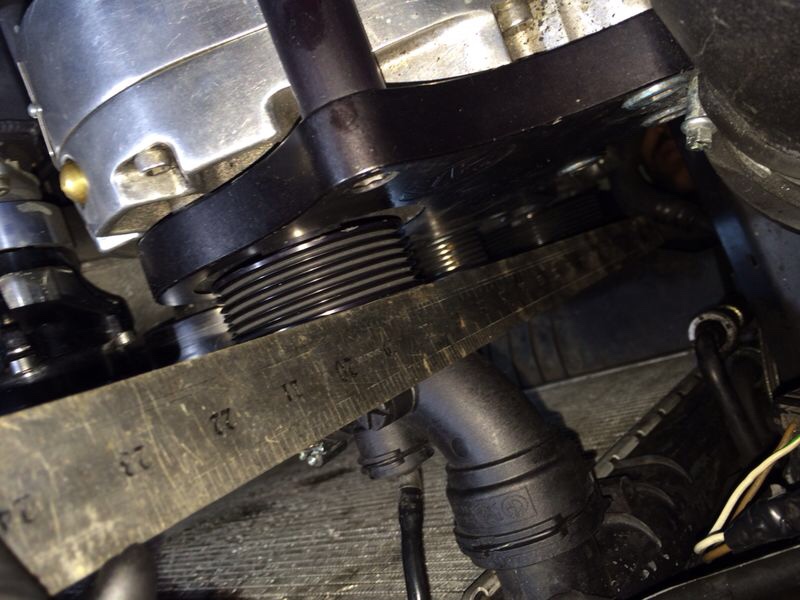

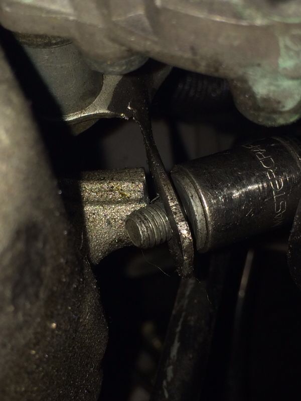

How many times Peter, did I say, the power steering pump pulley wheel is skew.
Yet you told me my eyes were skew, that I didn't know what I was looking at. Who the hell do you think you are? How can you speak to me, not just a paying customer, but a friend like that? That blew my mind? That you could say something so cruel. I am easy to offend when I deal with people I trust. So, clearly the relationship between us was not mutual. I looked up to you, yet you looked down on me.
In the end Peter, I proved you wrong. I fixed my car myself with the help of Nikhil. But the damage was already done. The car had already overheated twice, once when the belt came off originally. The second time when I was testing the new belt tensioner, which apart from swapping for a smaller serpentine belt, seemed like the only other solution, as you would not admit to to the power steering pump being skew. So, after installing the new mechanical belt tensioner myself one Saturday afternoon, I had to take the car around the block to see if it fixed the issue. I was less than 500m from my house when the belt came off. I told you I parked the car right away after the cluster light up like a christmas tree. Yet the cars temperature kept climbing. You told me not to worry, that it wasn't in the red for long enough to cause any damage. Do you remember this? I sat for half an hour waiting for the car to cool down before trying to get her home. But, you seem to think I just drove the car happily without concern. You told Burgy that I am at fault for overheating the car because I drove it around? Yet you are the one that told me to install a new tensioner and to test and see if the belt comes off. We tried everything short of changing the water pump pulley and crank pulley before I just decided to get Nikhil to help me straighten the power steering pump ourselves. But you still had the guts to blame it on the vibration from he supercharger, not your handiwork. You are delusional. Here are some pictures from your skew pulley install.
The first picture is the actual bolt and how it was sitting on the power steering pump. Nikhail can confirm this is how we found it installed on the car.
The second photo is the straight edge that was used to show the direction that the power steering pulley was facing. Note, the straight edge should rather line up with the supercharger pulley up top, instead the straight edge runs at an angle past the pulley.
The third photo shows how the straight edge is aligned with the supercharger pulley once the power steering pump was correctly installed by Nikhil. These photos were sent to Peter, but he blamed it on the new pump being faulty. Not his workmanship.

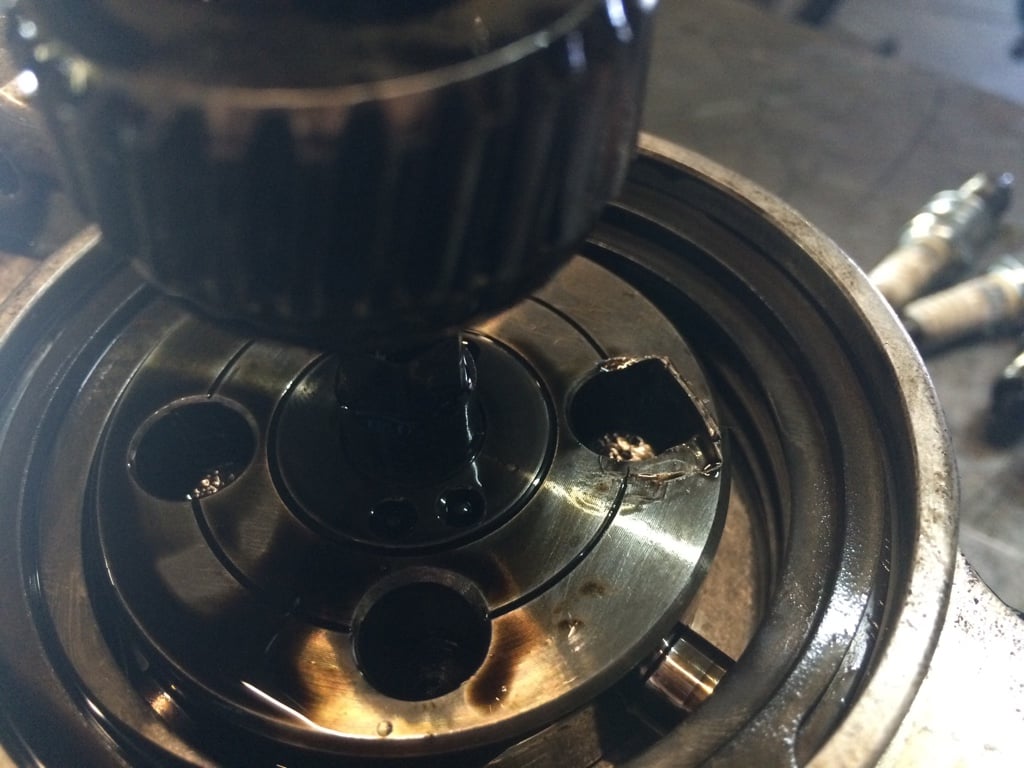

Lastly, whilst we are looking at photos, here is the pump disc I mentioned earlier, that does not belong to me. See how it is damaged. Looks pretty much like the one that came off tehwalleth's car. I for one am not happy about having a pump disc of this type on my car and would have appreciated being told about it.
