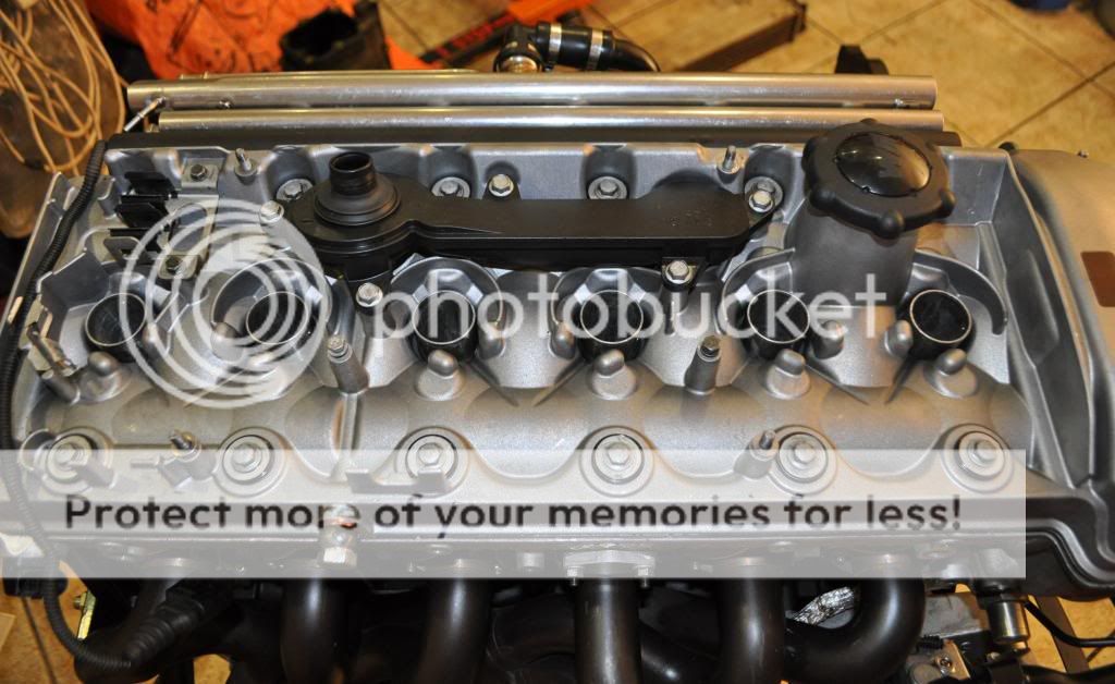

Go see universal coolers and get a 100mm intercooler core that will fit in the space but it must be many short rows opposed to fewer long rows. Pics included. Make up your own end tanks and mounts which is rather easy and you will have the most efficient intercooler there is, far better than anything imported thats for sure! I will be making my own later this year for my turbo build.
