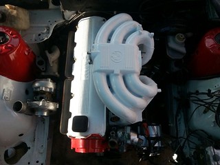

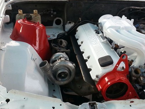

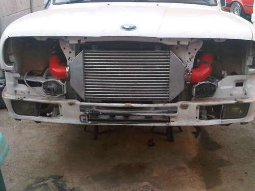

Concise mods list as I have it all excel'd for anyone who is keen to know.
16" 540i wheels
Slotted discs
660cc injectors
Snow performance watermeth
Swirled valves
Ported and polished head
O ringed block
High Tensile headbolts
Victor Reinz Gaskets
Turbonetics Turbo
Custom 76mm downpipe
Turbonetics wastegate
76mm exhaust
Powercoated turbo exhaust housing
Alpine Developments manifold
Powercoated manifold
Ported intake manifold
Custom powerflex engine mounts
Spitronics Management system
HnR Springs
Custom LSD (3.15)
E36 325i coupe gearbox
6 puck copper button clutch
High pressure fuel pump
D1 Spec adjustable fuel pressure regulator
Custom built front strut brace
Autogauge boost and fuel gauge
Lightened and sintered flywheel
All rotating parts balanced
Sabelt 4 point harnesses

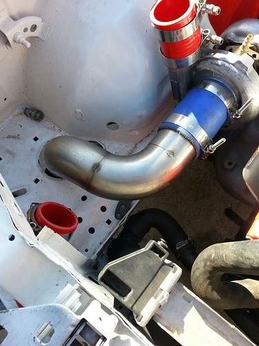

Racing Snake has just introduced stainless steel welding to his list of services, as you can see we decided to make my plumbing quite intricate to show off his skills.
Contact him for more details!

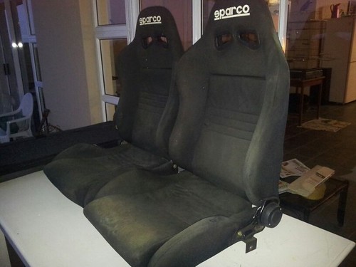

Found some 2nd hand original sparco buckets for the car too.:inlove:
