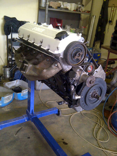

So gents a bit of progress, going to upgrade the small T4 for a GT35 ballbearing turbo.
Going for forged rods and pistons as well to hold the planned 1.5 bar of boost, will also have ARP studs.
Water jackets are being welded to create a better seat for the headgasket.
Also looking at a 150hp NOS system that will be installed along with the water/meth system.
Aeromotive fuel pumps will deliver the fuel to 1000cc injectors and a custom fuel rail and D1spec adjustable FPR.
Should do this to an E92 M3 comfortably when finished.
