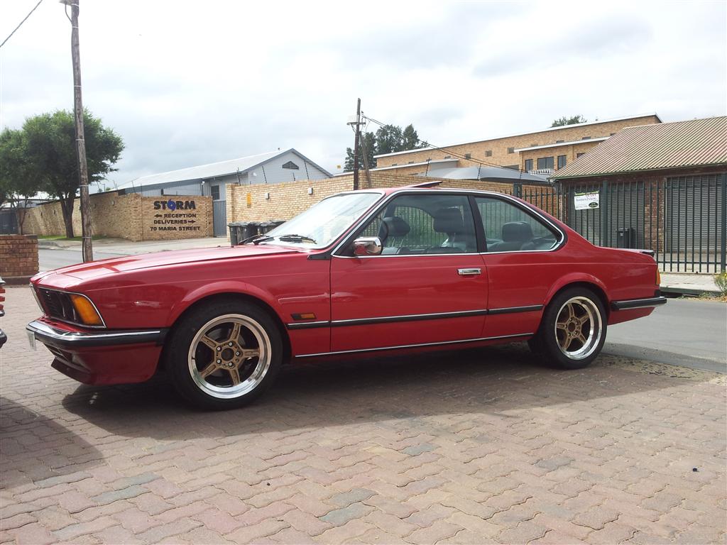

Right, to quell the nagging I had Helga washed and waxed this morning with a little leather treatment. Days like this I heart my Shark :inlove:
Note the new lights, wheel covers and unbutchered center console!

New wheels arrived from Germany. Cost almost as much as the bloody car but the sexiest wheels on the planet. Only problem is that the offset is too low at the back. Muppet who sold them said ET15 but they're actually ET4!
Now the back tyre rubs the arch. Still sexy as fuck though.

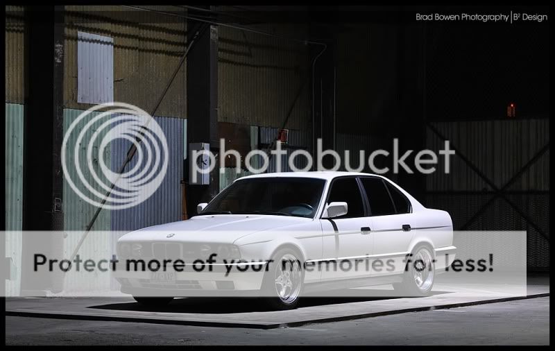

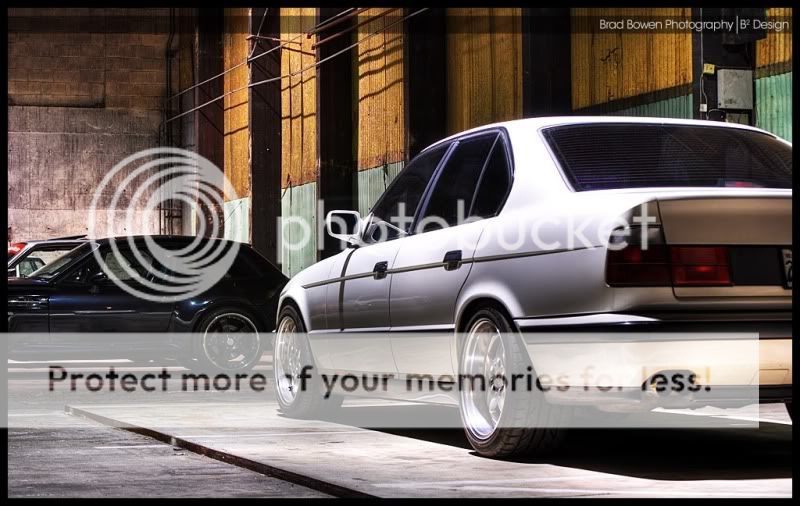

Look good on E34 too...
Do you really need 10.5 inches in the back? By the looks of the stretched tyre on there, you don't. Instead of spending tonnes of money modifying the car to fit the wheels, rather modify the wheels to fit the car. Take 1 inch out of the outer dish, that will increase the ET which will clear the arches and your tyre will fit the wheel better.

skank
Well! As with all things in life the application of Occam's razor is normally the best....
I removed the rear arch extensions and gained about 6mm clearance, no more rubbing. Can't believe BMW would screw the things in, very ugly. I have slight poke now but will cut and silicon the arches on for a better look and to avoid having them as horrible rust traps.
