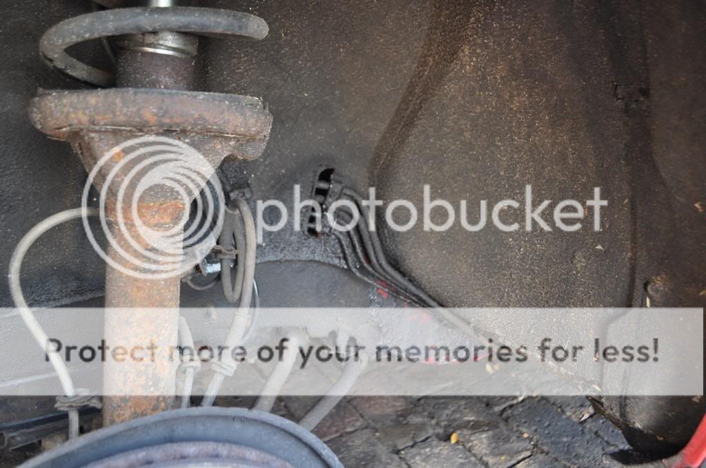

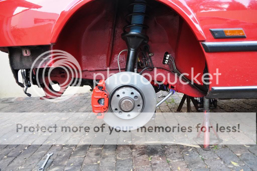

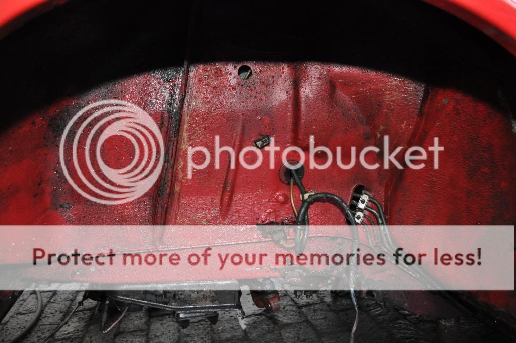

You can see the original red paint in the wheel wells.
At some stage someone sprayed black stone chip in the belief that it looked better.
I am not convinced so I stripped it back to original and will touch up the areas in which the red has worn away.
This is an English car and I now have a deeper appreciation as to why the English boards have posts about rust blaster,heating bolts and soaking bolts prior to loosening them.
The salt that they use on their roads really attacks the metal and corrodes it solid.
I will have to change every single nut and bolt on the suspension.

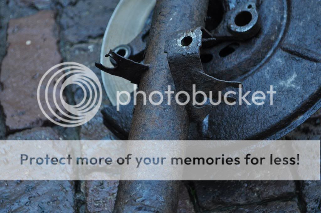

The brake disc backing plates are wafer thin after having been exposed to numerous salt baths.

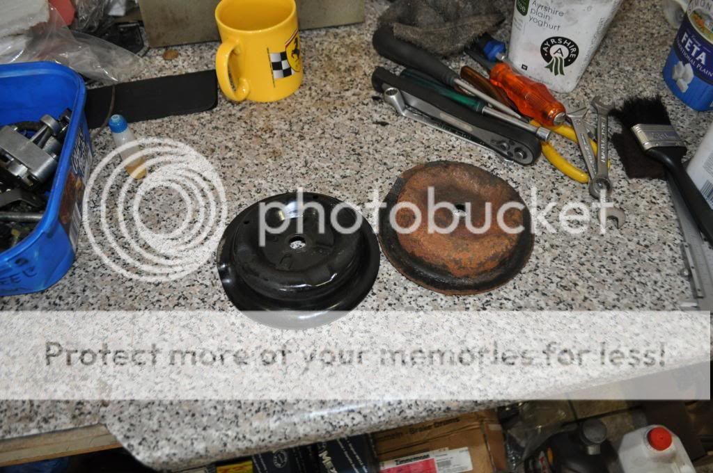

The struts are dimpled from rust.

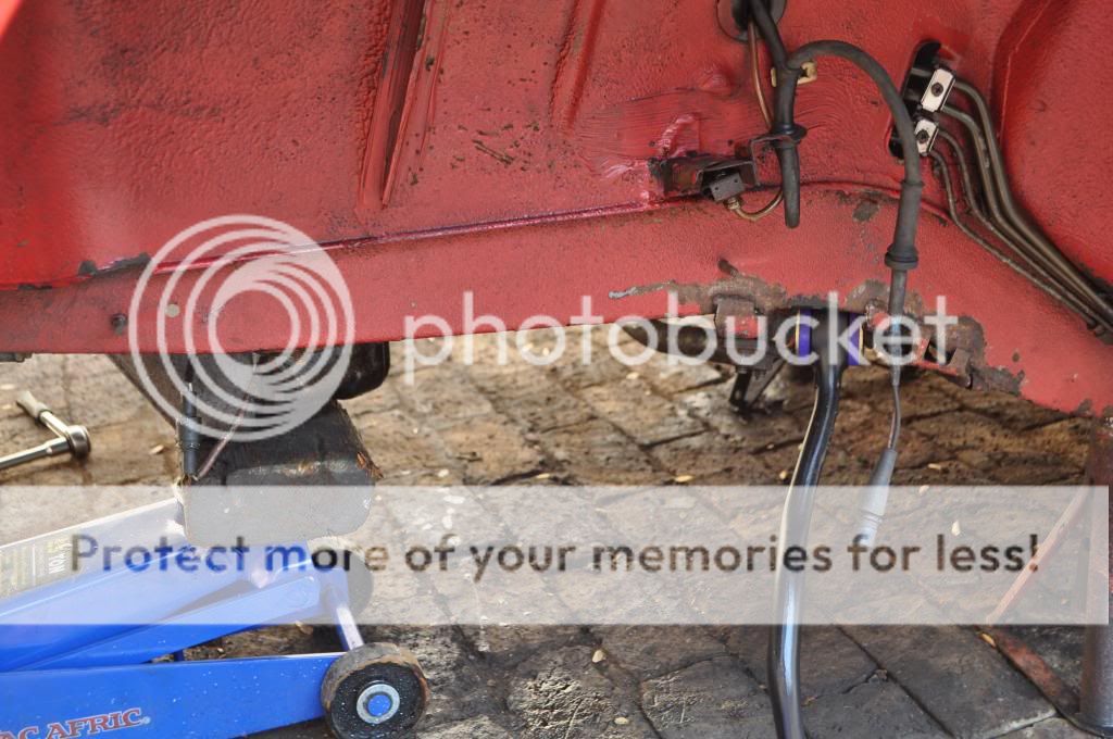

Rick wants poly bushes fitted on the new suspension arms so I will check all welds on the car mounting points and will reinforce any that look suspect.

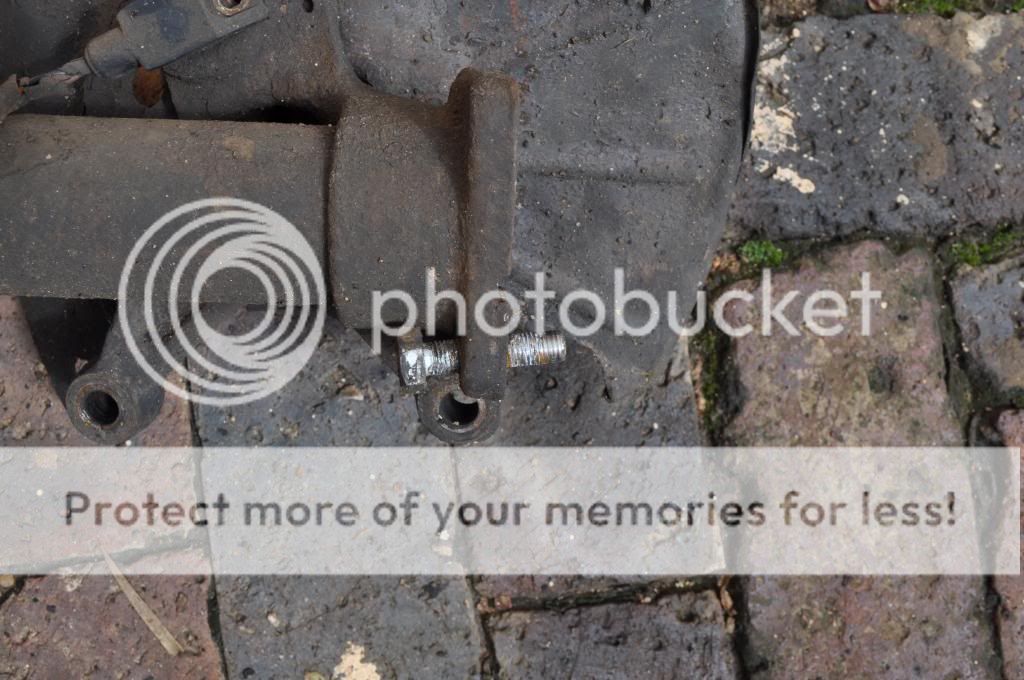

A slight modification made in SA I suspect.
The strut is held onto the lower suspension by 3 bolts which thread into the bottom of the strut.
Clearly the threads must have stripped and the strut was drilled to accept a longer bolt and nut.

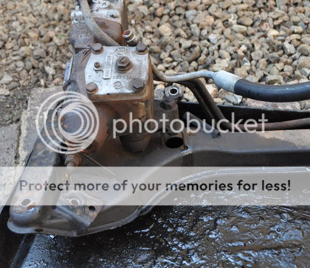

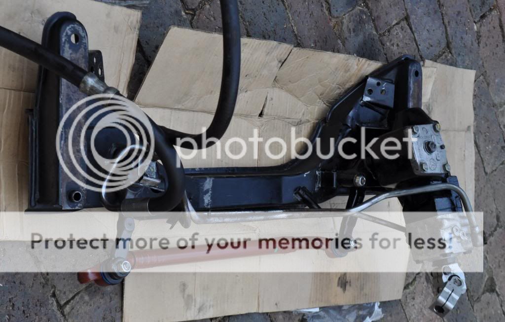

Stripped the front cross member of the car as it is kinked where the lower control arm sits.
I needed some more cleaning work so I stripped the steering box and pipes and gave them a good clean and a fresh coat of black Hammerite.
I placed the thrust arm in its position to verify the placement of a washer which is against the bush.

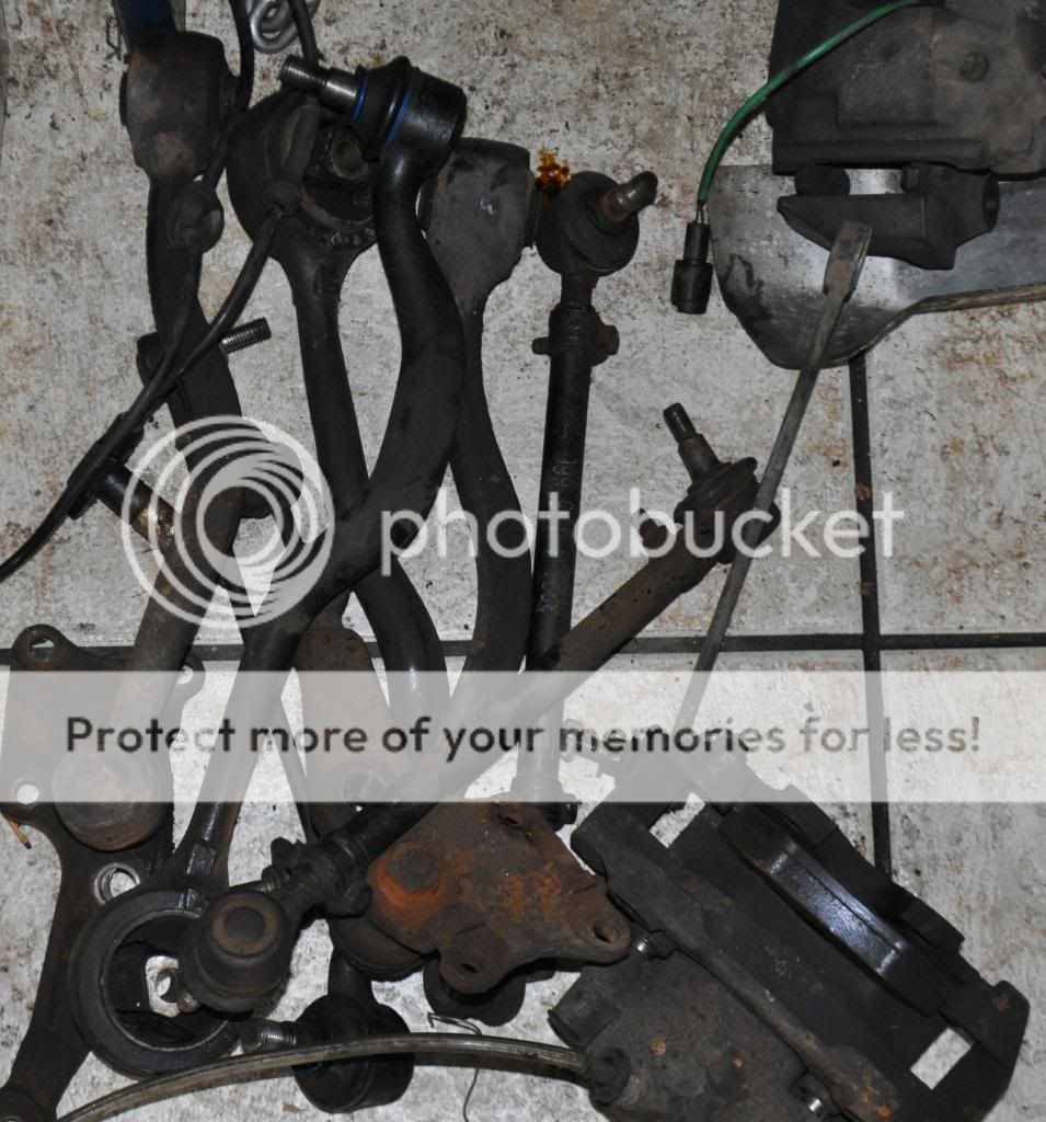

Here is a pic of all the old front suspension components which are being junked.
If anyone has use of e28 front calipers and discs with new pads give me a shout and I shall speak to Rick, even better pm Rick.
This is the replacement cross member from an e28 535.

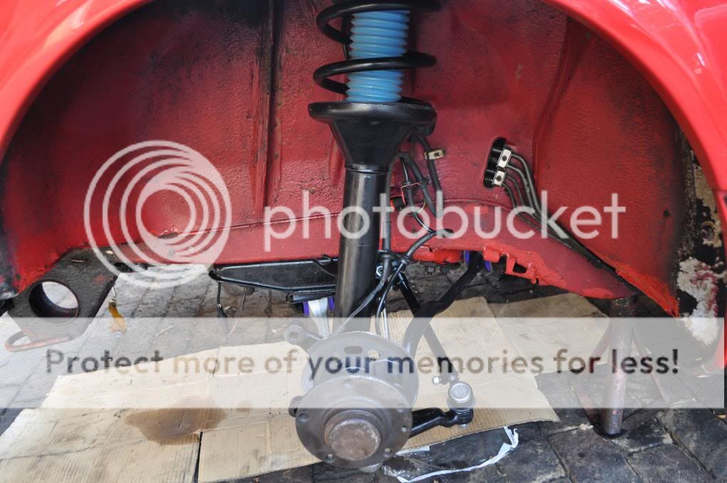

All new parts with the bushes pressed out and polly bushes fitted.
Front almost ready.
Waiting for anti roll bar to come back from powder coating as well as the M5 front calipers which are being ceramic coated along with the rears.

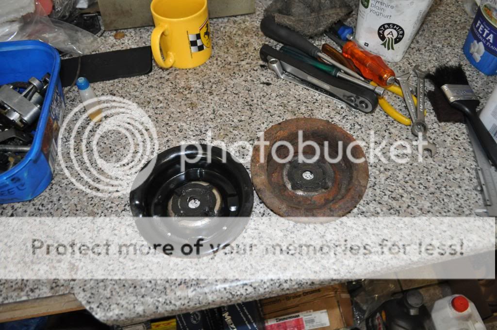

For those wondering I have cut the brake backing plates off as the new discs are very large and extend beyond the backing plate.
The small piece that I have left behind is so as to protect the ABS sensor

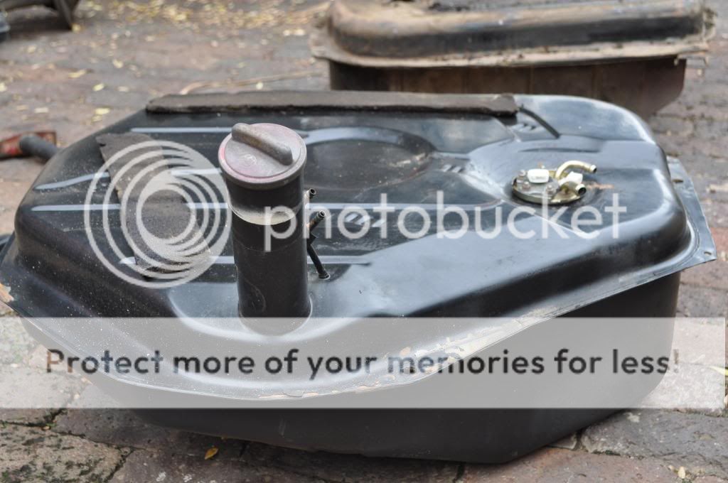

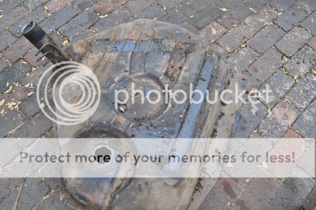

Installed new fuel tank as the one in the car had a leak at 75% fill.
Old tank.

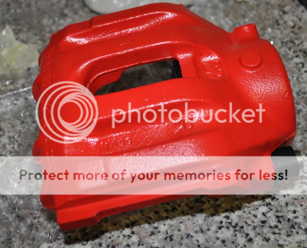

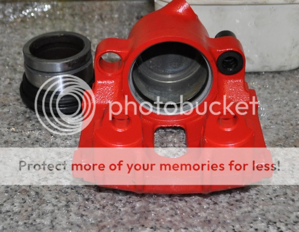

Brake calipers were ceramic coated and rebuilt.
Right hand caliper

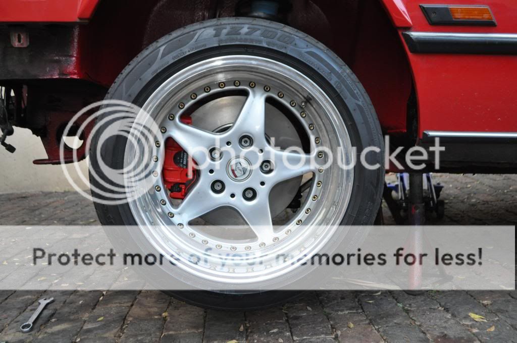

The front suspension is now complete with the addition of a silver (to match the rear) anti roll bar /sway bar/
Still need to bleed brakes but will hold untill I do the rear suspension overhaul.

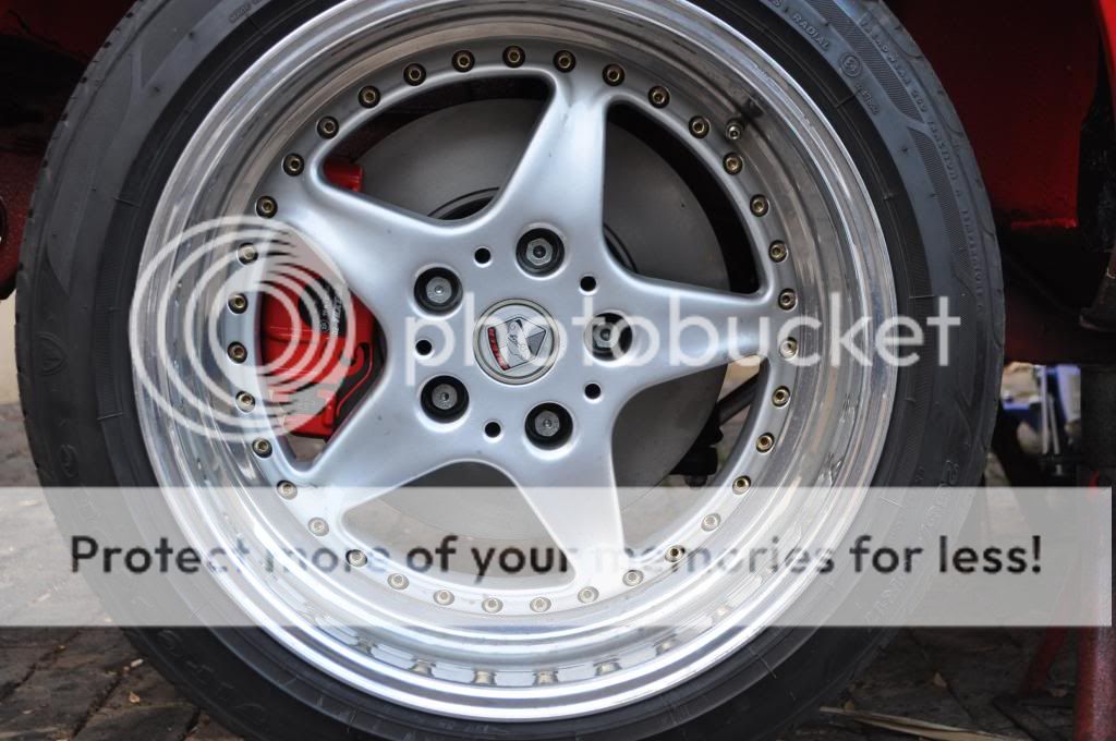

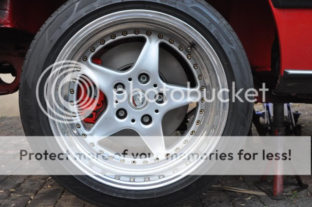

FOLGAR wheels imported at a considerable cost.
Love the way the brakes fill the rim.
