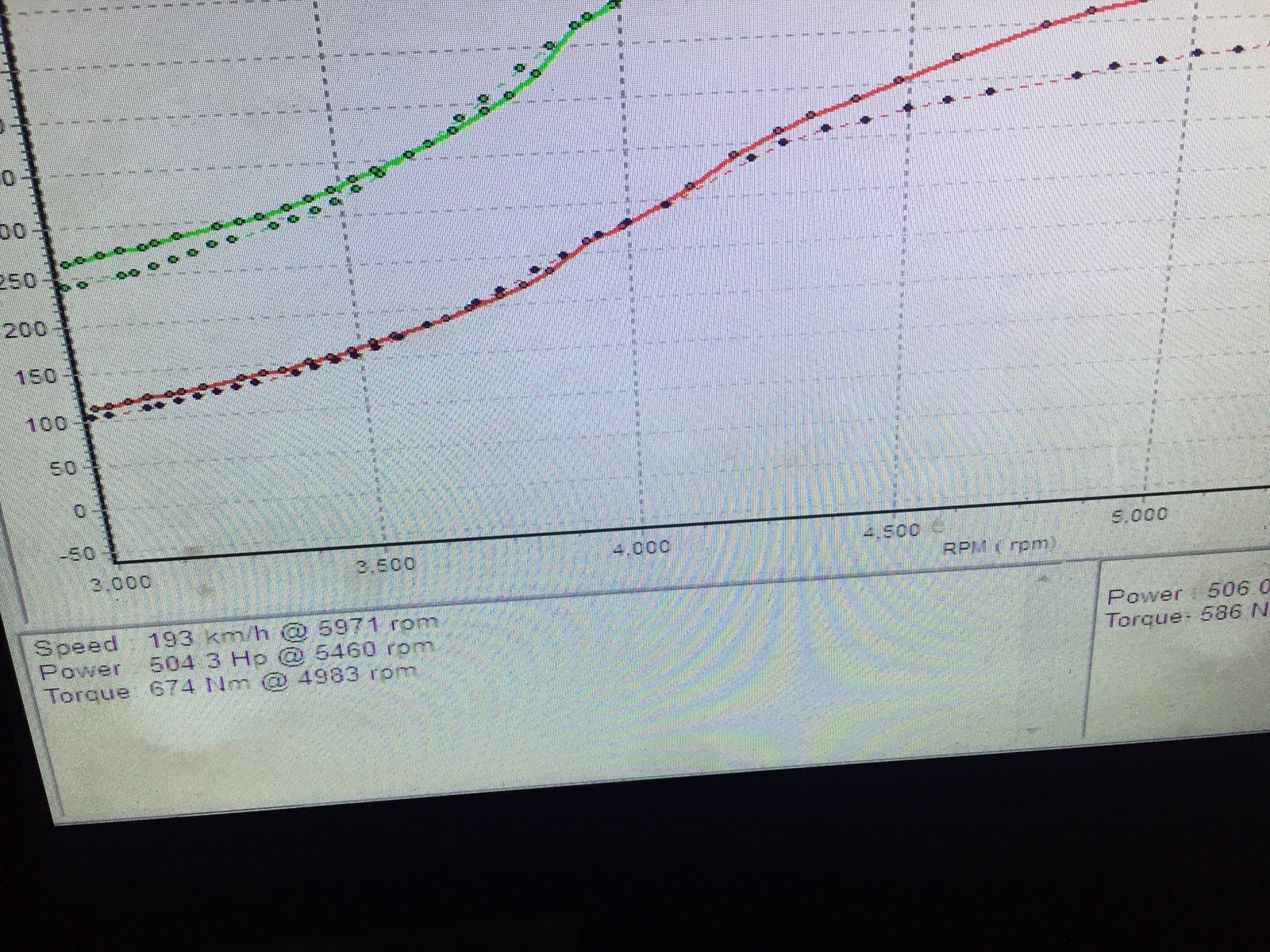

Update:
So as you may have guessed we hit the mystical mark of 500 Whp yesterday. A little eth in the tank and a dash of water meth, and presto:
The general consensus is to keep the car there for now so that I can get used to the power. I haven't driven it in this spec yet so I'm both very nervous and beyond excited to go and fetch her this afternoon. Leon says the car runs like an absolute beast :rollsmile:

KrS24
If you guys noticed the graph below Girevik77's 504whp. That's my graph. This revised setup comes into power much harder than mines. And the torque figures are intense. I went for a road test yesterday in this beast. Bare in mine I run my car daily at 520whp. But this car is a different animal. Its beyond exciting! on the 17psi I was properly scared (run flats) at 20psi I nearly crapped myself.
Girevek77 please take it easy in this car. Its dangerously fast :praise:
