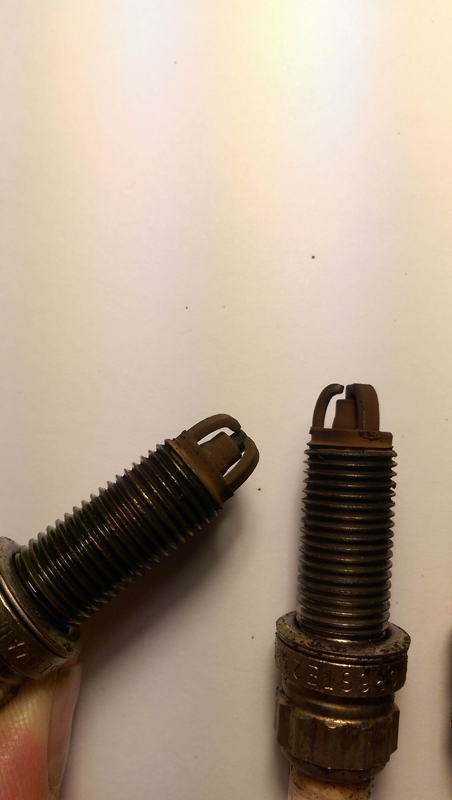

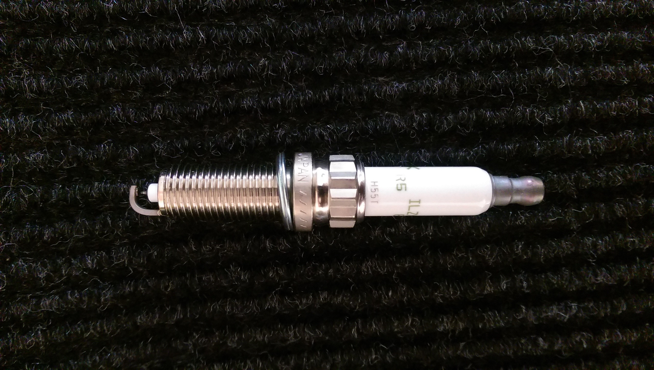

I replaced the spark plugs a week ago, the OEM bosch plugs were not coping. 6 New NGK 5992's (New part no. 95770 / ILZKBR7B8DG) were sourced from Autozone Centurion. I gapped them to 0.022" ~ 0.55mm per BMS recommendation.
Initially I got a misfire or two with the new plugs, but that quickly went away. I also did some testing with Eth mixes higher than 50%. I quickly found that my HPFP is not happy with mixes stronger than 60% Eth. On 60% exactly the car runs like a dream but I'm right on the very edge of what my HPFP will handle. I'll share a log or two later.
Some pics of the plugs old vs. new: It's very evident how much NF I've been using lately:yuck:

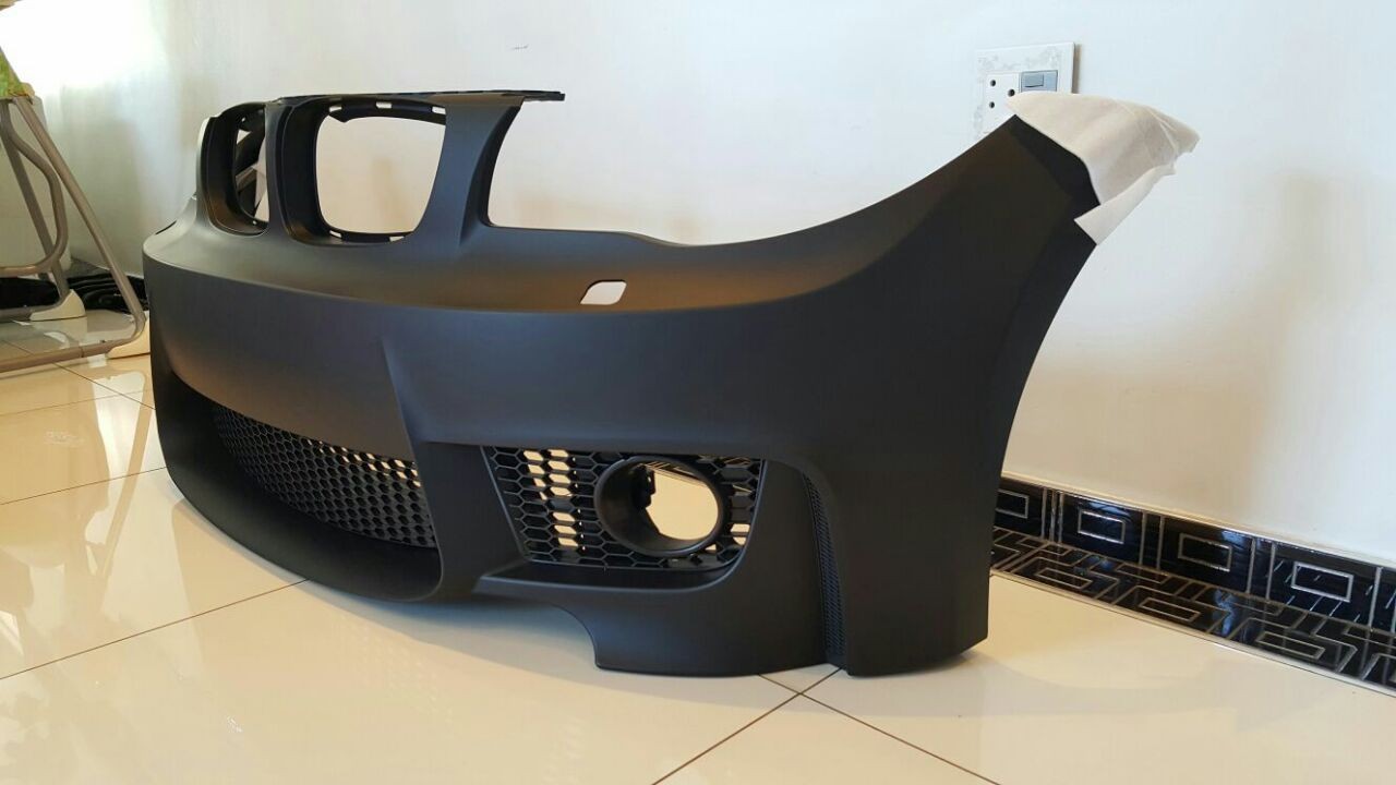

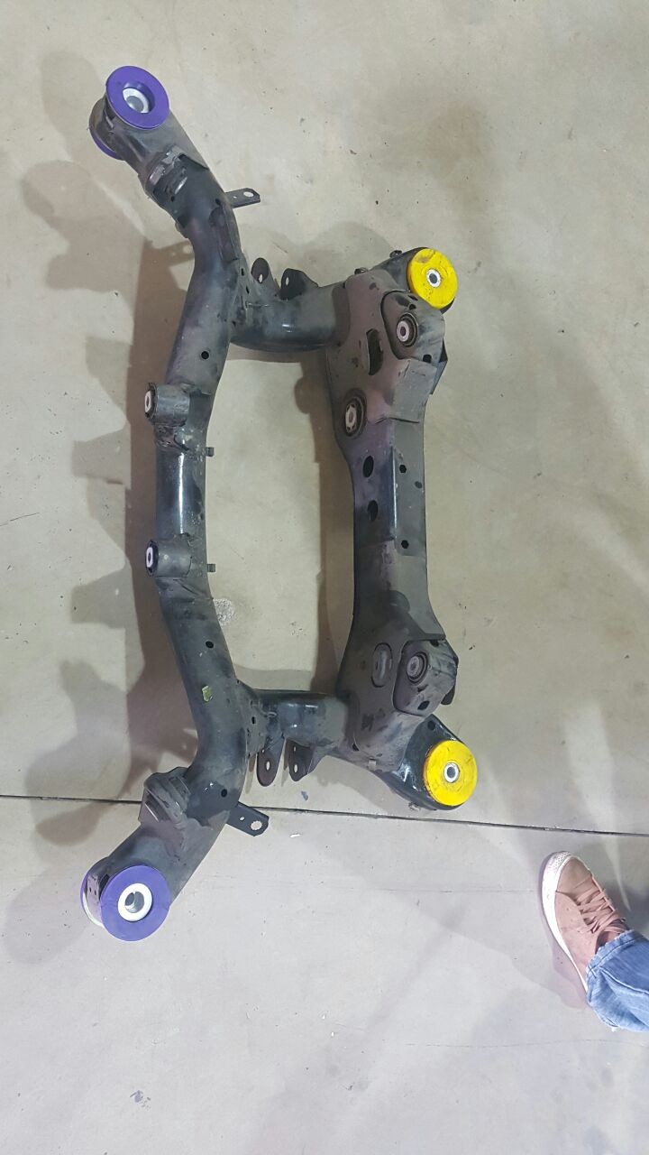

Some further mods have also been installed. Courtesy of Axis Engineering (Thanks Sean!!) a new set of Koni dampers, subframe bushes and drag bags for the rear springs. And in the aesthetics department, Courtesy of Rennzport (Thanks Firi!!) a 1M style front bumper which will hopefully fit over the giant intercooler without needing any modification.

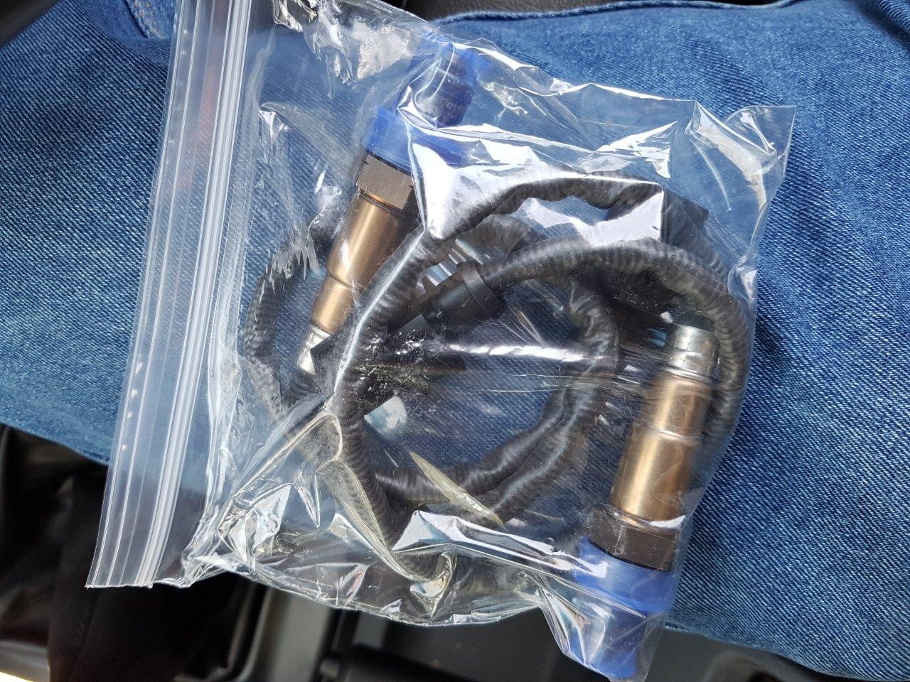

FINALLY!!! The replacement O2's arrived. Two painful months of me and S.A. Post office. I've learnt my lesson though, next time it's DHL.
I will post updates soon on whether these new units are worth the wait.

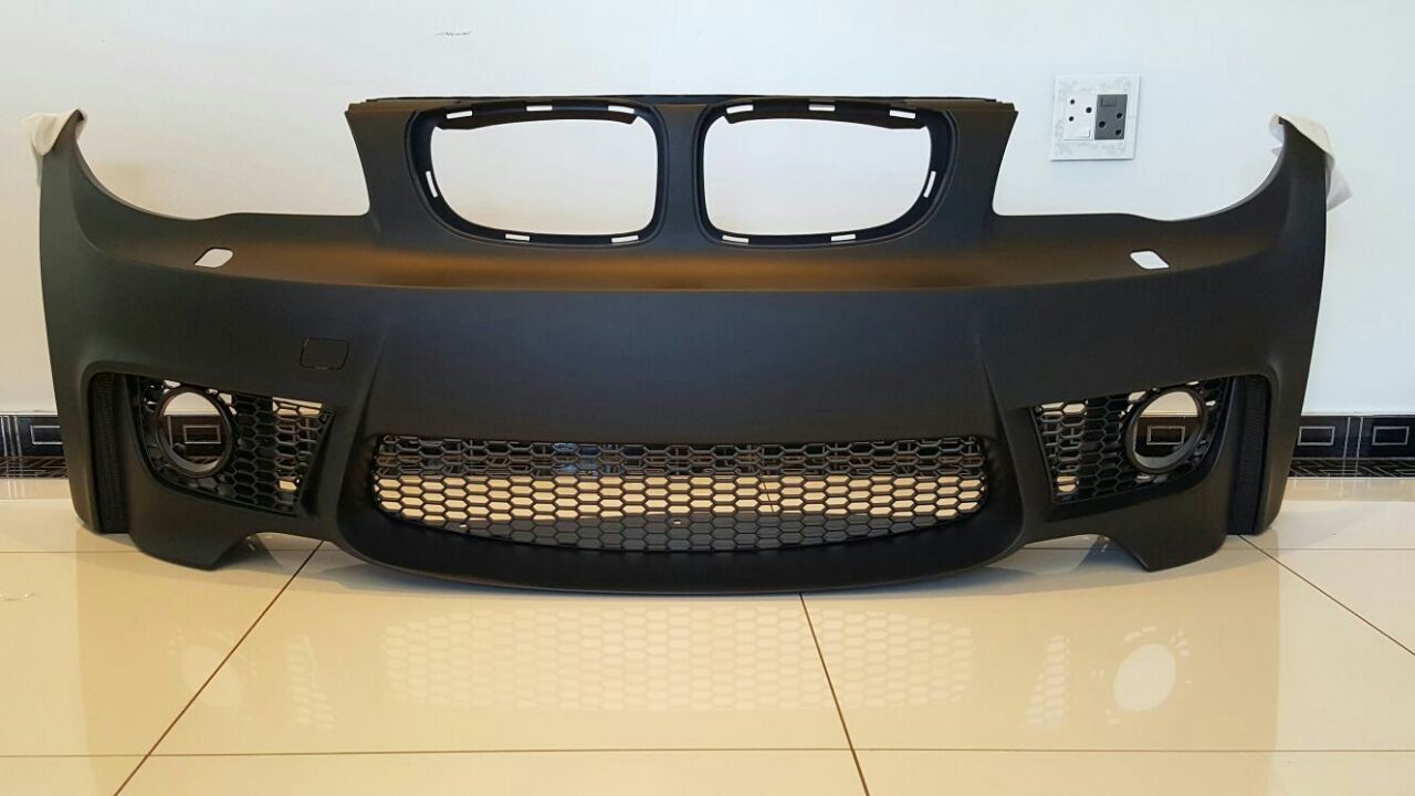

So finally the 1M bumper is on, and the front end is looking good once again. The original M-Sport bumper was looking a bit worse for wear.
I was surprised by how much space there was behind the 1M bumper, everything fit like a glove. I just need to install the last two grills in the two bottom corners. The guy who did the painting sprayed everything, even the brackets for the grilles and the little slats right on the edges. I will take the car back to him to get that sorted once she's up and running again.

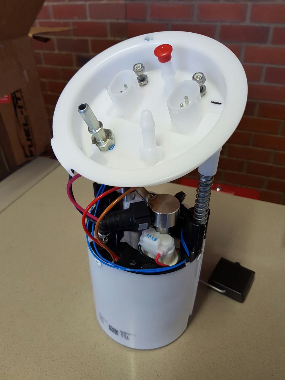

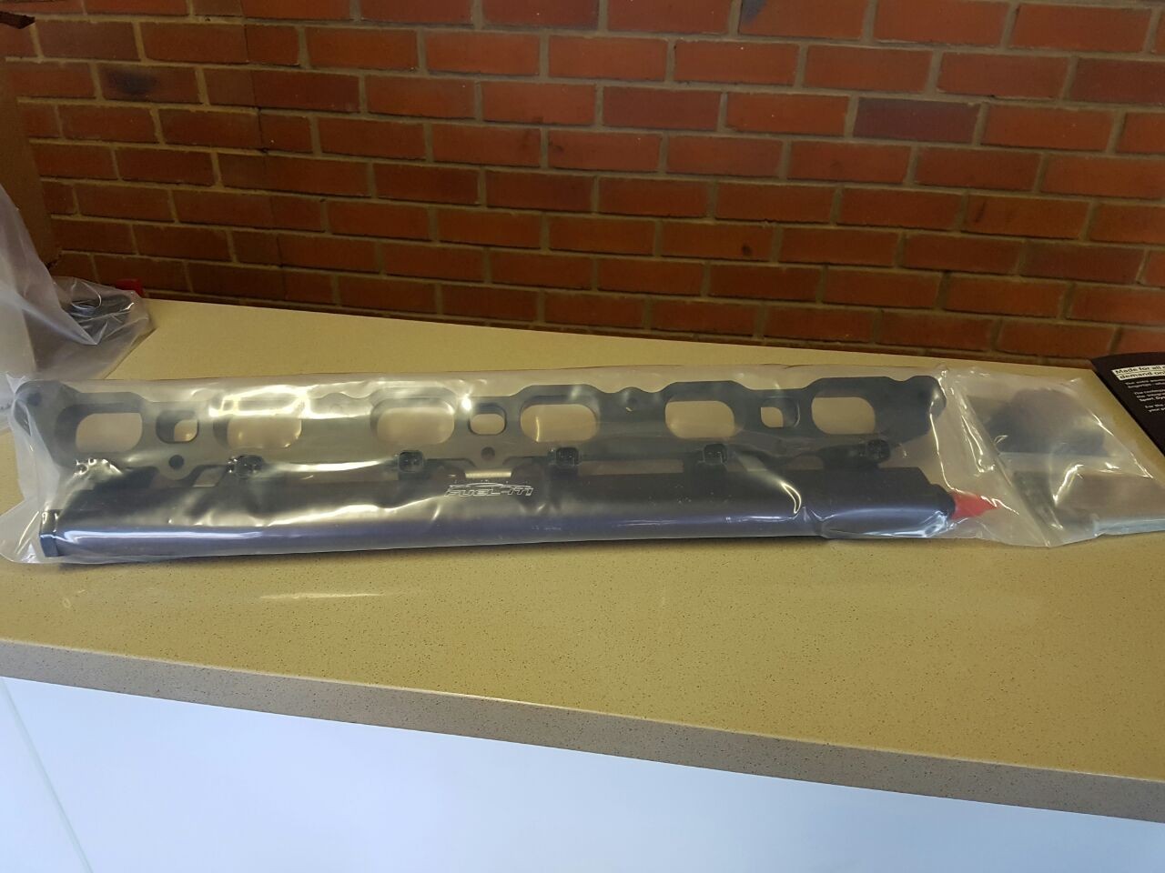

On Saturday FSalie (Thank you for the help!!) and I spent the whole day on the car installing the PI kit. I have to say we were both very impressed with the quality of the kit and how easy it was to install. Everything was fairly straight forward and we didn't hit any major snags.
Unfortunately we didn't manage to finish. One or two small things still outstanding. I have to finish up the wiring for the secondary LPFP and decide how to trigger it. Not sure if I want to go with the Hobbs switch or the JB.
I also think the charge pipe needs to be modified slightly to account for the PI spacer.
Hopefully we can sort all of this out during the week and get the car started by the weekend.:tiptoe:
