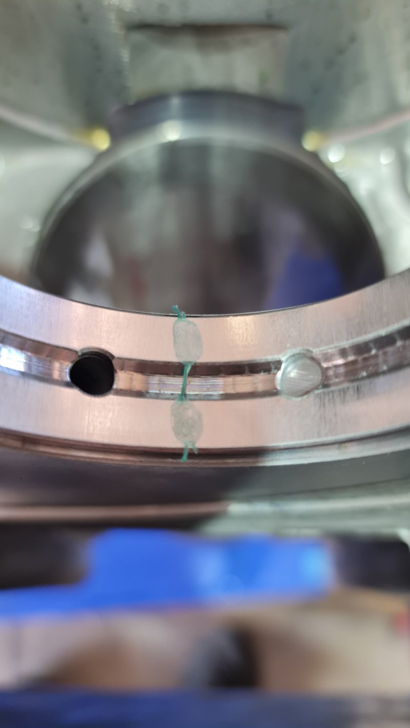

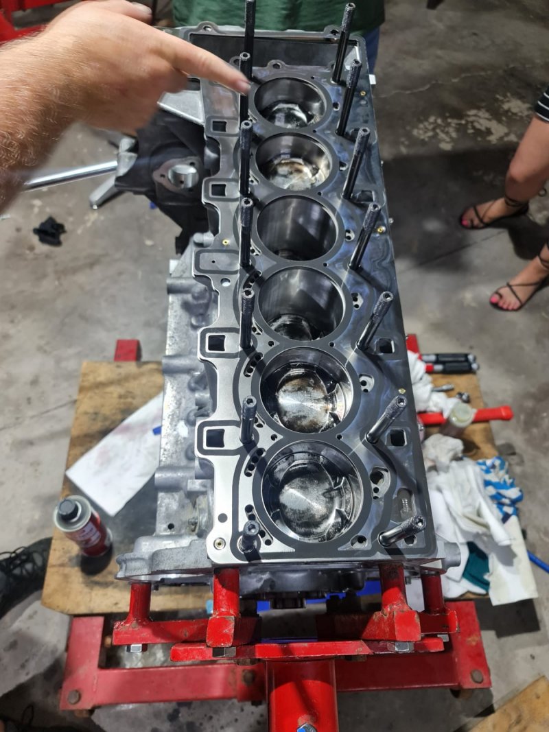

Hi, small update:

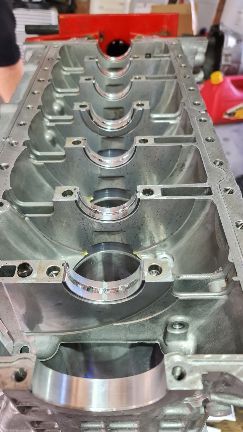

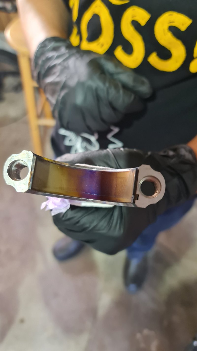

So back in January a couple of friends (Qualified mechanics and enthusiast) help me to put my motor together.

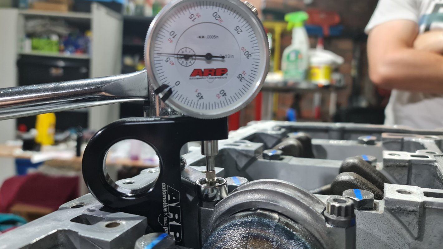

I imported a ARP Stretch gauge and a ring compressor, I bought a snap on extension for the rod bolts. we could then stretch to correct length.
This time we had all parts measured by an engineering shop and we used Plastigauge to double check (I mean we checked and checked again)
It took us two days to put the motor together, this time I used brand new Manley Rods.
Luckily I had a set of brand new rings that were gapped for the 2nd CSS Block I received as a replacement.
BMW gave me a brand new crank and I used OEM Main bearings and every other part needed besides Head studs (ARP) and Big end bearings (ACL Race bearings)
The car has done 3000km and 3 oil changes (Break in oil +120km) (Motul X-cess +- 1500km) and the car is on Motul X-cess gen 2
After initial logging on E85 we killed the clutch, I could still drive the car but could not put all the power down, I had to order a service kit from Australia through Karter performance.
The clutch required 1000km break in, that was painful.
On top of the I fitted a brand new JB4 and PI Controller, Today I upgraded the LPFP (Brand new bucket with 450 in from Precision Race works)
the car now has a 450 in the bucket and a 450 on a bracket with space for one more 450 (I have one going to test to see if it needs it)
The other major thing I did on the fueling side was to install a new filter and delete the in tank regulator, this has resulted in a 85 to 90 psi LPFP on the logs (Regulated with a AEM external boost reference regulator)
The car still needs a bit of work to finish it off but it is a monster, The turbos are in to be refreshed and try find bigger wheels then she will rock.
We had the car on E85 30 PSI 14 degree timing, Busy getting WMI to work correctly (using a external controller not a FSB)
The car will be going on sale, not because I don't want it because I am emigrating, If I don't get my price it will go with.
20220115_113929.jpg20220115_113933.jpg20220115_155843.jpg20220115_203549.jpg20220116_231920.jpgIMG-20220116-WA0007.jpegIMG-20220117-WA0011.jpgScreenshot_20220329-185440_WhatsApp.jpg

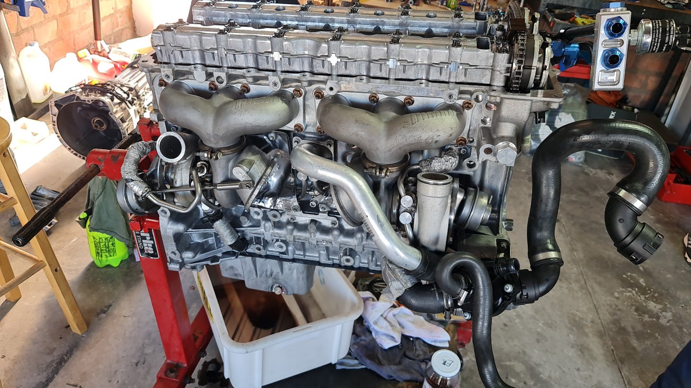

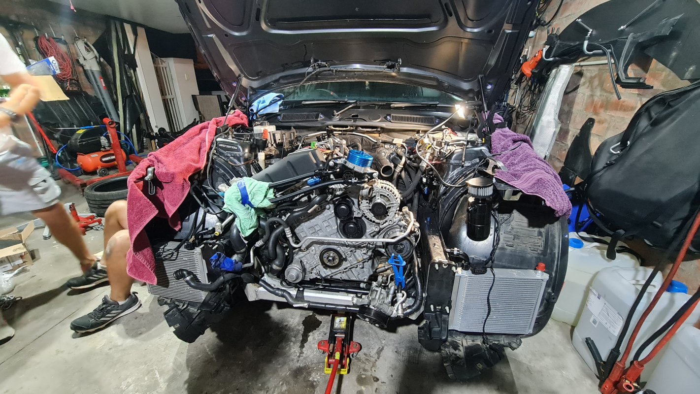

Long time,
Update:

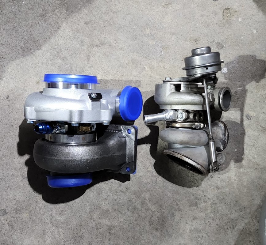

So a few months ago we had problems with car not holding boost and eventually the rear turbo let go.
It snapped the turbine shaft, and MMP would not supply parts to fix ''He recons someone in South Africa'' tried to rip him off.

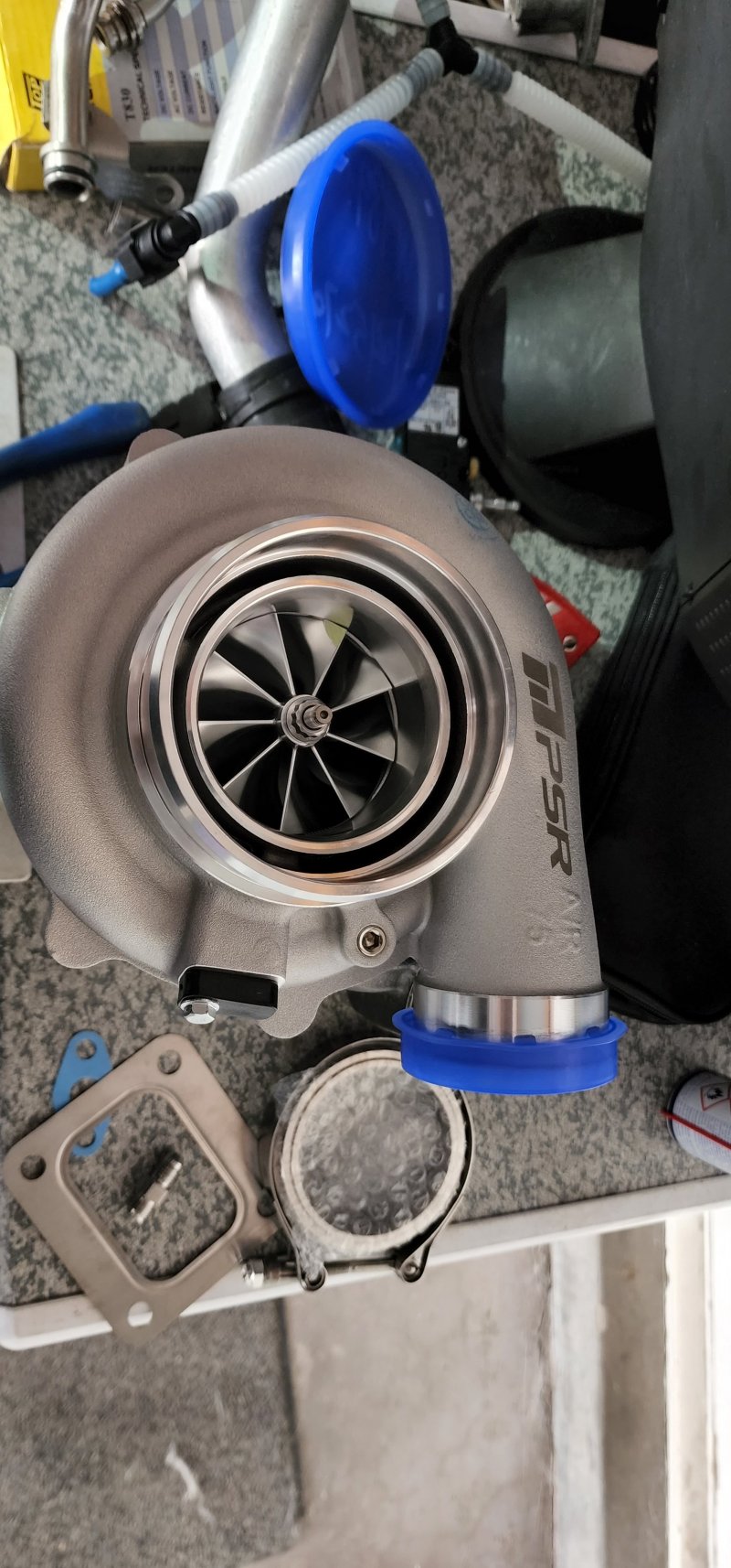

I decided to go single because it was the quickest way to get the car done, well I thought so.
I imported a Pulsar Turbo (Copy of the Garret G35-1050) from Australia, and found a butchered manifold in Cape Town that we sort of got sorted.
The reason for this was to ship the car to the UK.

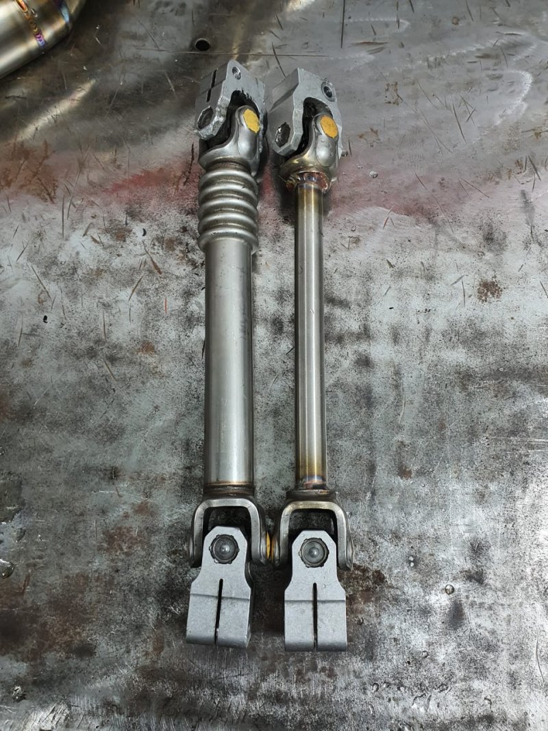

It was a mission to say the least, we ended up finishing up a day before I had to fly and it was not done to my spec, we just ran out of time.
We even modified the steering column to get a few extra mm
That said here are some pics:

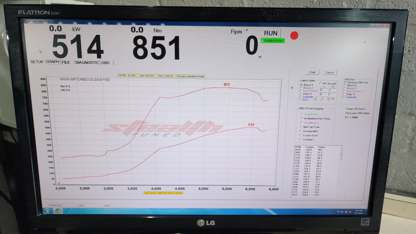

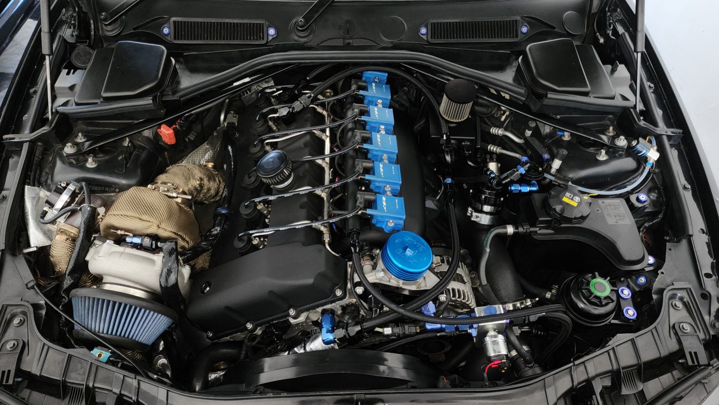

Its been a very long time since I updated
So the car is back in Cape Town (UK Trip was a Total F up)
We had to rework some stuff to get the ST working.
The screamer and down pipe were a mess and still need some work but the car runs and runs well.
I had to buy a new wastegate, I got a turbo smart the ones that came with the turbo were junk.
At the same time I did some more work on the engine bay and catch can setup.
All wiring except the injector harness has been moved to the intake side of the motor, I did this for two reasons, heat and it just looks so much better.
On the catch can side I found the car runs better without the vacuum side attached and if everything vent to atmosphere but these motors breath a fair amount so I have made it that it can be connected/disconnected quickly.
We ran the car on a Pump file with E18 and WMI 1000cc (Our fuel is so kak)
514kw on the wheels and 851 NM, I believe with a better downpipe we should get another 15 to 20kw.
I am not sure if I will do a Ethanol tune, the car is wild as it is but time will tell, the car is going on sale and I will pay my tuner to do an E85 tune if the new owner wants one
Since the Dyno we adjusted the Meth to come in sooner to prevent the drop off at 4100rpm
This was at 25psi
Driving around town and in traffic the car is so easy to drive, I was surprised actually.
some pics:
