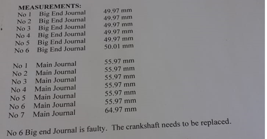

So below are the sizes of crank journals measured by an engineering company appointed by the BMW dealer in CPT
I believe the following:
BMW SA should replace crank, it is clear that big end number 6 is out of spec (Too Big)
BMW SA should then claim against manufacturer of the crank.
The rest of the repairs and parts is on the Builder (Gaskets, Bolts, Seals, Rods and labor) it was most probably and combination of the incorrect torque and oversized journal that caused the failure
This is the first thing any engine builder should do, measure all journals and check clearances "Dry Assembly"
Please give me your thoughts and what you would do in this situation with BMW and engine builder
