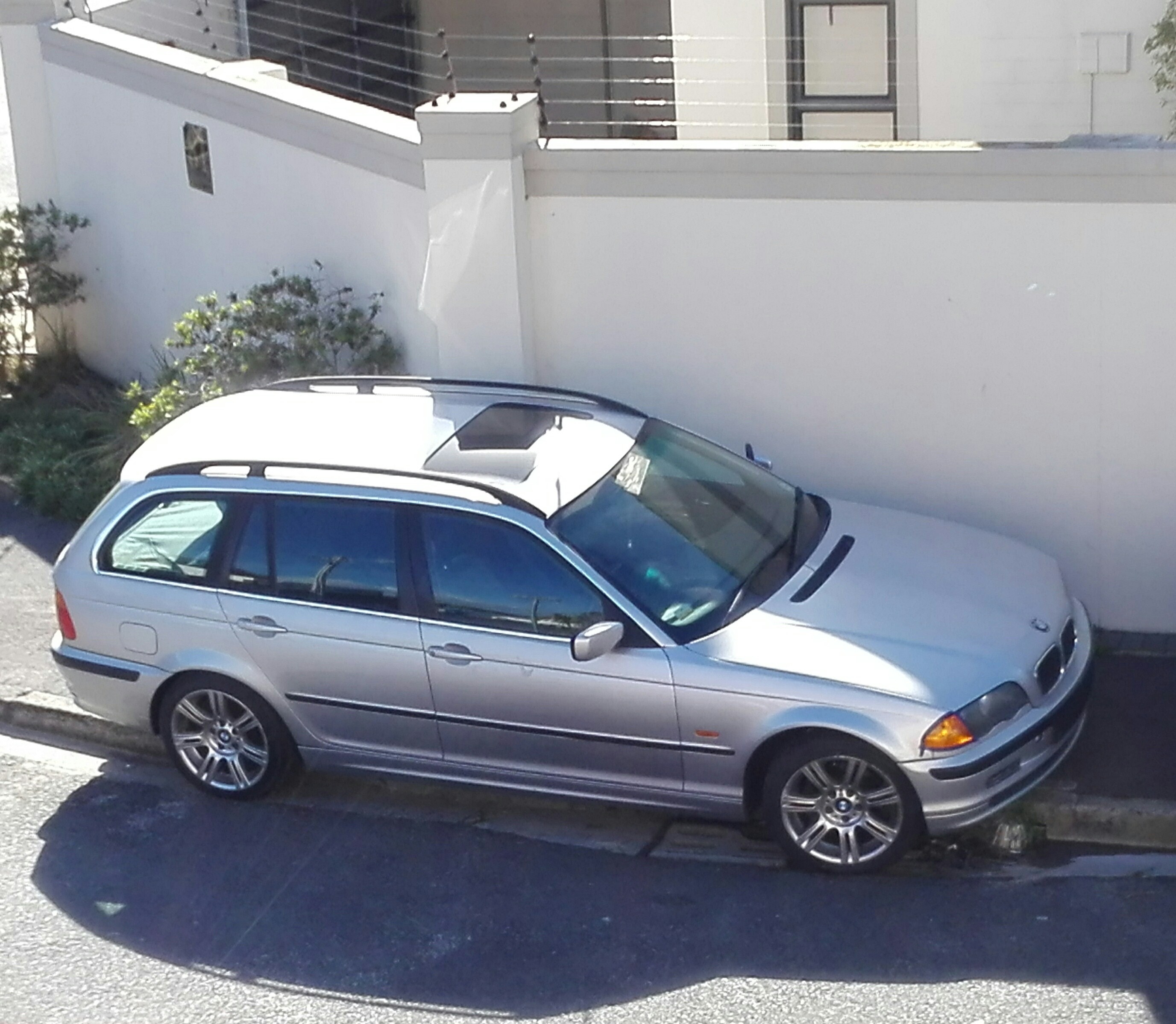

11-08-2017, 09:37 AM (This post was last modified: 11-08-2017 09:44 AM by evnmopwr.)
Post: #20
RE: Project E46 325i Touring
So the car is Mobile...
Has some Drivability issues when idle so been Looking into that for that Past few weeks but its daily driven..
Issue:
At idle, Low revs of about 650-700 RPM, The Car will ping Between 1000 - 3000rpm but still has all the power
when the Idle decides to correct itself to about 800-900rpm, There is No Ping, But car is lazy as hell!!!
nothing on the ECU but Misfire codes on 1, 4 and 6cyl.
It only Misfires when idled for like 5min.
Revs are bouncy, Plugs are Carbon fowled and Smells of fuel
Thinking maybe the Airflow meter??
I put a hold on the rest of the Cosmetic work for now to focus on the driving issue but have few tests planned for this weekend and see if i can narrow it down
this is what she looks like currently
[Image: img_20170627_133337_4721652138.jpg]
Also have a Set of Coilovers on order, Def needs some Low...
Ordered this off Aliexpress, hopefully it fits neatly, Attaches to the Original bumper
[Image: for-1999-2000-2001-font-b-bmw-b-font-fon...022848.jpg]
Will Attache some Interior Shots once i get the car cleaned And will Magnify the rest of the Cosmetic's that needs attention
Thanks for all the kind words
