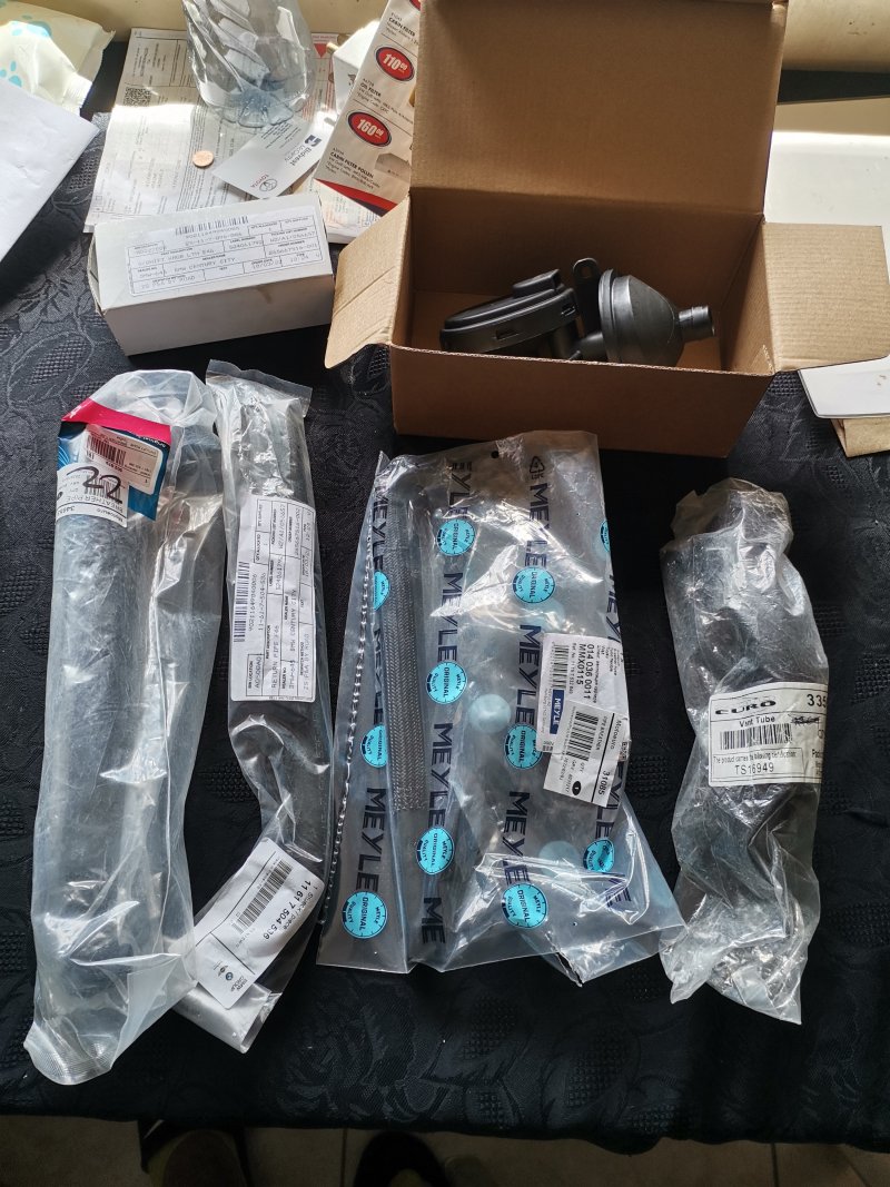

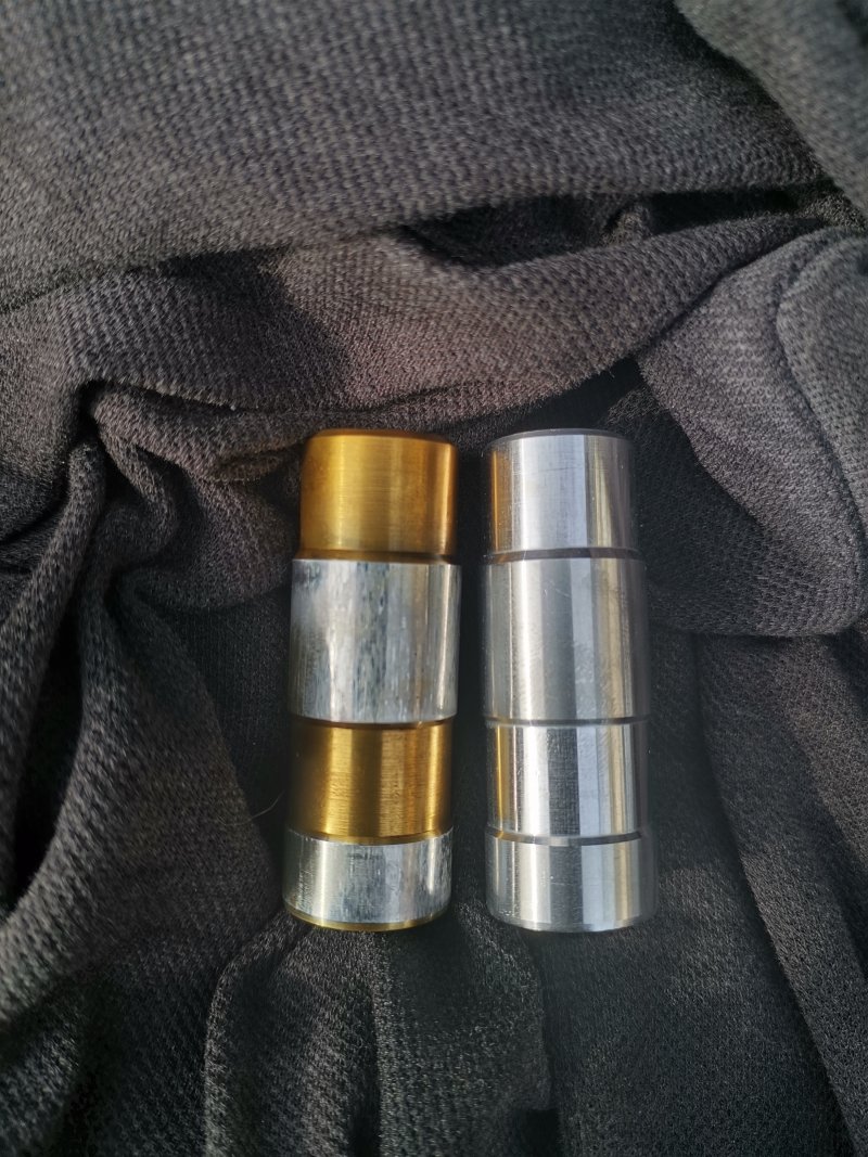

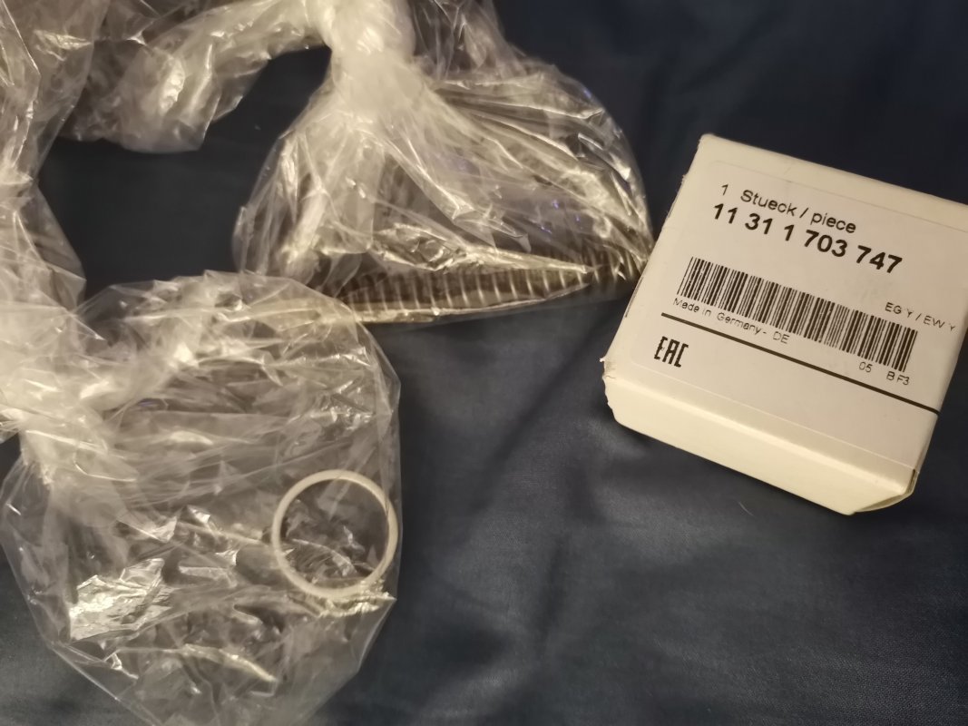

So first parts Received last week and replaced before i went on holiday.

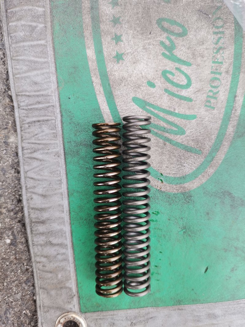

Removed the Tensioner and Compared the Springs and 1 coil shorter than the new one
replaced the Cylinder while i was at it (OldvsNEW):
I was so happy when i went for test drive and Ticking noise was GONE when decelerating.
