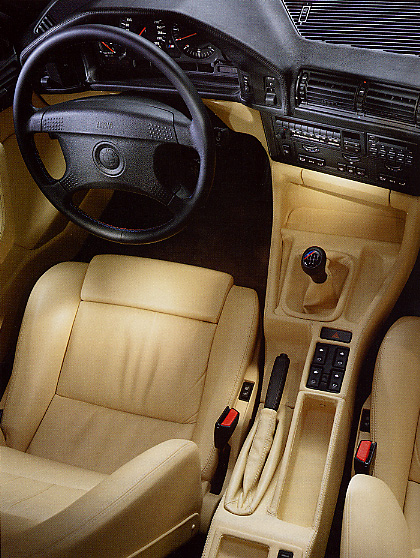

How I wish I could re dye my interior and add the M5 gearshift surround while I'm at it :drool: :drool:
I am so damn tempted to recover my interior in that caramel colour!
Not sure if it would work with the white exterior?
Sankekur
Don't, A light interior does not go so well with a light exterior, if the exterior I would have said go for it..........
Aaaand you have a white M5 with a black interior what more could you want? I think you are just looking for things to do on the car now that everything is pretty much sorted :rollsmile:
