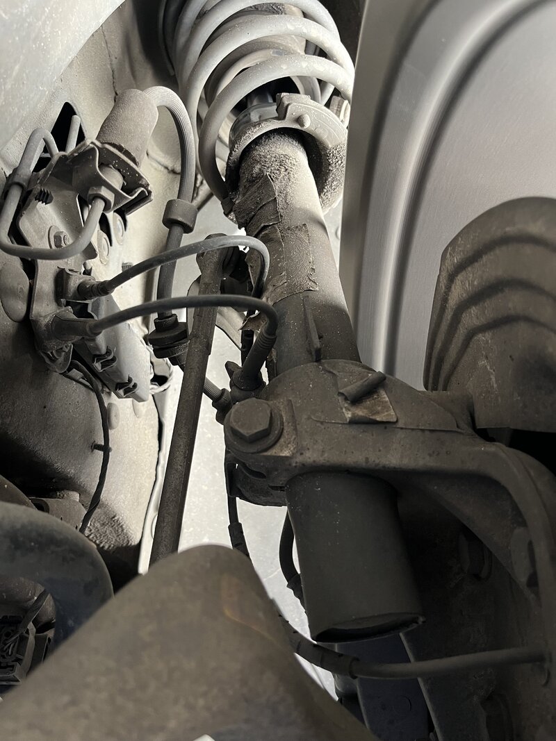

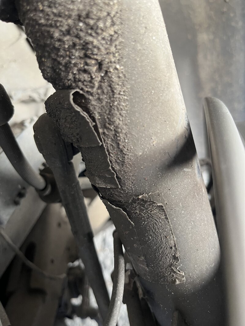

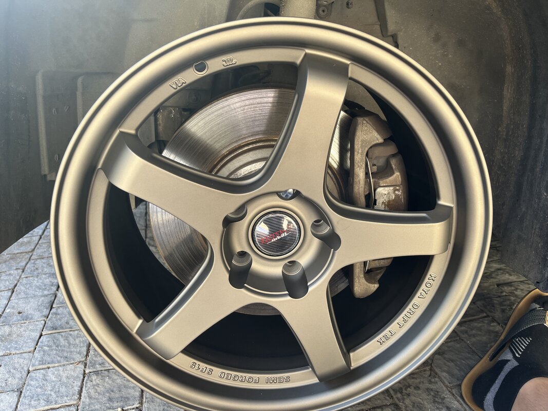

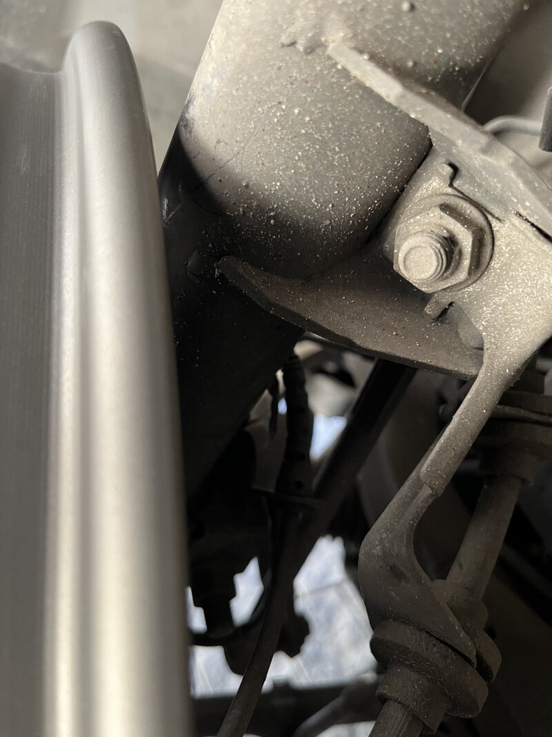

Did a test fit on the fronts today.
With the 9j et35, there is around 6mm clearance between the wheel and strut/shock. so with a 255 35 front tyre, it's going to be tight. If you look in the pics though, where the tyre sidewall would be, the shock angles away, going upwards, and a 255 should be pretty squared (neither stretched nor bulged) with the wheel.
I am thinking of using a 3-4mm spacer just to make sure I have ample room.
Also,I wouldn't want any bigger of a spacer as your amount of hub center you have going into the wheel center bore, would provide too little purchase for the wheel to sit on.
There is around 12mm of hub for your wheel center to sit on, and the Koya wheels have a 3mm+- chamfer/bevel, the add the 3-4mm spacer, this would leave 5-6mm of hub for the wheel.
I will probably order hub extenders down the line for the front.

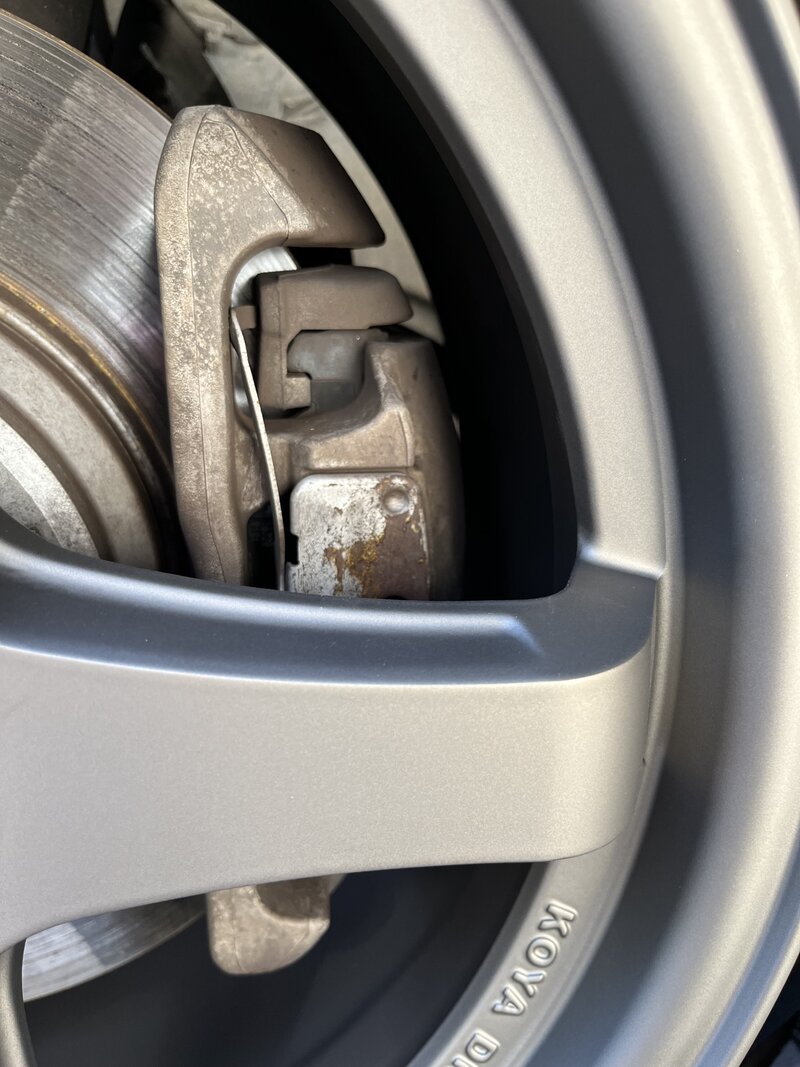

Also, I was checking the front brake caliper clearance, to guesstimate fitment of F30 4 pot Brembo's and 370mm disks, and it looks like there may just be enough clearance going from the 348mm disks and single pot to the F30 brakes. 11mm more disk and similar size caliper....
Anyway, that is my findings, hopefully it will all be fitted up soon with temporary spacers while I wait for the actual spacers to be made.
Super excited to get these on....

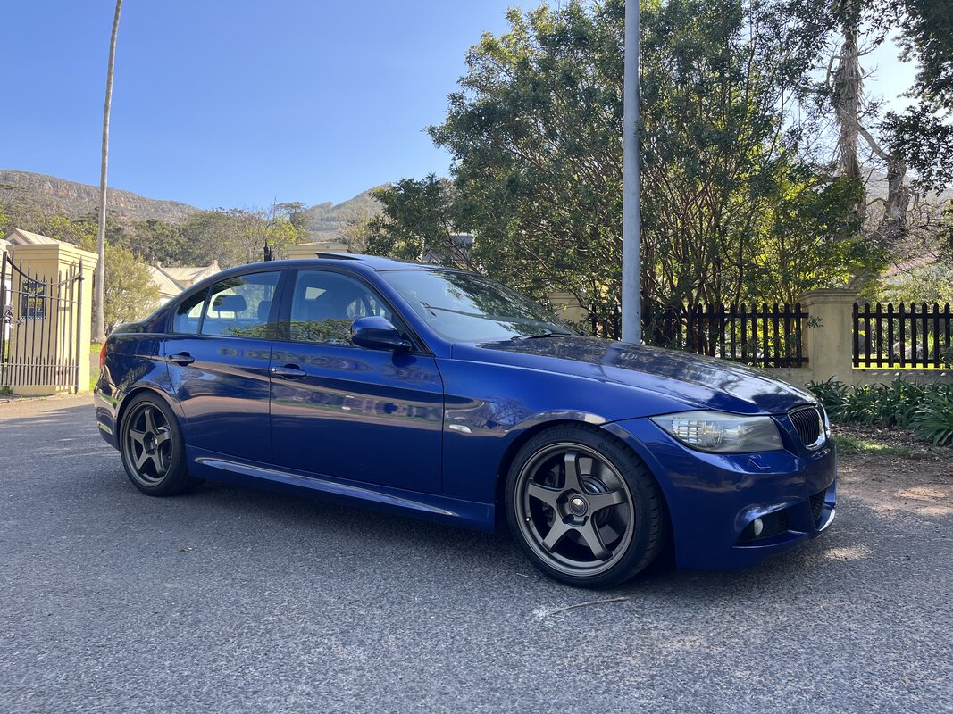

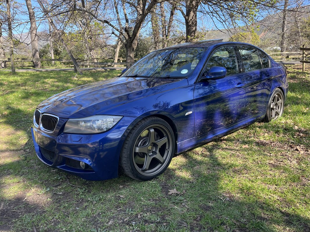

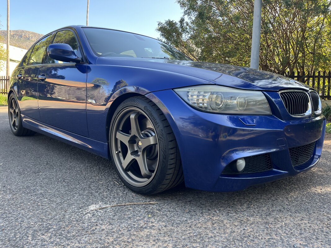

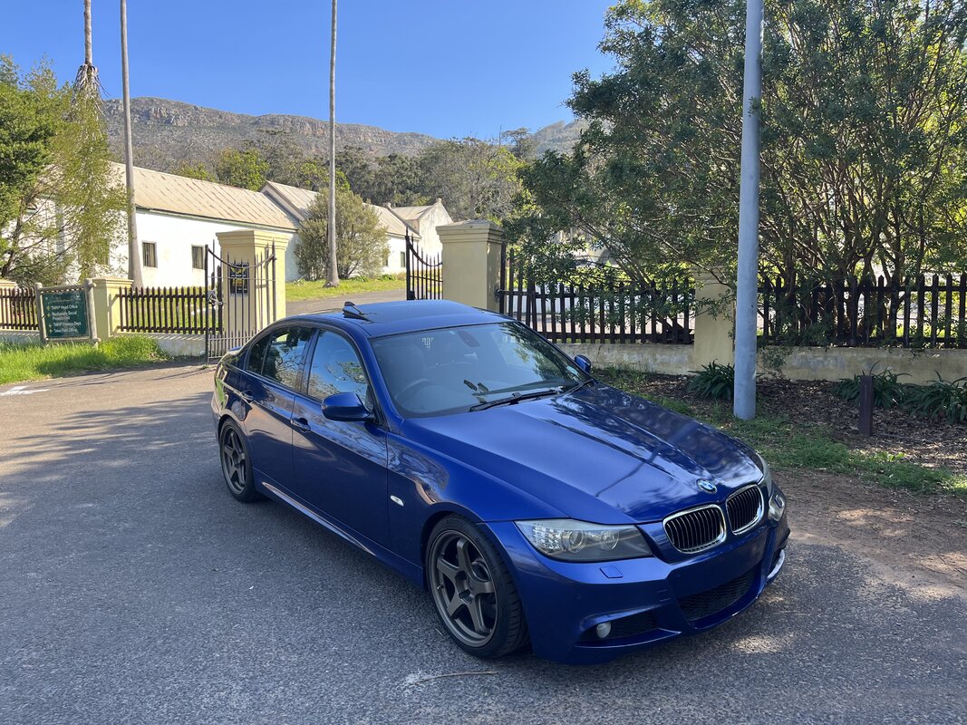

Diesel
Congrats. Looks great
Check your fender indicators. They have been swapped left to right and fitted upside down.
