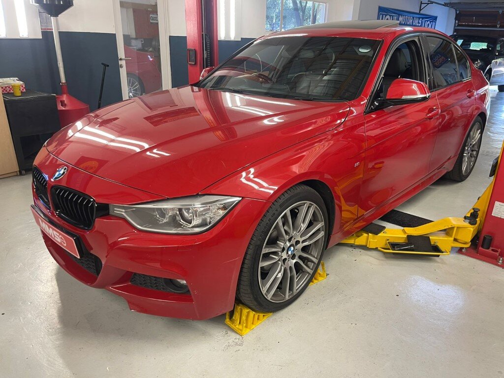

I was in the market for an F30 320d — something to run around in, preferably with a bit more mileage on it so that I could document the experience of owning a higher-mileage diesel BMW: what to look out for, what eventually needs attention, what these cars are really like beyond 200,000 km and, at some point, the infamous N47 timing-chain replacement.
Anyway, long story short...
I logged onto the forum the other day for the first time in a while and came across @lebofa 's For Sale thread. Then I realised the thread was about six years old. 😂
Since I know him and he literally lives three streets away from me, I figured I’d drop him a message and see what had happened with the sale.
We arranged for me to quickly come and have a look at the car — not inspect it, just spend a few minutes looking at it in his garage.
He mentioned that he had owned it from new, had done oil services every 10,000 km, and had maintained it properly throughout its life.
Being a 2014 model, I certainly wasn’t expecting to find a “like new” example. What I found instead was a good, honest car.
It isn’t perfect, but it is in far better condition than probably 90% of the used cars I come across.
We agreed on a price, I paid the deposit that evening, settled the balance the following day, and arranged to collect it on Friday morning at 08:30.
Since he lives so close, I literally walked to his house and drove the car back home. 😂
Then my wife saw it... And apparently it is now her run-around because the Fortuner has suddenly become “too big to park at work”. 😂
Either way, the goal remains the same: get the car as close to 100% mechanically perfect as possible and use it.

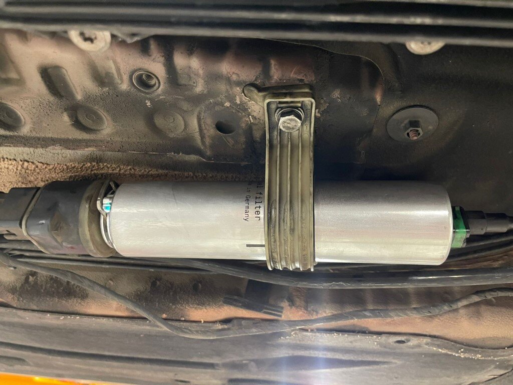

At some point during the day I was ordering parts for another vehicle, so I decided to add a few service items for the 320d to the order.
I ended up with:
• 3 × oil filters

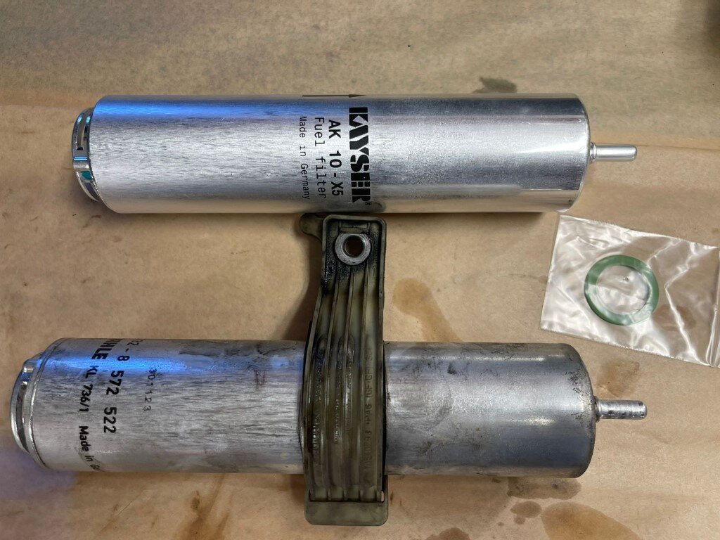

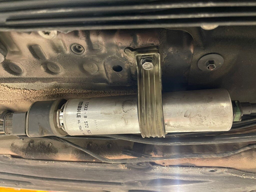

• Fuel filter
• Cabin air filter
• Engine air filter

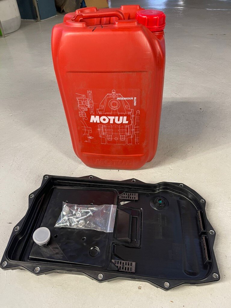

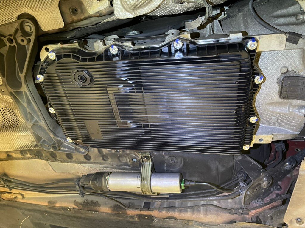

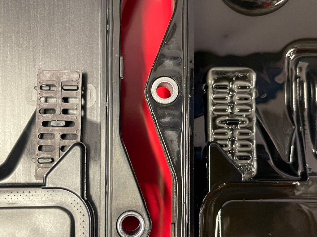

• New ZF 8HP oil sump/filter kit

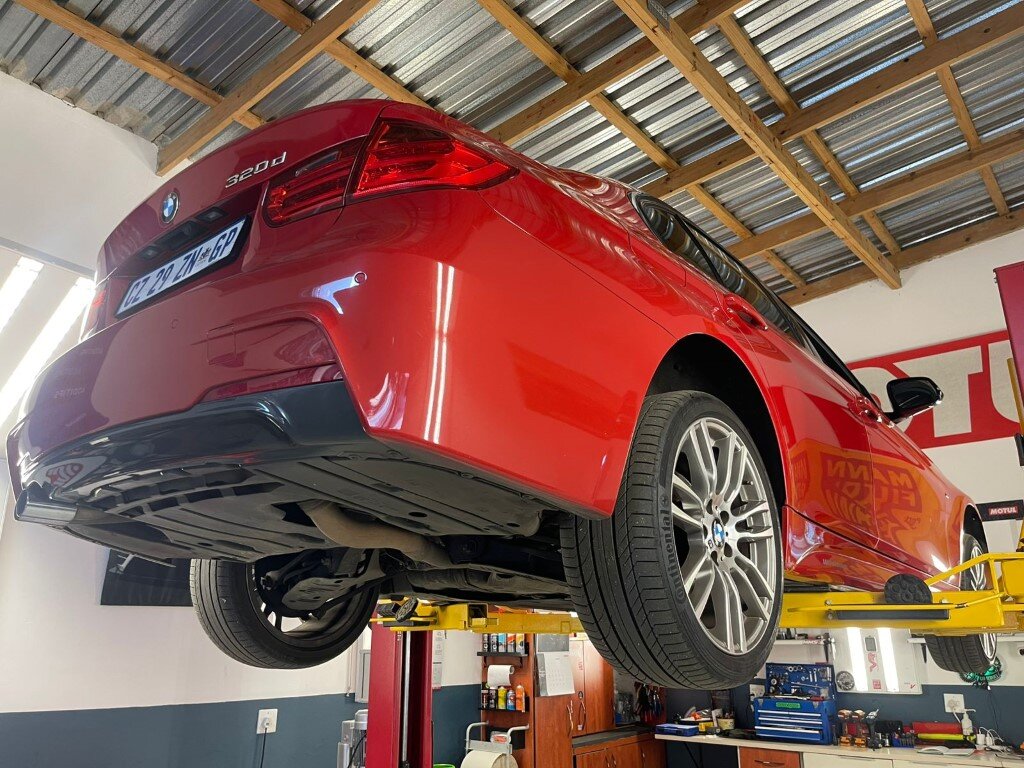

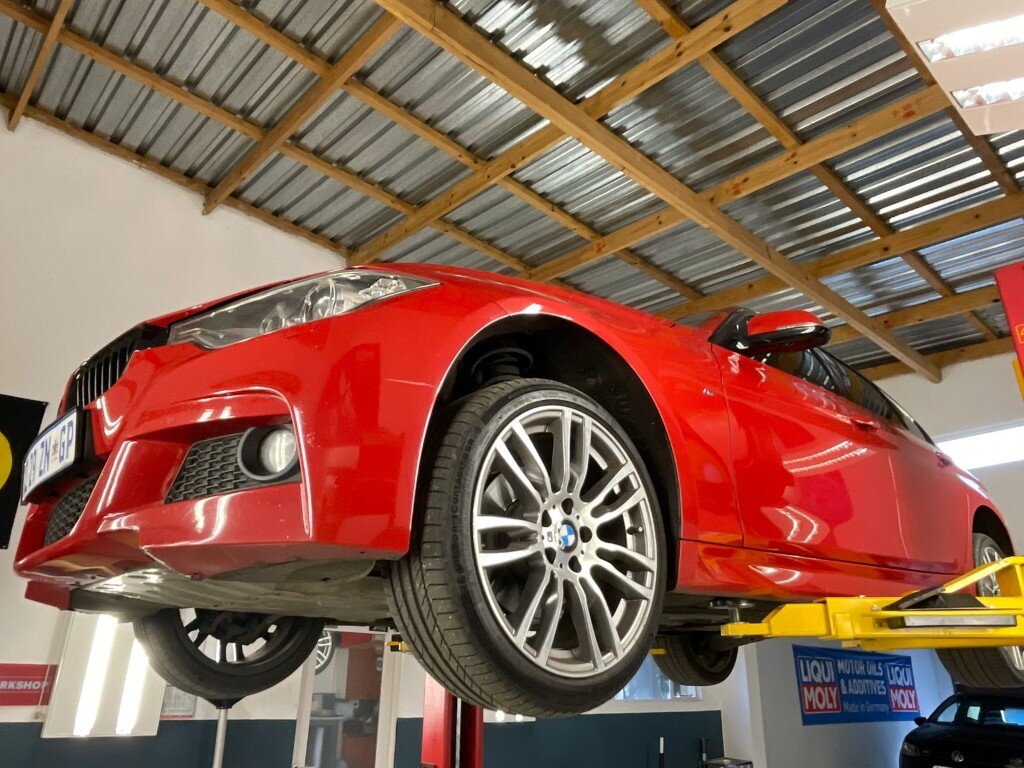

After completing the day’s work and bookings, I moved the 320d into the workshop and put it onto the lift.

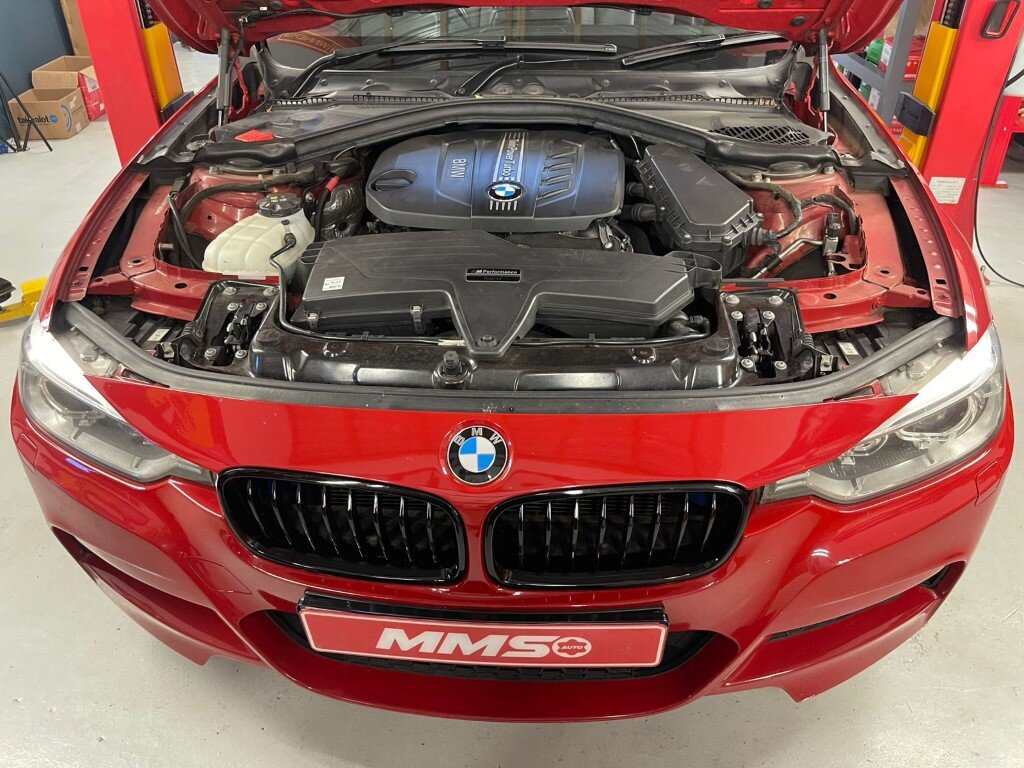

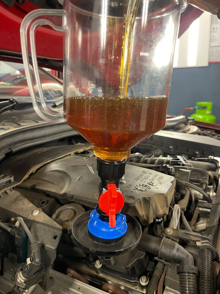

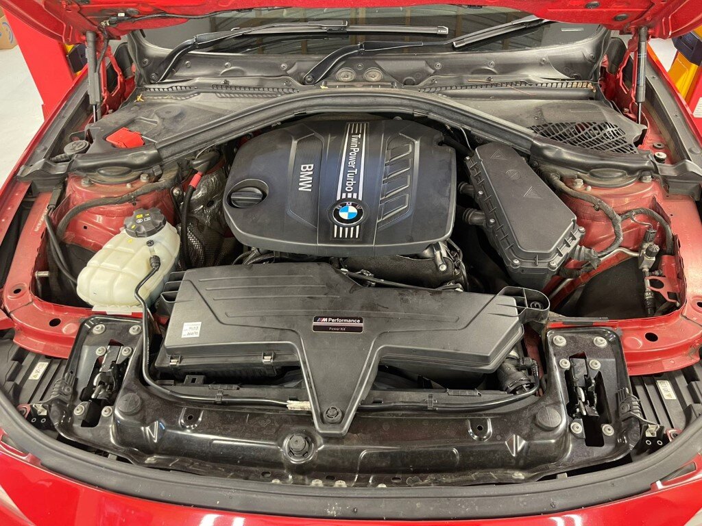

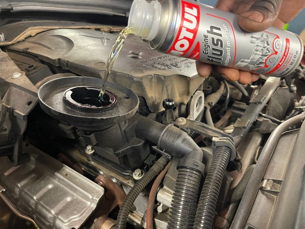

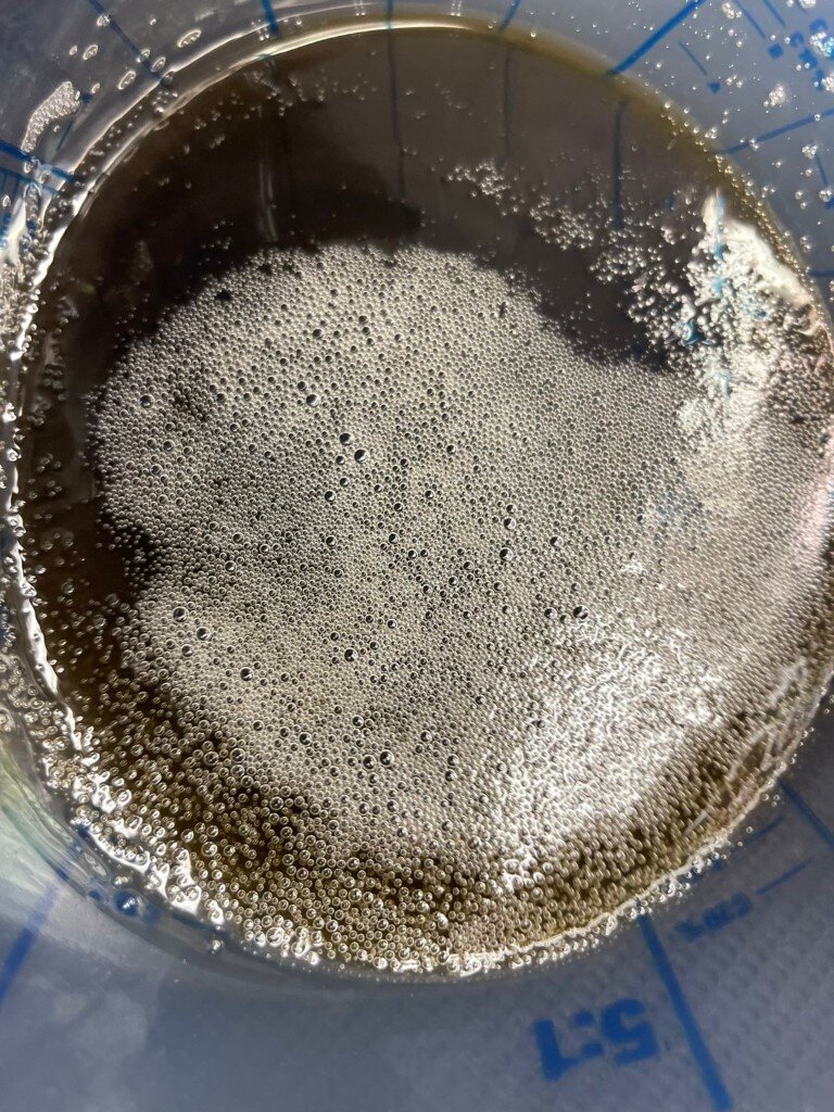

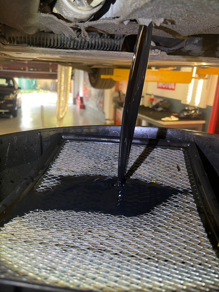

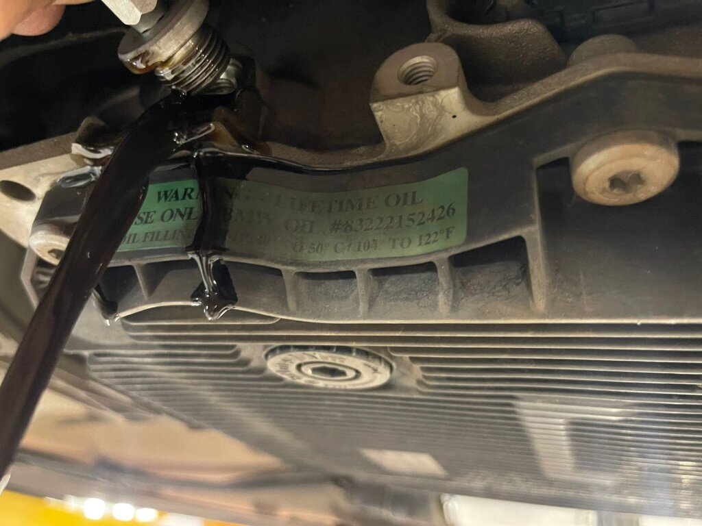

• Added Motul Engine Clean/Flush and allowed it to circulate before draining the old engine oil

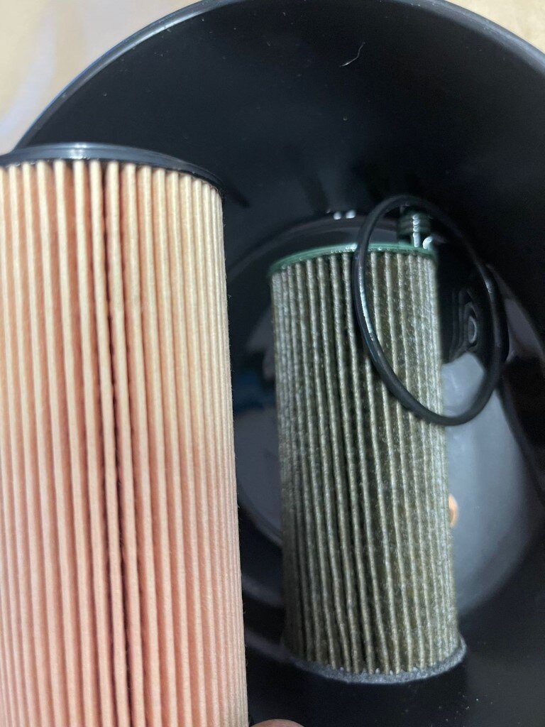

• Removed the oil filter, cleaned the housing and installed a new MANN oil filter and O-ring
• Installed the drain plug with a new crush washer

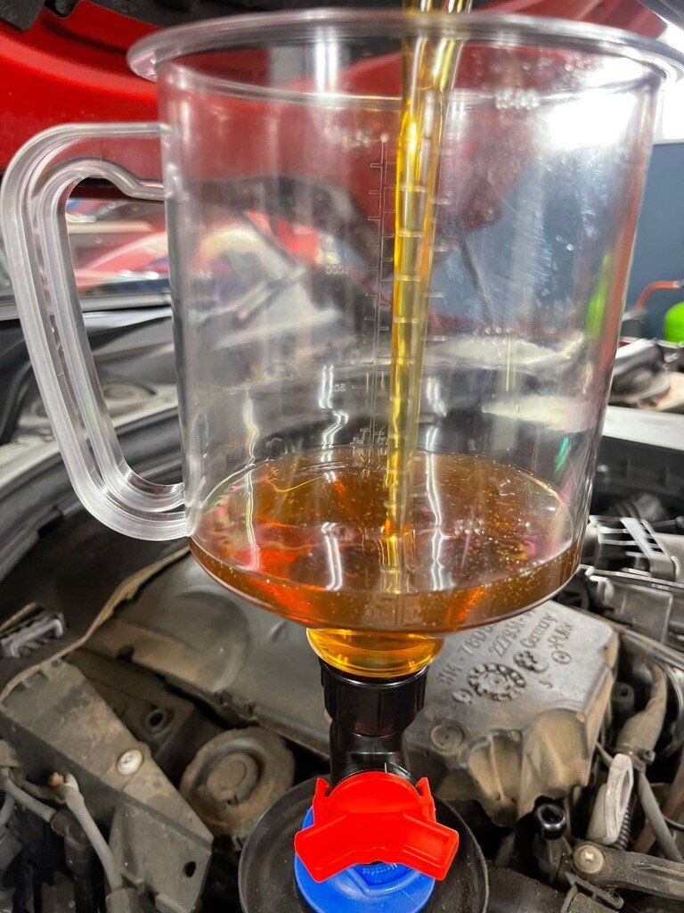

• Filled the engine with approximately 5.2 litres of Liqui Moly 5W-30

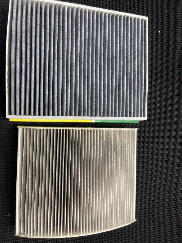

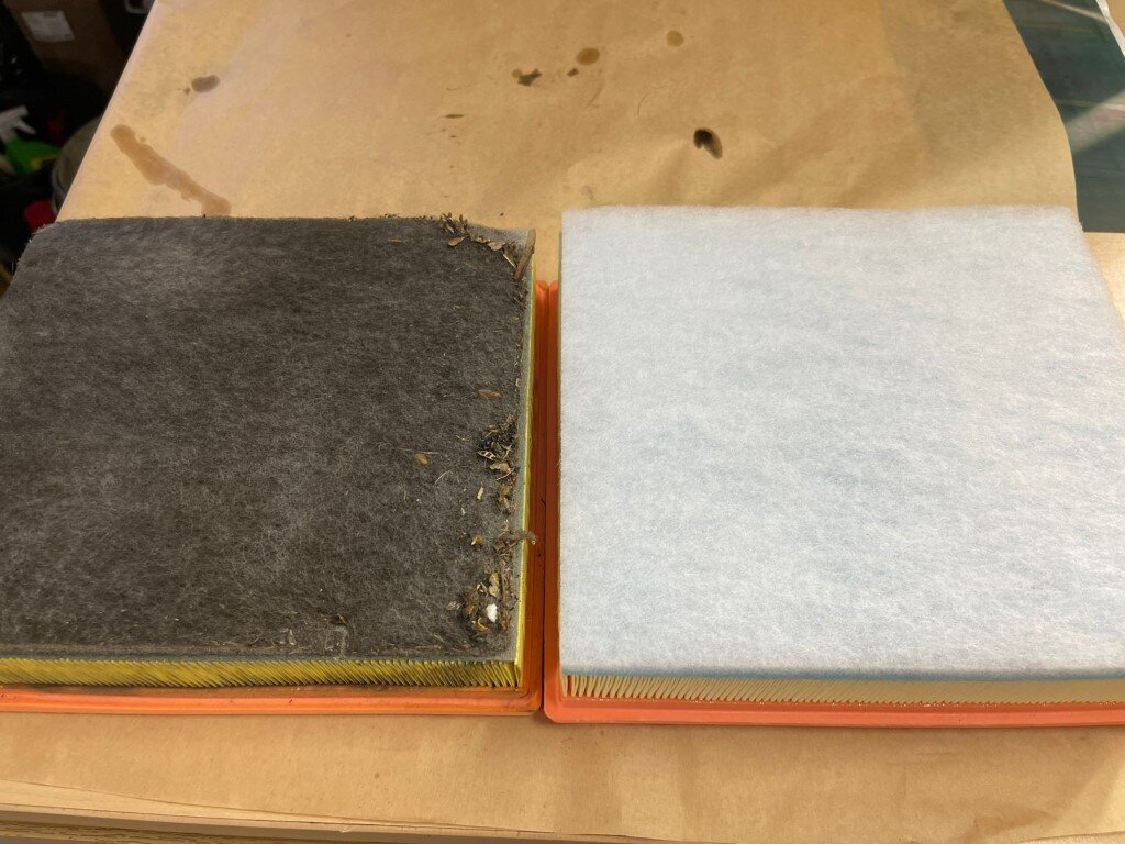

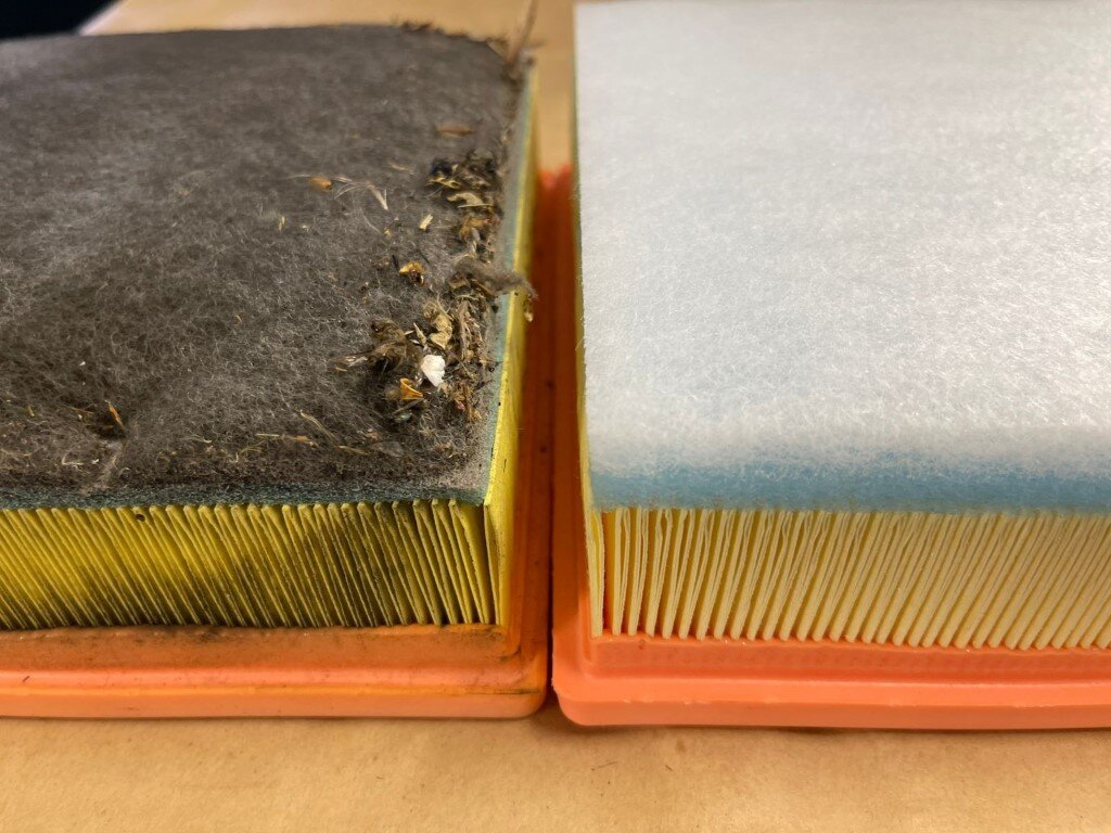

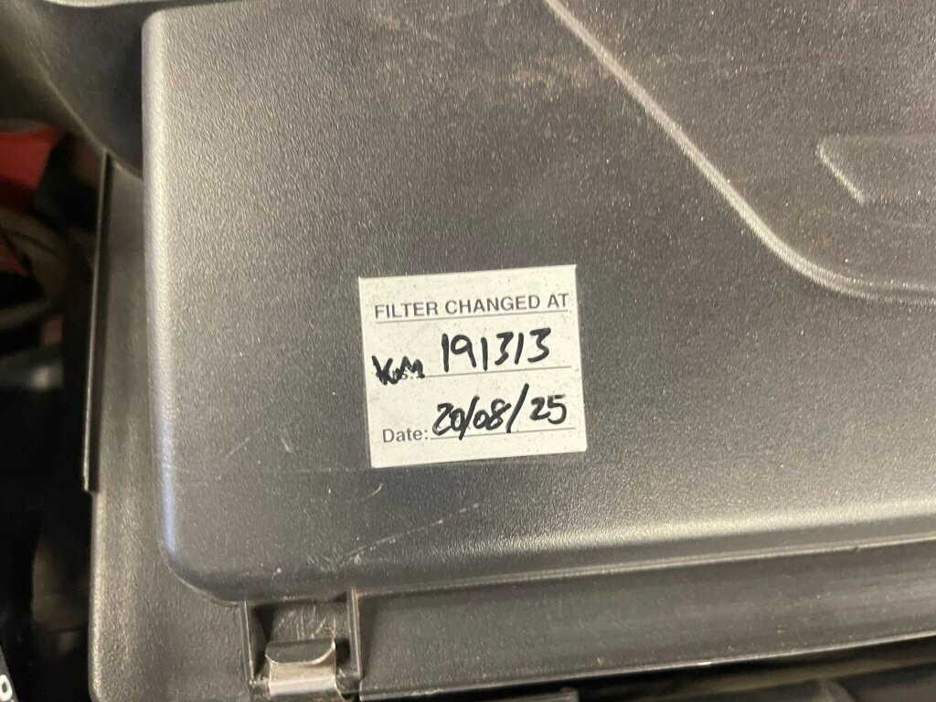

• The engine air filter had last been replaced in October last year, roughly 10,000 km ago, so that was replaced again
• Removed the old cabin/pollen filter and installed a new activated-carbon cabin filter

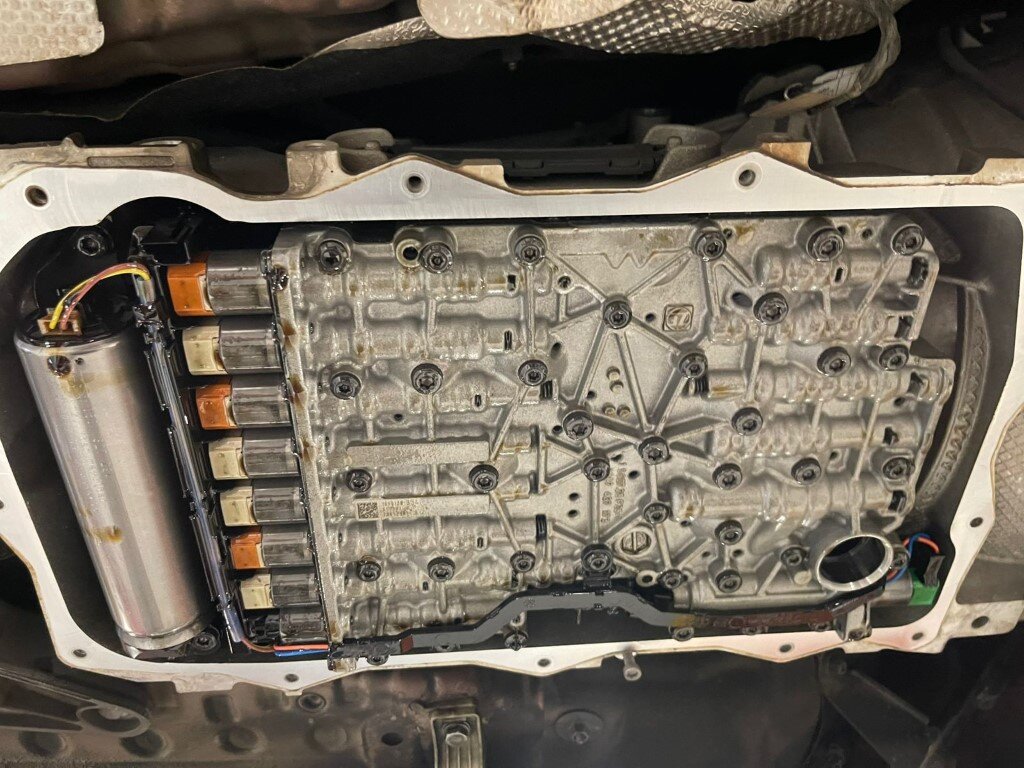

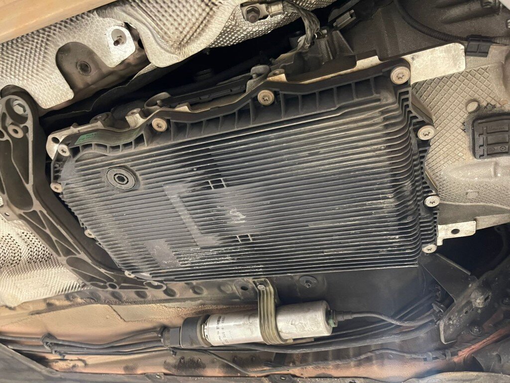

• Ran diagnostics on the EGS/transmission control unit and checked the transmission data to determine whether the gearbox can be safely serviced

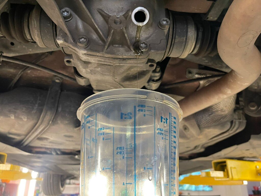

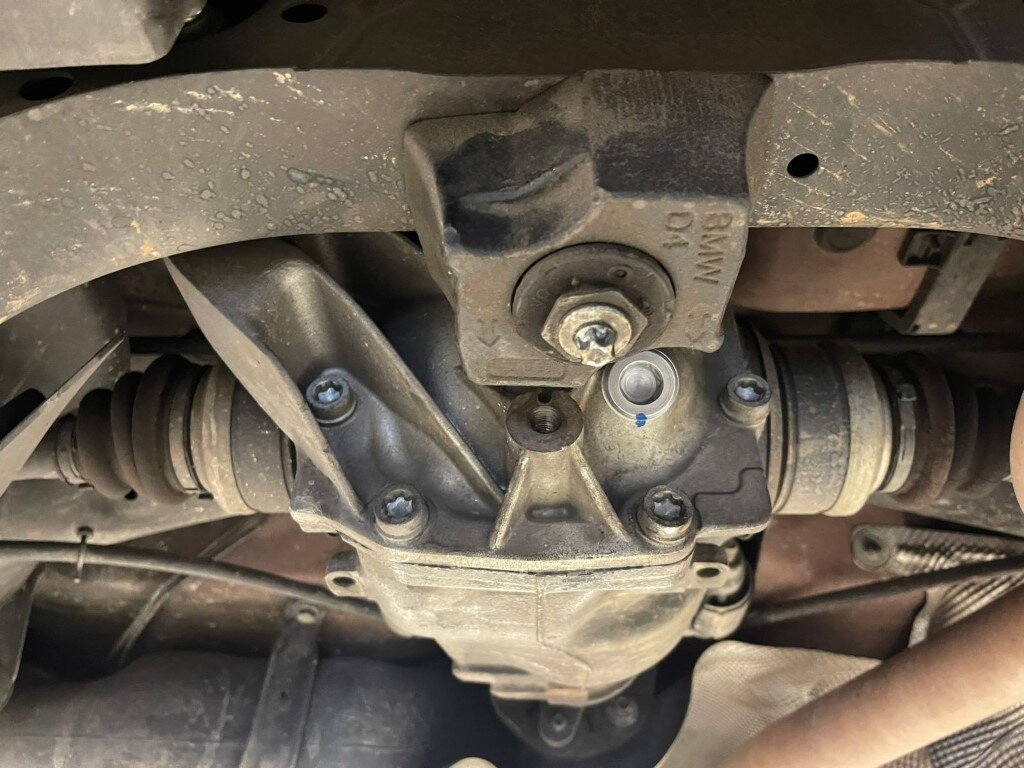

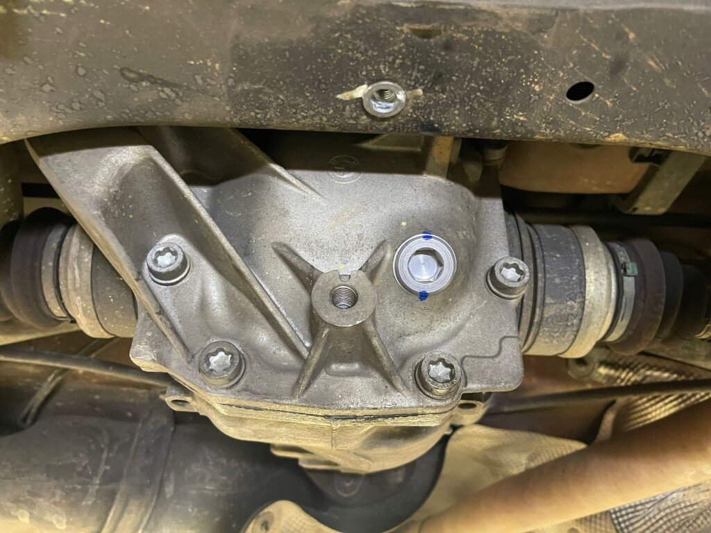

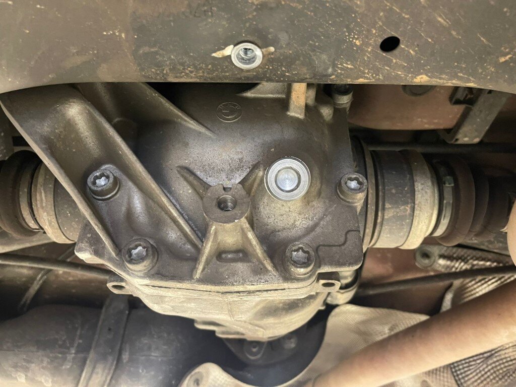

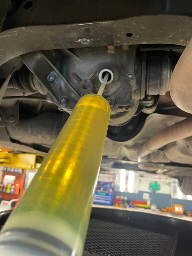

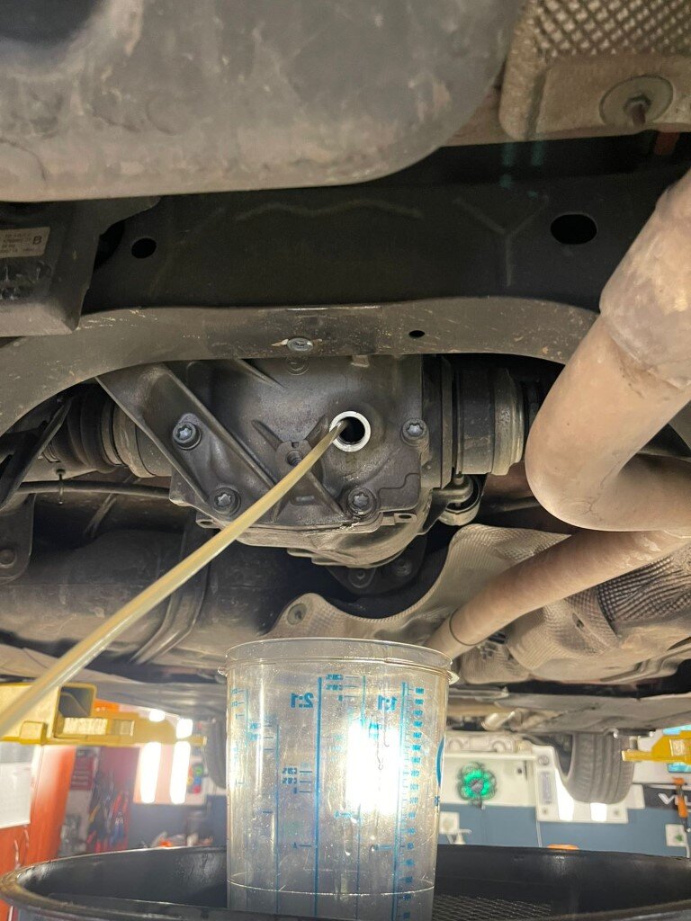

• Drained the rear differential oil, which had apparently been replaced last year, and refilled it with Motul Gear oil

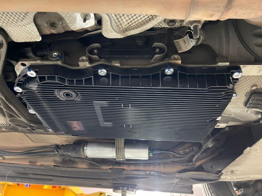

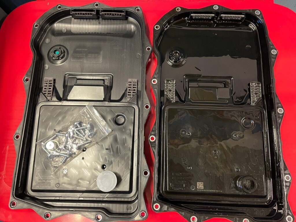

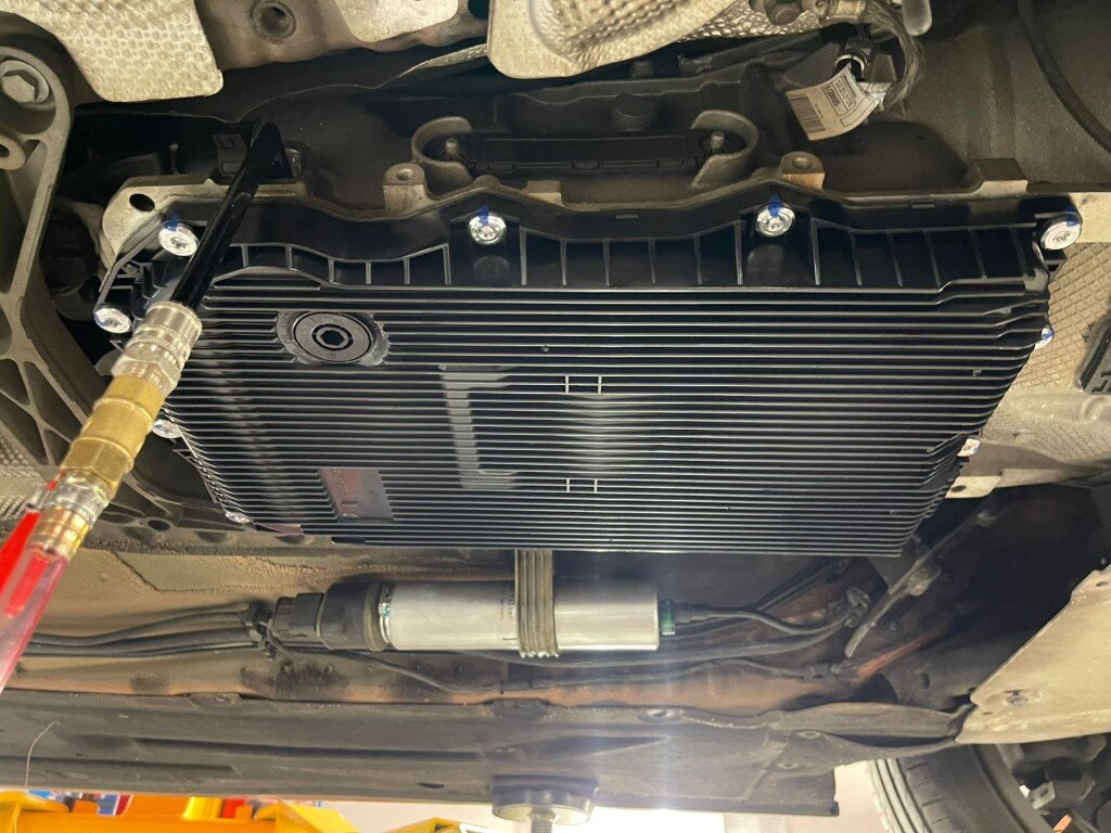

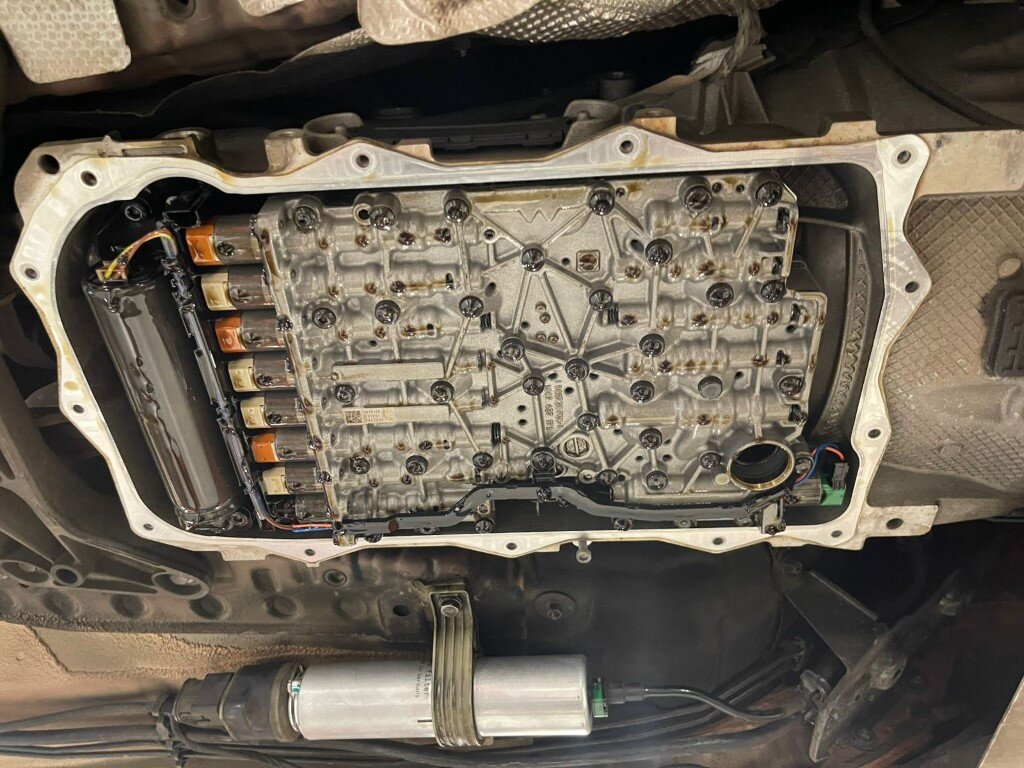

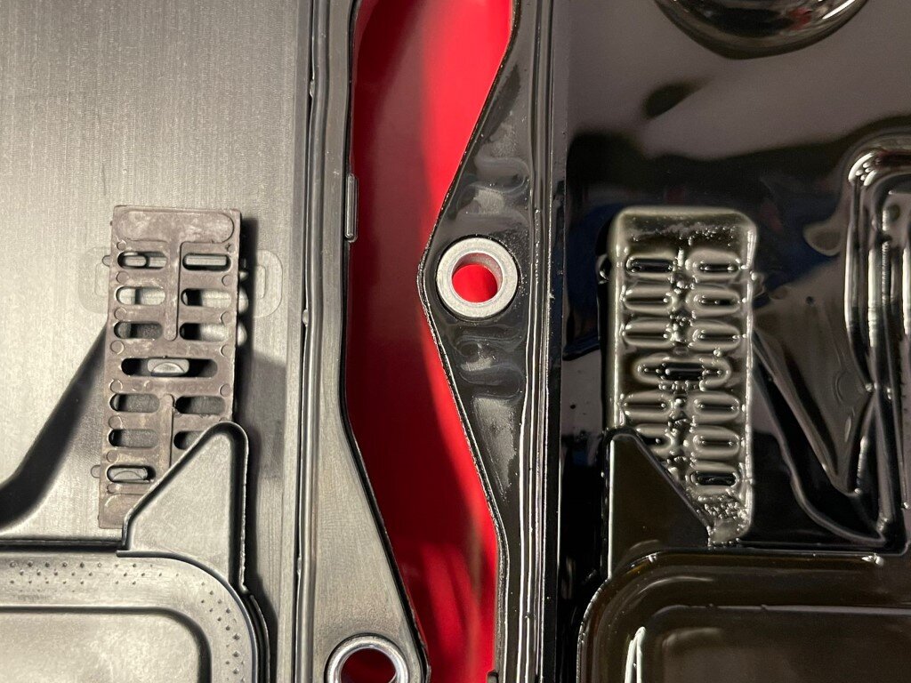

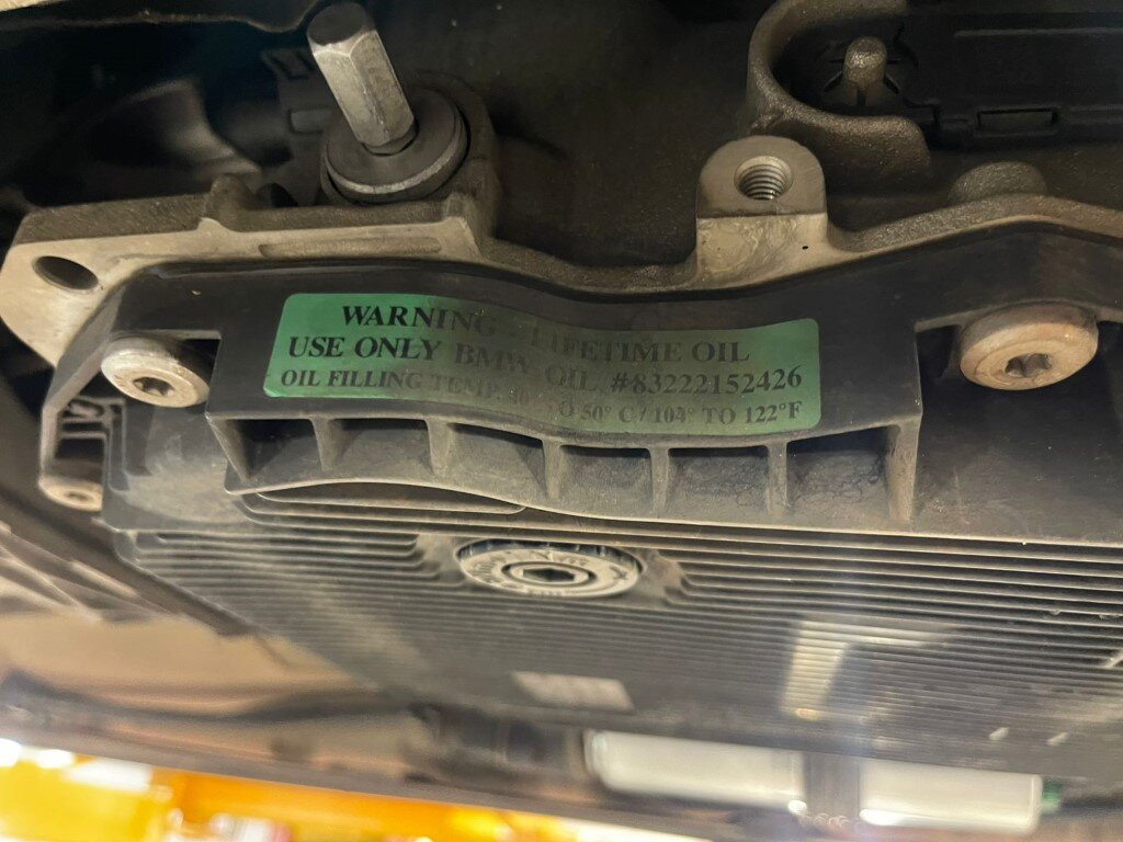

• ZF 8HP transmission service with a new oil pan/filter kit and Motul ATF

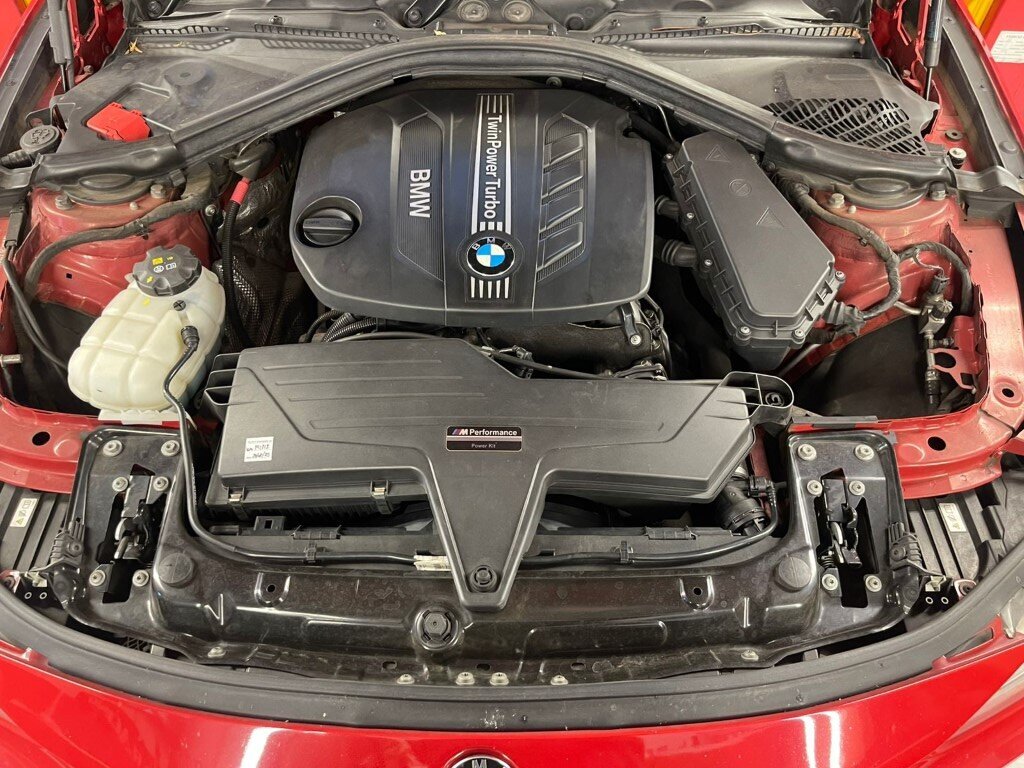

My plan with the engine is to gradually clean out whatever accumulated soot, contamination or deposits may be present after 200,000 km by doing three oil services within roughly 1,000 km.
The first two will be done using Liqui Moly 5W-30, mainly because I have some extra stock taking up space in the cupboard.
The idea is simple: fresh oil and filter, run it for a short interval, drain it, replace the filter and repeat. Once I’m satisfied that everything is nice and clean, I’ll make the permanent switch over to Motul engine oil.

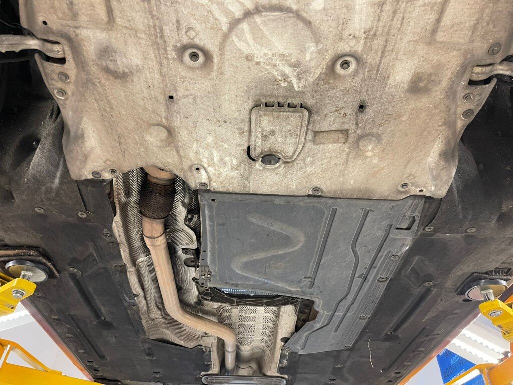

Once the car was on the lift, this was actually the first opportunity I had to properly inspect it. For a 200,000 km car, it is a fairly clean and decent specimen.

I’ll drive it around for the next week and let the fresh oil do its thing.
Then, if I get some free workshop time next week, I’ll continue working through the list.
NEXT UP:
• Replace the diesel fuel filter — I’ll probably do this together with the gearbox service since I’ll already be working in that area• ZF 8HP transmission service with a new oil pan/filter kit and Motul ATF
• Flush and bleed the braking system with Motul DOT 5.1 brake fluid
• Replace both front tyres with new Continental ContiSportContact 5 SSRs
• Start collecting the parts for the complete suspension refresh
• Engine and gearbox mounts
• Front and rear propshaft guibos and centre support bearing
• Replace the driver’s door seals — replacement seals came with the car
• Install the steering-rack repair kit — a new kit also came with the car
And obviously, somewhere further down the road...
N47 timing chain. 😅

Here's the pics from day 1
