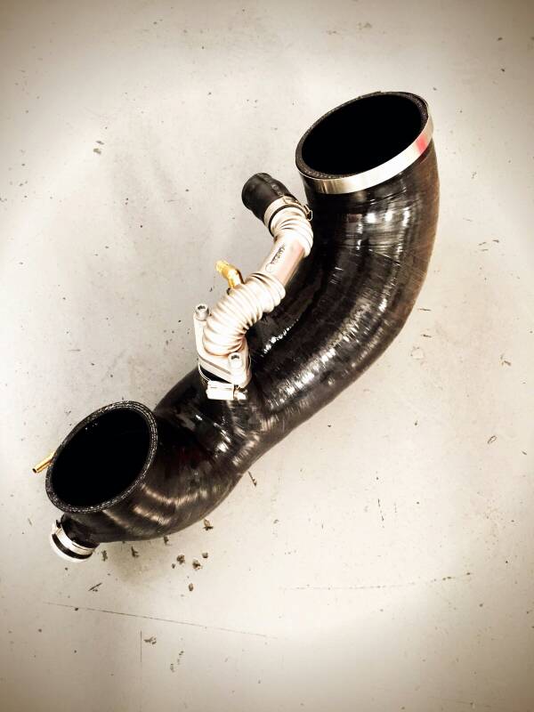

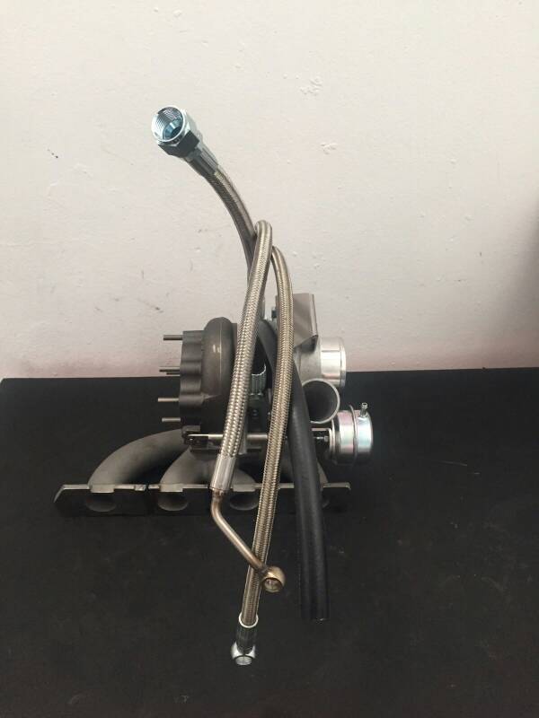

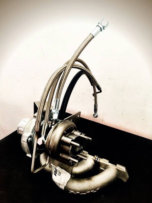

First impressions of the APR BT kit. This kit is phenomenally well built. Everything is there from gaskets to seals to shields and bolts/nuts. Very well made up kit. The feed lines are of extreme high quality!

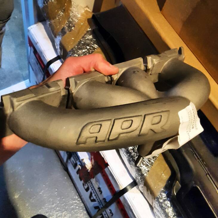

Couldn't get enough of this cast manifold. Just had to take another snap. Also very confident there won't be leaks and issues around this section as it's not a welded setup.

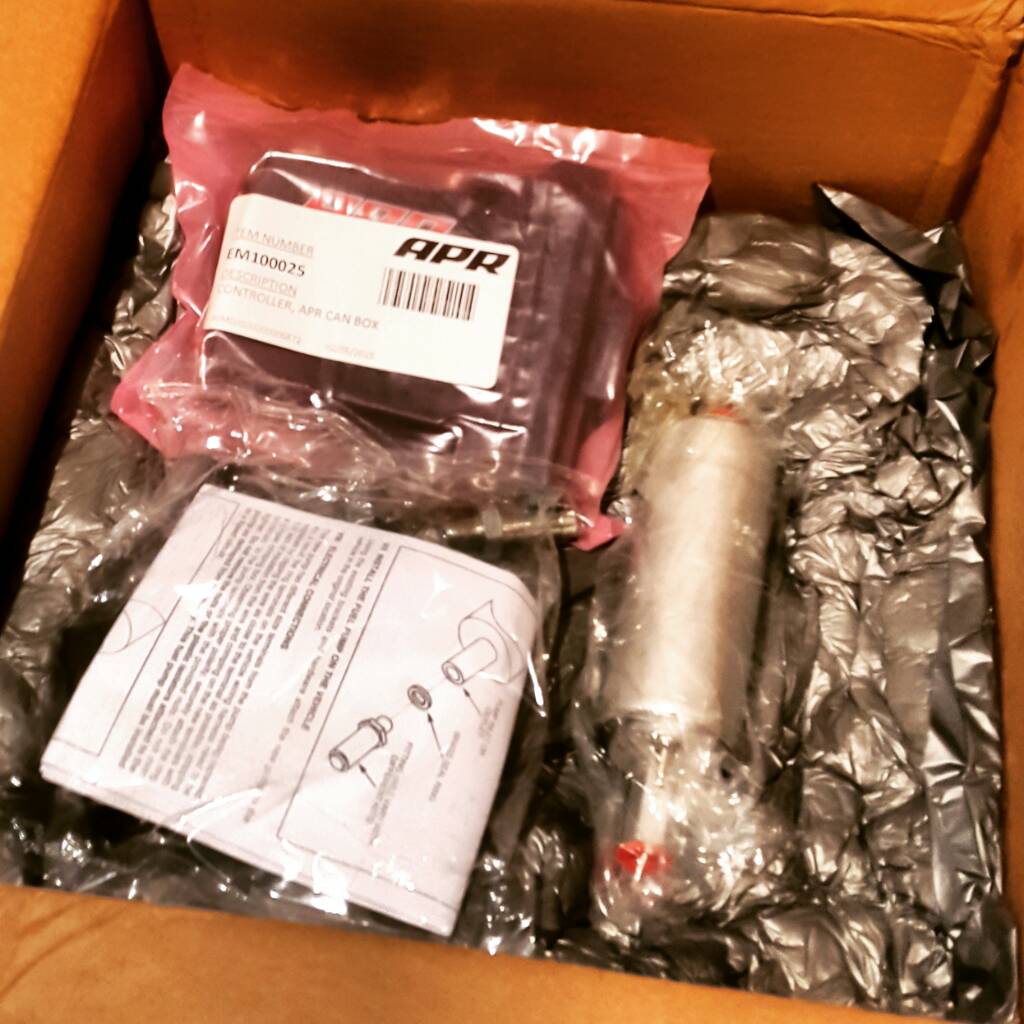

And I took a peak at my Low Pressure Fuel Pump kit from APR. It's basically an Auxilliary 2nd pump that is installed and it runs off a controller that gets mounted in front. The other nice part of this kit is because it runs on the fuel line, it has a section that you can disconnect and drain all your fuel out. Leaving you with the option of filling your tank with either 20L of pump/OB1 or race fuel.

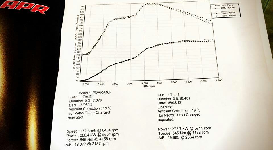

First up, he took my car to the closest dyno there which is an AWD dyno. Car was run twice and it was datalogged to check for any issues.
This is flywheel figures and on the 95 program with no additives or WMI. Dyno could be reading a tad high as the APR 2+ 95 file is rated around 355BHP, but I'm not concerned about that. Curves are good. Logs confirmed good and the same dyno will be re used to measure the gain. I requested a before of my pump file 95 program. Basically how my car runs as a daily as I want to run the Stage 3 in the same program as a daily.
With everything in check with no issues, Malcolm took the car back to his shop for the build.

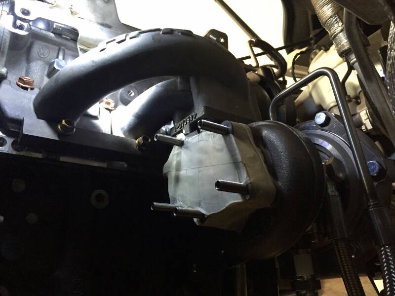

And some more updated pics again courtesy of Malcolm and his team.

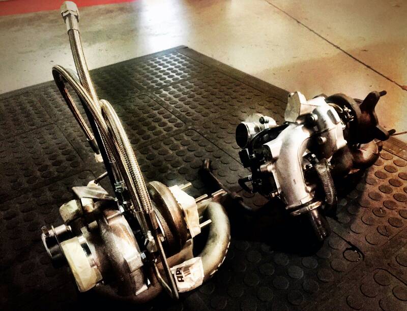

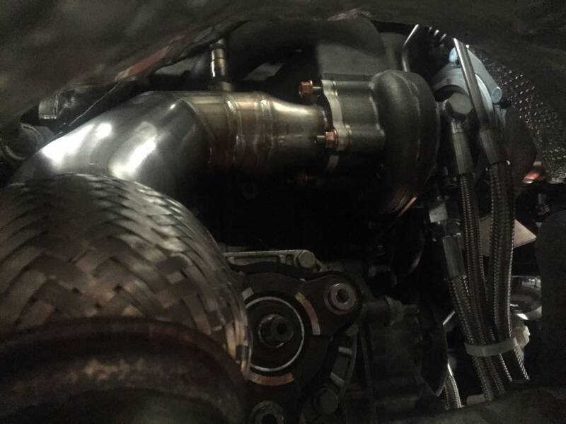

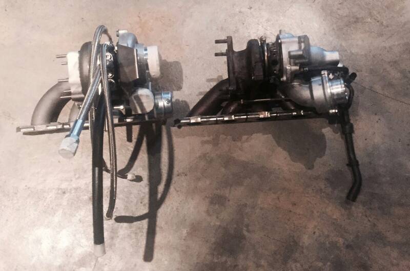

Pic comparison of the two turbos were done. On the left, the bigger GTX turbo with compact design manifold compared to the OEM K04 with manifold.

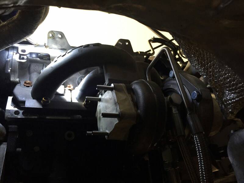

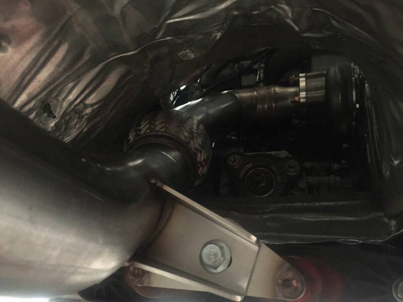

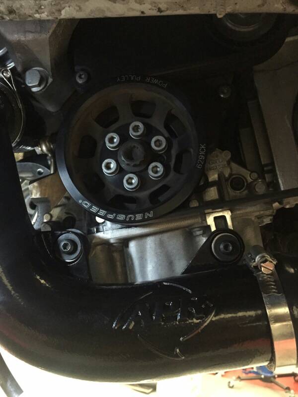

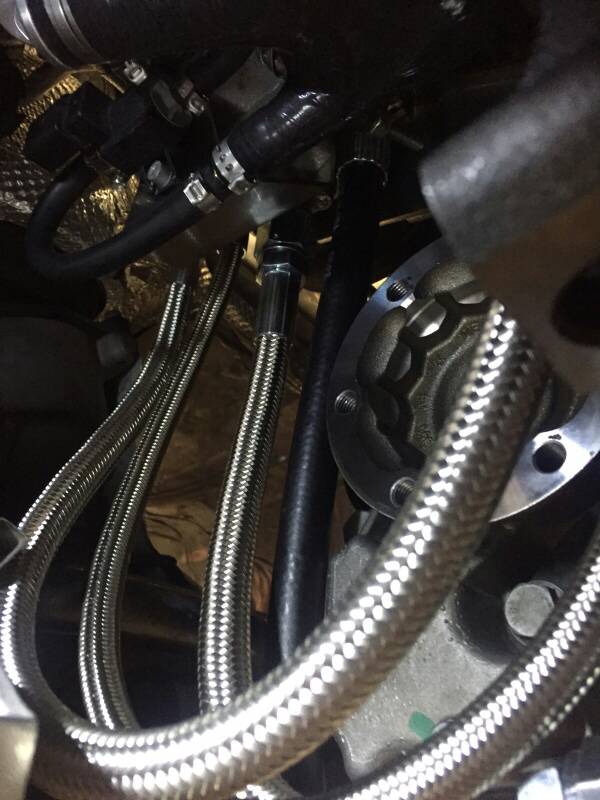

GTX Turbo kit fitted. I have not seen a more OEM fitting kit than this one.
Miscellaneous parts that come with the kit have been fitted as well. The piping all lines up and a great job has been done with the installation.

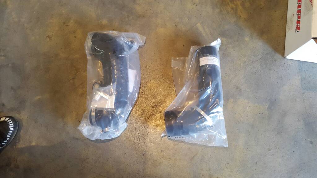

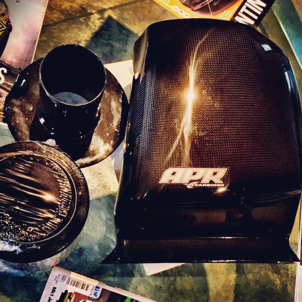

And the Carbonio TSI front intake section that will installed with my kit.
Slowly, but surely... Everything is coming together. Really getting amped to get this car back now!!
