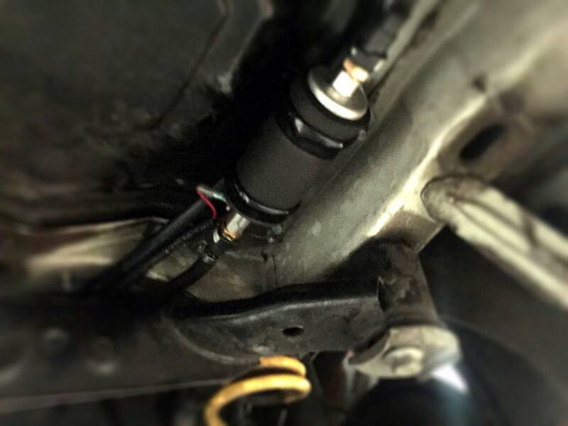

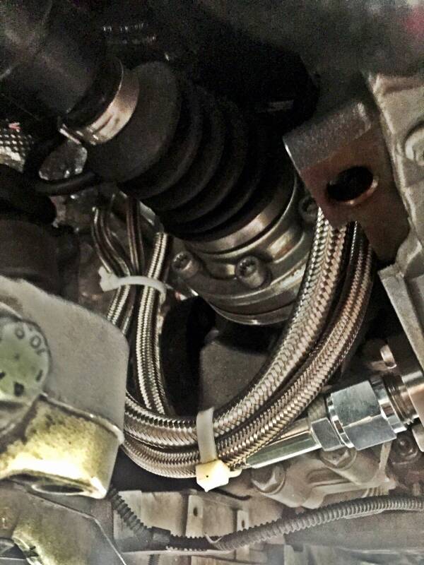

Auxilliary in line low pressure fuel pump installed

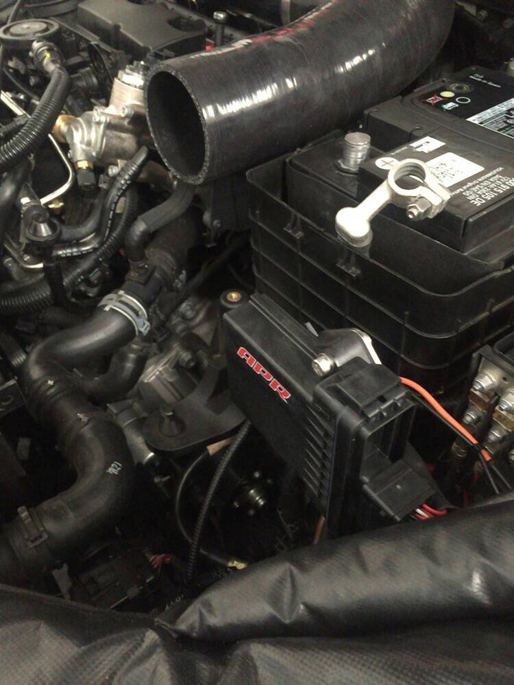

Pump runs off this front mounted controller

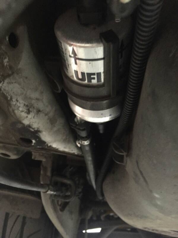

Asked Malcolm.to replace the fuel filter at the same time

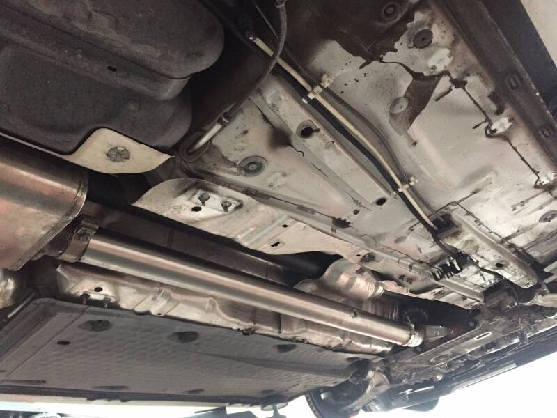

Connecting the downpipe to exhaust required modification. As I did not buy the APR midpipe that comes with a sport cat in. Normally looks like this.

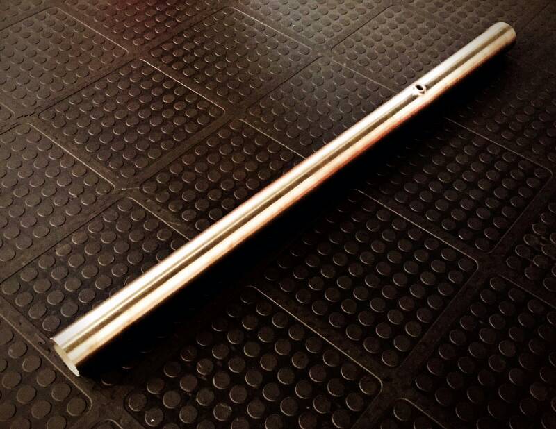

I opted to have a clean catless mid pipe fabricated to join my APR catback exhaust to the downpipe.
Malcolm had a custom decat midpipe made up from TMSS.
Hooked up to my APR RSC catback exhaust to the downpipe.

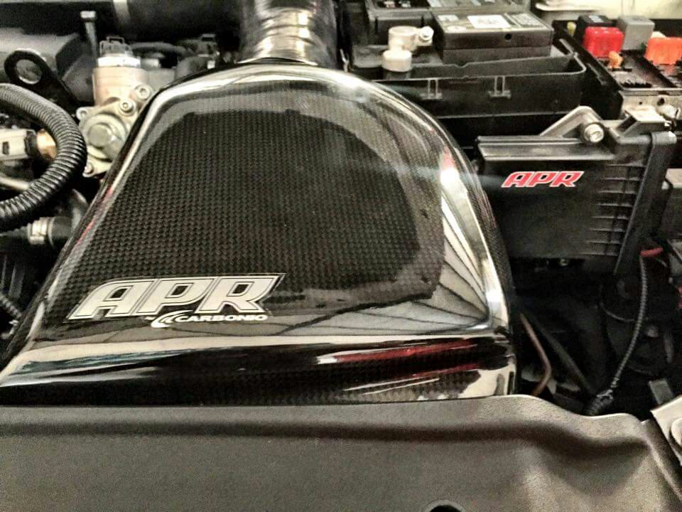

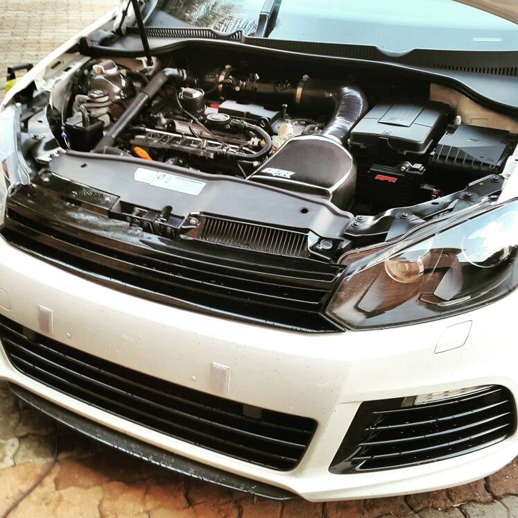

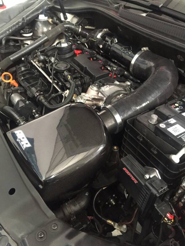

Front section showing huge MAF section with APR carbonio intake and LPFP controller.

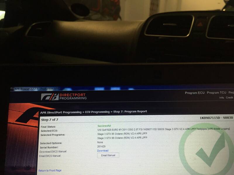

And Malcolm flashed my R and loaded the 95 and 98 programs. Once I have funds for internals, I will look at the 104 file to replace the 98.

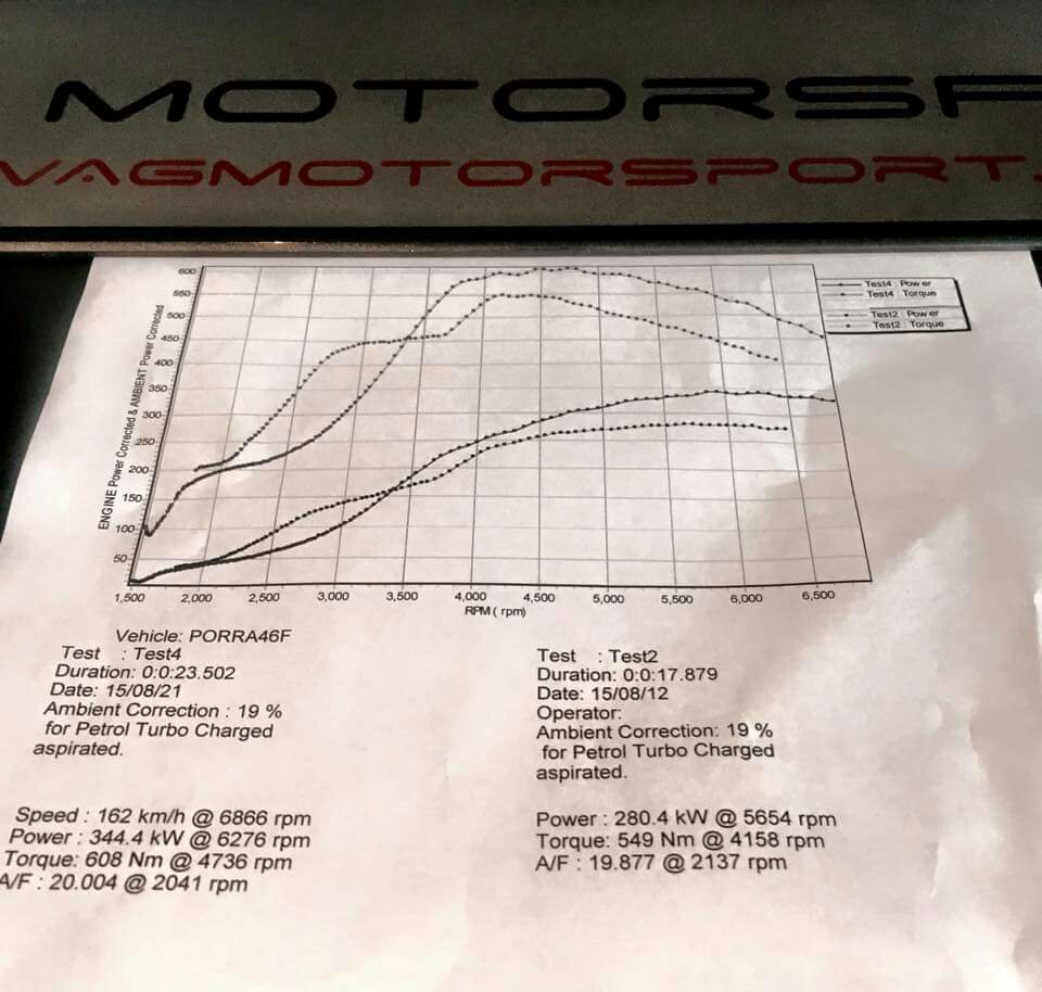

Car was datalogged and everything checked ok. Car is boosting very high, but the timing advance is very low on the 95 file. There is absolutely no timing pull at all. Malcolm returned to the same dyno that he used to dyno my Stage 2+ K04 power.
This shows the gains... A jump of 60kw and almost 60nm!

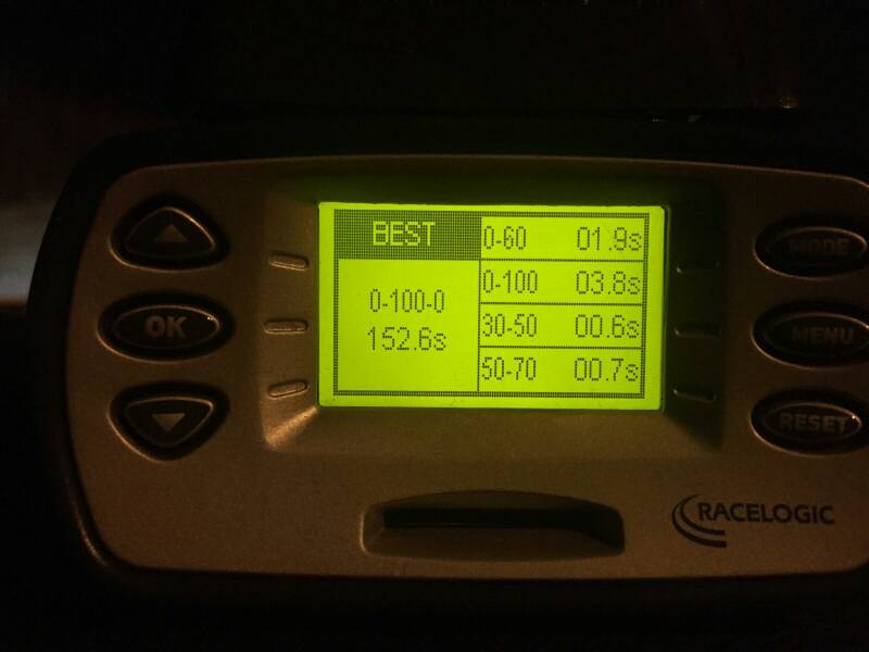

I was a bit worried the clutches will not hold. I requested the car get driven and tested before I collect. And Malcolm did a few torture tests with the car. also did 3 runs from the line and had no issues. Data from the vbox was very consistent. Maybe it's cause it is the 95 file. Here is the vbox data. 0-100km/h in 3.8s on the 95 file with no meth or additives.

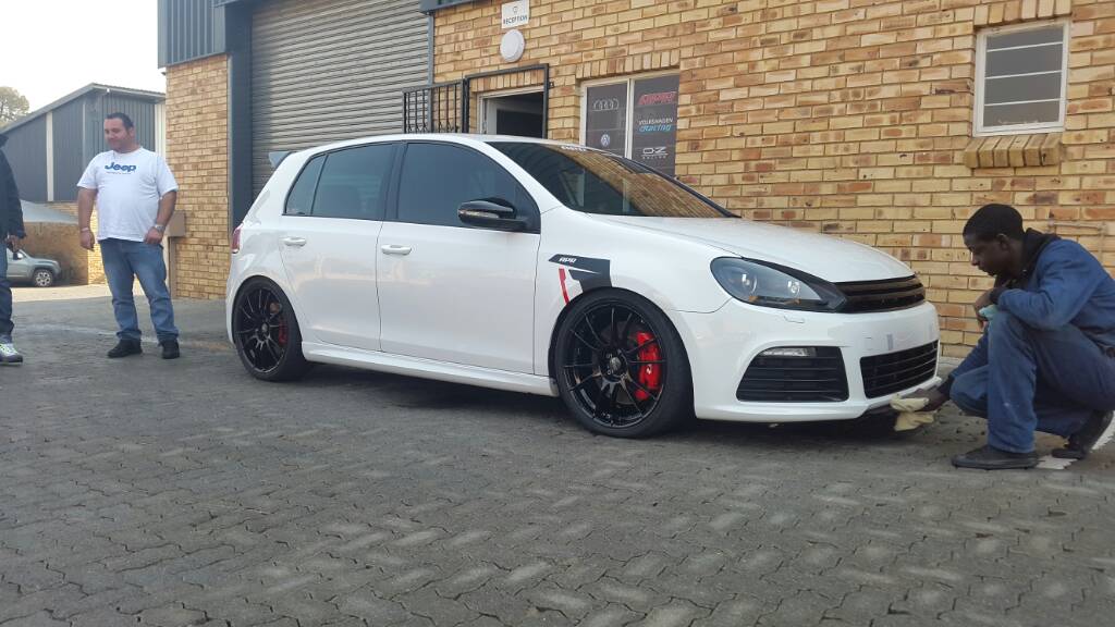

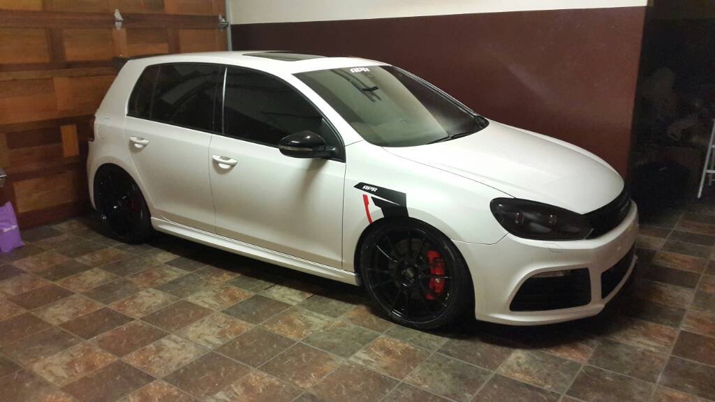

Confident that the car was ok and healthy, I had a friend take me to collect my car. Upon arrival, my R was being cleaned. The new APR sideburn stickers on the fenders really are a nice touch!
Malcolm pulled the car on the lift and went through what they did on the car. How the kit fits and some small modifications him and his crew did to prevent touching or issues. I drove the car back home and it gave me zero issues. What a pleasurable 300km drive!

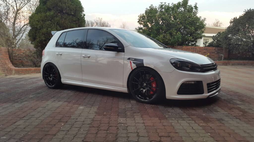

Cleaned out my new engine bay. My TTS cover doesn't fit anymore. Requires a bit of modification as the MAF section at the back is really huge!
And I gave her a quick valet. Actually drove my car more than giving her attention to the detailing part. But I will give her some good polish, sealant and wax soon!
