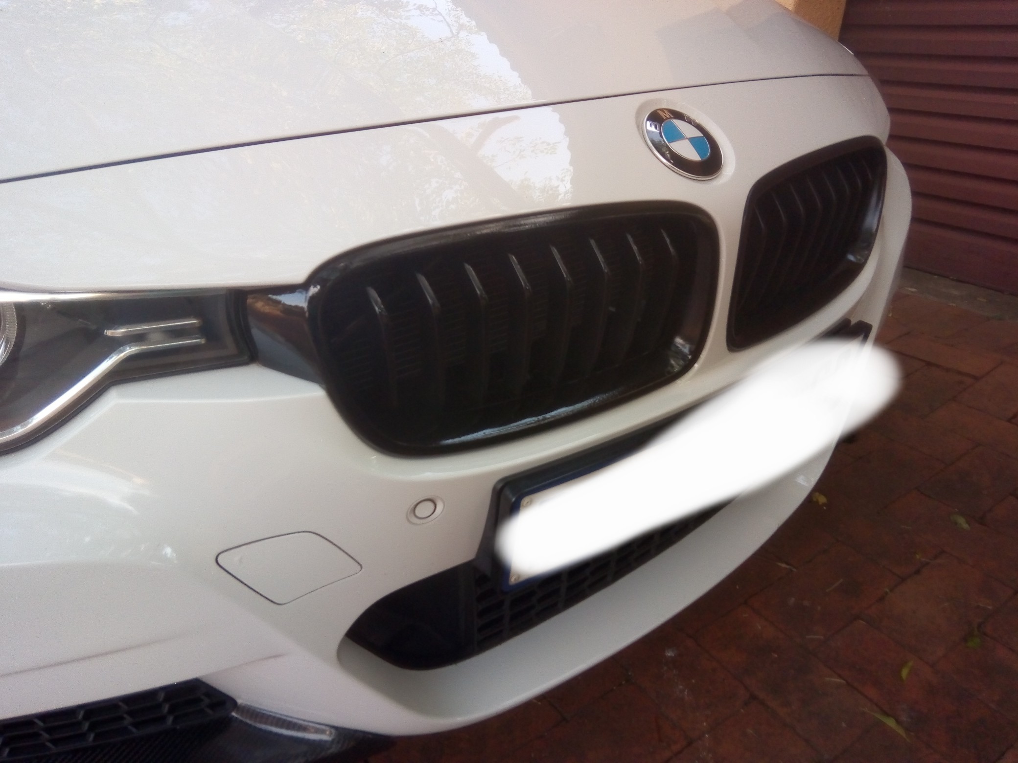

So my grills were plastidipped black some time ago, it did not last, faded and chips started to show. Not wanting to pay R2k for gloss grills I decided about a month ago to just sand and spray mine, worse case I can then buy a OEM set if I stuff it up.. But truth be told, came out okay, I am happy..

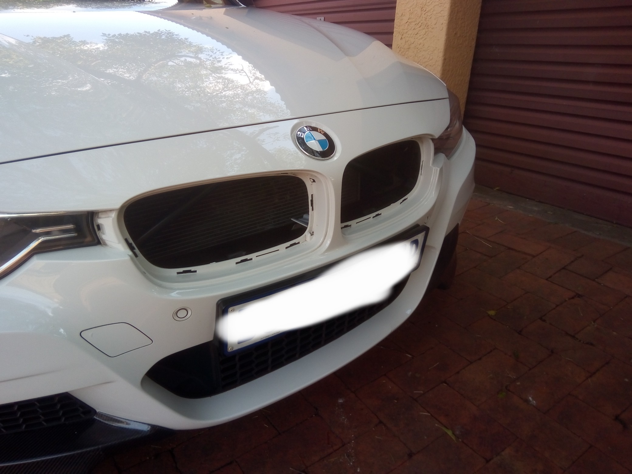

Removing the grill is easy, 5 min job.. Also gave me the opportunity to clean behind the grill and the radiator and intercooler got a nice scrub as well..
So I struggled with the plastidip, in my opinion it is not a product that will last given my experience.. I sanded the grills, sprayed with plastic primer, 2 coats matt black, 2 coats clear lacquer..
Obviously OEM gloss black is best, but this is close and I had all the paint, so it cost me nothing but some time :smilebounce:
