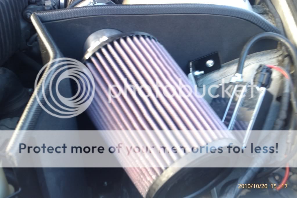

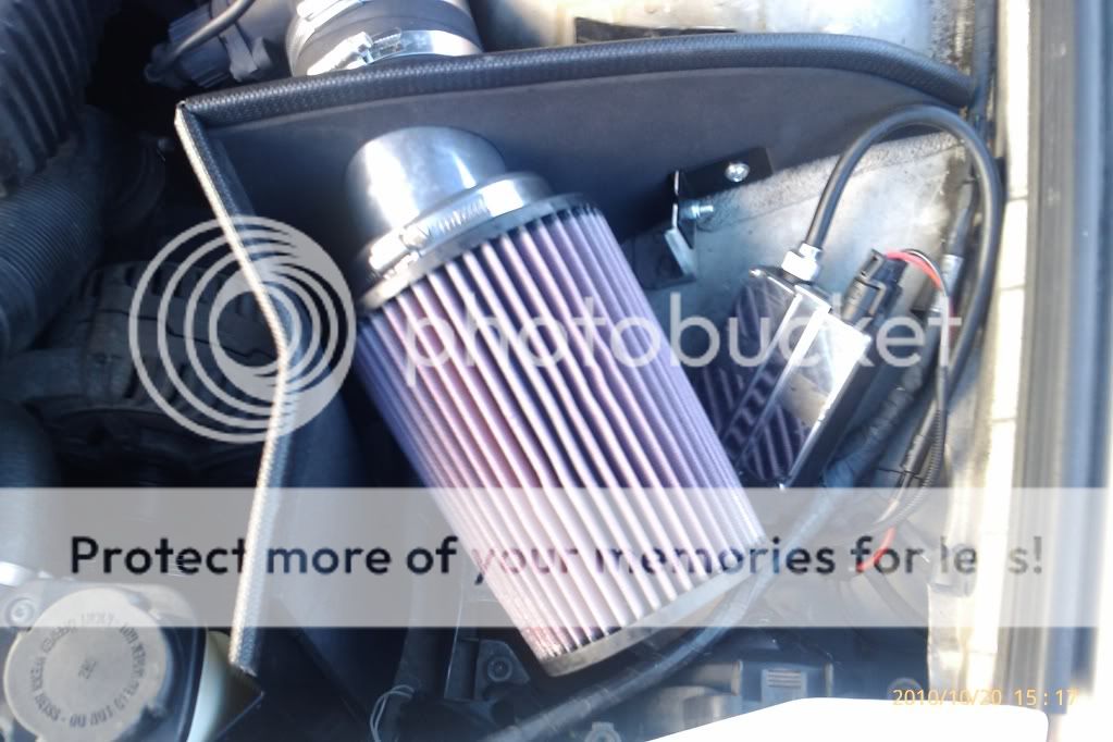

andrewbuch
Heat shield
Or this you get a simota replica for less money than gruppeM:
Iceman007
andrewbuch said:
Heat shield

this is the best ive seen so far because it also blocks off the heat from the radiator housing :)
It also has 2 cold airfeeds :)
Where from?
One is the old feed for the standard box and another which you can either run from behind the grill or as some people do and tap into the brake duct
