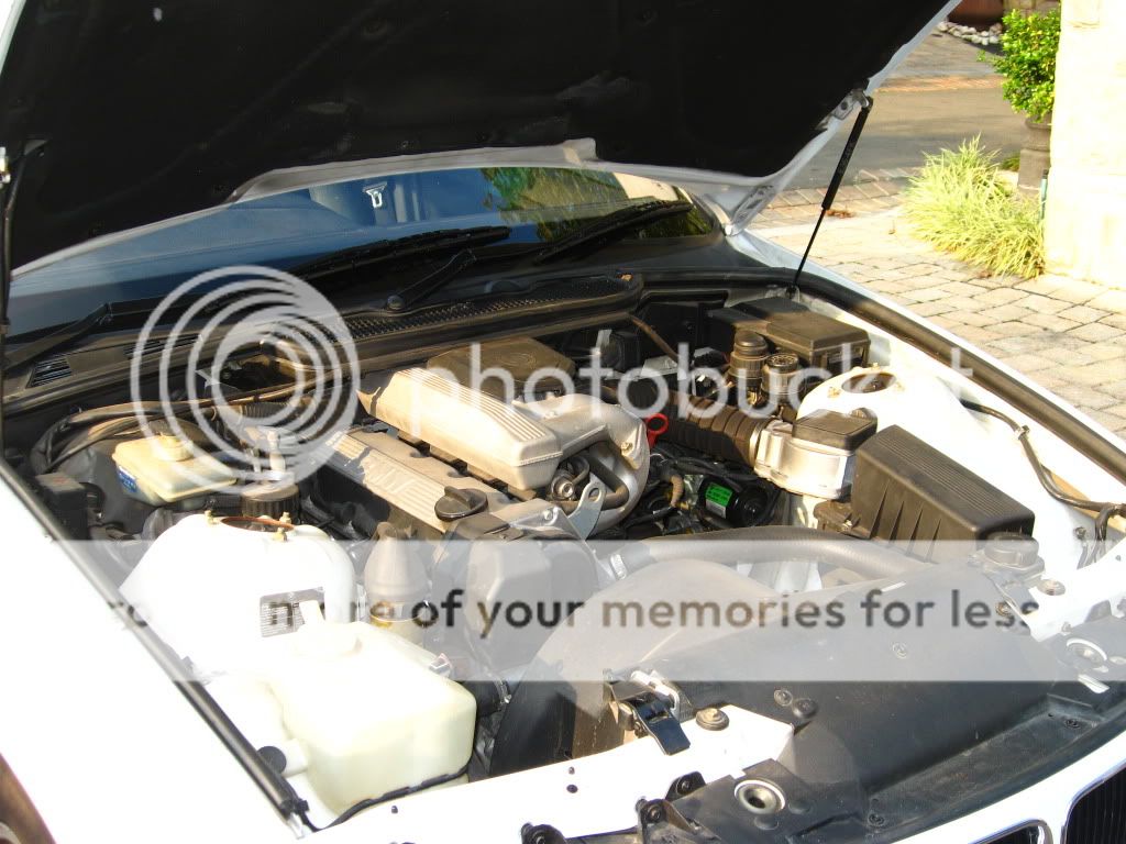

andrewbuch said:
I am sure its possible..
I have seen the front piece from a E46 fitted in a E36:
The intake piece thats above the radiator..
Then you could fit the Airbox as well I am sure..
And comparing my E36 to the E46.. I dont see why not..
E36:
The only thing is on my E36, to replace the AFM with a MAF & have a chip fitted would yield the greatest gain in power..
But for a 4cyl I do not think its worth it..
I do not know how the E36 6cyl engines look though
The fact that my 2 cars engines are similar would make it easier..
the E36 is a M40 & the E46 is the M43..

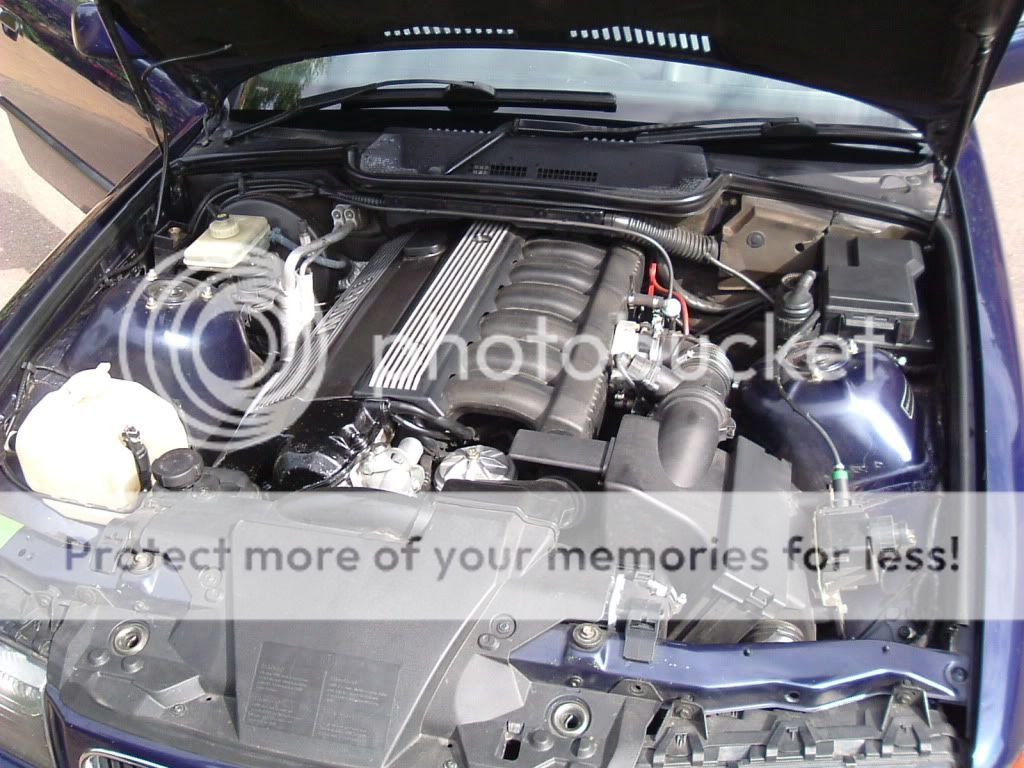

Here is a pic of a 6cyl
My 1994 325i
My 1994 325i
You can see where the intake for the airbox on the E46 is used as the cooling feed for the alternator on the E36.With a bit of modification it may be possibly to fit the E46 box...ie take another route for the cooling feed for the alternator
