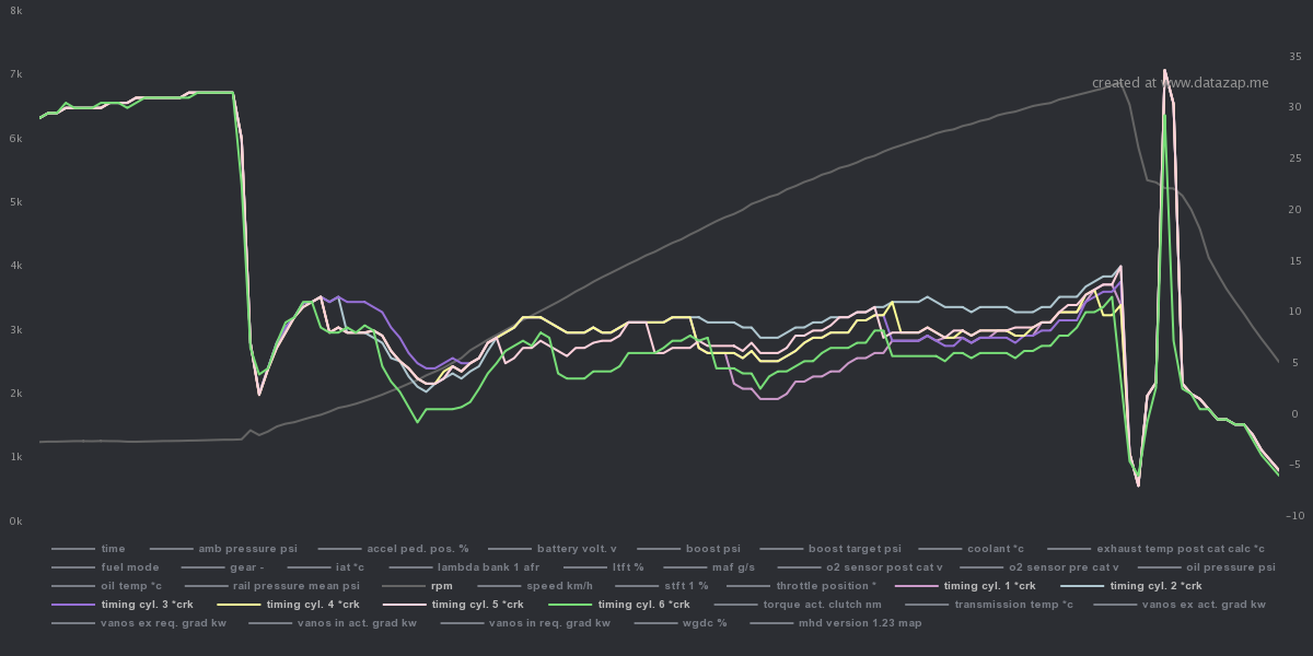

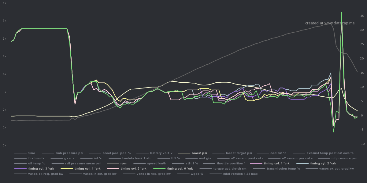

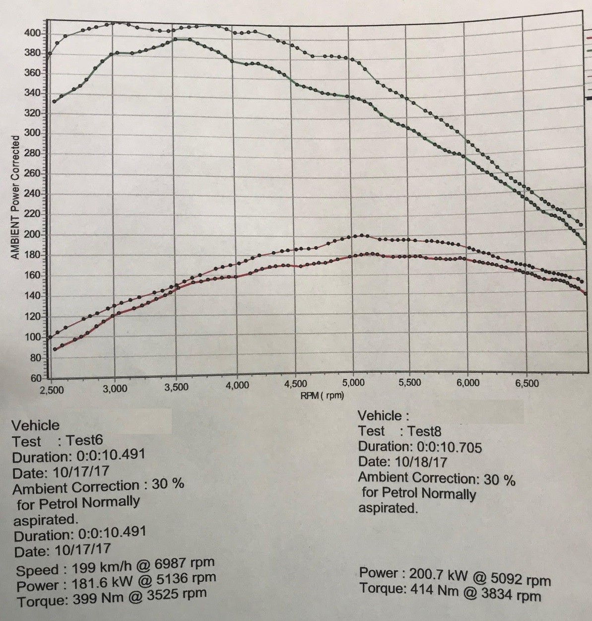

The dyno results today show 200.4wkw and 414Nm. The dyno graph itself is still not smooth but at least the car is now giving figures like other stock vehicles.
Below are the links to my MHD logs for these last two runs. Apparently the timing seems to be still trying to retard. I don't know why and not sure how to fix it other than flashing a map. Should I even bother to try this yet? I know the second my tank is empty and I fill up again I again losing the 20wkw gain with the NF Ultra.
I see the timing jumps a bit with the log but at the same time I see the throttle position drops from 99.9/100% to about 40% region. This seems odd to me.
Dyno run 7 - MHD log
Datazap link for MHD Log Run 7
>>>> Dyno run 8 - MHD log
Datazap link for MHD Log Run 8

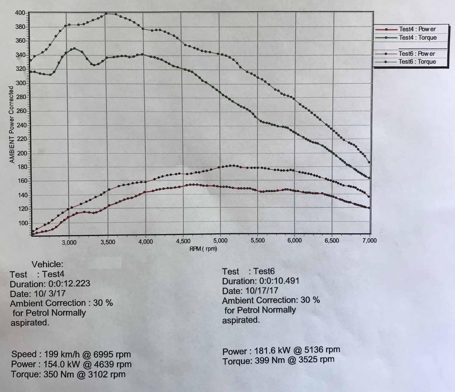

Below are some dyno graphs. One can see how unsmooth that graph line is.
At least a big improvement since the 154wkw and 350Nm to 181wkw and 399Nm after intercooler was fixed to the now 200.7wkw to 414Nm with NF Ultra. At least making some progress in the right direction.

Anyone able to look at the logs or provide some input regarding the timing issue?

What do you guys reckon regarding the potential issue on the logs and graph?

I think you worrying about things that don't exist now :) Your car is making good power and seems to be running well. The dyno graph with the bad fuel was a bit suspect but then when you ran it with NF it looks pretty normal to me. A turbo car isn't going to have a smooth graph like a NA car, its going to have peaks and dips due to boost raising and timing having to change to accommodate, waste gate duty cycle controlling the boost etc. There is allot of stuff going on there.

Haha. I might be worrying about nothing. I am just not sure that the car should only be doing 200wkw with NF and not stock.
