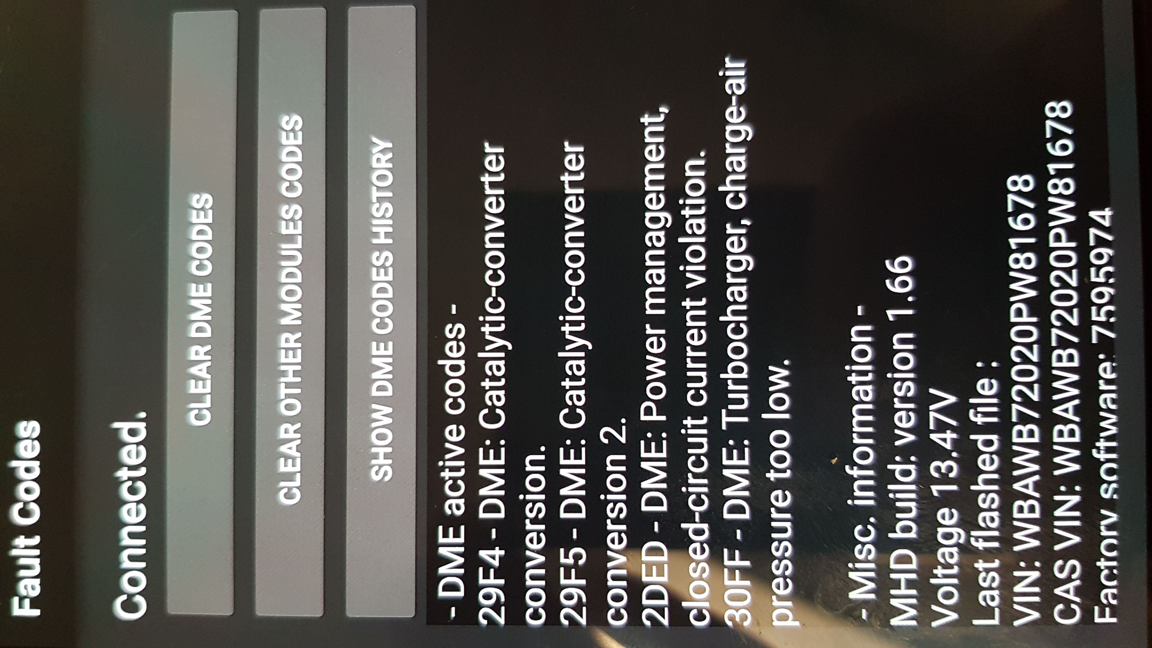

i have a request on the below error i get with MHD.
Now before anyone asks, i know about the 30FF error, and am busy troubleshooting it, but cant come across the issue yet, i have possible faulty Rear Boost Solenoid, so will try that along with new Vac Lines from Solenoid to Turbo (rest have been replaced.)
the 30FF is intermittent, and comes up once in maybe 2 weeks. not even on WOT.
the 2DED error, i only noticed it after i bought the MHD logging licence.
I initially had the JB4 connected, then wanted to log, and didnt read properly that MHD logging is not compatible with JB4, so i removed it, then read codes with MHD, and did some log with Osiris, which showed no issues, and the car was pulling strong.
no errors after clearing the codes, no 30FF, was fine.
drove home, and gave some throttle near home and the half EML came up, which i knew was the 30ff,
but on the odd ocassion now, i check the Codes, and see the 2DED Power Management error there. any ideas? could it be the battery, or the IBS sensor?
i took the battery cable off when i installed and removed the JB4, could it have been damaged at all? i didnt bump it or anything. just took it off the terminal.
